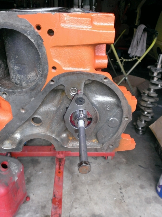

Today I had a clean block, so I installed the cam first. I installed the cam first to be sure that the 460 roller lifter wasn't gonna hit anything it wasn't s'posed to. It didn't ( That's cause I built it)
This is one of the things that my machinist did for me last week. Originally, we attempted to drill the cam for that dowel that would be necessary to put a SBF timing gear on it, but the freakin camshaft was so hard, that it screwed up the dowel alignment when we tried to drill it. So I bailed on that plan, and had him drill two smaller .250 dowels. By keeping the diameter smaller, it didn't get into the harder material that was farther out from center. I also had him make the thrust plate, as the stock piece was too thin. This one measures about .240.

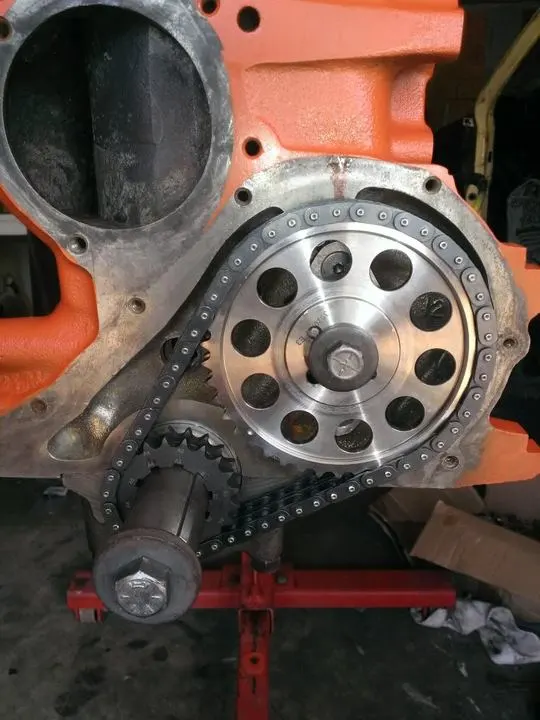

Now there had already been another guy that had done this before, but he took the SBF chain that came in the kit, and removed one link, and then put it back together. I decided to try and find one already complete. After spending a few days, and about a dozen phone calls working on it, I found one.
According to the source, this is the stock chain for a 78 Toyota somethin-or-other. It is made in India, and is suppposed to be as good as the DiDo chain that came in the kit I bought from Summit.
Fortunately, it only cost 15 bucks.
But,.....I had no idea if it was gonna fit.

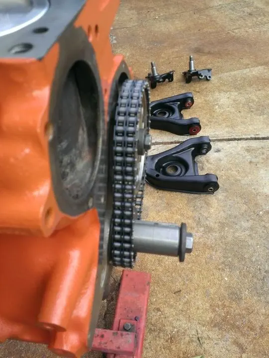

The next thing I did was place the crank. ( So I could see if the damn chain was gonna work)
So did it work?
Like a champeen! Not too tight, and only barely enough slack to allow me to get the damn thing on.
Like it was made for it.
Well, actually it was. That crank gear had to be cut .300, and the snout of the crank turned down an additional .050.
A keen eye here will notice a full length crank keyway that goes completely under that crank gear to the front of the journal.

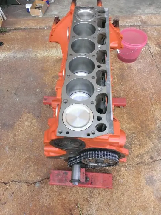

After breathing a huge sigh of relief, I moved on to fitting the rings. Recommendations called for a .025 top ring end gap, and the same for the second.
Once all of that was done, I threw them dudes in there.
Racetec 3.700 bore 2618 forgings. Compression ratio should be somewhere around 9.0:1.

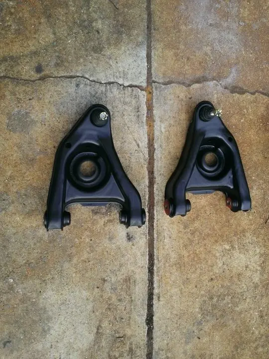

I stopped here on the engine, and moved on to rebuilding my lower control arms.
I have to use stock arms, because all of the aftermarket stuff is longer, and I can't afford anything longer, else wise my tires wont fit.
I heated the bearing shell the old bearings were in, and after about a minute of direct heat, they started to bubble. I whacked that b itch w/ a chicken peen hammer, and it shot outta there like a bullet. I did all four in about 30 minutes that way.
I put it back together w/ some red poly bushings I bought from Summit last week (one of those boxes I didn't even open till today) and some cheapo-degreapo 95 GT ball joints from the Zone.
Painted it black, and............... Now I present them to you.
Behold the lowly, lower control arm.
They're red, but I painted them black. I'll take some lacquer thinner, and wipe off the red parts so the OCD's out there can sleep tonight.

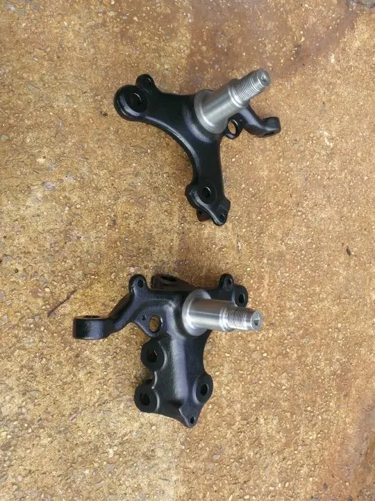

I also stripped my 95 spindles of their splash shields, and about 19 years of grease and dirt.
This is for another day

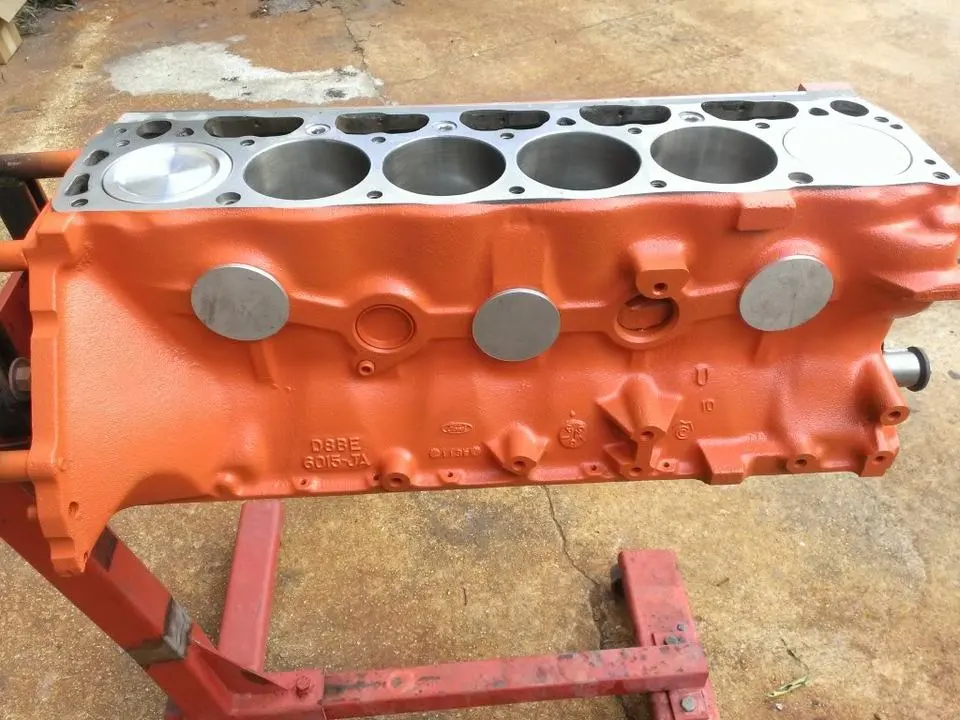

The three discs are made out of .500 thick aluminum. The intent is to use these for water fittings. I partial filled the block, and I doubt that a stock WP will work properly, given that it's impeller would be even w/ the fill line. The missing plug was where my machine shop decided that I didn't want the three brand new plugs in there if they were gonna run it through a final wash, and they beat two of them out before they realized that there was cement behind the bottom 2/3rd of the plugs.
I still have to degree in the cam ( Something that I have never done before in my entire life) and torque the bottom end. For now, it's bagged.
