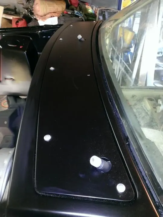

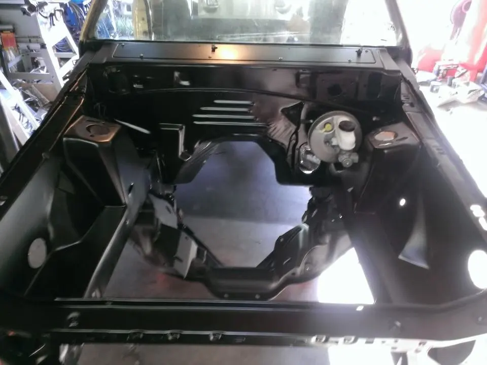

If you look at the pic, You'll notice the cowl.
This Cowl panel:
It always amazes me how much sh it the digital pic picks up that my eye manages to let slip by.
This stinkin' cowl panel is actually a piece of 20 ga. that I glued to the ribbed urethane substrate. I thought that all I'd have to do was drill some holes, prime, and paint it.
But nooooo.
The satin black paint I sprayed on here may as well be a flashing blue light. I seriously regret using this paint. Not for any quality reasons,...mind you,.....
It's actually more like.............................trying to hide a zit on the middle of your forehead.
A really big,......ooozing,......glowing,....zit.
But I finally got it good enough.
Stupid lowes didn't have enough of the screws I chose to fasten the panel down,..so I'm two short in the pic.

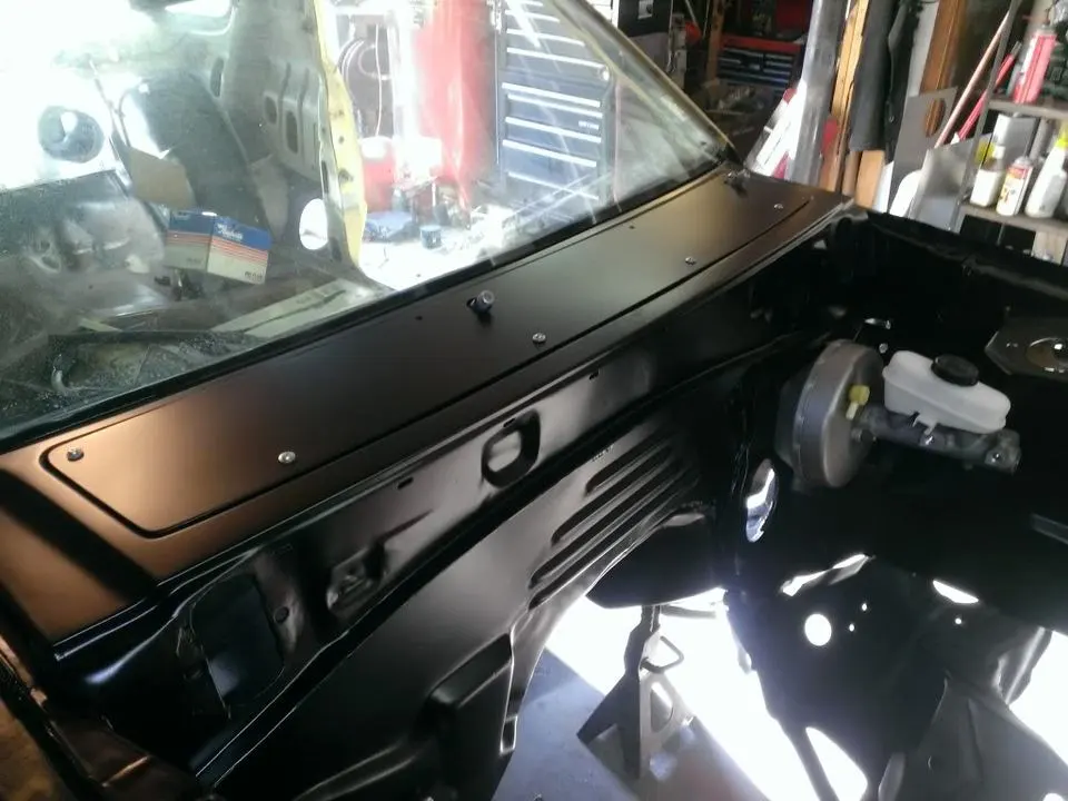

#1. That panel is hiding the wiper mechanism that was yellow this morning.
But in the pic, it's factory natural,..stripped to the way it came in 1978.

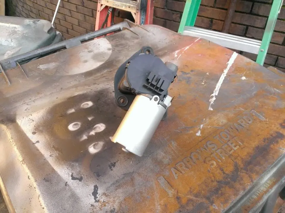

#2. The wiper motor:
Completely disassembled so i could clean, and paint a 35 year old part to make it look new. But, because I used stinkin' aluminum paint,...and because I wanted to get it together before it was dry enough,..the silver part of the assy is now covered in my finger prints.
I'll have to wetsand it toorrow, and repaint it again.
The wiper motor was good for two hours by itself.
#3 The flying saucer factory power brake booster,...badly needing to be stripped, degreased, and painted in stainless steel paint.
My brand new Cobra M/C acvtually was the single fastest thing I did today,..I think it took two minutes to bolt it to the PB booster.

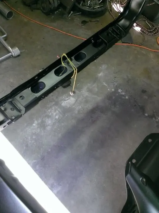

#4. The K member is bolted in place now. Despite the fact that it has been sandblasted for months now,..it still needed priming, and paining prior to installation.
It's not like I do this everyday. The question is,..How do you know it's square, and straight in the engine compartment?
I don't know either. I guess you just measure for center between the frame rails,...use a plump bob to mark it,..then triangulate and measure from the front of ea. control arm mount bolt hole, to that string.
All of this black stuff was rusty stuff. It took forever to get it clean enough to paint.
