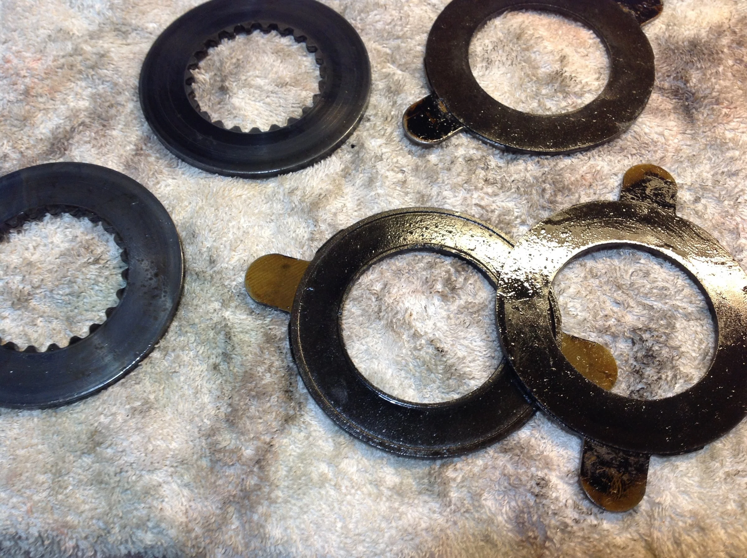

Wanna know how bad your T-loc is worn out?
Jack up one rear tire, while leaving the other touching the ground, put the transmission in neutral, and try to spin the tire that you lifted off the ground.
Mine spun so easy, I had to check to make sure that the other tire was touching the ground. ( I was worried that I might have an open diff)

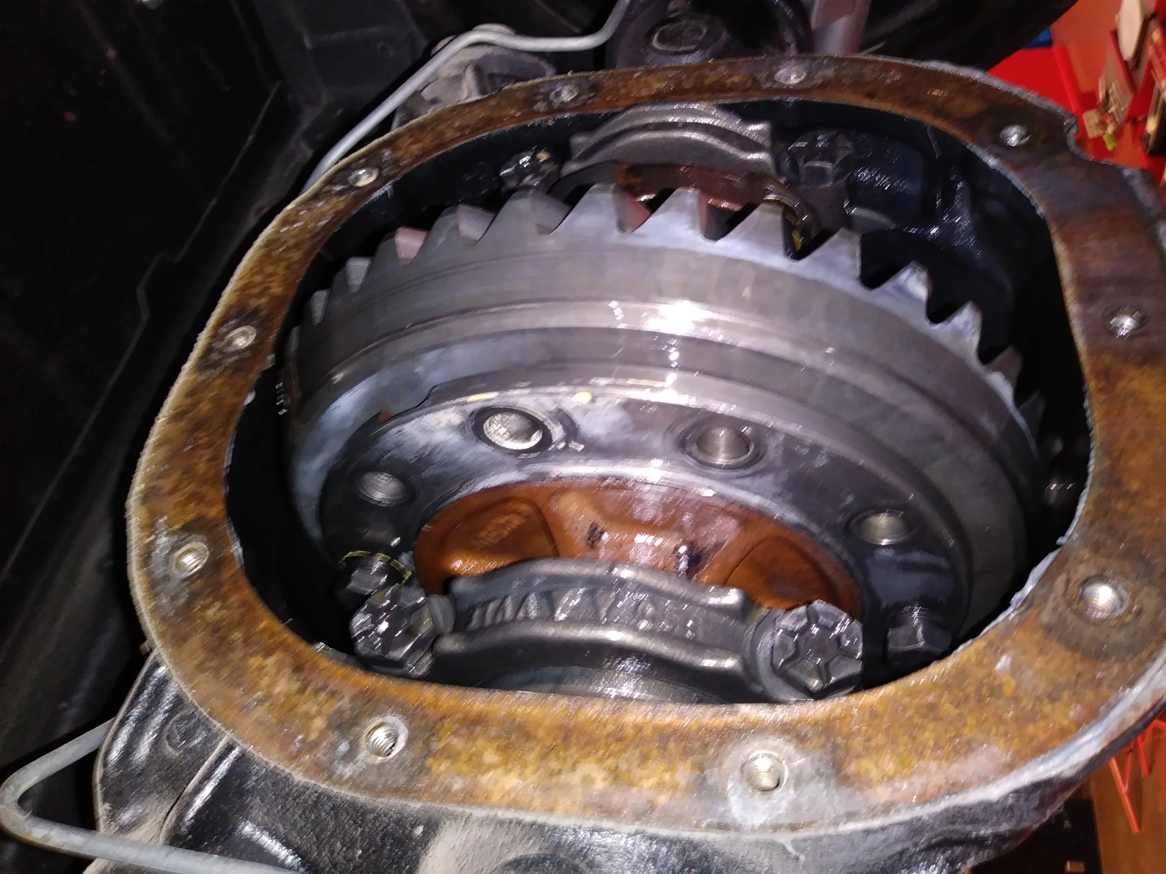

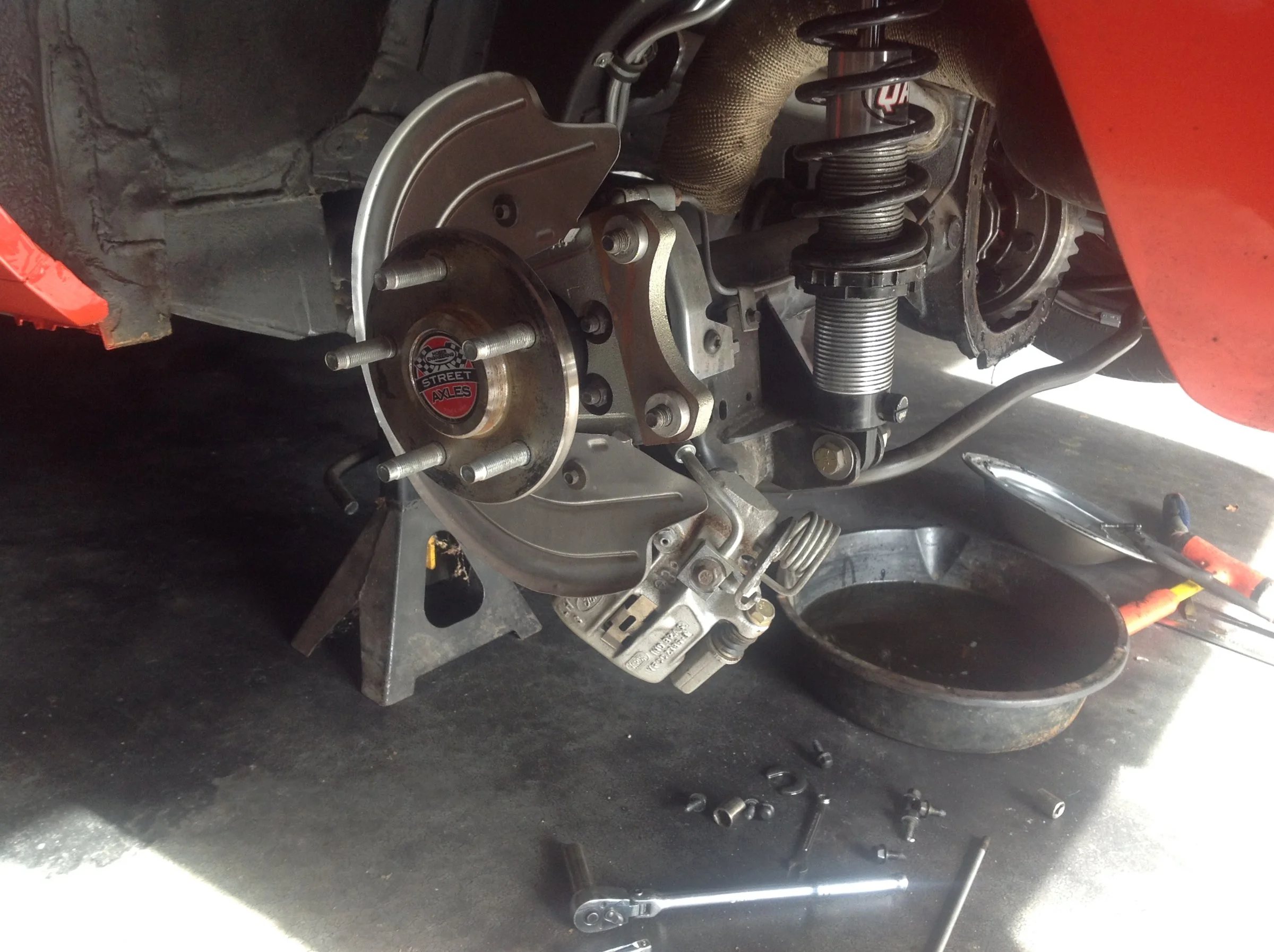

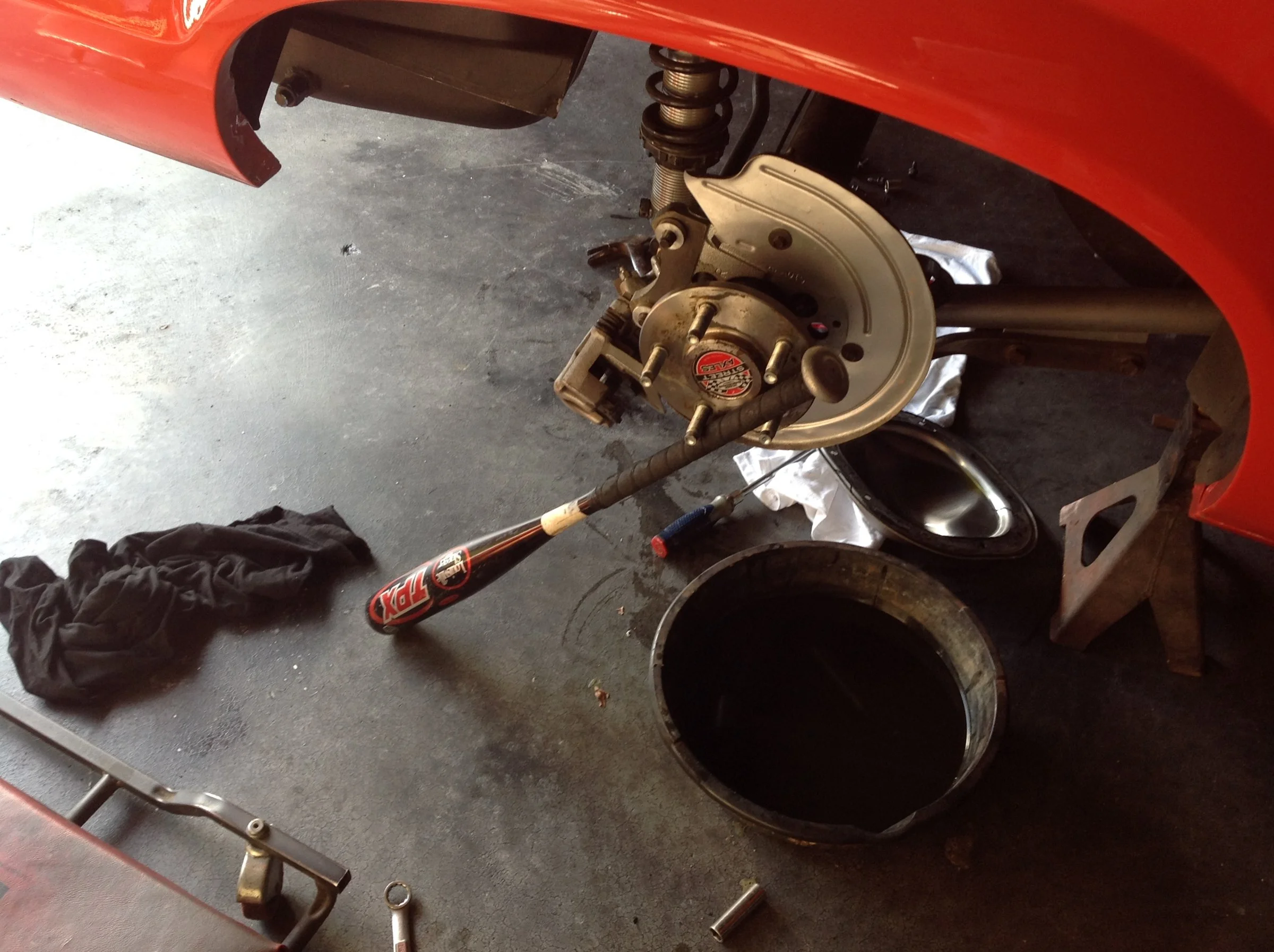

So,..I removed the tires and the rest of the junk that holds the axles in.
I had watched several vids regarding rebuilding a T loc, and was expecting a fight, but this was easy comparatively speaking.
Once that diff is out and on a bench, the spiders spin out like butter...The thing comes apart equally easy. The only thing you gotta pay attention to is the left/right orientation of things,...and you will need a dial caliper to measure thicknesses.
My old junk was visibly worn, you could see where the one clutch that rides next to the spider gear was showing it the worst.
Notice the "shoulder" on the one clutch.
I measured all that crap stacked together, and it said that it was like .654 thick ( That was with me turnin the one worn out clutch over so it would read close to its original thickness.)
The Ford kit only comes with stuff thick enough to install it at .660....It was all I could do.
Regardless, the spiders rolled right back in when I had both new clutch packs installed,....I was concerned that they were too loose...everything I watched this morning shows these guys forcing the spiders to roll into place.
I put it back together, and temporary bolted the ring gear in w/ 3 bolts..( couldn't get the new bolts from the local auto parts houses.....go figure) I'll install the 10 bolts and torque them in place from under the car where I'll be able to lock the drive train from spinning when I do that.
So,...weak new knees and all, I hefted that sucker back into the housing, and bolted and torqued the caps into place..
It's waiting on Tuesday when I get the ring gear bolts and the cover..
Then,...I performed the same "Mike test" only this time with one axle locked, and a 3' long wrecking bar in the studs on the other axle..
That sht dont turn now.....
So this is a mod that I'm glad I did. If it wouldn't have been for the damn stupid ring gear bolts coming off and flying around in the rear end, I would've put this off forever..

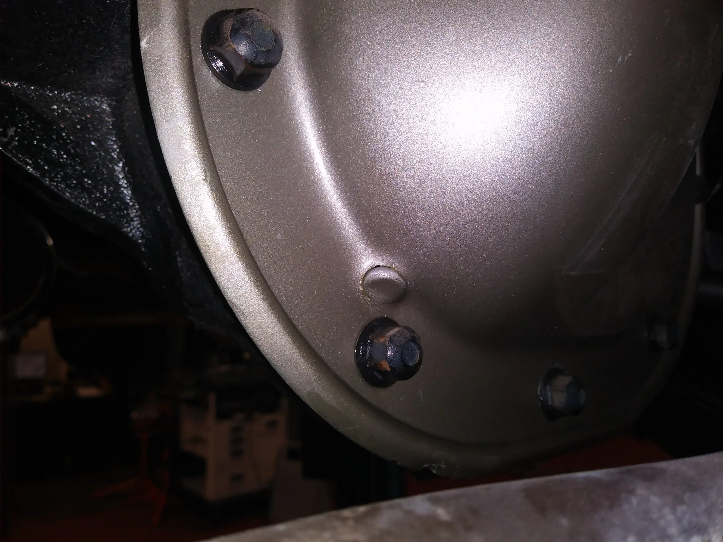

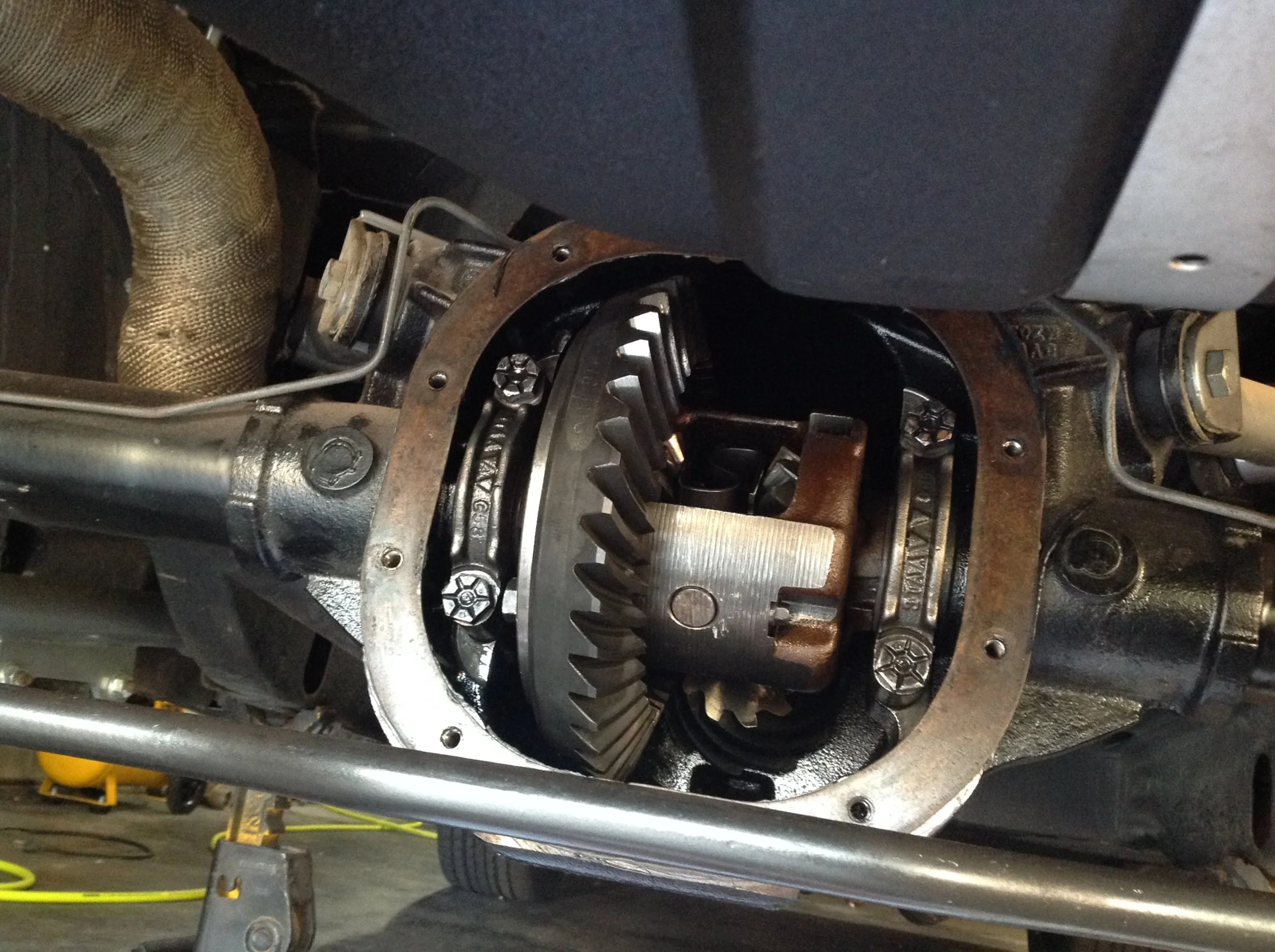

What's that look like to you?
Its one of the 10 ring gear bolts that were all on their way to falling out.
They were all loose, several had fallen out, and laying in the bottom of the housing...one of them got picked up and flung at the cover so hard, it punched a hole clean through the cover.
One of them is still unaccounted for...
( it likely never was installed)
For the last month, the rear end has been clanking when I'd put it into gear...Now I know why.
Two holes are gonna have to stay empty for tiday...one bolts threads were trashed..its very possible that the ring gears threads are the same.
It'll get me home tonight, and that's all that matters..ill obviously have to put new bolts in when I get him back home safe...ill consider rebuilding the Tloc, and adding a cover w/bearing cap support at that time too.
So...one more life down... That puts me down to about 3 left.
