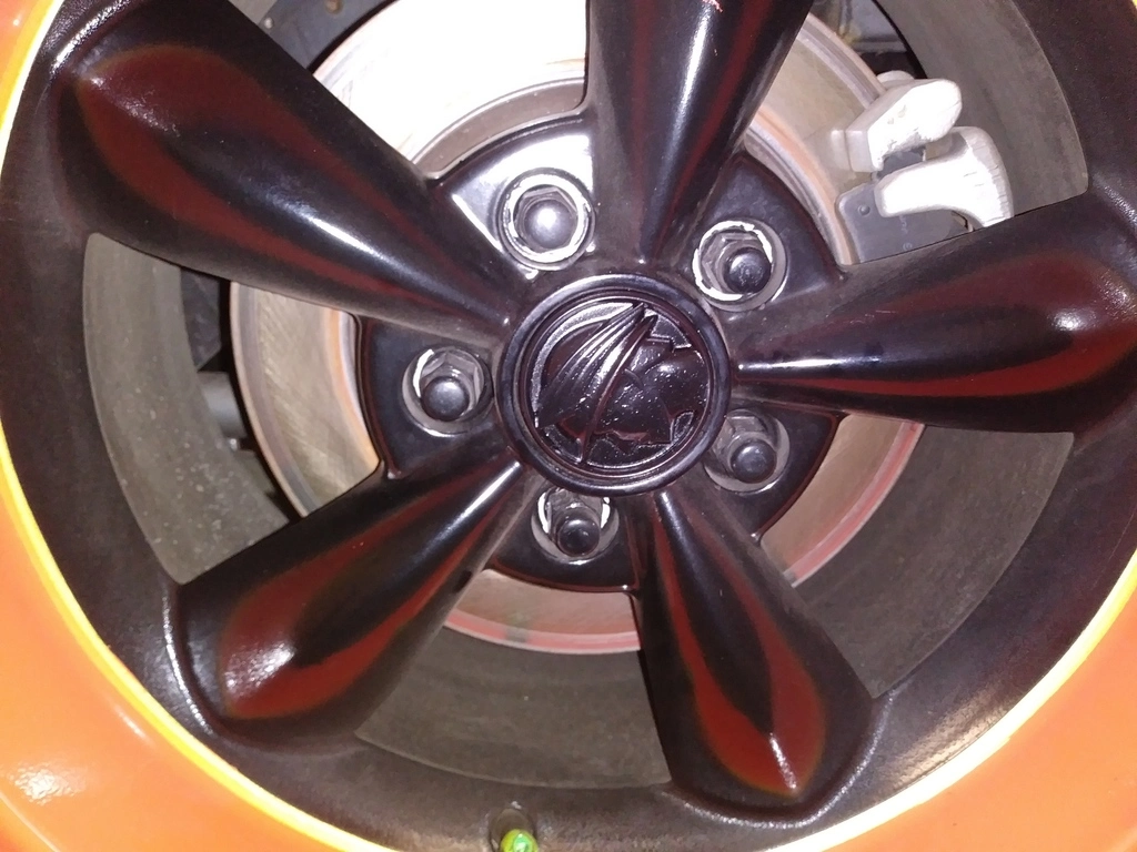

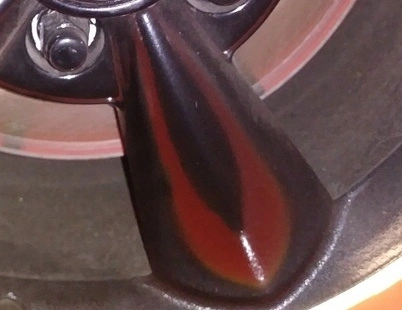

When did you put the cool stripes on your wheels?
Now that your rockin' the Melvin caps, what do you want for your old caps? lol
