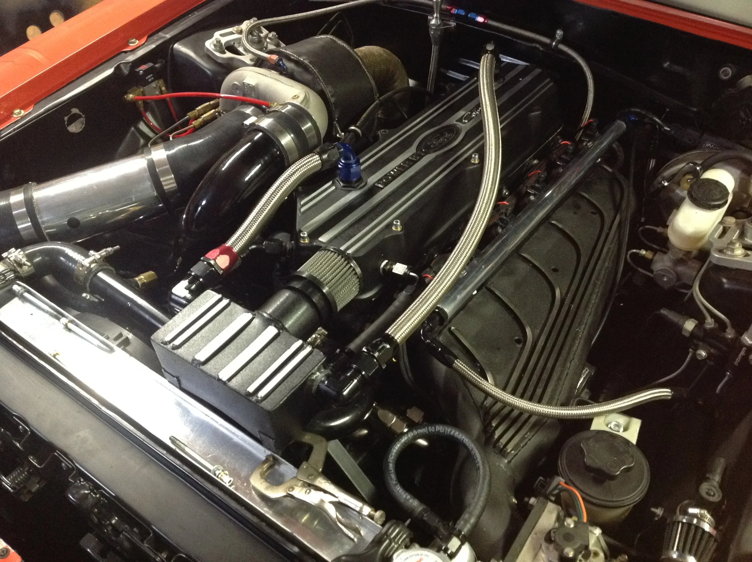

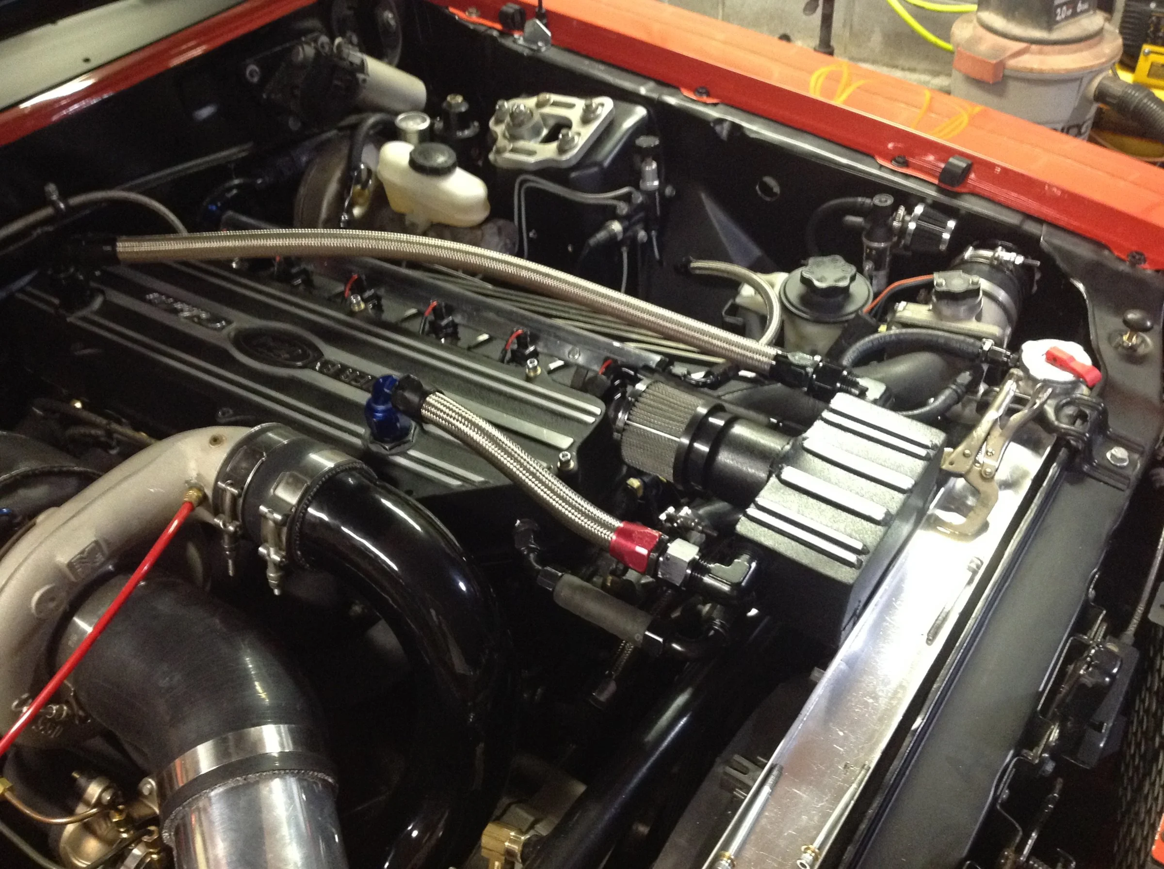

Took one step towards a tear down today.
But what a freakin amazing step it was.
When I had the gasket built by Cometic in June of 2015, I sent them the piece of crap copper gasket to use as a template. At that time, I asked if they could build me a MLS gasket for the thing, and they told me they could not. They did not have the tooling. I had to take a stock style composite replacement as my only option.
That was then.
I called on a lark this morning to check what the replacement was gonna cost so that I could set aside the necessary funds when the time came to tear into the engine. The customer svc person I talked to told me 115.00.
"I thought it was supposed to be 75.00 ea. from now on?" I asked her. She said "nope, 114.73 is what we sell that gasket for."
I asked her if I still only had that only gasket material as an option, and she switched me back to tech.
I end up with the same guy that built my original gasket for me. I tell him that Cometic AU lists an MLS gasket for my head, and was wondering if he could build me one here in the US.
He looks.
How big is your bore?
3.700"
How thick do you want it? .040, .060, or .080?
My current version is .040 I think,...Do you think I'll have push rod length issues if I go .060? How much compression will I drop if I go to a .060?
Yes, your current gasket is .040, hard to say definitively until you check, andddd almost a half point.
Yeah,..we can do it.
Whaaattt? You CAN build me a MLS gasket to fit my morphadite version with the extra holes rearranged in the locations they need to be?
Yep.
How much?
Well they list at 175.00, but because you missed the window in 2015, I'll sell it to you for 122.00
What " window"? I ask...Dude says, we started building this gasket in an MLS version 4 months after you ordered the custom one...the application is for an Aussie falcon XD. Yours is only slightly different.
So,...I'll give you the good guy discount because of that,.,and,... you're a returning customer.
Who'd a thunk it.......an MLS gasket to fit the monster for 7 bucks more than the composite one woulda cost me.
I ordered it. They'll ship it Friday.
Nowww....let's just hope the wife don't see it till after the middle of the month.
