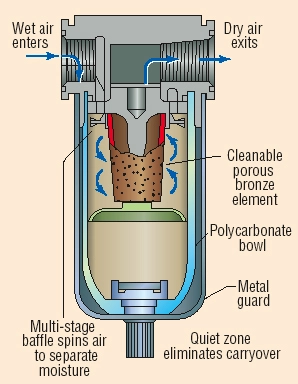

@Davedacarpainter Can you name a supplier of air/ water separators that you see in the air compressor plumbing that you use to paint cars?
The "dry air" gets dumped overboard; easy enough to do.
The "drain" connects to a one way check valve similar to the one in the 5.0 fox body smog system. Then the drain dumps goopy water vapor and oil mess in the bottom of the separator bowl into the exhaust after the turbocharger. The check valve protects the separator and plumbing in case of a backfire or an odd pressure surge.

It is time to quit trying to reinvent the wheel...
Devilbiss.
Devilbiss.
Ffffttt.
I may as well run one 1/2" hose off the valve cover, and put a cork in it.
Using an air/water separator designed and intended for compressed air would have an equivalent effect.:puke:
Air,.. ( or oil laden vapor in my case) .moved at just north of atmospheric pressure needs large volume to move efficiently or internal pressure increases. When that happens,..gaskets spooge out,..oil spews everywhere, and then I get on here and piss and moan about gaskets spooging, and oil spewing.
I need big hoses, large openings, and multiple vents to let this pig breathe, all w/o hocking up a lugie at the same time.
