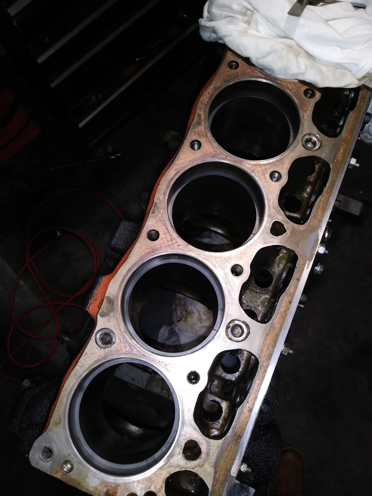

Funny you should say that...I was awake at 2 AM, thinking/worrying about that very thing.....
Installing the sleeves requires a huge over bore...(I think it was .181 last time) the sleeve they install has a .090 wall, but the finish bore of that sleeve is 3.680........( Which is stock 250 bore). ....You can't get a good ring set for a 3.680 piston, so they over bore the new sleeve .020 to 3.700, solely for that reason. ( Which is why I have a 3.700 bore piston) Doing that leaves a .070 thick cylinder wall + what ever remained of the original cylinder after it was hogged out.
At 2 AM,...You wonder what that does to your deck integrity......You wonder how many times this process can be repeated..( indefinitely?) You wonder if this time, you'll have a leak. You wonder if they shouldn't have to deck the block after that process.......rational thought being that there would be some need for that, after all 6 holes were violated to that extent. You wonder if they have to deck it,..and if they do, how far out of the hole your piston will stick up, considering the last time this was done, the block was zero decked.
Then you wonder how much compression will be added to that as a result.
The last time I did this, the block was short filled before the sleeving process. I filled it to just below the water pump opening..the bottom of the cylinder that the sleeve sits on is completely buried in block cement. At the top though,...you can see that sleeve..
It don't look like much....and I wonder what keeps water from getting by it there? There has to be remaining cylinder wall between the sleeve, and the water jacket..else wise I'd have a leak there I'd imagine.

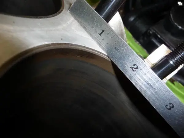

Ok.
Just spoke to the machine shop. He isn't gonna have the engine back to me before the first of the year.
I did learn that more than one cylinder had so much taper
( .003-.004") that he is gonna sleeve all 6. At .003, the ring end gap would've closed up as much as .015". In retrospect, the fact that the ring end gaps were set so loosely by me in the first place probably was a good thing.
I didn't consider it at the teardown, but the side of the piston skirts show significant scuffing...they were way too tight too.
So then....I guess that I dodged a bullet here....one that could have done way more damage had I let it run its course..(even though I had no idea that I was saving the engine when I decided to do the tear down)

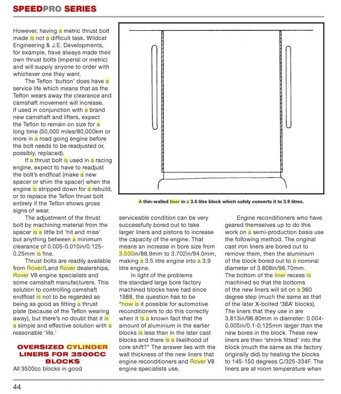

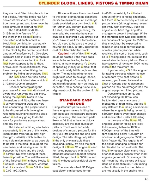

Diesel guys rock. I like to step bore, and like to put a block plate on a sleeved engine. Dry sleeves are okay, wet sleeves are much more risky.
I kind of remember what we discussed. Recap on the advice I gave back in 2014.
Down here in Hamilton Jet equiped Jet Sprint engines, pop top high compression pistons were illegal in most classes, so they decked the hell out of the factory iron six and eight cylinder blocks, and ran a copper head gasket with a reprofiled stock piston.
If thinwall, you could always sleeve an engine if it was rare. The normal rule was over bore 250 thou and use a 125 thou thick sleeve for 3.3 Vauxhall in line sixes, to get back to the stock 3.625" bore. It was a very common Hamilton Jet and oval track engine, and they got sleeved on occasion. You could over bore them to 3.700" or so, and thats 87.5 thou thick between rebored cylinde sleeve to to the piston ring. Allways, somewhere, the sleeve was protecting a major crack or score. The over boring process on a thinwall 1978 engine is taking out metal in an area that is at best 130 thou thick, sometimes 90 thou. That 90 thou is certainly the case with 90% of all Cleveland 351's that have been sleeved. Hell, Ford Australia sleeved the 76 to 82 modle year blocks from the factory to recover the casting cost of an engine, and sold them to customers that way. Mainly due to core shift.
In those cases, the cylinder wall would have been daylighted and metal woould have clear air in certained places before the liner was popped in. That is okay as long as somewhere in the thrust face, there is 180 thou of metal supported. Normally, shell molded thinwall engines have egg shaped section, and they are thicker at the suporting bulkheads, and tapper down the 5-1/2 or so inches of cylinder to a minimum 130 or sometimes 90 thou with core shifting thickness. And core shifting can be 50 thou or more. The spun cast liner is very strong, stronger than a cast iron block, but any time you remove cast iron, you lesson the chance of the liner doing its job.
On the L28's and LD28 diesels, the factory sleeve kits were only 103 thou thick for a start, and the second or third rebuilds on the sleeved engine could end up 60 thou over, taking wall thickness down to 73 thou. You can go another 20 thou over from your current +20, about +40 thou is as much as I'd risk, but your block is hardfilled, so its not an issue really.
Liner shifting due to water ingress or overheating is so uncommon in an iron engine.
According to
How to Power Tune Rover V8 Engines for Road & Track
By Des Hammill, Veloce Publishing Ltd, 2005 ISBN 1903706173, 9781903706176 and 216 pages long
The reliable replacement thinwall liners are just 55 thou thick after machining to 3.702" in a bored out 3.5 Rover block.
Stock, the very unreliable liner is 91 thou thick wall for the 3.702" 3.9 liter Block.
page 44 to 45.
That is in an aluminum block, Mike, so if its cast iron, hardfilled and over bored, you can over bore to a 305 Chevy piston and still have about 55 thou of wall thinkness.
This is what I based my liner around, the prospect of saving any iron 200 or 250 Ford block using the common GM 4200 or Rover 3.5 style liners, and the common 3.625 or maybee 3.756 pistons, and having it survive three 30 thou over bores, +30, +60, +90. Its possiable!
Back in 1985 to 1994 when I had it, everyone suggested I used a Rover 3500 or Buick-Olds-Pontiac 215 in my old 58 PA Vauxhall, but that engine isn't something that mechanically locks its iron liner to the aluminum block. Either the B-O-P 215 cast in liner isn't inbeded, or the later Rover 3.5/3.9/4.2/4.6 shrink fit liner moves under overheating and heat gasket failure.
Collateral damage at normal rates is up to 3 to 4 Grand US to preheat, remove liners, quench and reheat and replace. Its the same with the alloy LS Chevies. Some just bore out the existing block with the liner still partly in.
That's why I'm a Cast Iron Charlie all the way. Alloy sux dead Cats and dead 215's and dead LS engines
Aren't you glad you used a junked 78 Maverick 250, you cheep a$$ed tight wad?
See the maladies of the 3.5 litRE "Wover Vee Eight"....http://forum.britishv8.org/read.php?6,18390
I have little respect for English re-engineering. The Rover 3500 was better than the US 215, but it still had some blQQdt stupid engineering stuff ups.
You will never have a slipped liner, and the liners can be replaced much cheeper on an irin in line six than this 3.5 liter Rover with a moved liner

I went down there back then after the .180 overbore to see what the cylinder looked like then, and IIRC it was unremarkable. No ragged bored-through metal thinness...
( Too bad though...a 3.867 bore
Would net me a 275 c.I. engine)

madmike1157 said:
Ok.
Well then........Yay for you Mike..............................

In proper American English.
You effectively have had the old stock 3.680" bore engine taken out to 3.861". The 3.9 Rover liners are shrunk fit to about 3.808-3.886" or whatever. So what you have right now is as near as dammit to 3.9 Rover spec 3.702" liners right now.They have replacement outer cylinder wall target diameters of 3.808, 3.813, 3.886" bores depending on what kind of mad stuff the Limey's did on the 3.5 or 3.9 , 4.2 or 4.6 liter V8 production line between 1965 and 2005.
With the botched machining to the liners replaced and fixed by your machinist, you can go up to 305 Chevy sized 3.756", 20 thou over pistons at some later stage if you ever want to. 55 thou wall thickness is all you need for liner stability. Thats 52.5 thou wall thickness. Enough in cast iron.
Ahem, after your 300 000 mile rebuild.
