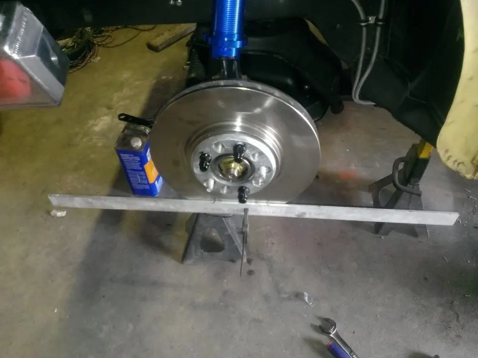

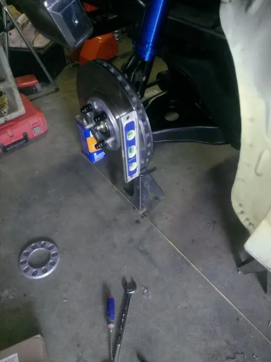

I have to get the front suspension to a point where It can be checked for bumpsteer. That means that Caster, Camber, and Toe all have to be close enough to make the whole process of the bumpsteer tuning not a waste of time. I assembled the front suspension, placed jackstands under the control arms to simulate ride height and put the rotors on. Then I pulled a string from the rear of the car, to the front, pulling it taught between two cement blocks.
Referencing the line by using the rear rotor, I finessed the thing till I got it as parallel to the body as possible. Once done, I used it to align the front rotor. Once the front rotor was aligned with the string, I set the camber to zero bubble, and pushed the strut to the rear as far as the CC plates would let me.
Then I moved the string, and clamp-U-lated these alum bars to the rotors, and set toe to 1/8" toe'd in.

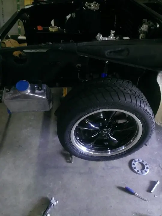

Then I put a chain between the top of the k member through the lower control arm and strapped the arm so it wouldn't drop. Removed the jack stand, bolted on my front wheel, and ran it through a turn arc to make sure it wasn't gonna rub anything. (it did)
I have to "persuade" one of my fuel lines to hug the fender well more closely, and I'm gonna have to change the fitting that comes out of the I/C to a 90 instead of a straight w/ a 90 hose end. Both small problems that are now remedied.
When I get to work on it next, I'm gonna place a 2x4 block between the lower arm, and the k member so I can put the thing on the ground and make sure that the ride height I think is right, is actually where I want it to be.

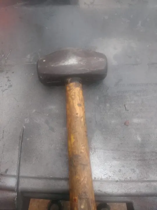

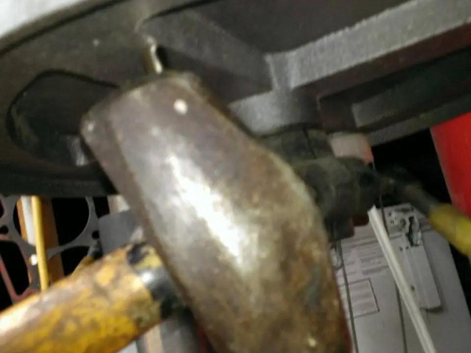

No real update other than a Ripley believe or not tidbit.
Magnet.
B.F.H.
BFH hanging from magnet.

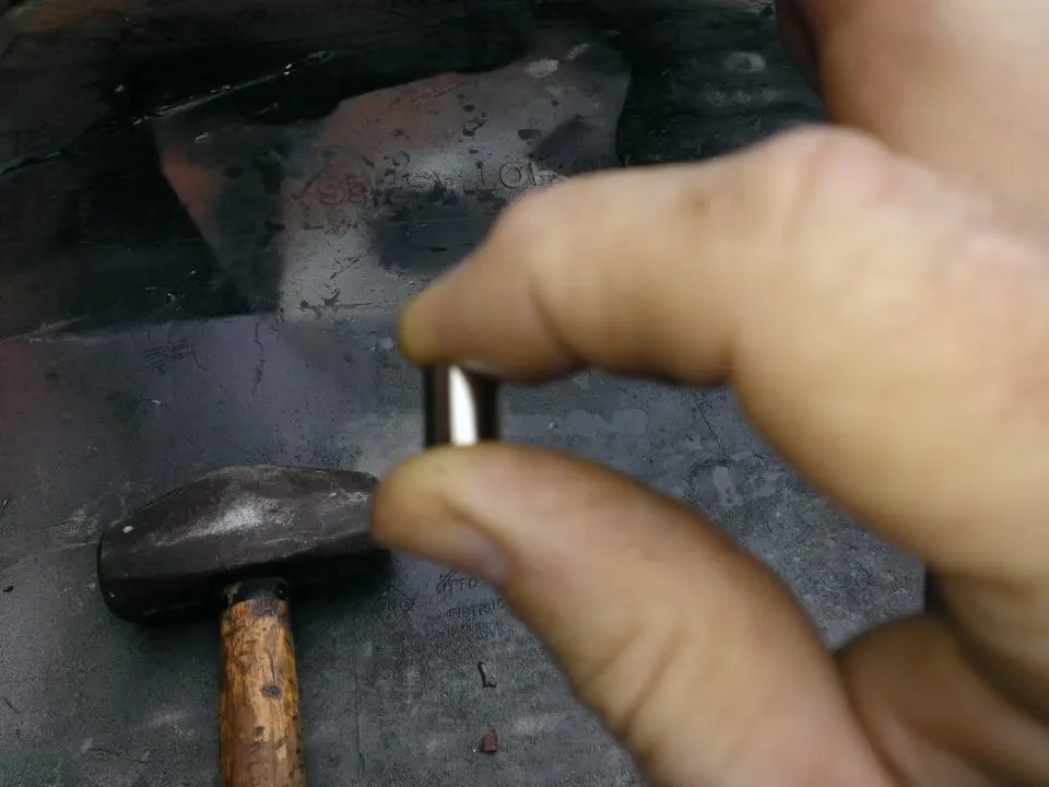

I'm placing three of these rare earth magnets in the oil pan. These things are so magnetic that prying them apart takes a seriously deliberate effort. Obviously, the intent is to stop metal from circulating through the engine, but as sticky as these things are, I believe that they'd hold a freakin' connecting rod if one was to come loose.
Just sayin.

...and where might one get one of these rare earth magnets???? o_O
Try http://www.kjmagnetics.com/categories.asp?gclid=CN_Ok8bW074CFQKhOgodNFoAjQ . I have bought several stacks of small magnets from them and got good service and prices. Check out their surplus stock since you aren't really concerned about the shape of the magnet. Personally I would choose a magnet that wasn't very thick and had a larger diameter than 1/2 in or 12 MM.
@madmike1157
Check out the magnet's temperature rating since most rare earth magnets start to lose their magnetism at temperatures above 176 ° F.
The D82SH magnet from K&J Magnetics is the one that they recommend for use in oil pans and filters ( https://www.kjmagnetics.com/proddetail.asp?prod=D82SH )
Nice avatar pic, Mike! I was picturing you more as the mad scientist X the Hulk.
The magnets are easily available on eBay in a variety of size and shapes. Would you epoxy it in place? Soldering it will overheat it and it will loose sticking power.
