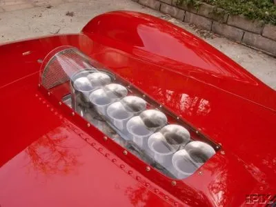

@CarMichael Angelo I, too, vote clear box of some sort. You can't cover that :poo: up and you don't want to dick around with putting on and taking off 6 air filters before and after a show.

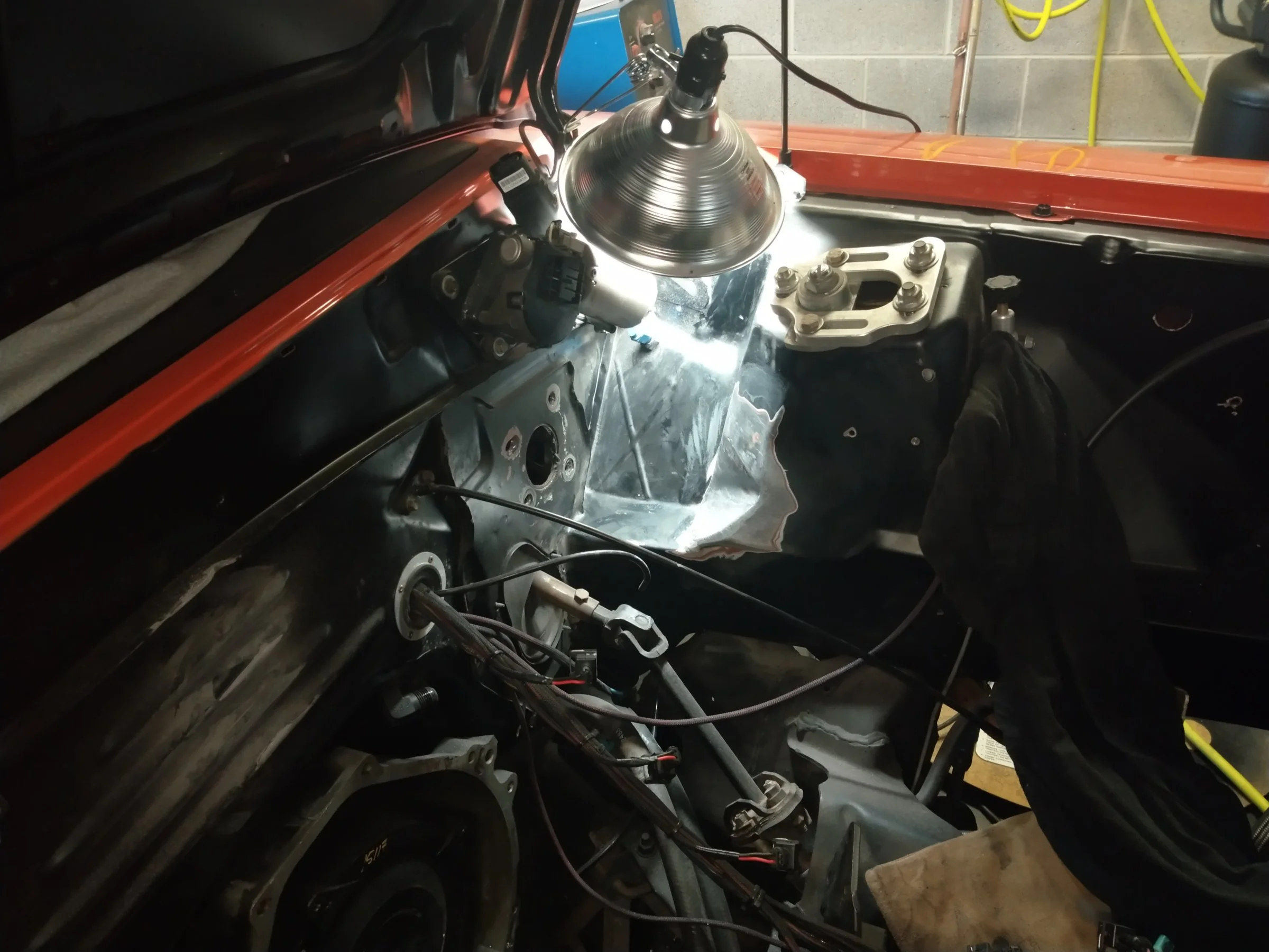

Before I can go any further with both the intake, and the exhaust...i gotta put the engine back in to check fitment.
One of the biggest obstacles is gonna be that Cobra R booster. So,..i fixed that hole that used to be under that piece of sheet metal.
It's all painted, but the paint can decided that it was gonna phck me, and clogged. That led to me being covered in paint trying to get it unclogged, and after forcing brake clean through the nozzle, which also meant I was covered in that too, all I had time left to do was spray it, and run to work.
I'll check how it looks this afternoon when I go home for lunch.

It's a thought...The whole plexi thing is more likely to not happen than otherwise. I'd rather cover the thing w/ a box that I can remove the lid off of, than to try and come up w/ some 70's looking clear box.

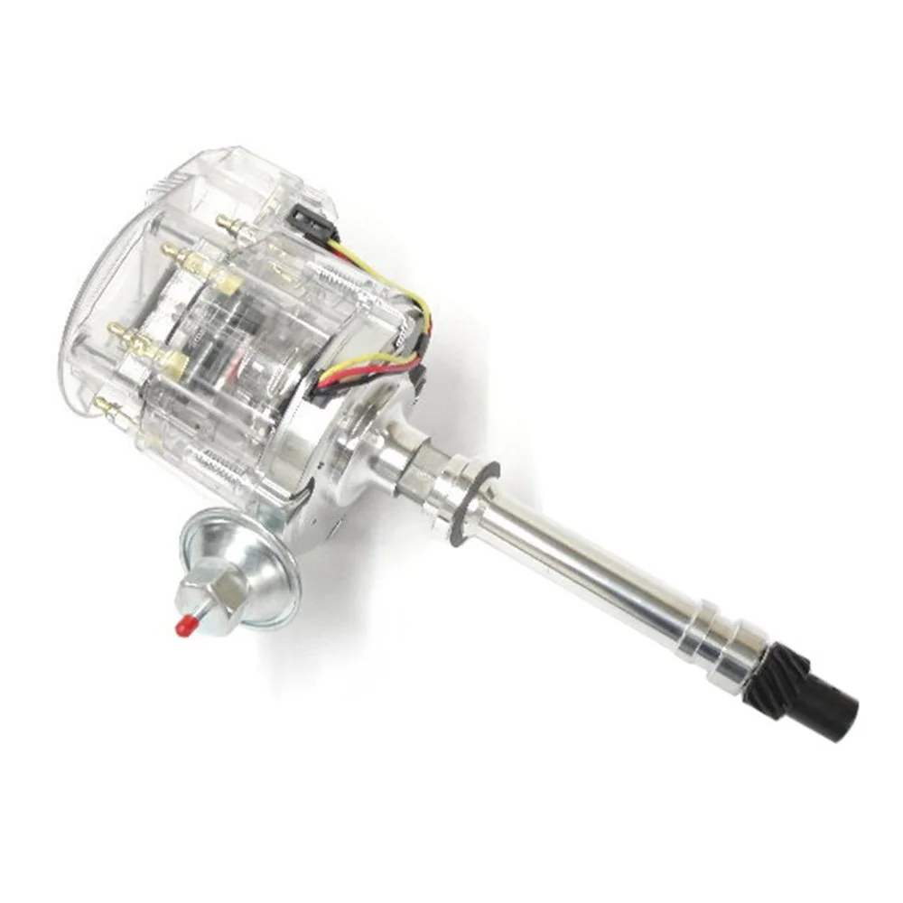

It is kind like putting all your Patriot Missles under the deck, but hey, if showing it is like a plastic Distributor cap
View: https://www.youtube.com/watch?v=OSBS-s0XxkQ
and other 70's bling, it is what it is.

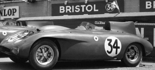

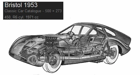

I'm guessing 1962 Ferrari GTO...

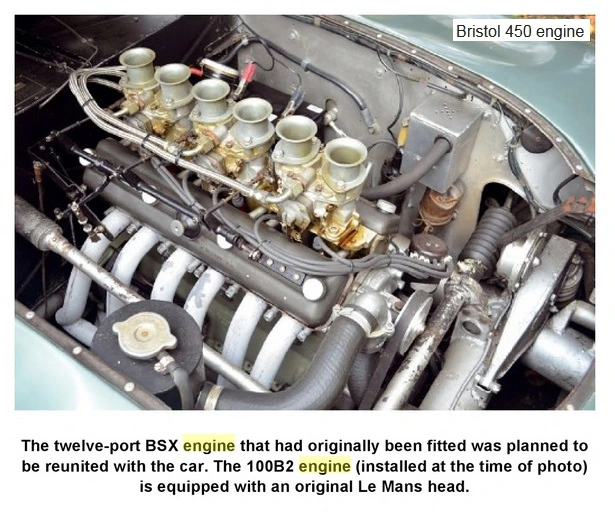

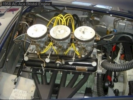

Or maybee one of Bristols BMW engined 450's might have had plexiglass covers over the triple Duece Solexs.
I know some of those BMW 328 engined cars like AC Ace's and some of the Le Mans racers had wicked High mount, upturned exhausts with wierd pipes going all over the show.

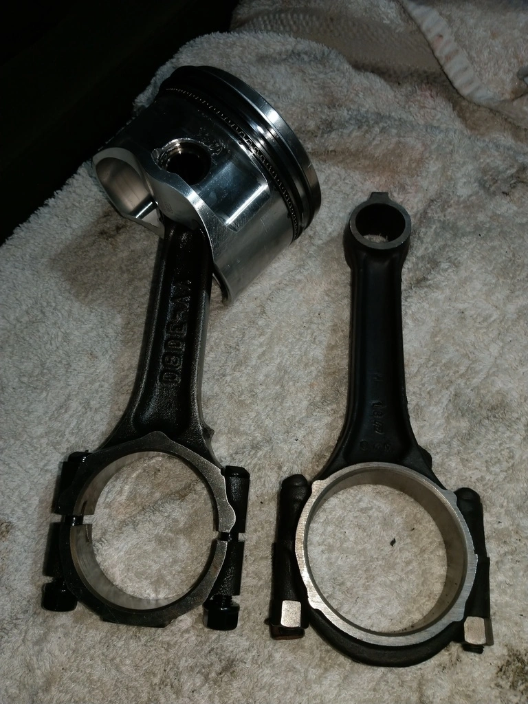

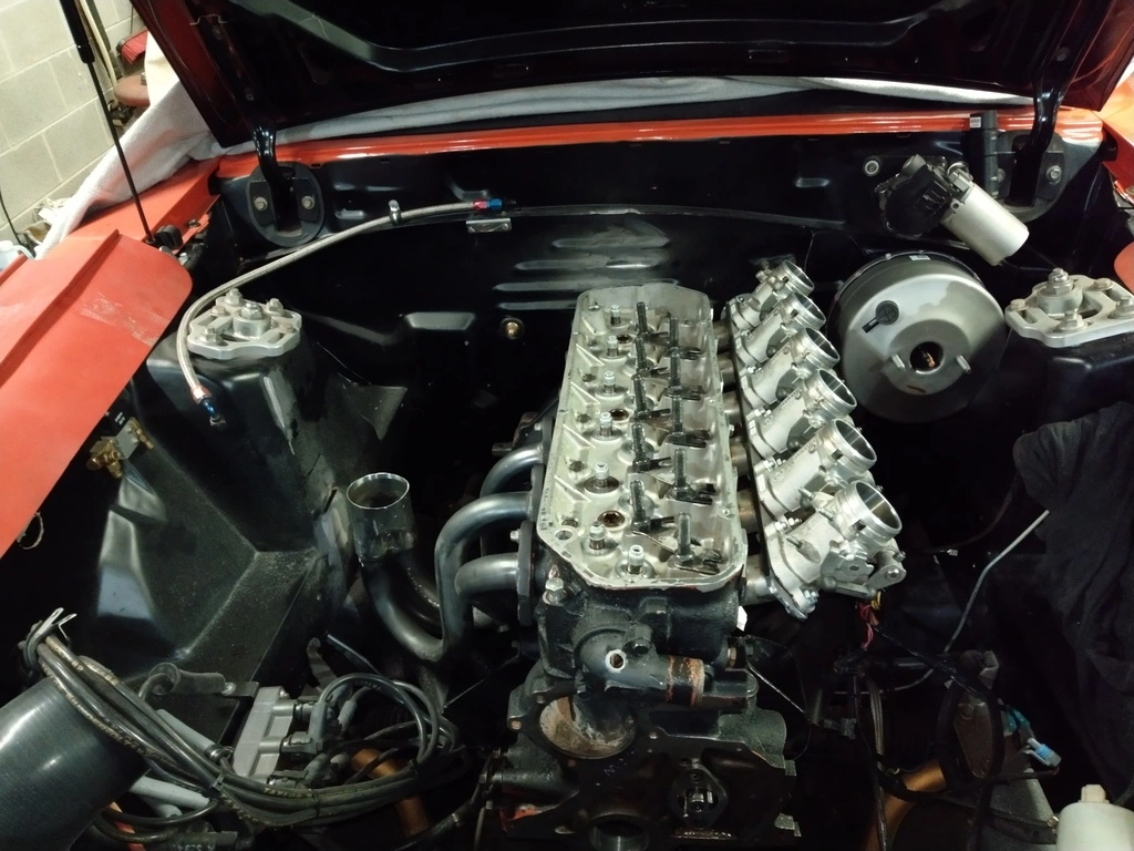

I removed the pistons...Again...... a real weird bunch of circumstances that make deciding to take the rods back out and swap them out almost......"fortuitous"
Several of the rod bearing had embedded dirt in them...Two of them significantly gouged after only turning the crank a few rotations by hand. And this is a new development. This time around, there was junk in the reassembly and the rod bearings,
(that were clean and un-marred) are now crap.
I still couldn't be happier with the decision to change out the rods though....look at the difference.
You can literally see that one is coarse, porous, and sloppy, while the other is smooth, tight, and sharp. And this is still a stock rod.
As for the rest of the objectives......Yeah,...I did all of it.

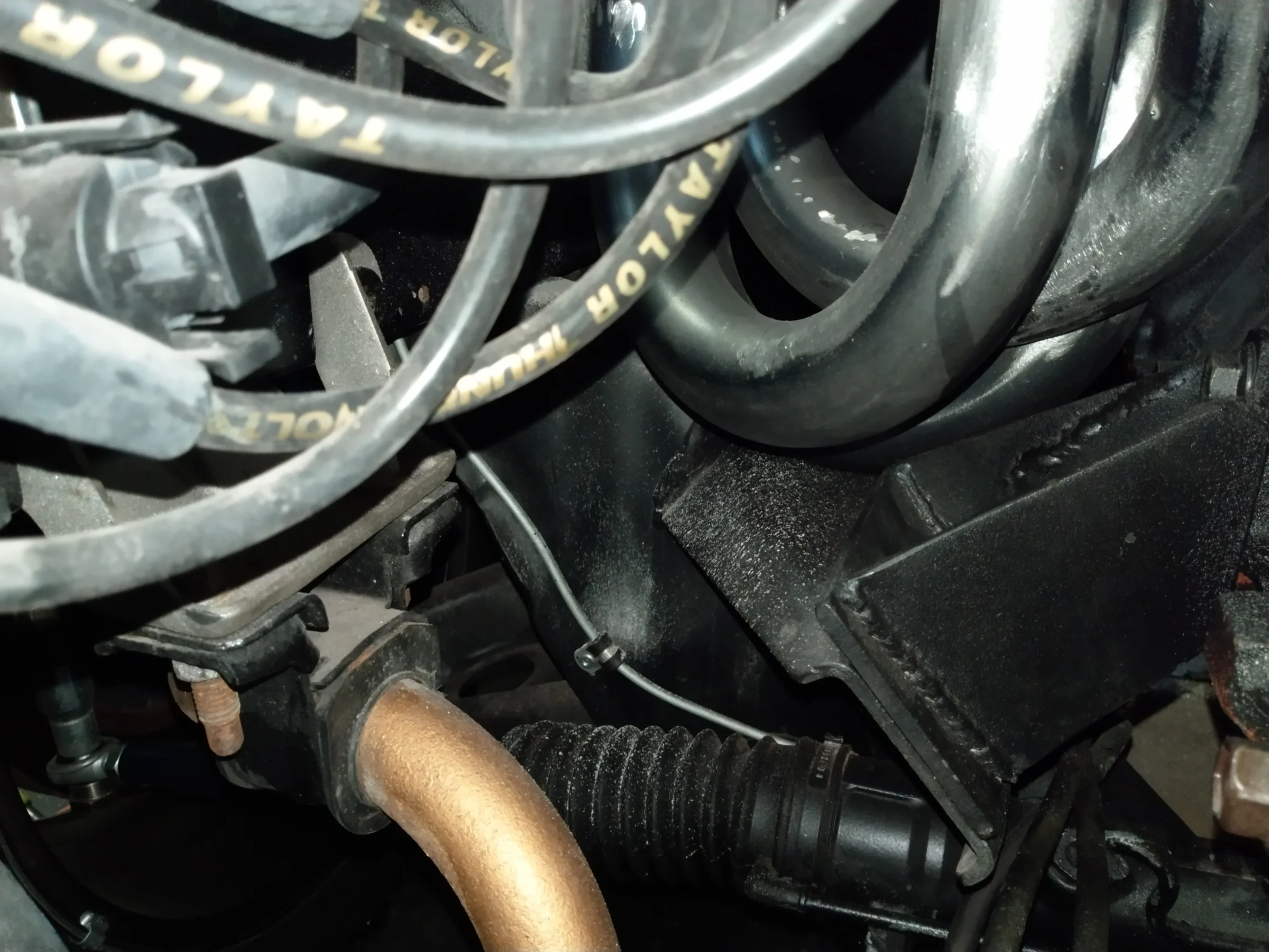

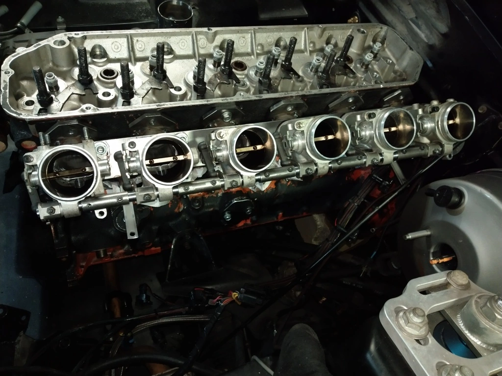

There were casualties....The fuel rail hits the booster.:nonono:
The header tube is touching the K member...Not enough to cause a fitment problem,..but it's contacting it nonetheless.
Because of the impossible camera angle, I had to use the cat to get the shot...
* Damn cat...can't get his picture to upload....probably did something wrong..
Anyway,....I've gotta big issue with the fuel rail. About the only option I have is to abandon the integral fuel rail bosses that are built into the throttle bodies, and weld in some steel bungs at a different angle underneath. That'll more than likely mean that I'll be spraying the injector upwards at the port roof...
I was so hoping that I wouldn't have to do this... The rail probably stands about a half inch too tall,...I got no option with the current install except send that booster back and get a smaller diameter unit...but the brakes..I want the good brakes too.

Yea, fuel rail v2.0
Bets on 'fuel rail v3.0'?
I was able to get the original to fit....(needed to "massage it a bit) but,..it fits.
So now I got one header tube barely touching the K member, and the fuel rail gently caressing the Power Brake booster..
It's all lovey dovey in my engine space now.

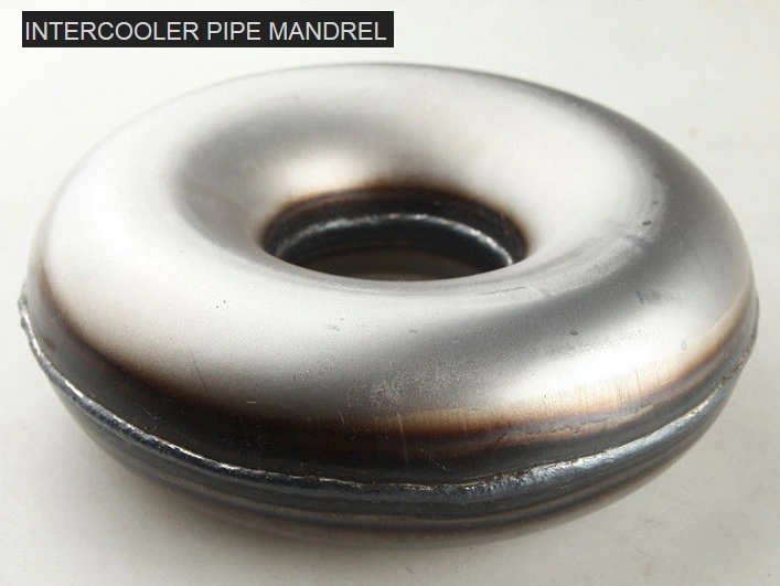

After looking at execute's supplied flow chart, one of the best port entrances I could come up with isn't a flare,..it'd be a half donut.
Now all I'd have to do is find a steel half donut that would have a 2" i.d. in the donut " hole"
Ha! Talk about a needle in the haystack....
http://lmgtfy.com/?q=Steel+2"donut
They make this thing!
Problem is...those are for mandrel bent pieces...they cost 55.00 ea.....AND......nobody who makes them has any in stock.
So.... let's modify the search,....and word it in broken engrish.....and change the way you ask for it.....
http://lmgtfy.com/?q=Intercooler+pipe+mild+steel+2"+donut
Those Chinee guys I tell ya....this thing looks like hell compared to the domestic versions,.....
But no matter,.....I'm cutting it in half right on the weld that looks like ass....And...it's half the price......And they have it in stock in a US warehouse,....And will ship it for free.....And I'll have it by the week end..
They are gonna get cut in half...3 will make 6. The O.D. of the donut is 6"...,they are gonna have to be sectioned, they will butt together...
I'm gonna have to cut them perfectly, so I'll have something similar to this.
