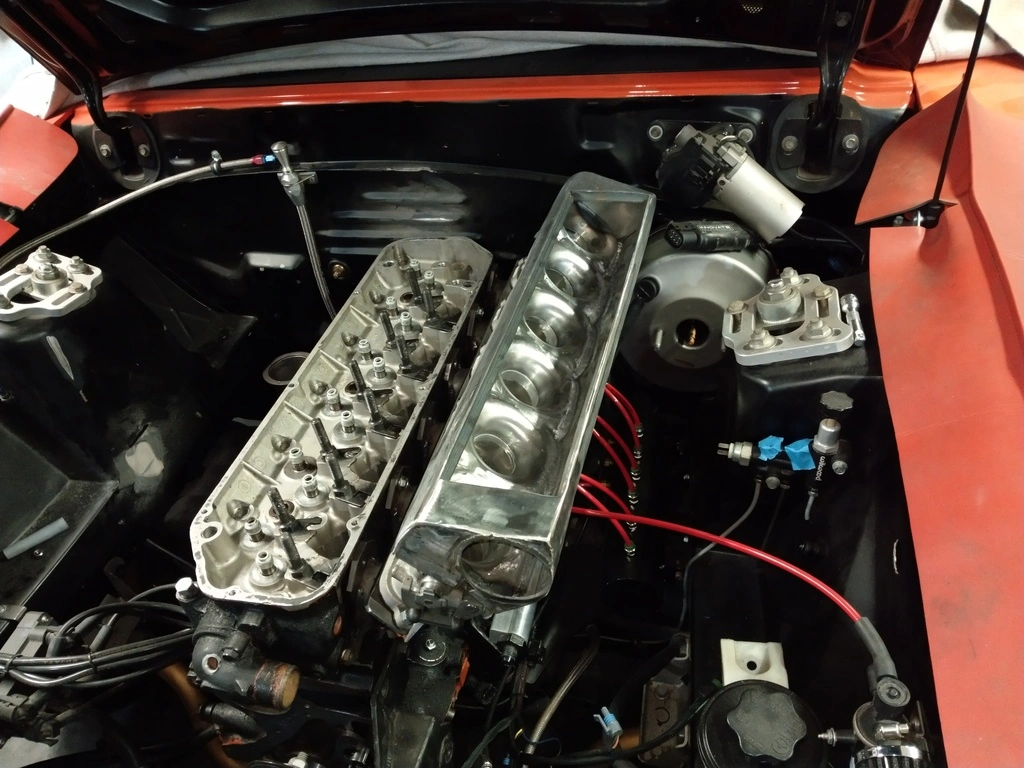

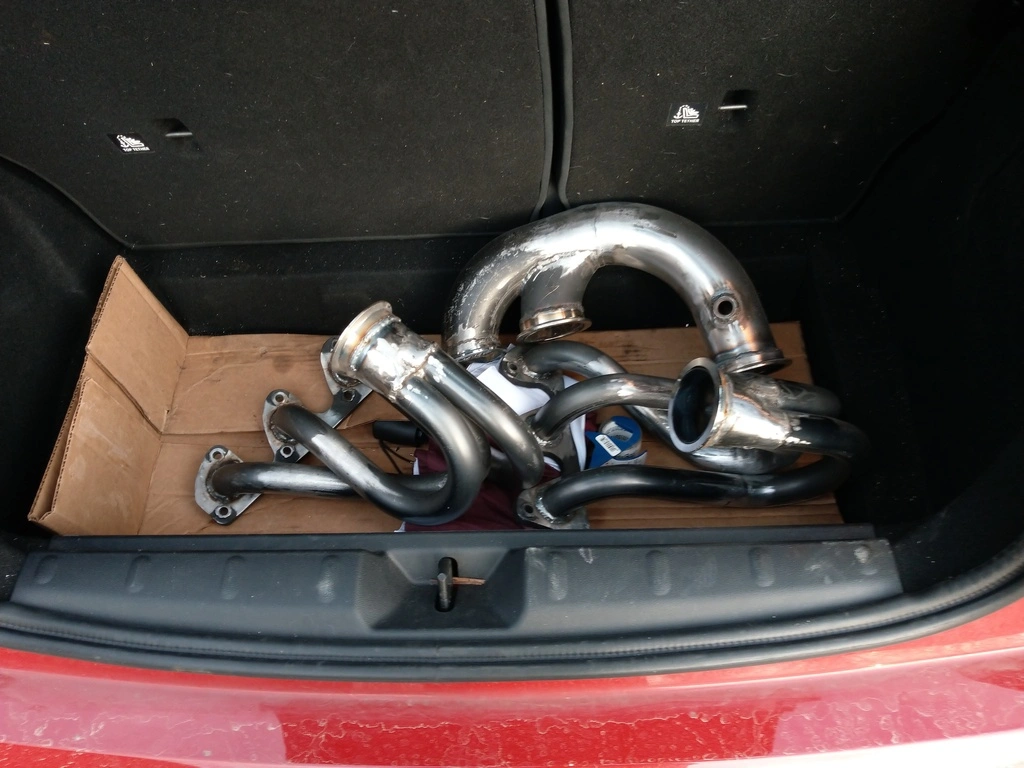

The headers are done. I'm taking them to the powder coater tomorrow.
I was also gonna take the airbox to him as well, but the thing is too wonky to be shiny
There used to be a stub sticking out of that box. It was all good until I tried to shut the hood.
No said the finger.
So for the pic, I cut the stub off. I'll have to turn it down 45* to get it to clear the hood. I decided to put a piece of glass on top. Today, I had to build the tray for that glass to sit in. Now,...with the right tools that might have not been such a bad deal...but I don't have a brake. So I go looking for a piece of 1/4" angle iron to use as a base.
They don't make a piece of 1/4 x 1/8" thick angle iron. As an alternative, I buy a piece of C channel. It's 1/8" thick, and has two 1/4" legs....but it's an inch wide.
I have to cut the thing down its length to get a true 1/4 x 1/4 piece to work with.
Problem was, as soon as I cut it, the thing bowed as a result of the 90* bend that was part of the original C channel.
In other words,..as soon as I cut it, the thing became less than straight.
So,...here's why it takes me for-fckin ever to build this thing: After I get the two sides cut, I have to straighten the bow that they have taken on after the cut. That involved clamping one of the bowed pieces to a piece of rectangular tubing to keep it straight. Then I have to weld the short sides onto that using a combo square to keep the thing at 90*. When I unclamp the long side leg, it's still bowed. So I gotta tweak it. But, since I'm putting a piece of tempered glass in this thing, it has to be straight. So I have to tweak it some more....... And some more,.........And some more.
Finally, the thing is straight. I weld the other long side to the two short sides that are welded to the tweaked long side.
That requires that I build a jig to hold that thing perfectly square at 20.750" long. I weld it.
It's twisted.
I put the thing in a vise, and twist it the opposite way to cure the twist. It takes several of these "adjustments".
I finally get the thing square, straight and un-twisted.

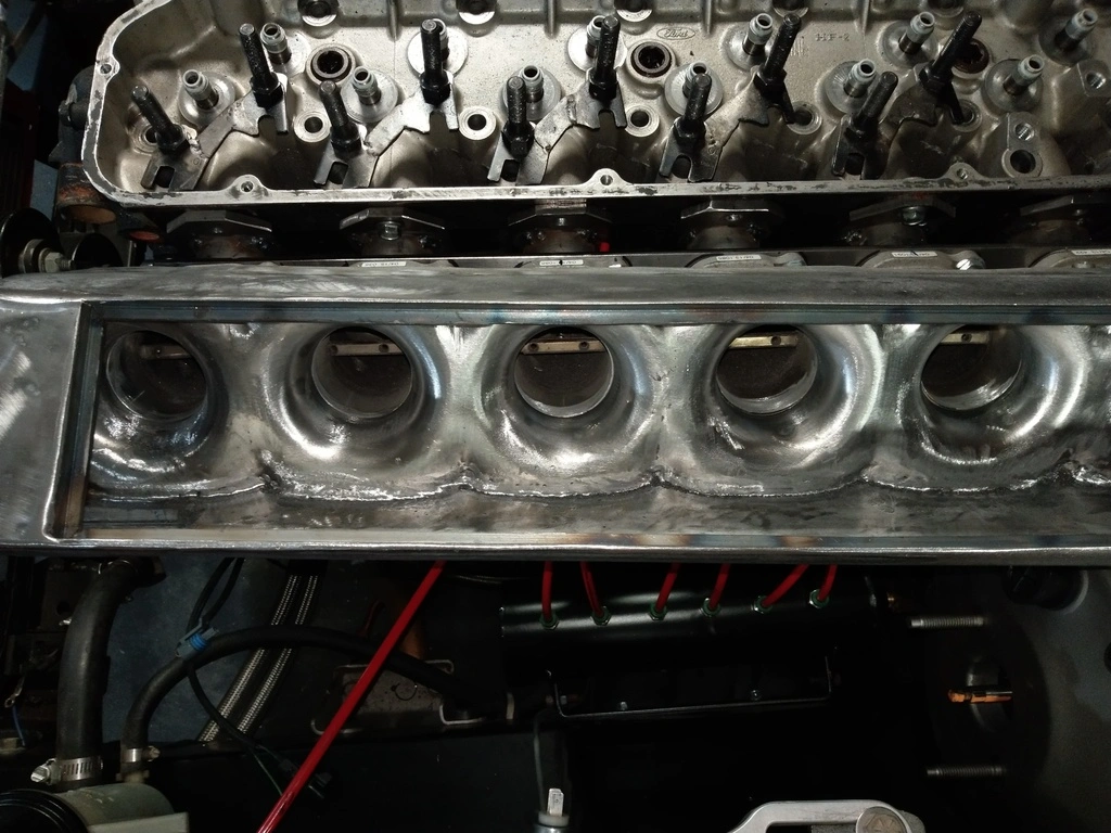

I place the rectangle in the rectangular hole I've cut into the airbox...It's gonna take some "modifications" to get it to look decent. The modifications involved welding.....alot of it.
Alot of welding requires even more grinding. Because I've decided to allow God and Country to look down into the throttle bodies, All of that welding I did along the low side of the donuts had to be ground down....It took forever. And I'm still not done.
If I have that area powder coated in some shiny silver, that will smooth that area significantly, but because I'm not, I'm just gonna have to polish the metal the hard way.
With a die grinder.
