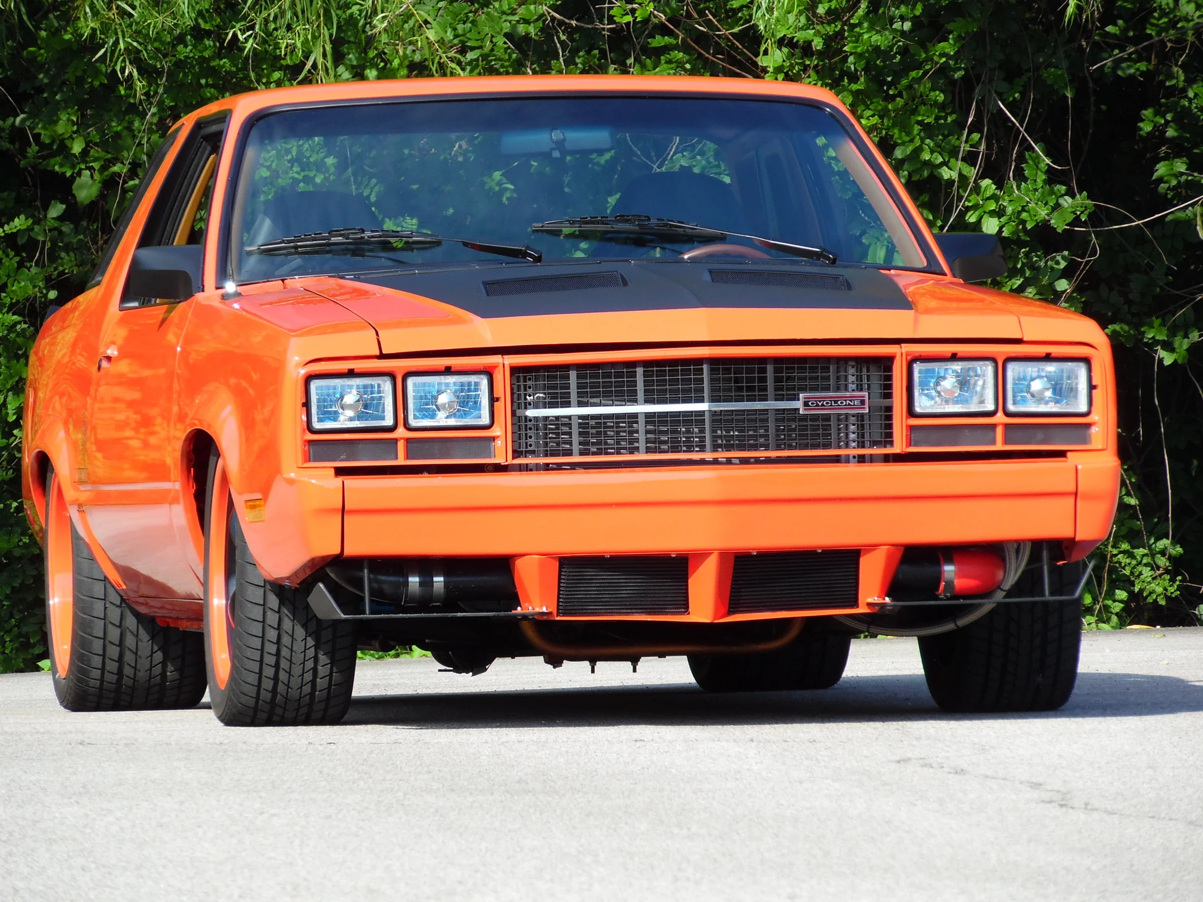

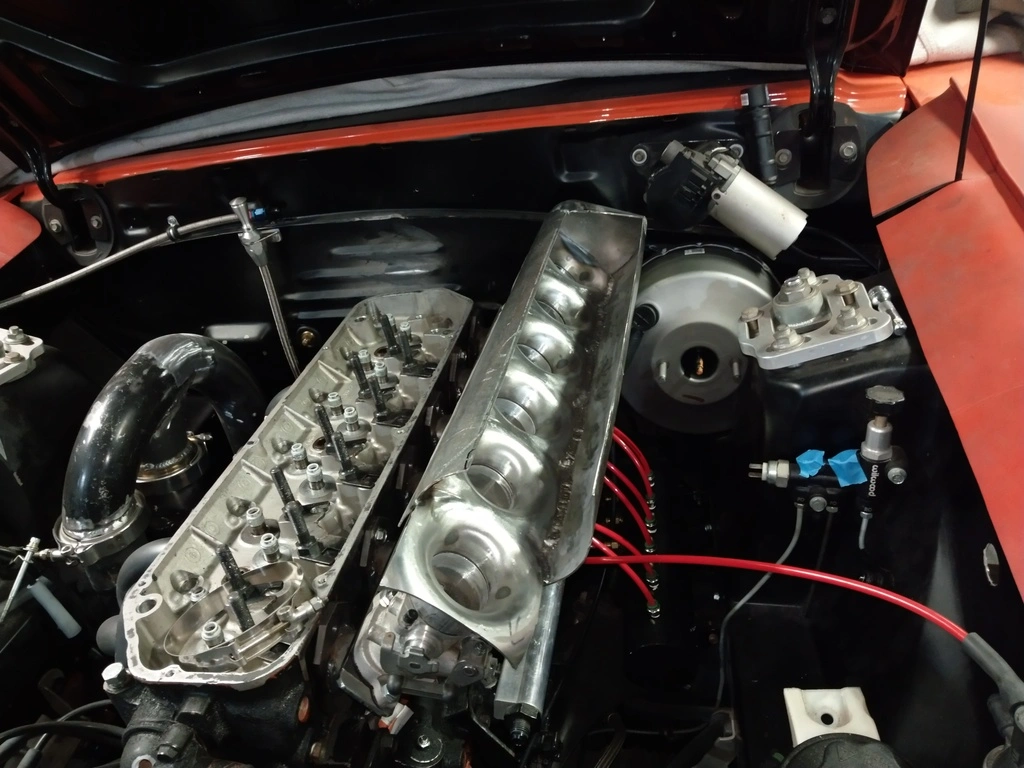

No the pic of the car like 2 or 3 pages ago where you tantalize the masses with the intercooler that's gone and big orange coupler that's gone. If you can stick a long neck between the cowl and the wiper at park position, it's a little high.
I did read the iron lung donut child labor China posts. I'm still in awe of the exhaust though! The downside up right do over is down right puuuurty! The 6 itb ready to roar are pretty cool too. As are the brass fittings against the backdrop of the red tubing.
You coordinate so well. And strangely enough, I completely understood every word of your Jameson post.
Funny you mention Nam. I was born in the 60's and my dad had already put in 20 yrs in the AF by 70. And if I take this new job, there's a chance I'll be taking a trip to Chi-Na and Nam in the next year or 2 to look at manufacturing sites. I'll tell them you said, Heeeeey.
sam_0580-jpg.585375.webp There's the pic. High wipers or not, you CMA, have done a fantastic job on that Fairmont. That's a mean look. The car has really great lines. Good job!

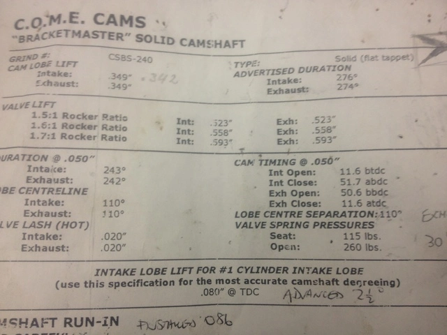

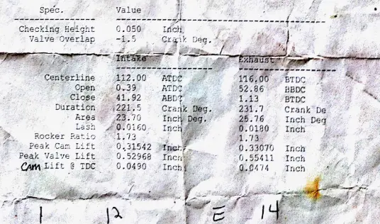

I heard back from Schneider Cams......
Unless he's talking about cam lift, He essentially wants to decrease the lift considerably, and increase the duration by about 7 degrees on both events.....
this is what I have:
He knows what I got for my combo, I included that in my initial email. But I'm confused. Look above.
.315 x 1.75 (my actual rocker ratio) = .551 (intake)
.330 x 1.75 = .577 (exhaust)
Is this guy talking about almost taking .090 off of the cam?
And speaking of my cam,....what is up with the last spec (Cam lift @ TDC)? How is it that the exhaust lift is less than the intake lift on that row, where it's more everywhere else? Or is this because it's already in some sort of overlap, and at TDC, the exhaust is already starting to open? :shrug:
I’m no cam expert, but taking an educated guess.
Looking at the exhaust closing and intake opening events and what looks like a negative overlap value, it appears both valves are closed at true zero degree TDC. The exhaust is closed before TDC (1.13 BTDC) and the intake opens after (0.39 ATDC). Added up, total time with both valves closed equals 1.52, which is on the cam card as -1.5 overlap.
So to answer your question, the cam lift at TDC must be measured at some value BTC for the exhaust value and some value ATDC for the intake. If these are both measured 10 degrees on either side of TDC, the exhaust is closer to the base circle (10 - 1.13) than the intake (10 - 0.39). Assuming symmetric lobes, this could explain why the exhaust lift is lower.
Maybe some of the cam gurus will jump in and provide their thoughts.

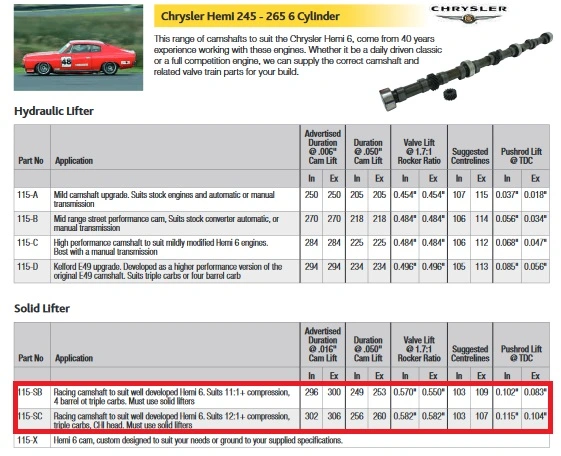

The 115-D Kelford solid lifter, flat tappet cam is a modern day E49 cam that passes the working to rule SAE cam duration rules. Its better than the orginal E49 cam. In stages, its a Stage 4 cam like a Q code Boss 302 or Shelby K code 289 310 degree or J code 302 or H code 351 aftermarket 290 cam is.
Stage 4 "https://www.kelfordcams.com/nz/camshafts/chrysler/hemi-245-265-6-cylinder/115-d-camshaft.html"
Stage 5 "https://www.kelfordcams.com/nz/camshafts/chrysler/hemi-245-265-6-cylinder/115-sb-camshaft.html"
Stage 6 "https://www.kelfordcams.com/nz/camshafts/chrysler/hemi-245-265-6-cylinder/115-sc-camshaft.html"
Stage 7 "https://www.kelfordcams.com/nz/camshafts/chrysler/hemi-245-265-6-cylinder/115-x-custom-camshaft.html"

I don't think he has a clue what is really the intended usage of the engine. I don't think he even remotely knows what my expected goals are for power. I don't think he knows that the current cam makes over 19" of vacuum at idle. I don't think he has an inkling what the Monster is all about.
I don't think he remembers that I talked to him years ago, and he recommended that I run the cam at 110.5*
https://www.stangnet.com/mustang-fo...ted-going-forward.871263/page-37#post-8837253
I think that if he knows anything, he thinks that I have a Aussie speed intake bolted on the the side of the head w/ a 600 CFM vacuum secondary Holley four bbl sitting on top.
Not 6 ITB's from a BMW M3.
I'm gonna call the guy tomorrow and follow up with him to see what he thinks after I fill him in with all of the true objective dealios.
(besides,..I wanna learn how he justifies scrubbing off 70-80 thousandths of valve lift when the objective w/ a roller cam is to make as much power as possible.)

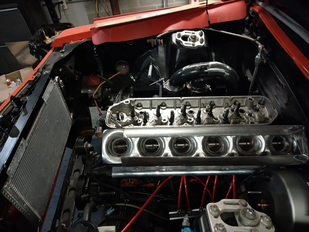

I am making good progress on the intake box,...I hope to have the thing to at least a rough completion stage tomorrow night. I have everything I need to do that,......Except time.

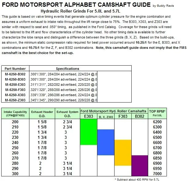

A traditional Cobra Jet or Torino 73 351 Marine cam was what the 5.0 GT's and the non Saleen SVT R351 1994 Mustang used....split lobe cams were Fords total solution to getting cars to make low end torque. The culmination of them was the Deadly Letter Roller Cams, the
Ford via SVO Motorsport, supplied , eventually, about Seven Deadly aftermarket 303-style letter cams (now known as
A311,
A312,
E303,
B303,
F303,
X303
and Z303 as non dealer fitted items,
These are effectively Cobra Jet or SuperCobra Jet style roller cam remasters of the best hydraulic "335", Windsor and Boss 302/351 cams from the 70's. These got swapped into 5.0 HO's on a fairly regular basis.....An X 303 with 1.7 rockers makes 577 thou lift, a Z 303 587 thou......
A six cylinder non turbo cam that works on a 250 long stroke six lookes a lot like an aftermarket Jaguar XJ-6 camshat spec.
One that came close to working, but are still a little too mild are the reverse pattern 279/269 at lash items for the Triple Weber DCOE 45 cams,.https://www.terrysjag.com/product/TJP81.html
None of Dean Tighes cams go that high, but the 4.2 is rev limited by stroke and immense crank and rod weight
https://tighecams.com.au/cars.htm
Schneiders cam is pretty much like the TJP81, but its got more exhaust duration, and it over scavenges.Intake mix ends up right out the exhaust.
And its gonna HAVE to be way more radical than the wilder Ford 5.0 and 5.8 Windsor OHV letter cams.
Here is a smattering of the 10 most Revolutionary Roller and Solid cams for post 1986 Port Fuelie 5.0and 5.8's.
50 thou figures show a lot more on what was going on.
Stock 85-90 cam is 204°/204° at 50 thou 444 in. 444 ex thou lift ( Version 1 and Version 2 again, Roller cam)
Overall Roller cam Production figures are effectively four types, revised four times:
85-88 5.0: E5ZE-6250-AA 266°/266° at lash 444/444 thou lift (Version 1)..................................................1st
89-90 5.0 : E8ZE-6250-CA 276°/266° at lash 444/444 thou lift (Version 2)................................................2nd
91-93 5.0: F1ZE-6250-AA 276°/266° at lash 444/444 thou lift (Version 2)
93 Cobra 5.0: F3ZE-6250-CA 270°/270° at lash 479/479 thou lift with 1.7 rocker arm ratio (Version 3)...3rd
94 Cobra 5.0: F1ZE-6250-AA 276°/266° at lash 444/444 thou (Version 2)
95 Cobra 5.0: F4ZE-6250-DA 276°/266° at lash 444/444 thou lift (Version 2)
96-01 Explorer 5.0:F4TE-6250-BA 256°/266°at lash 422/448 thou lift (Version 4)....................................4th
A-cam (Ist flat tappet hyd ) is 204°/214° at 50 thou 448 in. 472 ex...............Deadly Letter A'.....................5th
A-cam (2ndflat tappet hyd ) is 204°/214° at 50 thou 472 in. 496 ex..............Deadly Letter A''....................6th
E-cam is 220°/220° at 50 thou 498 in. 498 ex thou lift..................................Deadly Letter E.....................7th
B-cam is 224°/224° at 50 thou 480 in. 480 ex thou lift..................................Deadly Letter B......................9th
F-cam is 226°/226° at 50 thou 512 in. 512 ex thou lift..................................Deadly Letter F......................10th
X-cam is 224°/224° at 50 thou 542 in. 542 ex thou lift..................................Deadly Letter X.....................11th
Z-cam is 228°/228° at 50 thou 552 in. 552 ex thou lift..................................Deadly Letter Z......................12th
Cam operation speed for a 331 would be 200 rpm above the right hand column. You add a bit more lift with your 1.73 to 1.75 ratio rockers, then you rip off two cylinders, and end up with just 250 horsepower. Smaller engines do haul a lot harder, but thats my summary.
These wilder cams are a bare minimum to make 265 rwhp in a manual Mustang stroker EFi.
A Kelford style Stage 5 to 6 cam is what you need, and on a wider lobe.

See,....here's where you lose me.
What does any other brand, or any other engine other than a Ford 250 I-6 have to do with this discussion?:shrug:
In the end, if I don't feel like somebody can take what I have, and make it work better in the new combination, I'll leave the one that's in the engine alone. It just makes sense to me that at 114, my cam CL is entirely too lazy to make good power when it has to coordinate making power with the confines of a naturally aspirated engine.

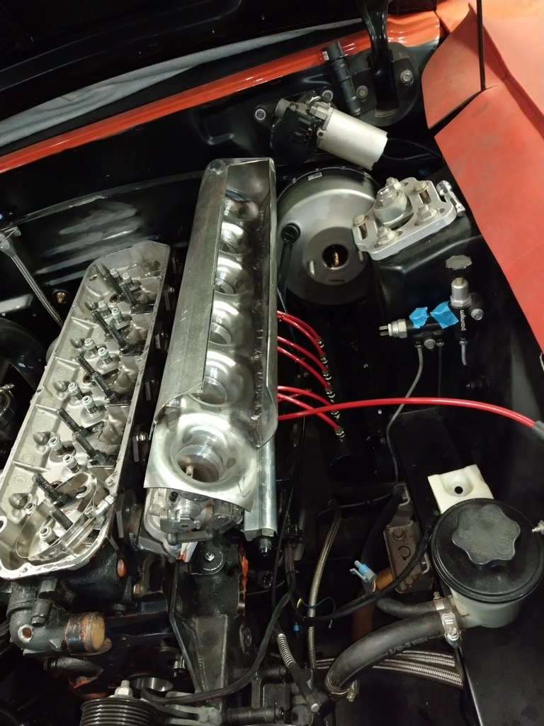

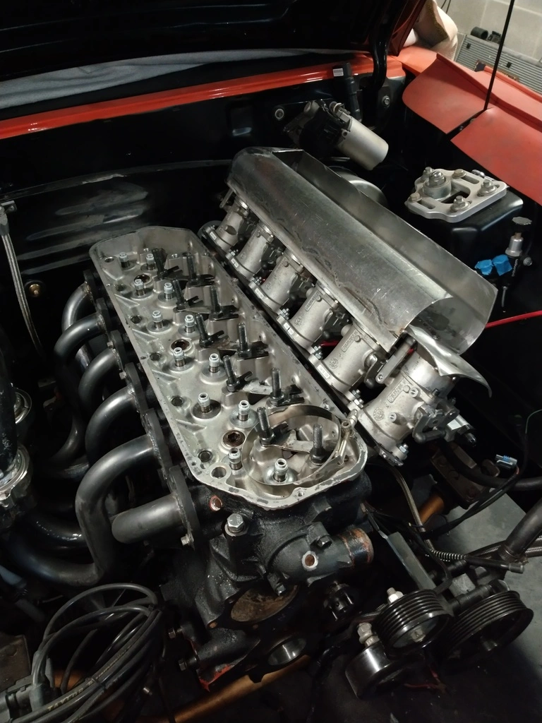

Man am I clueless when it comes to what I can and can't do based on the time it takes to do it. I cannot imagine having to work on a job clock like a mechanic does,...I'd freakin' starve.
I woulda swore that I was gonna be able to get the entire air box built, and was even thinkin that I could get the CAI mocked up as well.
Like I said,.......clueless.
This is all the farther that I am on the thing.
Because I'm stupid, I cut the thing short thinking that the ends would be different, but It's just one more thing that I get to do twice. Now I'll have to add a piece and there'll probably be a visible seam. I was thinking that I'd have some sort of 3" exhaust elbow merged on the lower end, and alot of that would just be sectioned in, but after looking at it, think maybe I'll just put a 3" stub straight out the end, and use the 90 degree couplers that I have laying around from the turbo stuff.
After looking at it initially I decided that I should open up the top more, so I cut another inch off along the short end.
This looking down at the donuts before I cut the extra inch off.
Now I know what you're thinkin.....You're thinkin that I'm leaving that center space open for some future piece of acrylic to show off the TB's.
Wrongo.
The Donuts look far too rough to display them,...and for what ever reason, I welded the low side from the inside, instead of from underneath,..and the fitment required that I weld the piss out of it. Needless to say,.it looks like ass on a plate.
The reason for the center cut out is so that the steel top will be flat. On the same plane as top of the valvecover. I'll do a similar raised rib like I did on the old intake...
All in all I'm very happy with the way it looks...but I sure hope all of this sht works.
Dont hate me for saying it, but it seems you are damn near covering the ITBs completely. Once you put your valve cover on, you wont really be able to see them...
I don't hate you regardless of what you think.
The side view of the TB's leaves alot of those things exposed. They'll stand well above the top of the valve cover.
There is nothing else short of velocity stacks, or those little K&N individual filters that will truly keep the feel of the ITB's intact.
The airbox will probably run far nicer than the individual filters would because each TB will share each others pulses. The good thing is however, The air box is removeable. Two bolts and the thing is off. So,...depending on how it runs with the thing all sealed up, I may swap out the individual filters as an option.
But im quite confident that it's gonna be good. And I think it'll be the only thing that I run on this change up.

Ball three. On the basis of other engines, the cam is a fail. Mopar Hemis just aren't like canted valve Clevelands or Lima 429's in those engines abilty to savagely become wild on the idle and have a big 2800 rpm hump in the torque delivery curve. The Hemi 6 Pack is a very, very noisey engine, but its essenally tappet and timning chain and starter and induction roar. Once filtered out, its a very steady and tame idling engine that just beggs for more duration and 50 thou lift like the 115SB and115 SC cams... just the same a Jason S's old roller cam for his 4-bbl 365 hp engine. Strike three. OUT.
Jason Stoddards Cyco_250 six for a time had 45 mm R32 syline GTR throttle bodies, a gift for a time from a very smart EFi tuner who teamed up with Jason.
Speedflow fuel rail ends and 550 cc/min injectors, Motec lambda and temp sensors, Corse EFi computer
Internally, it wasn't changed from what it was like when it was thrown together in the late Noughtees....it still runs the old Ivan Tighe solid Roller cam with 256 deg @ 50 thou inlet, 265 deg @ 50 thou exhaust with 107 lobe separation.
This lost a few hp from his 650 cfm 4-bbl, but with EFi and this cam, it made 250 rwhp with 4-bbl and C4 auto, and with less hp from EFi, made his 2701 pound TF Cortina 250 EFI X-Flow do 11.59 second 1/4 miles @ 114.60mph. 6200 rpm rev limit.
Reverse tested based on a 50% power loss, its flywheel hp is
345.5hp @ 6100 rpm
333.3 lb-ft @ 4700 on California Texaco Vortex 98
353.0 hp @ 6100 rpm
336.7 lb-ft @ 4700 on Sucrogen E85
Aspirations index, 4320. (253*6100)/353 hp. Bang on DJR 320 with 429 hp 5.4 quad cam territory.
A ball bustin' bad b@$+@rd Six
The 2007 build Tighe cam wasn't designed for an ITB from a Nissan Skyline GTR twin turbo, it was for a stock exhaust 4-bbl that needed to make 350 flywheel horsepower. So the lobe center and extra exhasut duration won't be helping to keep the fuel air mix flowing the right direction.
Ford use the same kind of ideas. Adding a V8 style cam like Schnedier is suggesting will strangle the arse out of your 250 X-flow. To say I'm a little disapointed is an understatment.
Everything about that cam recomendation is wrong for an ITB I6 with EFi.
All fine aspiration fuel delivery systems hate narrow lobe center cams, and all X-flow sixes hate over scavanging extra duration exhaust profiles. Nothing, NOTHING in the recomendation gells with me. I quickly took you through the A to Z of Ford roller cams. They work fine for a restricted intake EFi 302 Windsor, but anything like them in 50 thou lift or at lash duration won't make anymore than 250 horsepower. As a V8, they don't break the 300 rwhp mark at all untill you go MUCH wilder.
I don't even think a narrow lobe will help make an ITB give better torque and streetable power....it'll F it up the A with a knock off Anderson N41 verses TFS Stage II hybrid....with next to no lift.
