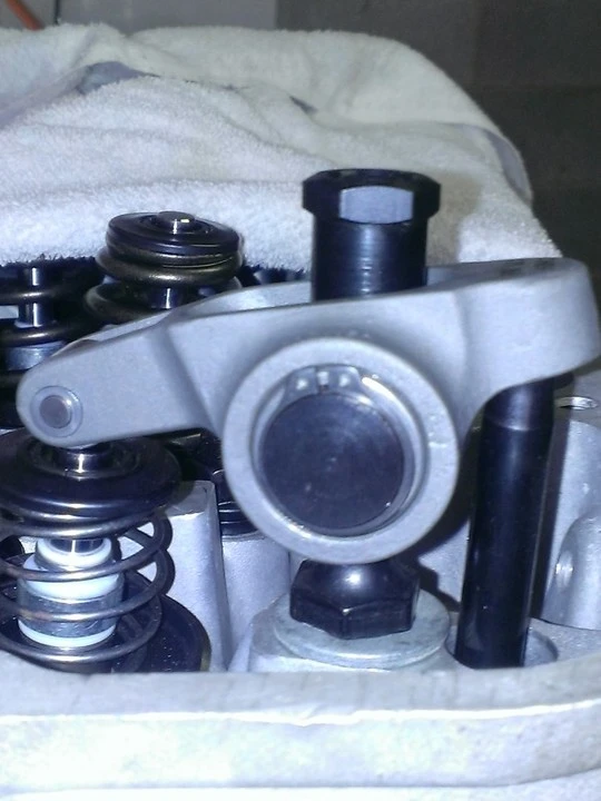

So it begins. Using a 5/16 adjustable pushrod set at 9.750 and zero lash, lets see what happens at max lift........
What do you thinks gonna happen?
Boom!!!

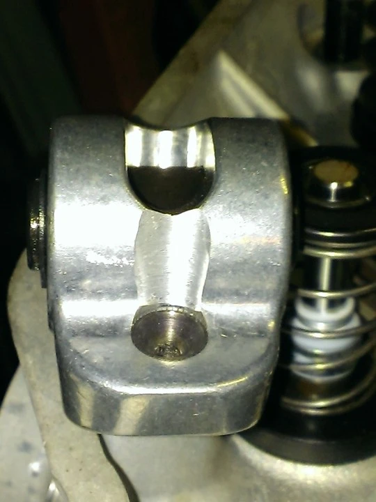

And this is the exhaust valve. You don't even want to see the intake, which is canted backwards, opposite of this shot.
I have already ground the pis s outta the back of the rockers (matter of fact, those "dust specs" you see all over everything is aluminum, I'm so gonna have to tear the entire engine back down, and re clean everything and put it back together. That is of course if I can overcome this latest boulder that fell in front of me.)
I have no idea just how much I can continue to grind on these things. All I know is that as much as I have removed,..they finally clear the 5/16 test push rod.
But,
I have to use 3/8" pushrods,.......an additional .070 (.035 on each side) that I'll have to clearance.

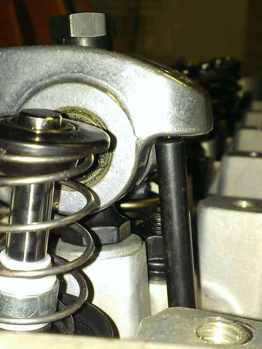

Well I think I've figured out the solution for the rocker arm collision dilemma. As usual, it means spending more money, going from the most inexpensive 1.73 ratio roller rocker, to the most expensive 1.75 ratio roller rocker.
Witness my solution:
Svelte, streamlined, lightweight stainless steel'
VS
Portly, bulky, investment cast aluminum.
The price jumps from 166.00 for set of 16, to 383.00 for 12, but if it means that everything will clear, then...........................
Ya gotta do what you gotta do.

The rocker dilemma will be solved by using the Crower rockers.
It just won't be solved using "these" Crower rockers.
Absolutely zero contact using the big assed 3/8" pushroods that I ordered based on information gained from the last set of tests.

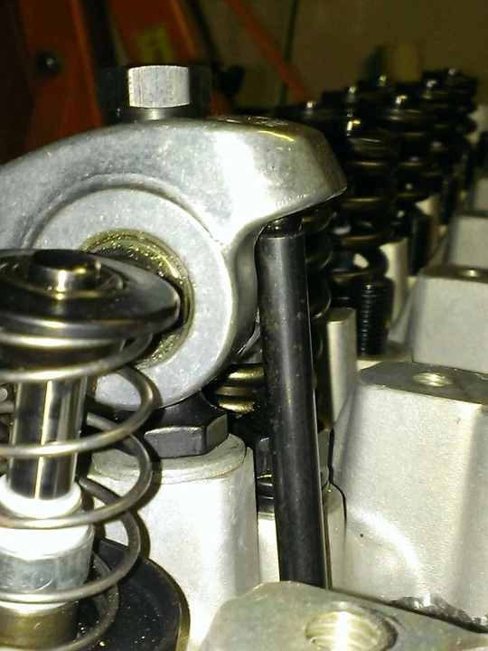

Now that I have 9.750" long pushrods, and 1.75 ratio Crower rockers, It's all wrong.
The roller tip of the rocker looks like it travels too far from one end of the valve tip to the other. I removed the pushrod, and re-installed the adjustable unit, and no matter what I did, I could not make the rocker contain its' travel to a decent margin on top of the valve.
I think that the 1.75 ratio is just too much for this setup. I'm thinkin that it should be more like 1.7 instead.
I'm gonna call Crower tech, and talk w/ them tomorrow, but to me it looks like I'll be boxing up all of this junk, and sending it back to summit (again) for an exchange.

Spoke to Crower this morning. Turns out that not all rockers are created equal. There is a significant difference between a BBC 1.7 vs a BBF/351C 1.73 rocker based on length from the stud to the tip of the valve. The Crower 1.75 Chevy rocker was waay too long, and would've never worked, so they are going back in favor of the Ford specific ratio rockers.
