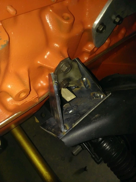

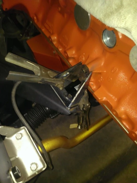

My last update that dealt w/ the motor mounts stated that I intended to build my own solid mounts, so that is what I ended up doing for the whole of the day.
Then I removed them and welded the p iss outta them. Painted them black, and put them where they belong.

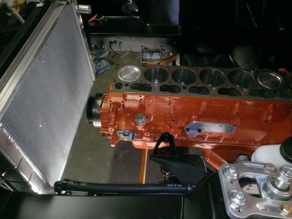

Behold the Monster. 30.75 wide, 19.625 high, 3.0" thick.
I was hoping that there'd be enough clearance between it and that black crank pulley to allow the shroud, and a cooling fan to fit between.
It looks like there'll just be enough.

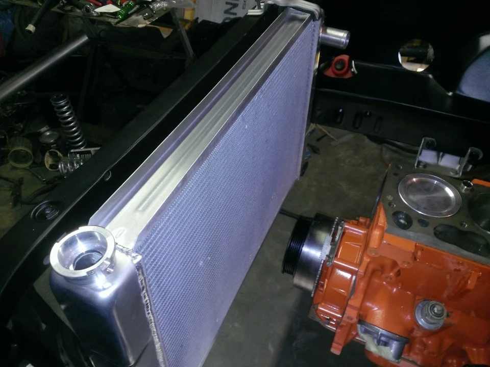

One of the motivators to install the engine was I just kept knocking the damn radiator over.
Onto a 1 gallon can of reducer.
I did'nt think much of it until I looked more closely.
This is on BOTH sides of the radiator. While building the lower saddle I tipped the thing over accidentally, and didn't think much of it. I swapped the radiator over to the other side the next time I handled it, and damned if it didn't tip over onto the can a second time on the opposite side.
I'm telling you,..if this bitch is hurt because it TIPPED over,....I'm gonna be so pi ssed you'll hear me yell 1000 miles away.

The engine is in, (permanently) I know that the radiator, the shroud, and the fan will clear.

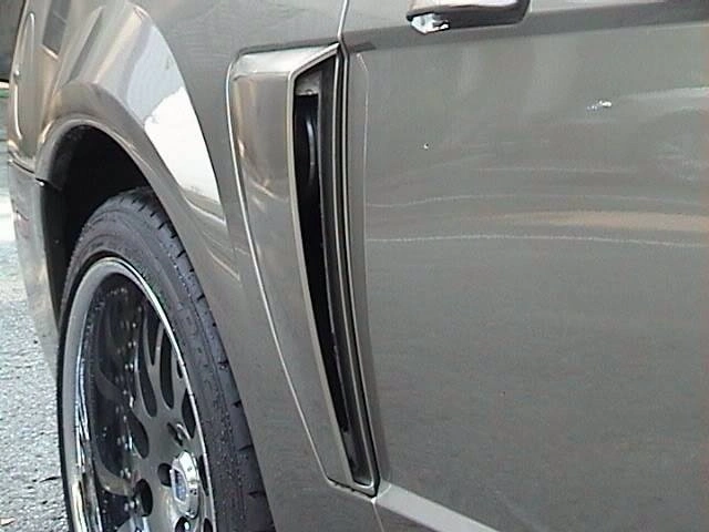

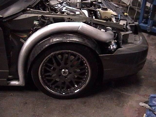

If there weren't ICs already taking up that area this seems right up your alley
I'd like to see what they did on the interior to cover up that turbo for safety.

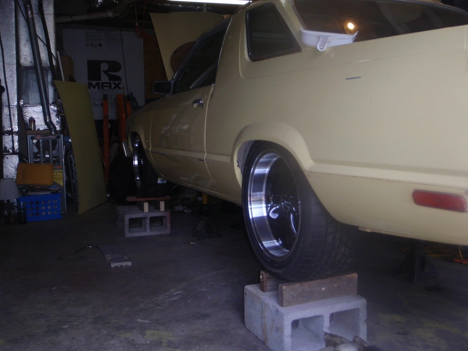

But,.....in case you didn't see (or look at) the last time the whole car was in a pic,...I dug this one up for ya.
back when there was no mountain of parts, and pieces to trip over, step on, or have to move just to walk around in the garage. Back when the only thing in that garage was the car, and the 4 new tires.
That hot side running right on top of the tire probably makes for some pretty hot rubber sitting in traffic I'd guess. That Turbo sitting inside the car also makes for some pretty hot passengers as well.
At least The radiators are gonna be isolated to the trunk, separated by a 1/2" thick piece of MDF.

A stock radiator is about 18.625 high. The summit piece is an inch taller. A stock radiator measures somewhere in the 27.75" wide range. The Summit piece is 30.750"
What that meant to me was either I was gonna have to modify the saddle to make it fit, or buy one that did.
( I'm too cheap to buy one that fits,...I'd rather spend a day making one that doesn't fit,......fit.)
That required pretty major surgery to the perfect lower radiator saddle, and had me fabricating mounts to sit each side tank in, as opposed to the way Ford does it. When I'm done,...I sit the radiator in the new lowered saddle and it's way off. One end had to have the mount ground back off, and moved back away from the saddle 3/8" to make it fit.
Now how the hell did I make a measurement mistake equivalent to almost 1/2"?
I modified the passenger side of the saddle, and instead of welding the mount back, I riveted it instead. (in case I was still off) But I wasn't. The thing sat where, and how it was supposed to for the pics I took last night.
Today I'm putting the shroud on it for real, (instead of just taking measurements to determine clearances.) I got the radiator laying on the bench and the b itch wobbles.
The core is tweaked.
Instead of my measurements for the mounts being wrong, the actual radiator is twisted big as s hit.
I call Summit.
They don't care about the two creases I put in the radiator, dude says the twisted core trumps the damage I did, effectively making that radiator DOA outta the box.
