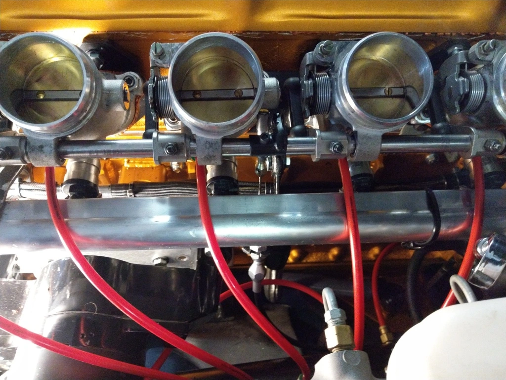

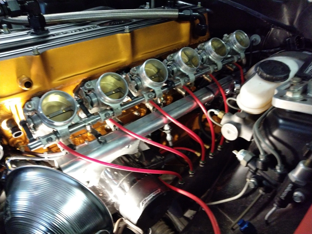

I'll bet some of you are wondering.......
Wonder if he was able to figure out the throttle thing yet?
Nope.
Well, maybe. I got nothing to show except a drying painted bracket. This will make it V5.0.
The cable running under and over pullies added drag. That drag wouldn't allow the throttle blades to close if you lifted off of the pedal at part throttle. They'd snap shut if you lifted at full throttle, because at WOT, the spring pressure was sufficient to close them.
At anything less than that........not so much.
So I completely bailed on that plan, and have since moved to a bracket that will attach the throttle cable directly to the shaft.
No pullies.
No cable routing over the river and through the woods.
Does it work?
I don't freakin know.
All I know is that it is a sonofabtch to get to. And if it does work, I ain't taking it back apart to paint it.
So I painted it first.
I'll put the whole thing together, and bolt it in there and THEN I'll check it.
Hopefully it does.
It's killing me that's for sure. The precious little time that I used to dog people for trading away to a shop has now reared it's head full circle. I almost have to force myself to go down there to work on this thing. The 50+ hour work week, and my status as a metal knee'd crotchedy have become one big plate of "I could give a fck" when it comes to deciding whether or not to give up an hour in the morning, or an hour at the end of the day to mess with it.
I have this new bracket fabbed, welded, smoothed, and now painted, waiting on tomorrow to bolt it in. The top of my right arm looks like the cat used it as a scratching post,.....everytime I test fit the thing, A cut off wire tie would gouge the sht out of me. I had no Idea that I was tearing my arm up so bad until today when a co-worker asked me what happened to it.
What's happening is that I'm getting bitten.........Repeatedly,.............By a Gila Monster.
I feel faint.
Reactions: General karthief and RaggedGT

Ok....................
This is one of my classic "One step forward, two steps back" updates.
What you see is a successful solution to the mind numbing ordeal trying to get the throttle cable thing solved. This works really well...................... Finally.

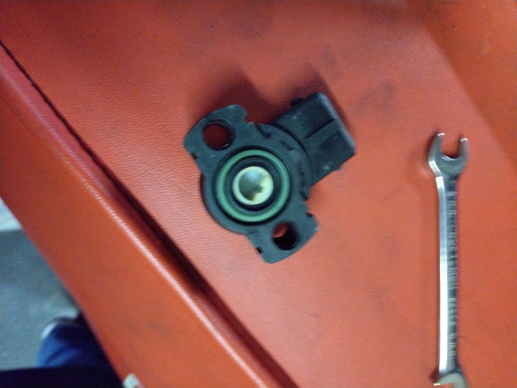

Then, for whatever bass ackwards reason, I decide to deal with the TPS sensor. (Now located at the back of the very last TB,...the one closest to the firewall).
I don't know why I do it this way I gotta tell ya....You'd think that I would've tried to deal with the TPS sensor while the head was off the engine, but noooooooo.
I gotta do it the hard way.
Screws hold the thing on......... Phillips head metric screws. With absolutely no way in hell to get any kind of screw driver in between the firewall, and the head of the screw.
Does that stop me from trying to get it tight?
Nope.
Does it take a stupidly long time to do it, filled with the kind of cuss words typically associated with drunken sailors?

Again, instead of checking the TPS sensor calibration while it was off the engine, when it could've been screwed on that TB easily, I have to do it when there is no room to do it. And now, even though I managed to get it screwed on to the TB, checking the thing for calibration determined that in it's present mounting position, and hooked up to a 9 volt battery to give the thing voltage,........
It shows 2.3 v at idle. WOT reads another 7v. (The check of this battery shows 9.2v)
When you move the test equipment over to the 70mm TB that used to be on the turbocharged setup, It shows .91 v at idle, and 8.02v at WOT.
So then whats the take away?.......
The freakin BMW TPS sensor is showing twice as much voltage at idle....and there is no way to adjust it.
So,....nothing left to do but remove the TPS sensor from the back of that TB.....The very same one that took for freakin ever to get tight, now has to get loosened, and removed to check it. After more D.S. cussing, I manage. As soon as the screws are removed, it becomes immediately apparent that the thing is preloaded as it spins slightly counter-clockwise.
Once removed and hooked up to the test equipment, It will read 0v at full closed idle, and 9v at full open. The bushings that are in the thing will not let me rotate it so that I could put it on the TB, and rotate it counterclockwise to show 0v.
So then....whatya do?
You beat the bushings out, and drill some big assed holes to allow that to happen. Which is what I did.
Once you do that, you turn your attention to the rewire....Remember my really pretty harness?
It don't look like that anymore.
I gutted it so I could pull the TPS sensor wires out and splice them in at the rear of the harness. Now it looks like ass on a plate.
Fortunately, it's underneath the whole menagerie that is now a bunch of BMW stuff.
Again, Why didn't I do this when the whole engine was out of the car when I couldve gutted it, then repaired it while it was sooo easy to do? Because I just love to make sht way harder than it has to be.
But I did it...
Wanna know the whole irony to the whole debacle that this day was?..... It goes perfectly hand in hand with all of the other "do it twice mike" work ethic I make for myself...
I have a Megasquirt computer......I'm pretty sure that I couldv'e just left sht alone, and calibrated the TPS sensor through the setup tools with the tuning software.
Somebody tell me that I coulda done this.
Then somebody give me a gun,.. cause .I'm gonna shoot myself.
