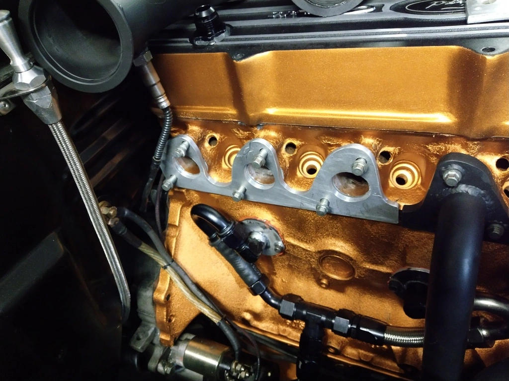

There was water under the car this morning.
And it was dripping from here.
The bolt you can't see is letting water get past it. The bolt threads extend into the water jacket. The engine is back to looking like this.
