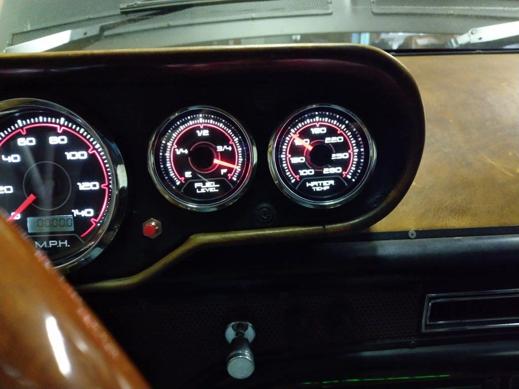

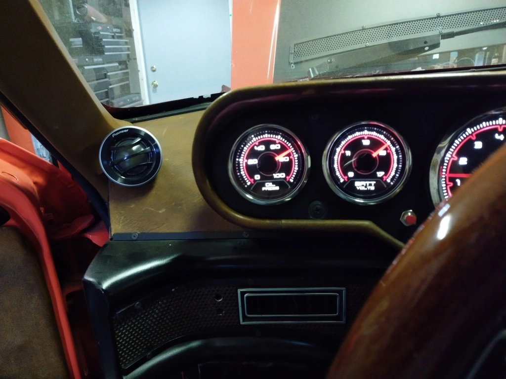

I temporarily put them in, and started the car.
Everything works.

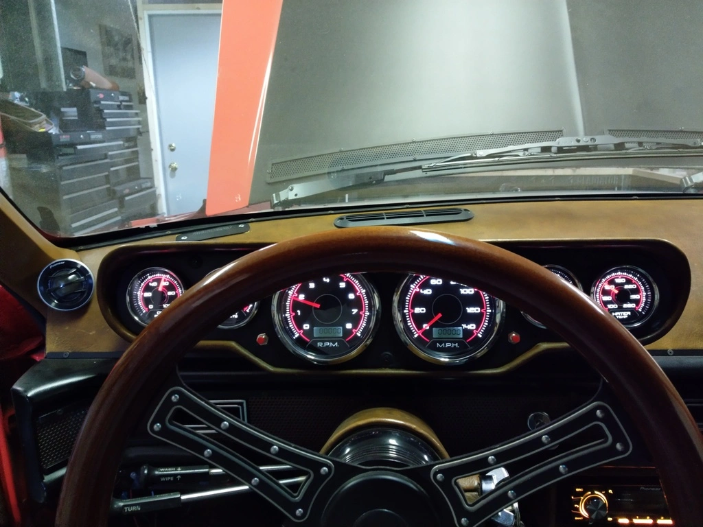

Clearly there is still a blindspot from hell. I made sure to put the two important gauges to the outside where they could be seen w/o craning around to see them, but when you do....
You have 72 pounds of oil pressure at 1300 RPM, and the system is charging at 14.5v's.
On the other side:
Well damn,........I can actually tell how much gas is in the tank for the first time since the Monster has been running.

Love the gauges Mike they look way better than i imagined
Here you go Mike, mount two of these babies (in green, of course) on each side of the steering wheel on the dash for turn signal indicators and get an extra blue one that you can mount up above your rear view mirror for the brights.
BTW, I love, love, love those gauges! Totally btchn!
