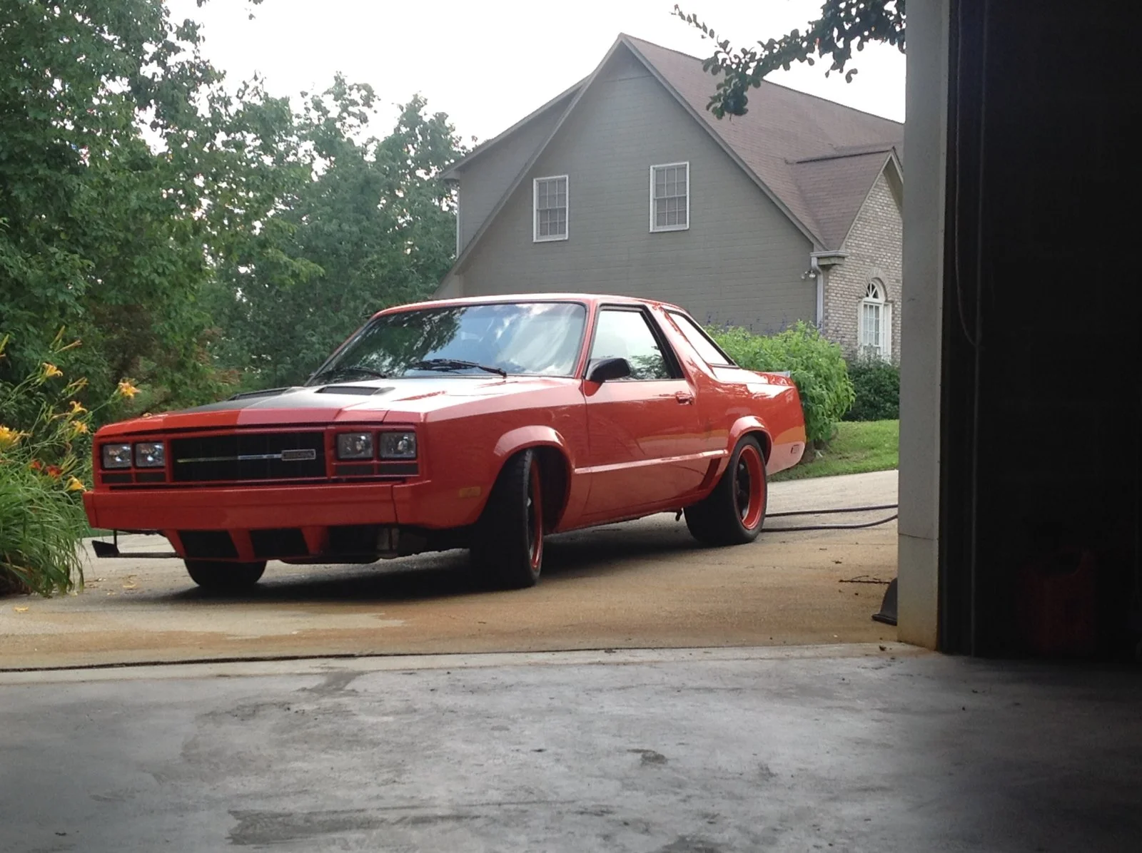

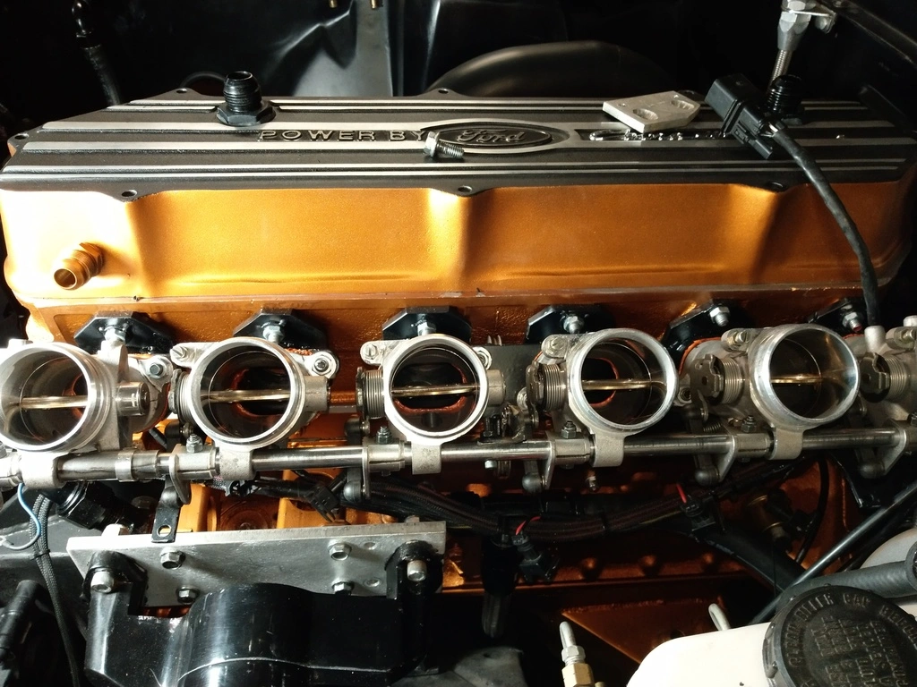

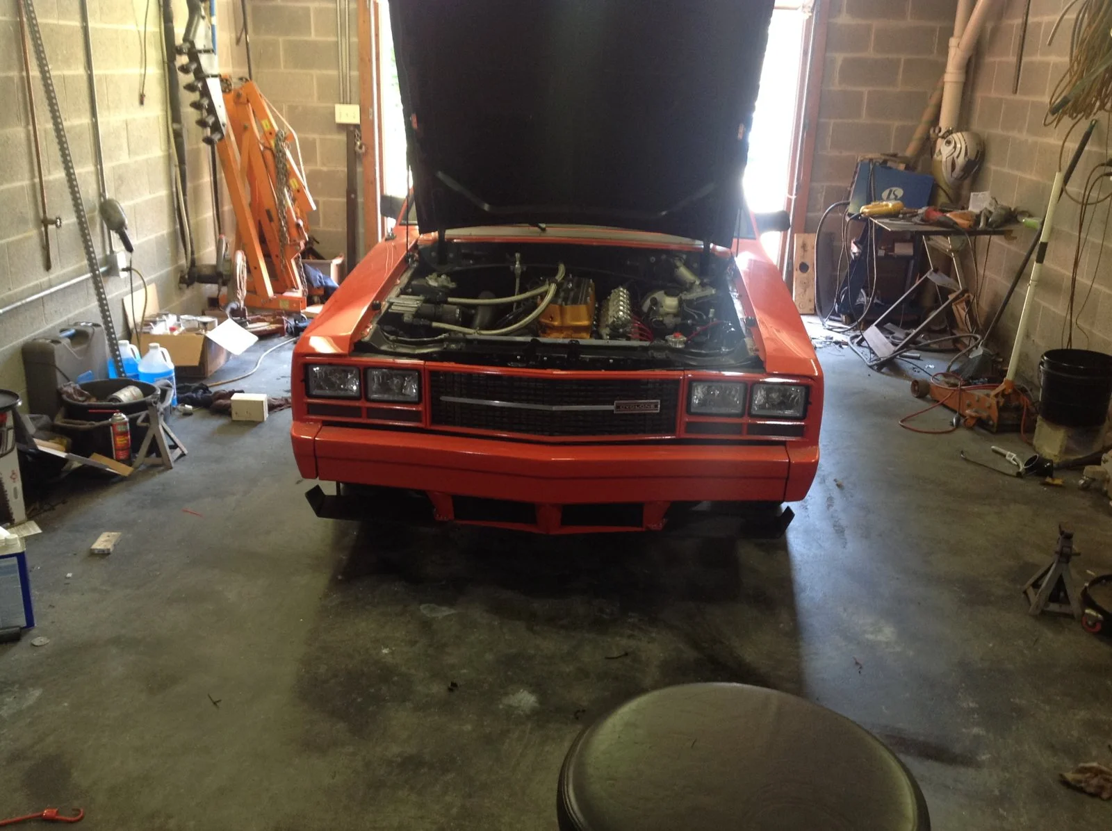

Well, for the first time in 2018, the wheels are on the ground. I've turned the throttle screws back another half turn, I'm going upstairs to get the laptop. I'll start TS, start a DL, and turn the key. No way in hell it'll idle cold now, I'll have to try and mess with the VE tables live.
It runs.
It's obnoxiously loud.
That single straight through SS dynomax is not long for this Earth.
I could not put my foot in it, It goes stupidly lean when I try that. But I have an extensive datalog.
Steve Good sir, when you get a moment...
It runs.
Correction,...it goes stupidly rich, then literally dies, then just as quickly comes back.
It's all kinds of fcked up.

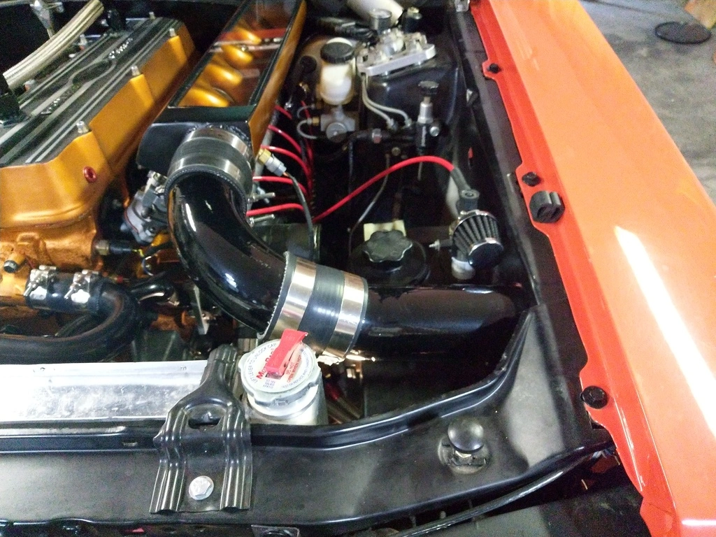

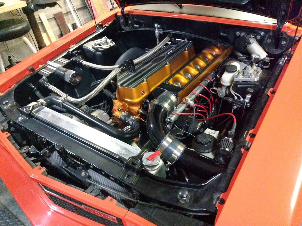

But that's all good,...cause when I open the hood I got this:
And as cool as the turbo was, somebody out there could've cloned it. And I'm all about the one-off.
This just makes it that much more harder to do.
The Muffler will guarantee that the neighbors will hate me, the wife will never ride in it, and you'll hear me coming a mile away.
All the things I hate when somebody is considering making their noisy assed car even noisier. Replacing That will be the very next thing I do.

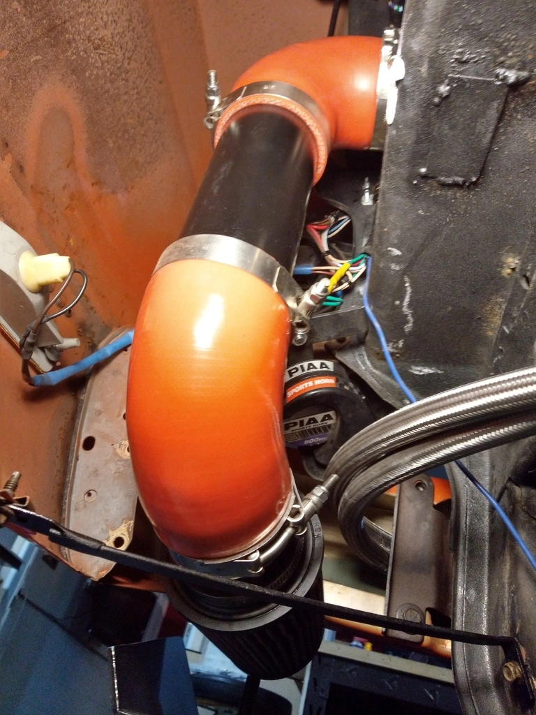

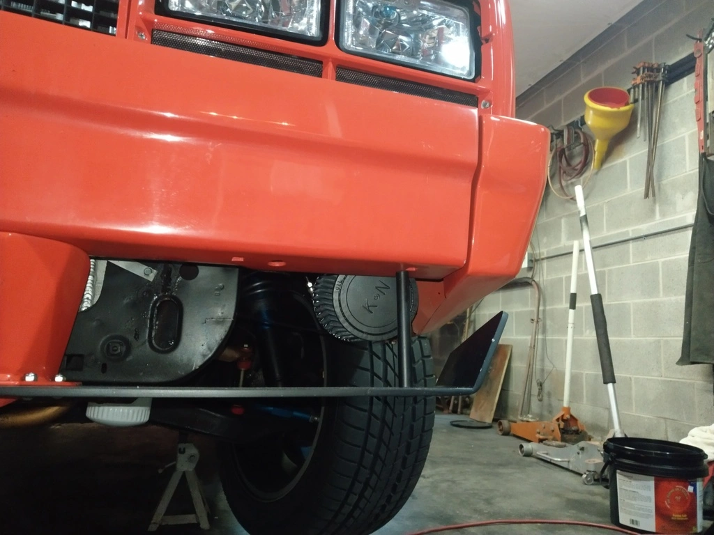

I configured my CAI. Much to the chagrin of the internet Nay-sayers,.The air filter is in the direct path of rain water.
Conversely, It's also in direct path of fresh air as well.
I try to avoid rain with this car, so it shouldn't be too problematic. The pro outweighs the con. Besides water vapor is good for an engine.:rolleyes:
And it'll have to travel 20 vertical inches.
and turn 3 90's just to get into the airbox.
It'll have to be determined water.

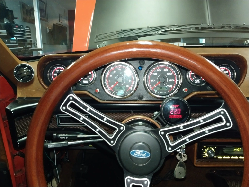

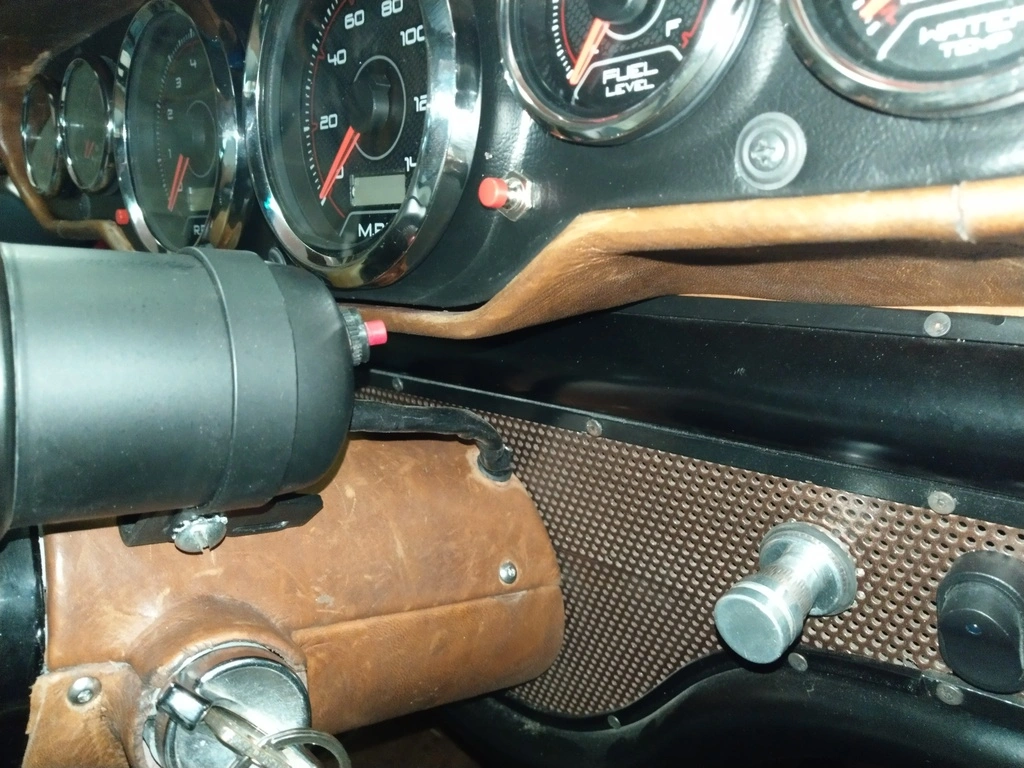

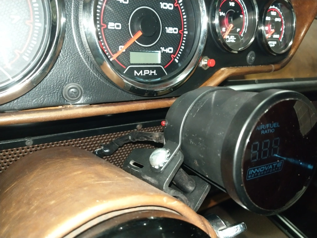

I also decided to hook the AFR gauge back up...I just happened to have an old Autometer gauge cup in my tool box,,,
The cup was deep enough to allow me to make it "self contained" when it comes time to re-initialize the O2 sensor.
button the back..
Lighty-dude on the back side. Easy-Peasy,........ japaneasy.
It hangs a little farther forward off of the bracket than i would've liked it to, but it's tight, and it's holding stuff where I want it. so....... meh.

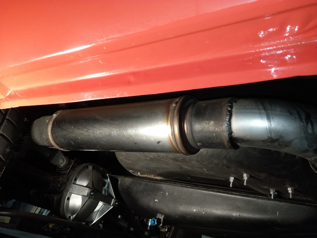

So muffler talk time.....
This is the noisy bastard that's under the car now.
some SS Magnaflow straight through kinda ding dang deal.
I could replace that with a conventional "turbo muffler", or try one of these 3 chamber things from Magnaflow
It's supposed to be a 3 chamber muffler. I guess I could put it in where the existing one is, or splice it in upstream and leave them both in place. Or conversely, If I replace my existing one with this one, and it's still too loud, I could add the old one back in.
