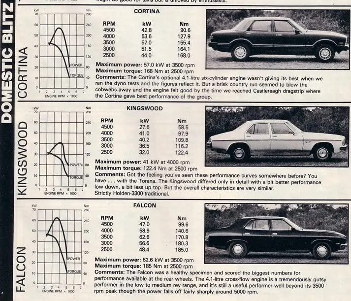

He misses the turbo. Where's Garry the Snail?
The funny part is that Ford USA directly managed Ford Austalia, and though its true that it used a large percentage of cast off parts with previous years emissions standards in lag, it also spit polished a lot of logs. I think the automatic 250 for 1979, even with a cross flow head and a single 1-bbl Bendix Stromberg Technico carb passed US 1973 emissions and made an exactly 46% loss at the rear wheeels. A not uncommon Horsepower loss for an auto in line six.
Thats where the the rear wheel horspower can double, triple or quadruple on any domestic US or Australian I-6.
63 REAR WHEEL HP TIMES 4 IS 252 rwhp horsepower. CMA could have quadrupled his log head 250 Maverick engines rear wheel horsepower!
DOMESTIC BLITZ (Wheels March 1979, Vol 50, No.4, Page 26) had a VB Commodore, TECortina, XC Falcon, HZ Kingswood and UC Torana comparo.
The Commodore VB 3.3 gave 19.2 sec 1/4 mile
RPM_____kW_____ Nm_____RWHP_____RWLB-FT
4500____47.0_____99.6_____63.0_____73.4
4000____50.7_____121.0____68.0_____89.2
3500____48.4_____132.2____64.9_____97.5
3000____40.2_____128.1____53.9_____94.4
2500____34.3_____131.0____46.0_____96.6
71 kW[DIN Net] (95 bhp) @ 3800 rpm
213 Nm[DIN Net] (157 lb-ft) @ 2200 rpm
9.2:1, 1-bbl, 3298 cc.
GM Stasburg Trimatic, 3.08:1 diff
Tare weight 1224 Kg, or 2698 pounds. Test weight approx 3100 lb's
Average Imperal mpg was 19.5 mpg.
Power loss was a factor of 1.4
The Torana UC 3.3 gave 19.8 sec 1/4 mile
4500____39.6_____83.8_____53.1_____61.8
4000____44.7_____106.8____59.9_____78.7
3500____42.5_____115.9____57.0_____85.5
3000____35.8_____113.9____48.0_____84.0
2500____30.6_____116.7____41.0_____86.0
88 kW[SAE Gross] (118 bhp) @ 4000 rpm
251 Nm[SAE Gross] (185 lb-ft) @ 2100 rpm
9.4:1, 1-bbl, 3298 cc.
Tare weight 1200 Kg, or 2646 pounds. Test weight approx 3046 lb's
Average Imperal mpg was 16.6 mpg.
Power loss was a factor of 1.97
The Cortina TE 4.1, in bad tune gave 18.2 sec 1/4 mile
4500____42.8_____90.6_____57.4_____66.8
4000____53.6_____127.9____71.9_____94.3
3500____57.0_____155.4____76.4_____114.6
3000____51.5_____164.1____69.1_____121.0
2500____44.0_____168.0____59.0_____123.9
92 kW[DIN Net] (123 bhp) @ 3700 rpm
288 Nm[DIN Net] (212 lb-ft) @ 2400 rpm
9.0:1, 1-bbl, 4089 cc.
BW 35 Automatic, 2.92:1 diff
Tare weight 1220 Kg, or 2689 pounds. Test weight approx 3090 lb's
Average Imperal mpg was 17.9 mpg.
Power loss was a factor of 1.61
The Kingswood HZ 3.3 gave 20.1 sec 1/4 mile
4500____27.6_____58.5_____37.0_____43.1
4000____41.0_____97.9_____55.0_____72.2
3500____40.2_____109.8____53.9_____81.0
3000____36.5_____116.2____48.9_____85.7
2500____32.0_____122.4____42.9_____90.2
GM Stasburg Trimatic, 3.36:1 diff
Tare weight 1369 Kg, or 3018 pounds. Test weight approx 3420 lb's
Average Imperal mpg was 17.8 mpg.
Power loss was a factor of 2.145
The Falcon XC 4.1, in good tune, gave 18.6 sec 1/4 mile
4000____58.9_____140.6____79.0_____103.7
3500____62.6_____170.8____84.0_____125.9

On Page 35, the Falcon, Commodore and Holden Kingswood were retested, the same models but the Falcon was an XD this time. The variance was interesting, with the Falcon six worse performance wise than the 330 pound XC tested in March 1979.
It's interesting to note the differences.
3000____56.6_____180.3____75.9_____132.9
2500____48.4_____185.0____64.9_____136.4
Tare weight 1540 Kg, or 3395 pounds. Test weight approx 3800 lb's
Average Imperal mpg was 18.6 mpg.
Power loss factor was 1.46.
The Falcon XD 4.1, in good tune but new, gave 18.6 sec 1/4 mile. The earlier June Issue showed 18.5 secs.
4500____56.6_____112.0____75.9_____82.6
4000____61.0_____147.6____81.8_____108.8
3500____63.3_____174.9____84.9_____129.0
3000____55.8_____180.0____74.8_____132.7
2500____48.4_____187.2____64.9_____138.0
94 kW[DIN Net] (126 bhp) @ 3600 rpm
292 Nm[DIN Net] (215 lb-ft) @ 1800 rpm
Tare weight 1390 Kg, or 3064 pounds. Test weight approx 3464 lb's
Average Imperal mpg was 17.5 mpg, but it was sateted that 21.7 was possible easily in the June issue.
Power loss factor was 1.48.
Top speed was 162 km/h, or 101 mph.

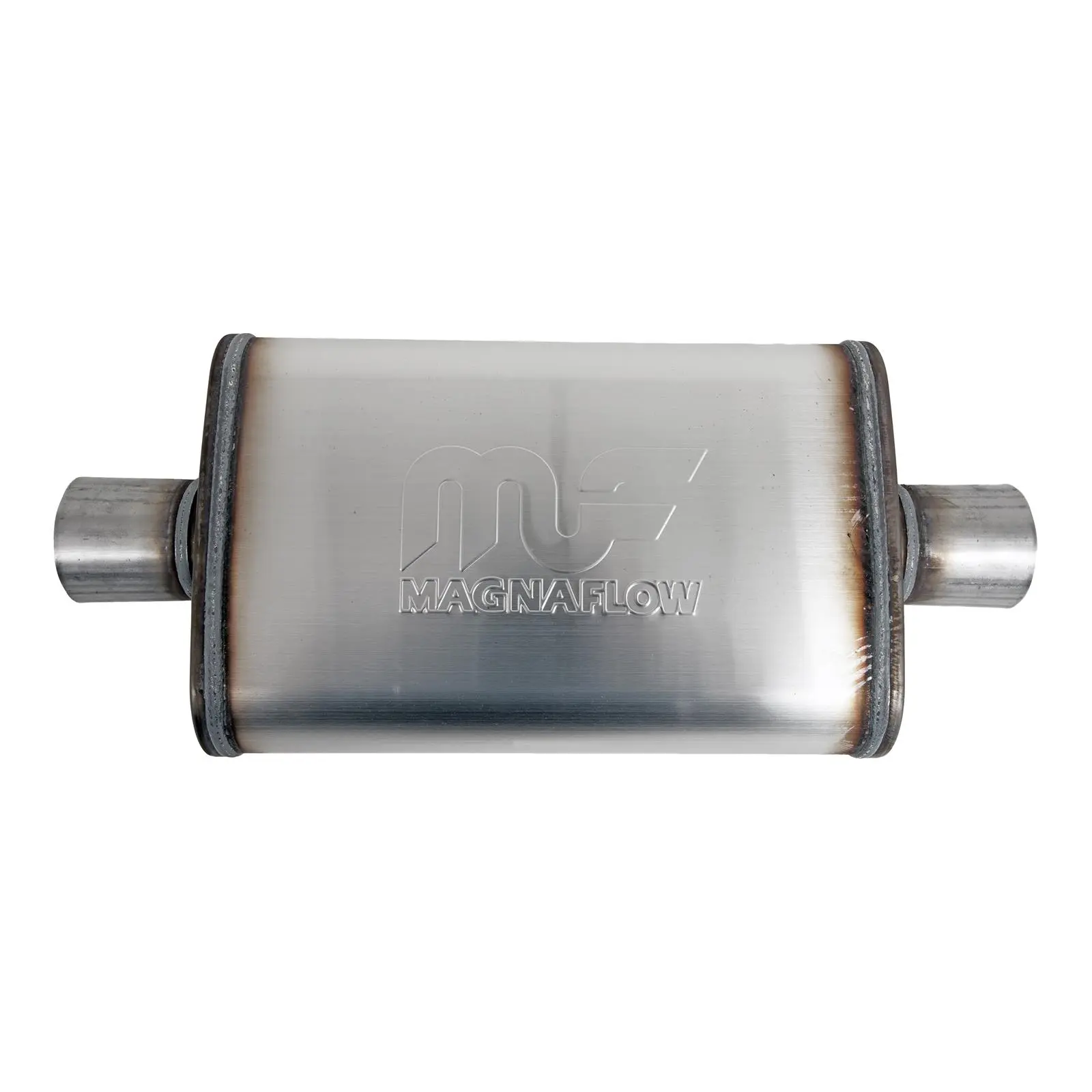

I called Magnaflow and asked for a recommendation. Dude says I should leave the loud assed muffie in place, and put one of their oval pieces in between.
The one he recommended looks like this:
Cost on it is 91.62
409 stainless steel straight through perforated tube w/fiberglass packing.

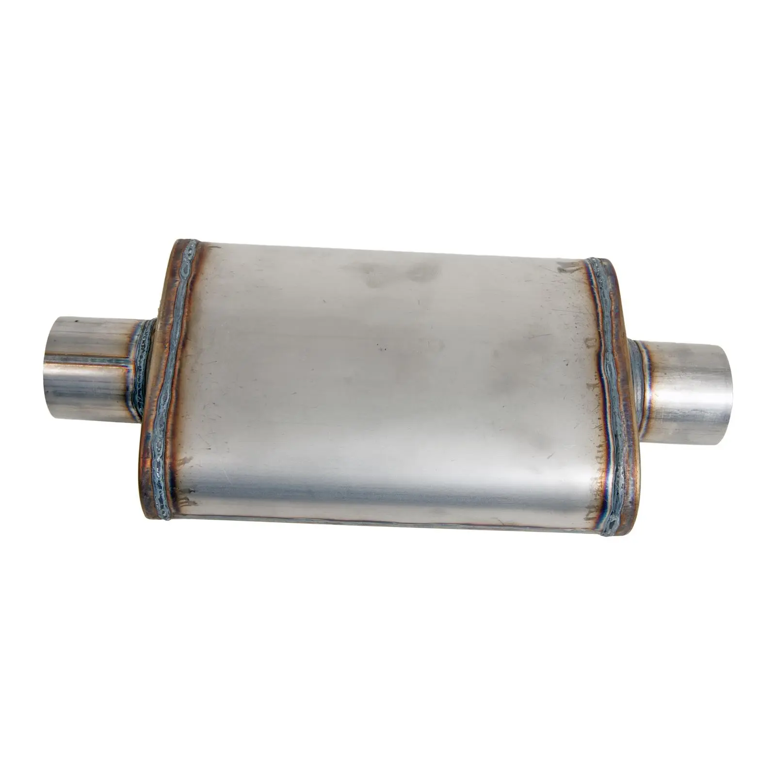

Then there's this:
409 stainless steel, Straight through perforated tube surrounded by fiberglass packing...
35 bucks.
Now I know,...I'm on record for stating that the high road is a road of no regrets.....and more often than not, the low road is full of ruts and potholes,......but it's a freakin muffler.
How much different could it possibly be?

I would say it is in longevity. And since it's not your daily driver, that almost $60 saved can go towards some fuel in the Monster's belly. I think it should do the trick. My new V-6 Ram has a giant beer keg sized muffler under the back seat and then a small muffler looking resonator on the tail pipe and it's super quiet. I've heard audio clips of different exhausts on it and they all are super loud without that resonator.
