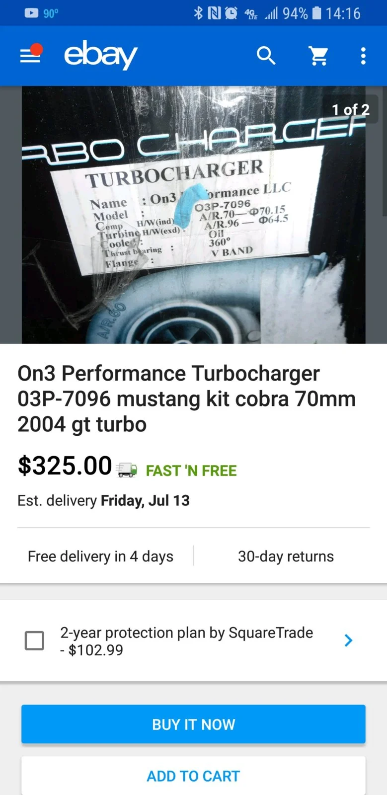

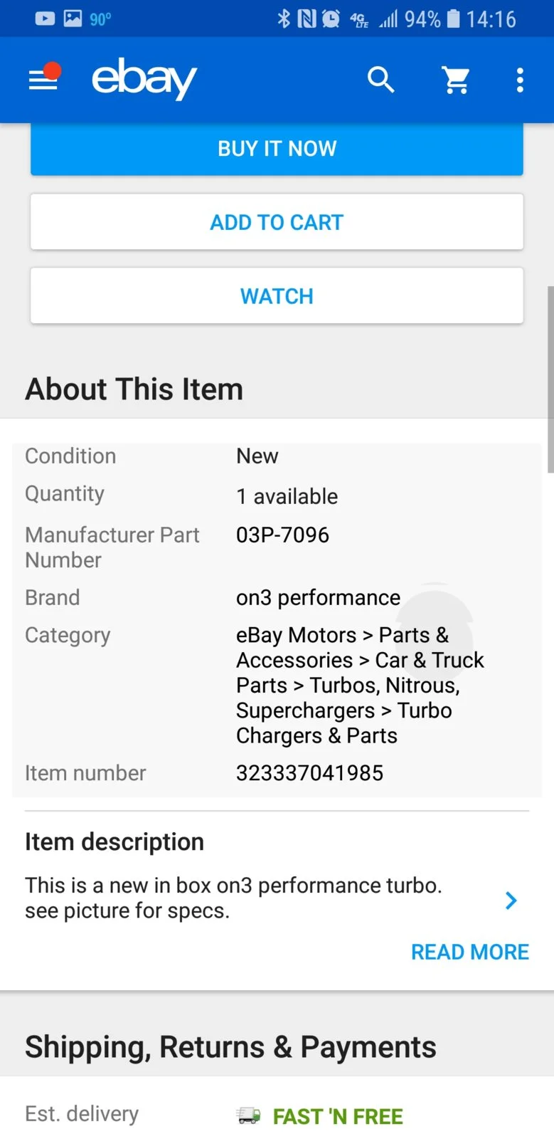

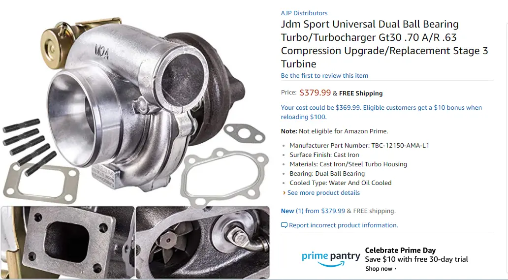

The question for today stems directly from my ignorance......
Why wouldn't I want this?
It's Chinee I know.....But there are several here that are using them, so I'd thought I'd pose the question out loud here.
It's a ceramic BB turbo,...says that it's water and oil cooled, but I cannot see from the pics where those lines plumb to.
The attraction is the price...it's not too cheap, and it's internally gated, which makes this conversion back to forced induction more reasonable.
The BMW turbos are actuated based on vacuum instead of boost, and it was just one more project too many that I didn't want to dick with. The only thing other than this thing I'd need to completely convert back is a new water meth kit. So for the price of my last turbo alone, I can convert it back.
I just don't know how an internally gated turbo is controlled.....( I don't know if this thing doesn't work off of vacuum either for that matter...)
It's a smaller flange, but that just seems like it'll spool faster to me..I don't know what the A/R ratio does/doesn't do for me here either..
I do know this.....the engine is done at 6k rpm. ( probably actually more like 5500). It's a street car with 3.73 gears. It didnt need hardly any throttle to put it in boost before, so I could actually afford to "lazy it up"
So, boost experts...what am I looking at here?
I'm not buying anything this minute, but I'm starting to look. ( which means I'll buy something w/i the next couple of days)
I've already learned that the turbine AR number is really the one that matters in choosing the thing. The larger the number, the lazier the turbo regarding where and when it makes boost. Conversely a smaller number makes boost quicker, but will create more exhaust back pressure limiting top end. When you read the " fine print" on the turbo I listed, it shows a .82 turbine a/r which will be very similar to my old one excepting that it won't be a twin scroll unit, and I'll be forcing all six cylinders to breathe through that tiny little hole.
The thing I choose has to be internally gated,...I'm not spending that much money on this thing this time around...I know it's probably a risk, being a JDM brand,..but the specs....( ball bearing,...inconel impeller, water cooled...) they just seem too good.
Too good to be true.

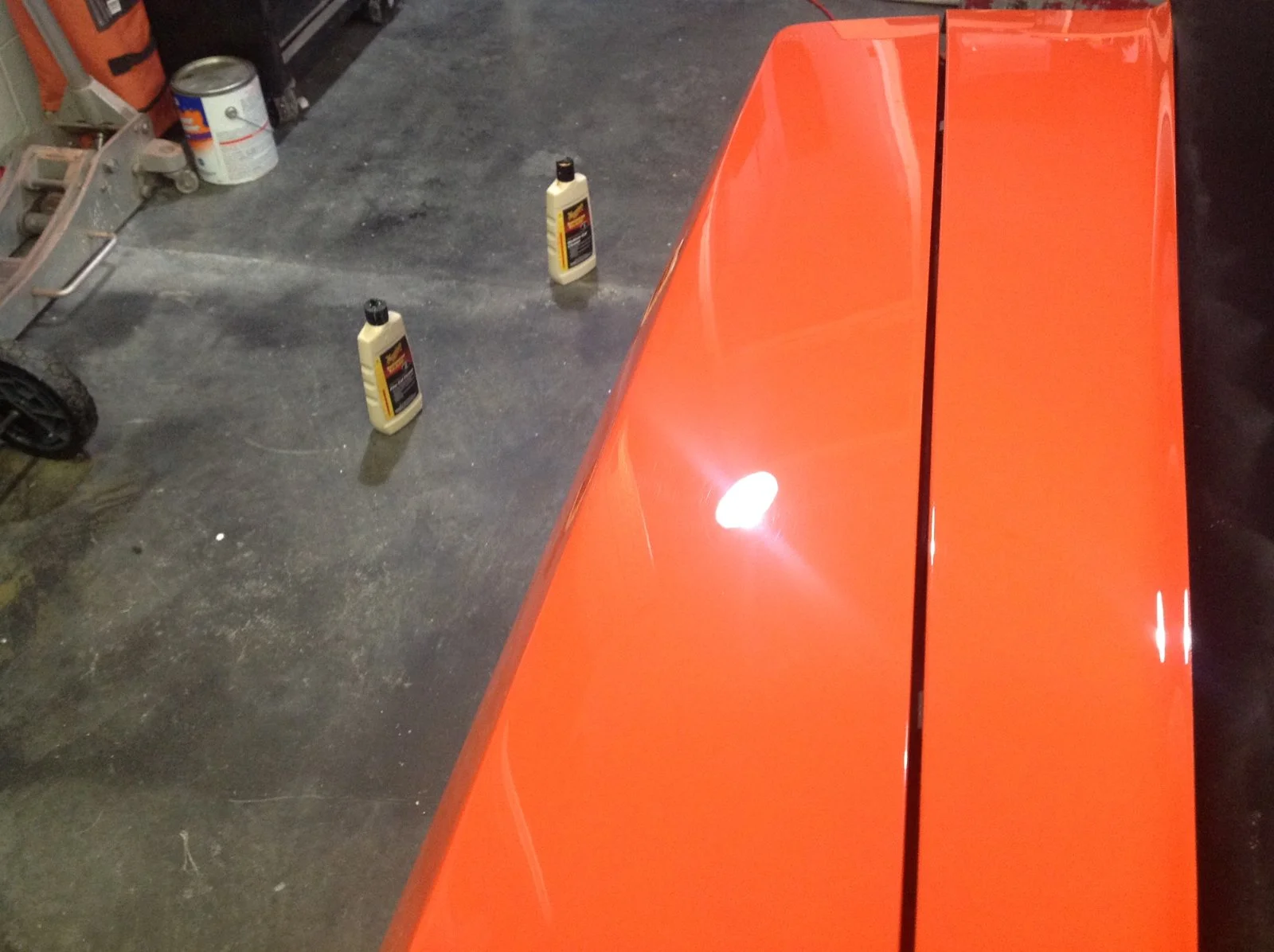

I got absolutely nothing to do today, so I decided to wax the monster on the off chance that I'll get off next Saturday early enough to actually make it there at a reasonable time. That plan lasted about as long as it took to put it on, let it dry and wipe it back off. Over the winter it appears that I have had a little paint hazing or something, and the need for an actual cut an buff was just roaring too loudly at me to let that be.
So,...out came the 2000, 3000, the buffer, two pads, and three stages of compound.
And I wore my ass out working on the drivers side front fender.
I've taken a picture, but you can't see anything from it... ( it's just shiny)
Now I'm not complaining...I love this paint job. Sure it has imperfections, and sure it's got a fair amount of debris in the paint,..but there's only one guy to blame for that.....me.
What do ya expect from a guy that didn't check his filter on the compressor, and didn't seal up the booth properly.

The whole turbo shopping thing is a pain in the ass. I can find a turbo similar to the BW that was on the monster, but the gates would be external again. Good gates cost twice as much as the stinking turbo.
I'f I could find an internally gated mono scroll t4 turbo with a .7 ar I'd pay 500.00.
But instead it looks like I'm gonna have to get a Chinese mono scroll t4 with the same spec as I quoted above at about 300.00 as a stand alone. A good gate is 250.00-280., and a new water meth system is just shy of 300.00, flanges, and some tubing, and I'm back in the Turbo business at about a grand.
