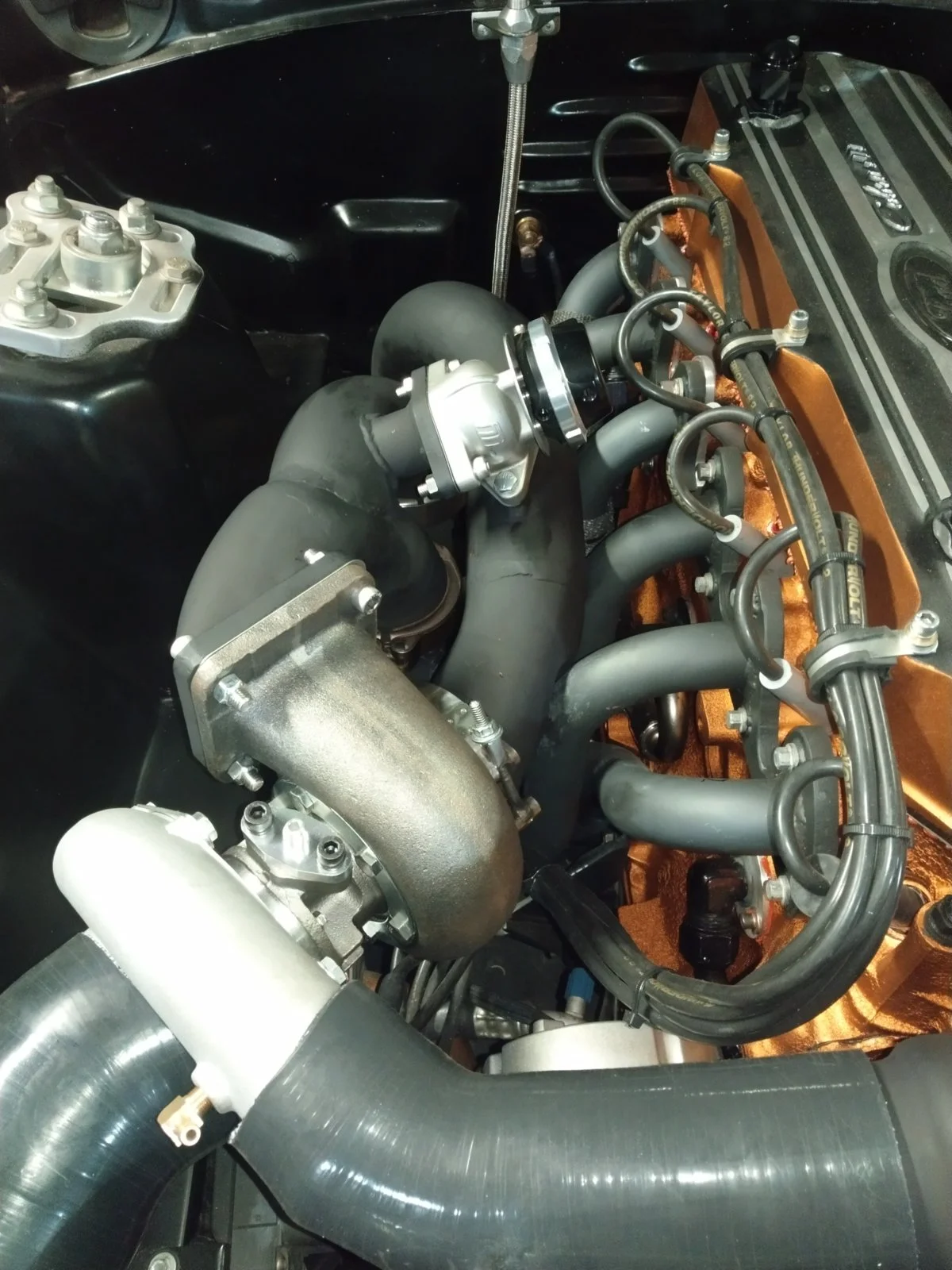

It's been a long time since my wife tore my ass up over something I did that was just too stupid to do...
Kinda like me drinking.....for whatever reason, seems like every 6-9 months I forget that I can't tolerate too much of it...and I pay dearly for it.
Tonight, the 3 pieces that make up the hot, and cold side piping are done. All of the holes are drilled, all of the pieces have been ground smooth, and all of the pieces have been painted using VHT's ceramic coat high heat paint. This stuff has to be heat cured like powder coat to give the finish a very hard, solvent resistant finish. You're supposed to bake this stuff at 250 for 30 minutes, and let it cool for 30. Then again at 400 for 30, and again let it cool for 30. Finally you're supposed to turn the heat up to 600 for 30, then let it cool for 30.
Tonight, as I'm sitting here, fumes from the first bake stage are starting to fill up the house, reminding me of how bad I'm gonna hear it when the wife gets home tomorrow. ( there,...the timer just went off...30 minutes cool time now)
Why do I do such stupid sht?......
I-I-I-I don't know rightly...maybe the paint fumes have compromised my sense of right and wrong. Maybe I'm dain bramaged from breathing countless ounces of metal grinding dust over the many years of doing this,...maybe it's simply because I'm a guy.....Regardless of the causes of my irrational thinking,..those cakes are bakin'....
I'm only gonna do the 400 degree cycle and be done...the oven just gets too freakin hot when set to 550, and not only will I have paint fumes to deal with, but the AC system will be running overtime trying to cool this place down.........just spreading those fumes all over the place...
Yummy.

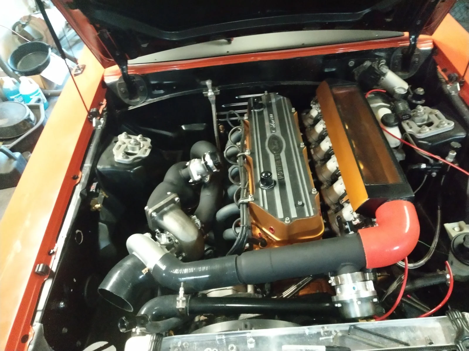

The orange 90 isn't long for the world...ill end up replacing that thing with black...( despite the fact that I have 3 of these damn orange 90's)
Obviously, I chose not to wrap any of the hot side..it will be a pain in the ass.
Left to do:
I gotta splice the fpr back into the vacuum/boost system so the it'll start adding fuel under boost. I have to plumb in oil feed and oil drain lines... I gotta re plumb the boost duty solenoid into the Wastegate.
I gotta reconfigure the crankcase vent lines to some catch can..( I'll probably just buy one)...
i have to mount the Snow cooler activation/safety solenoid as a fail safe against accidental seepage/siphoning of the water meth into the engine...
And I gotta Hook up the BOV... to the iron lung.
Once all of those odd and ends are complete,...I have a running engine again...I'm thinkin Monday....
