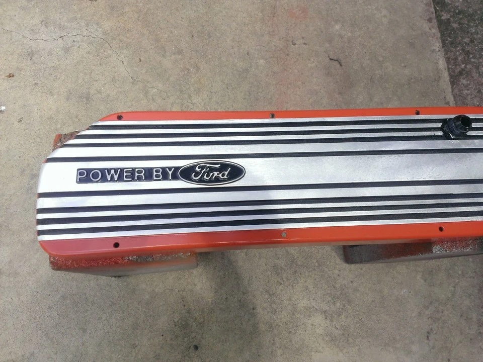

The valve cover. The one that I said was "kinda" finished, that nobody called me on, still was lacking something for me to be totally happy w/it.
It needed a little something else.
I come back in get on the computer, di ck around here for about an hour, all while looking at small aluminum letters online.
( I was thinking I was gonna spell out CROSSFLOW down the middle.)
But stupid little aluminum letters cost about 12.00 a pop. It wasn't bothering me that bad to have a bare valve cover that I needed to spend another 100.00 just so I could bling it up.
I resigned myself to having a boring valve cover, and went back downstairs, and started rummaging through some of the mountain of new stuff to put on the car. I decided to install the rear brakes, and attempt to fab up a tunnel mounted E brake handle to actuate them.
I get the driver side mounted, when... (because I was laying on my back, and my view angle allowed me to see it) I saw the solution to my boring valve cover.
There, in the corner of the old six banger junk was the stock, stamped steel valve cover. On top of that valve cover was the script: POWER BY FORD w/ the traditional blue oval at the end.
I get out the cut off wheel, a block of wood, some black paint, some clear paint and a sanding block, and cut, grind, beat, flatten, sand and paint that piece of steel.
Then of course I glue it to the valve cover.
Now it looks done to me.

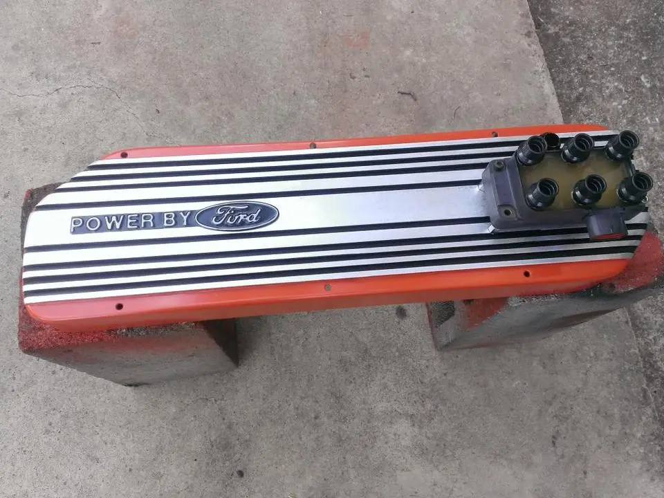

What's in the box I wonder, and I cut it open to find the Taylor plug wires I ordered for the goofy assed 6 tower coil pack that goes w/ the EDIS-6 ignition that I'm running. I open the wires to see if they are cut to fit or already made, so I can determine where I might locate that stupid clunky thing.
They're already cut to length. I only got about a foot on the shortest wire.
Now I gotta find somewhere to put the thing that is close enough to allow for that short assed wire.
What started out as a relatively spacious engine compartment is cramping up in a hurry. The turbo and the exhaust manifold (Medusa), take up the entire passenger side, and the induction has the fuel rail on top, a water pump, and a dual oil filtration system under it, so I got no choice.
I had to put it on top of my pretty valve cover.
The ugly assed thing sits on four 1/4 " pedestals, and is through bolted to the top. I hate it, but I didn't see an alternative.

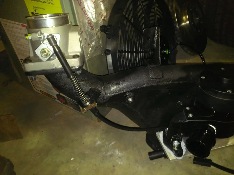

I open the box that has my Lokar trans dipstick tube in it.
Why did I think I needed a 36" long dipstick tube?
I don't know why either, (must've just finished my last crack vial) but I'm determined to NOT send this thing back. It's just like a piece of braided line anyway. I Modify, I overcome, I adapt.
I cut it down to 24", It now fits.
Also inside that box is my 42.5" long F-250 accelerator cable. All I have to do is make the bracket
Fit's like a glovie.
You cant see it, ( and you're not going to either) but I needed a piece of metal the right thickness to slide the molded on retainer on the acc cable to. The only thing I could find that was the right thickness was an extra 18" steel ruler from an old broken combination square I had laying around.
So my bracket has little tick marks indicating that it is exactly 1.750 long to the bottom of the bracket.:banana:

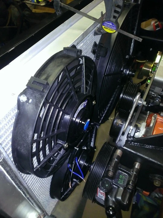

The fans come in today. For those paying attention, I had an interference issue when the single 16" was mounted to a 1" alum shroud.
I knew that I'd be able to direct mount the fan against the core, but that left a significant amount of un-cooled space just sitting on the core.
So I bought two 8" auxiliary cooling fans and stacked them on the open side.
Just for Sh its, and grins, I decide to tie all three together, and hook them to a spare battery that I had laying around just to see if they would do a good job.
This is where I wish I could take that decision back.
No sooner did I plug in the other end of the socket that was direct wired to the battery when the negative pressure drop that came as an immediate result of all three mini tornadoes pulled the garage man door against it stop.
I feel a "whoomp"! as the door pulls tight against it's gasket. My ears pop, and I'm although I wasn't immediately aware of it at the time, I'm being pushed away from the position I was kneeling in. The cat had been doing that "lick paw, wash face, repeat" thing, and was sitting directly in front of the car when I plugged them in.
Her eyes got about the size of quarters as she felt the pressure drop at the same instant I did, and she was now being pulled towards the radiator. Being on pavement, there was little for her to grab onto for traction against the suction, so she just screeched across the pavement. In a last ditch effort, she managed to snag the leg of my work bench, but only managed to get one little
pinky claw hold.
The fans are now running at full speed now, and the cat, still doing her damnedest to hang on, is now horizontal,..and is starting to flap like a flag, all while howling bloody hell. I'm now acutely aware that there is like a mini-black hole thing going on here, and the fans are starting to warp time.
I remember thinking to myself, but even my thoughts were in slow motion as I struggled to make sense of what was happenning. "MMUUUSST.....GGGETT....TOOO....WIIIRES!" I thought, but by now, the same force that's making the cat flap, is pushing me back, making it impossible to move.
The cat's one single pinky claw fails, and she flies across the garage, and slams against the radiator, hitting it w/ a solid thud. The area that was now blocked by the cat's body now goes into mega suck, and starts pulling clumps of hair off the cat, and is blowing that junk all over the engine, and throughout the garage. Now the noise coming out of the cat is only eclipsed by the amount of hair that's getting sucked through the radiator.
Fortunately, before the rest of the universe got sucked into my garage, the battery tipped off of the cement block and severed the connection to the fans, and they stopped. The cat, now half naked books off through the cat door, with clumps of hair still following her as she bee lines for safety.
She left a giant impression of a cat's body smack dab in the middle of my brand new radiator.
This pic was taken before all that junk happened.
