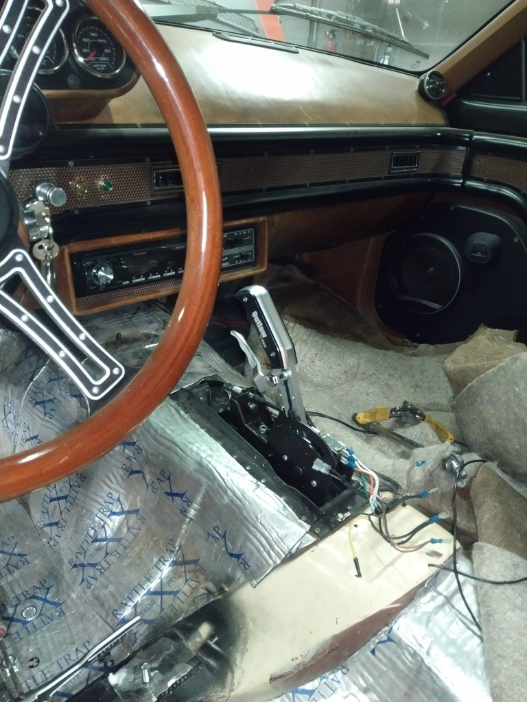

The new shifter is in.
The top of the console is gonna have to be modified.
Significantly.
I could not leave the shifter as low as the other one was mounted, the handle on a ratchet shifter basically moves very little, and requires a very small cut out to work. This thing moves a bunch. The range of travel is over twice that the ratchet shifter needed.
No longer will I be able to use a single gang decora switch plate cover as a trim plate.
The photo makes it look way higher than it actually is, because the console is removed. When that thing is back in place the shifter handle is only an inch higher than the other one.
After I got it al installed I tried it out..Pull the trigger, pull the handle all the way back. Low gear.
Push it forward against the stop, second gear, push it again, it goes into 3rd..
But,.....there's a problem...you can also push the damn thing straight past 3rd, and right into neutral.
WTF?
I messed with it some more,...same thing.
I wondered if I had a reverse pattern shifter..
Then,..just to be sure, I decided to read the instructions.
Durrr.
So,...now that I've read the instructions, the proper technique for shifting the thing is to push it forward from low into second. ( you can't push it past that, it hits a stop.) But,...if you pull the trigger and hold it while pushing forward into 3rd, again it hits a stop. Release the trigger, and then you can push it into neutral..but reverse has a damn lock out lever..it requires you to flip up a lever to get the thing into reverse.
So I'm good.
Those side panels on the shifter handle are remove able. Maybe there are blank ones available...I freakin hope so.
Otherwise I'm sanding and painting them btches.
