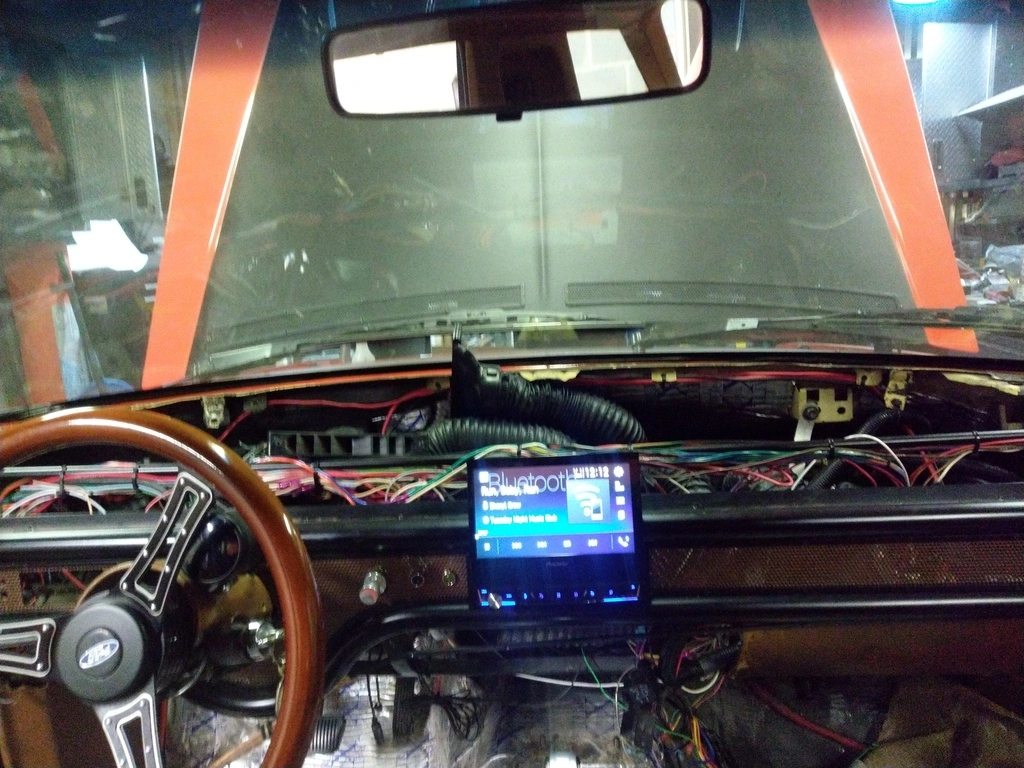

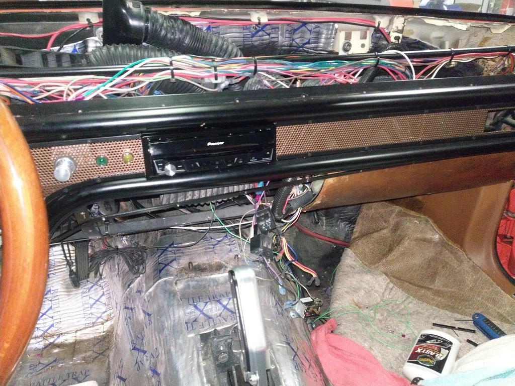

Well the car stereo fits....but it isn't right.
It opens without interference upfront,...MOF, it's just high enough to miss the shifter completely as it opens.
But When it tilts upward, it doesn't project out enough. The horizontal lower dash bar won't let the screen stand completely vertical. The screen covers the center dash vent, and covers one of the two gear indicator lights that I just put in.
It needs to move out another inch 3/4" so it'll stand vertical. The only way to accomplish that is to space the thing out that much farther., and that means I'll have to modify Blinkin.
Which I don't really wanna do...I like how it looks with the AC controls and the head unit shrouded. If I move that mounting surface out 3/4" there'll barely be a shoulder left to surround the metal mesh.
And it'll still cover the center vent regardless.
If I lower it, and drop the bottom of Blinkin, kinda like I did to Winkin to make the gauge housing accommodate the new gauges, it'll run into the shifter unless the shifter is in low...While that may be an acceptable consideration, when you shut the car off with the screen out, it will store itself automatically once power is cut.
And jam itself against the now forward shifter.

I know you aren’t this dense, but just in case.... When I had one of those head units, there was a screen adjustment feature in the settings. It could be set to sit further out/in, or change the angle at which it sat. Still needs to come out more? Mine could be made to sit several inches out from the dash...
Not this one. This is a 7" diag screen. it's giant compared to the chassis it retracts into, which is only 6-3/8" deep.
I know that I can change the tilt angle, but there is a physical obstruction preventing that.
Laying in bed again, thinking about how I fix the fitment issue on the new touchscreen. I really don't want to extend the mount out, and hate the fact that the center vent is covered when the thing is open.
So,..desperate times call for desperate measures.
I could make the thing fit where the center vent is now, and drop the center vent down to where the old radio location was before, or simply move the center vent over. That'll mean the dash top, and gauge pod come back off, but it'll give me a chance to add some wires for the eventual upgrade to MS3x. Most notably SEFI. I want to build a wire bundle, and pass it through the firewall so that I can have all of that stuff coiled and hanging at both ends when/if I ever upgrade the thing.
It'll also allow me to deal with the the future possibility of adding a full time onboard computer to hold the Tunerstudio program
Again, if I choose to deal with that.
The head unit has provisions for a back up camera, a microphone for hands free integration of my phone, and can have Sirius and Nav added as options. For sure, I'm gonna add Sirius, but I'll forego the Nav, opting to let my phone do that through Android auto.
I'd like to add the camera, but having seen how bad a lot of factory b/u cameras look, I can't tolerate a crappy looking image that I had to pay for, so I'm Leary of that.
Moving the thing up will solve al lof my issues/concerns for the aesthetics when the screen is open, but will create a big gaping hole in Blinkin where the old radio used to be. Easily solved with a new cover plate, but what to stick back in that space is the question....

#3. The side plate on the shifter is powder coated aluminum. Sand off the sides, and you get a black outlined insert. I still have to work the scratches out and polish them shiny..but...fixt.
The car stereo has moved on up to a Deeluxe apartment in the sky.
This is where ol G buddy thought he was gonna try a " No said the finger" on me...
I got out my sawzall, and cut that finger clean the hell off.
It was tenuous..running a sawzall blade along the top and bottom of those bars, cutting off the welded backer that the mesh is sandwiched against. I had to worry about the blade cutting into the bars, cutting through wires, or kicking back and jamming against the front of the bars. ( that happened,...you can see the little doink marks in the top bar)
Fortunately, I only spot welded the backer every 6" or so...there was a hole in the dash in about an hour.
The rest of the day I was either running around chasing my tail,...or screaming at the top of my lungs after I tried to relocate that center vent to Blinkin...
The vent hose was too short.
I learned this, " after" I mounted the head unit..now I have to take it apart so I can move the center vent 10" to the right.
But in the end....and aside from the fact that I'm gonna have to take it back apart so I can add back the center vent.
I have a touchscreen head unit that isn't covering up anything when it's open.
