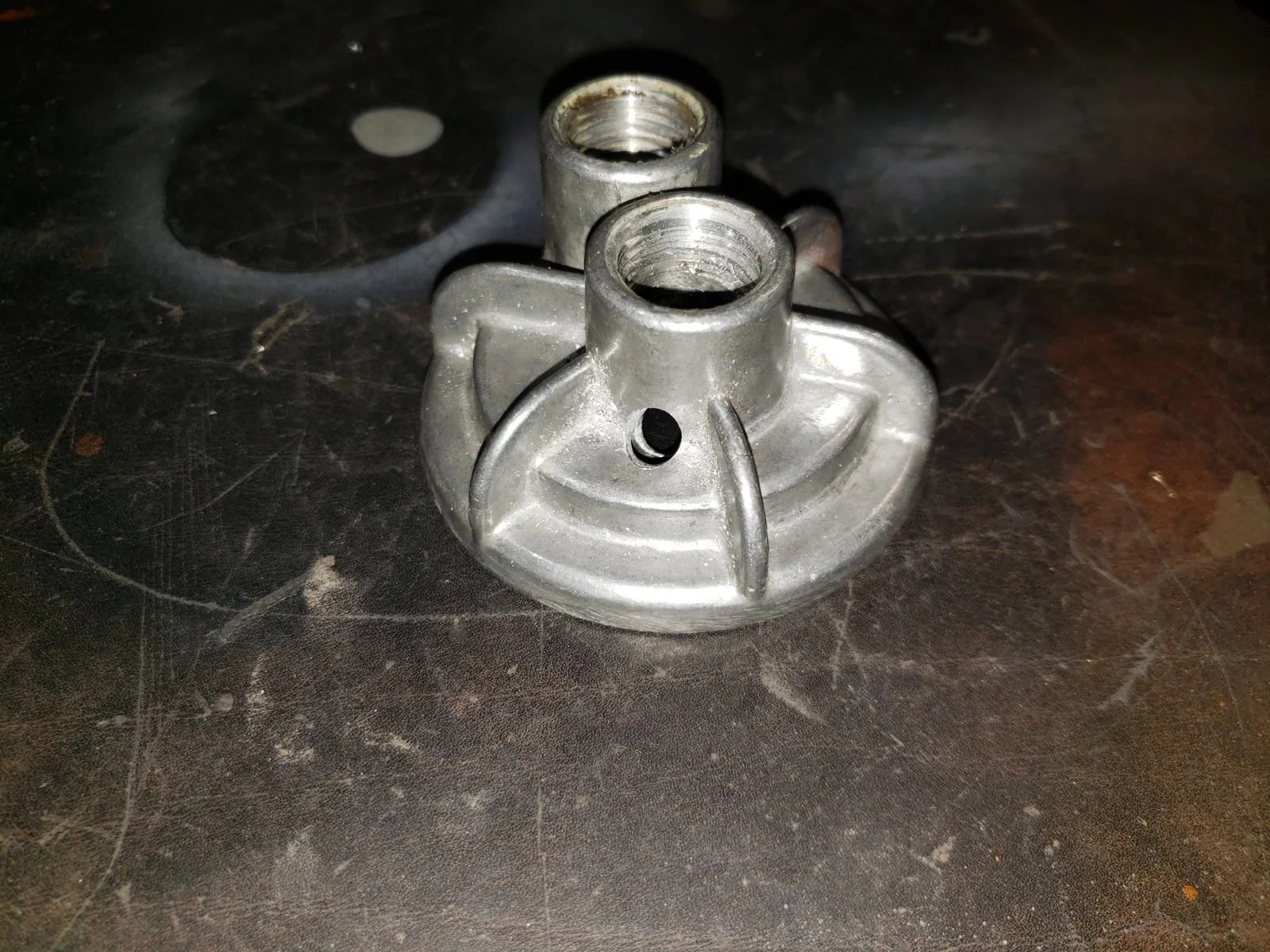

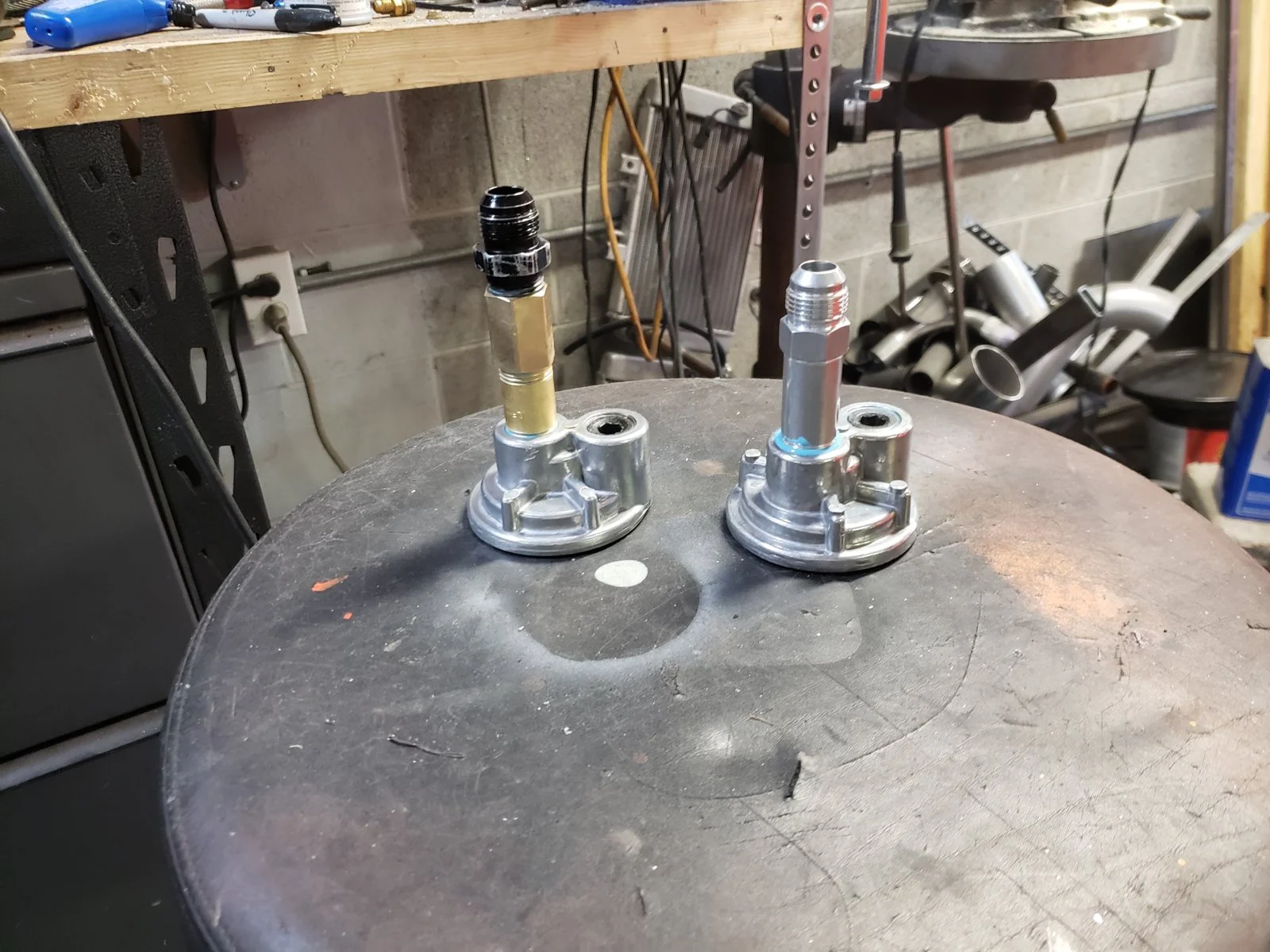

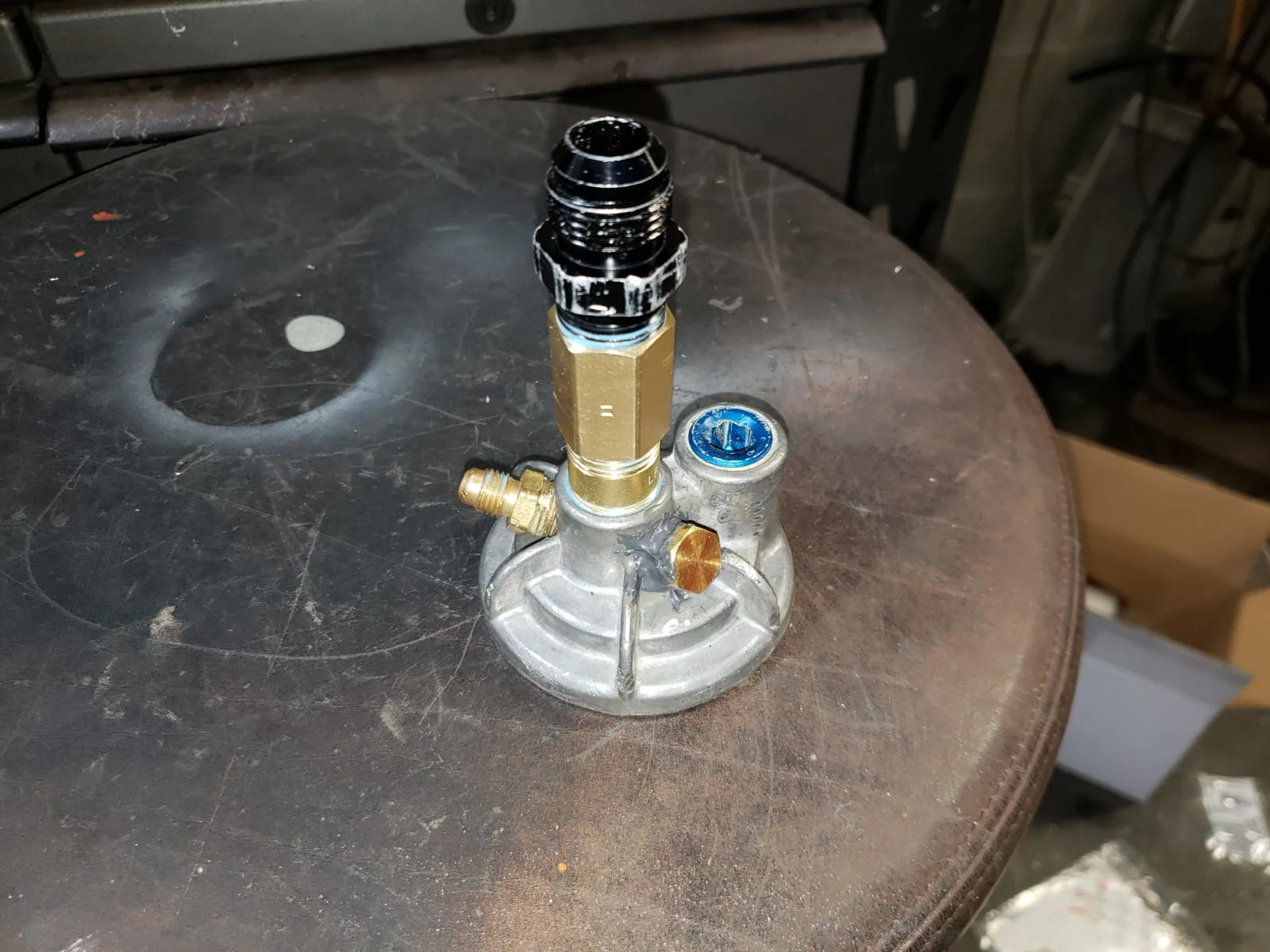

Of the two adapters I have, this one is now killed..courtesy of a too agressive drill angle.
The hole drills through two surfaces, and exposes the inner return to the open drain directly into the pan that used to have a cam driven oil pump feeding..
Now there's just a hole there...like I said...huge oil leak..straight into the pan.
This is why I decided to start with the spare adapter...if anything looks like a potential disaster..its this thing.
But, here it is,..sporting a plugged up first attempt, a currently working -4 second attempt,...and the newly extended return fitting that will allow the lower radiator hose to fit.

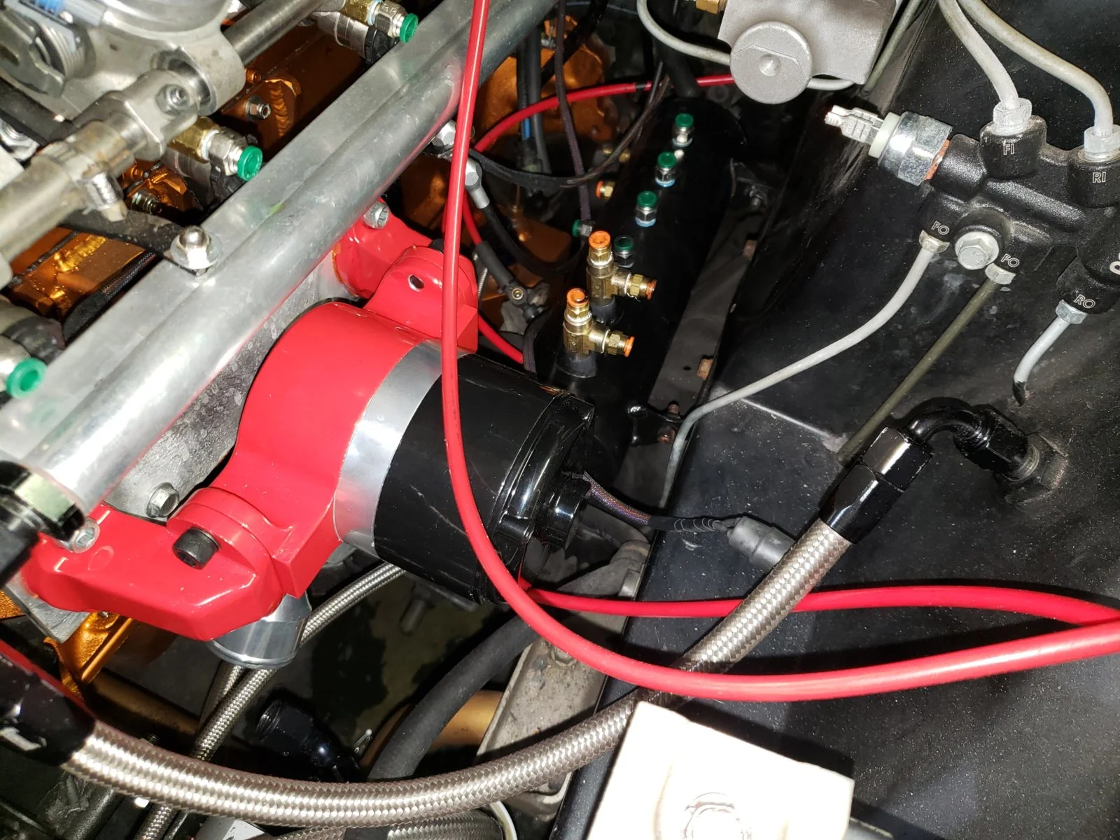

The new pump, the newly sealed iron lung,..waiting on their respective hoses to make them work..

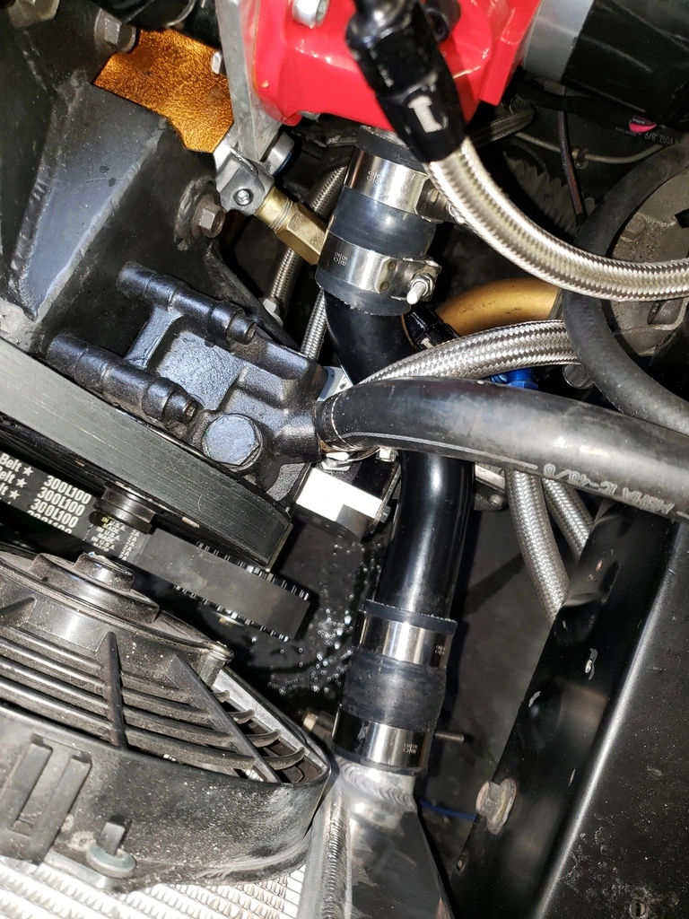

That oil filter adapter that looked so scary is in fact leaking...oil is getting past the 1/2" pipe nipple that you had to buy to extend the oil return hose far enough down to get the lower radiator hose to fit..And tightening the thing doesn't make one damn bit of a difference.
It's gonna need something else.

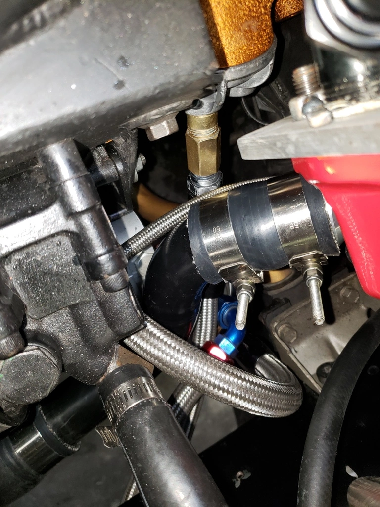

This was right after I bolted it all up,...pleased as punch that the lower radiator hose, just barely sneaks past everything else..
And there that leaky btch is..again before starting it and the leak starts...it's coming out of the threaded portion where it screws into the aluminum adapter....I'm gonna fix it the way I fix everything that has the potential to leak...I'm not gonna use Teflon as a sealant this time,....I'm taking it back apart,..cleaning it all up,...and I'm gonna use JB Weld as a thread sealant..works Everytime.

Ultimately, I gotta stop the stinkin oil leak. I'm ordering a new oil filter adapter thing, and a couple of fittings so that I can rule that leak out. I'll order it today, it'll be here tomorrow.

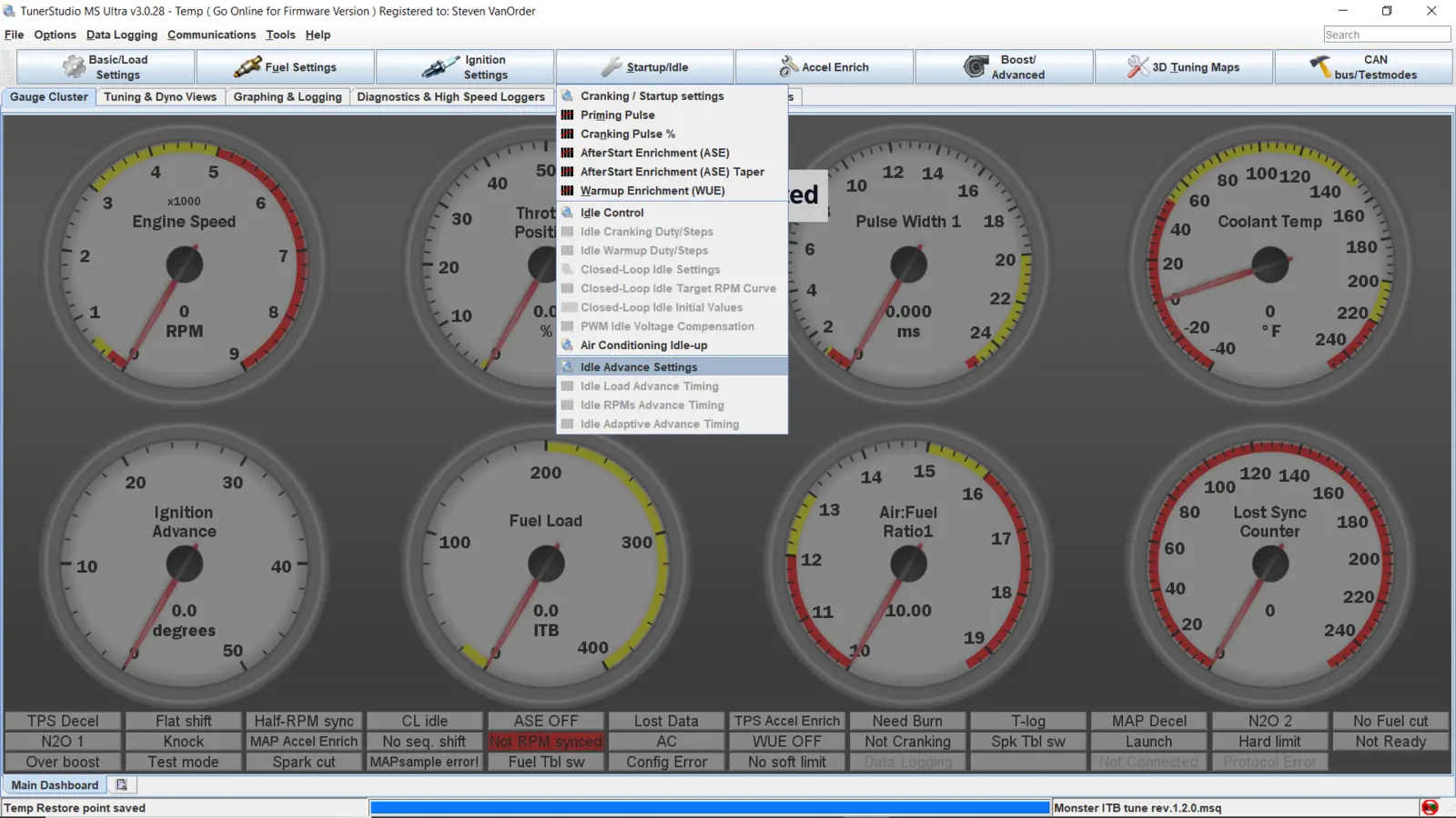

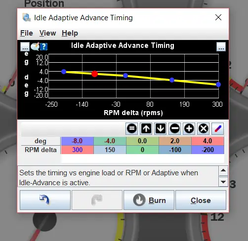

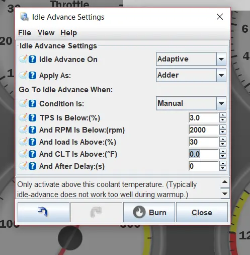

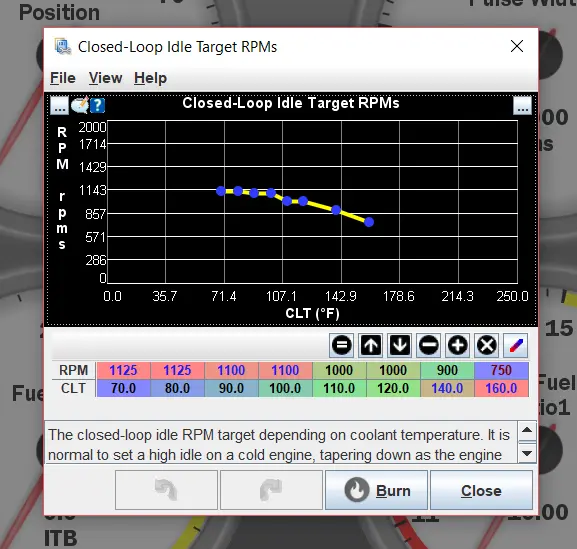

I have a simple fix for this, these pictures will show you how to setup the 3 tables to enable timing to help control idle speed. Its also cold as EFF right now still and your air is much denser than it was when we tuned the car.

Mike, I seem to remember the idle never really being that high on your engine... now lets assume something is more efficient or otherwise affecting the car, you idle with the timing to a set number, something to the order of 26* or some-such. If the engine picks up speed and moves into an area of the ignition map where the timing starts to rise, then the idle will "run away" with the timing.
Yeah,....I see that..but it's not cold here..it was 70 when I started that thing. I think you're right though..I had the computer running, it was showing 31 degrees timing when I shut it off.

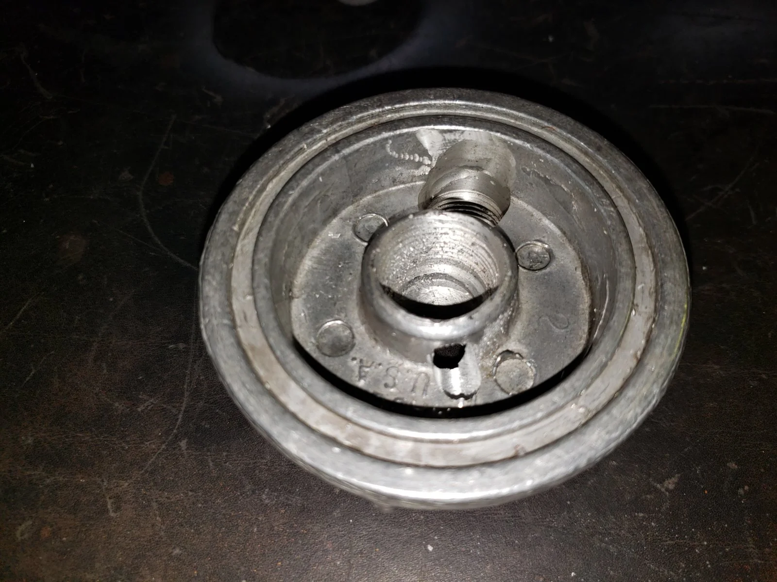

Well,.....I thought that I was gonna take the old filter adapter apart, and stick it back together using JB Weld.
Not today...
The thing is seized..it would destroy any chance of reusing it even if I could get it apart.
It’s all good though....that thing had been around the block a few times, and has been on more than one engine I’ve cobbled together. Truth be told....Its time to buy a new one.

So I have a choice now.. Inside this box is the same adapter that I had before I seized the fitting into it. It's the same replacement adapter that is currently on the engine this instant.
The difference is that the piece that extends the oil hose fitting low enough to clear the lower radiator hose is one piece, as opposed to 3. And,..it's made of aluminum. So it'll actually mate up with the adapter better than the brass nipple that is screwed into the one on the engine.

Steve sent me pictures of what I need to do control my runaway engine timing ( if that is what is actually happening). Problem is that they are.....pictures....I need,..words too.

It's not megasquirt, but on my Holley I read a good idle timing article once. You can create a stable idle speed by manipulating the cells around your target idle. You can do this to both the fuel and ignition maps. I think at my target rpm, 800, my advance is 26. Iirc, because of the limited resolution of the C950, the next block is 1050. So at 1050, the advance drops to 22. So if the engine starts to creep up, the timing goes down which helps stabilize the idle. If the idle fell towards 650, the timing would bump up. It worked great to keep it from surging at idle.
I'm sure you'll get it sorted, but it took me a minute to wrap my head around how that worked.

yup thats timing control 101..... but the megasquirt has a table called "idle advanced settings" that let you build that same idle timing loop your talking about without having to manipulate the timing table. It follows the CL idle curve for idle speed you set in the ECU, this is how i get big cam cars to idle like mild cam cars:)
Ok, ..gotta do this, and get the computer booted before I call obi wan to get verbal instructions to set a timing table...
Purely from an aesthetic...I just can't put the Frank-n-filter on when there is a much prettier solution.
