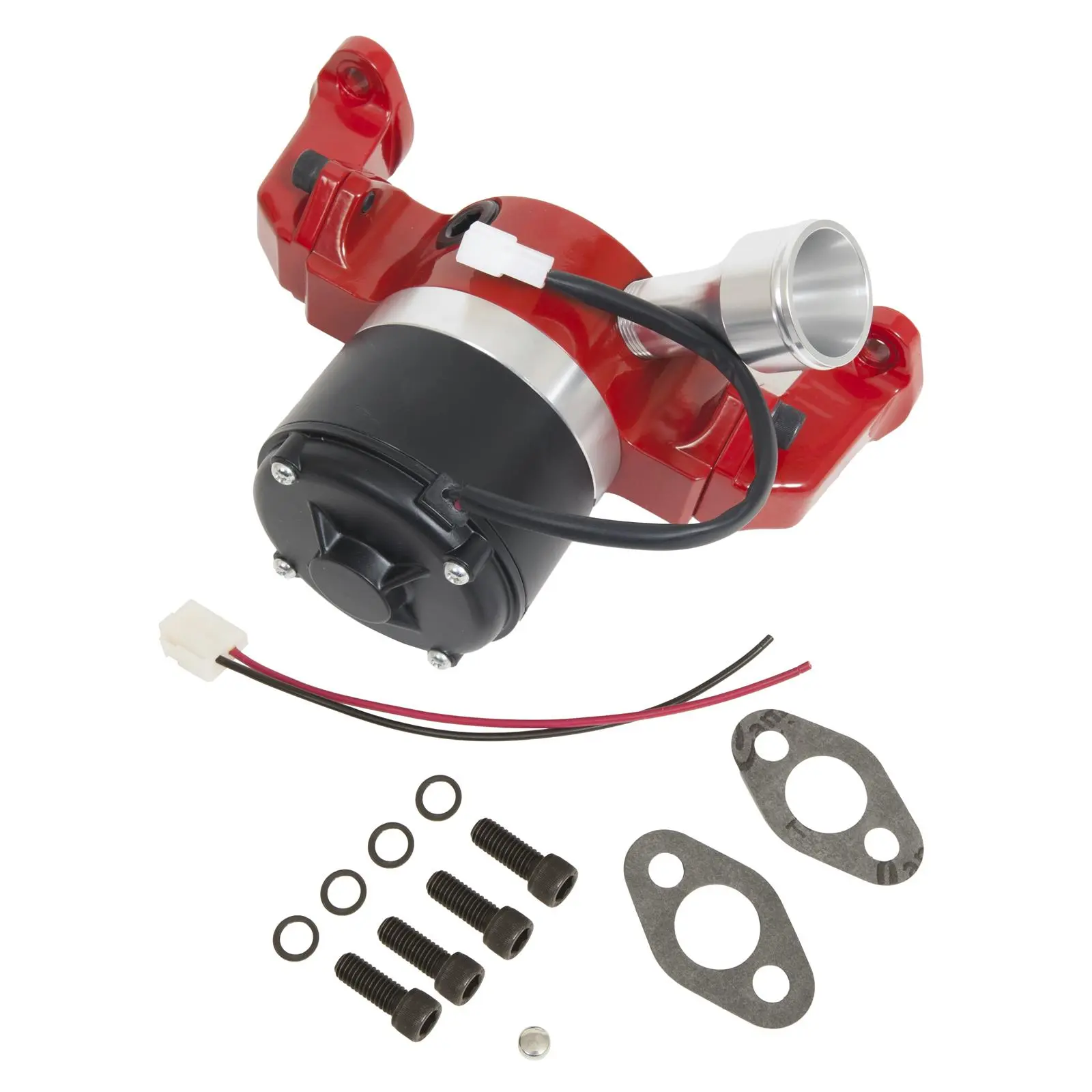

The water pump no worky...There was a time last year that I took the thing apart, cause I was gonna do something to modify it...it appears that I fcked it up...cause now it doesn't move water.
The engine started on the first crank. It ran too fast, and it ran to lean. I shut it off knowing that something was leaking air, unfortunately, there is no way to check it. I recalibrated the o2 sensor, and it came within tolerable spec, but it still rant too fast.
And, it was getting hot fast.
So,....I hooked up the computer to the ecu and did some I/O checking to see if that freakin water pump was turning on ( cause you can't hear the damn thing with all of the rest of the engine noises). It was...but barely making a whirring sound. And when you look in the radiator,...there ain't sht happenin in there.
So I cost myself 200.00 messing around with the old pump. Cause that what a new one costs. They say when something dies, any fluids that were in the thing "leak out":eek:.. So,...I pulled the pump........
Sure enough...this btch is dead.
This was a proform,.I ordered a Summit piece this time around... ( they're copying CVR..it's kinda the same looking thing like above, but draws less current). Regardless,...it's still a damn SBChevy piece.
I also ordered one of those high flow t stats...it'll all be here tomorrow.

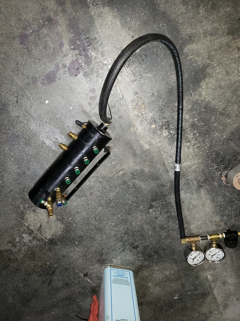

I removed the iron lung..and rigged up a pressure testing thing-a-majig....it's leaking like a pig...
Clearly, this is where my RPM increase is coming from......I don't know what I'm gonna do to fix this...there are so many fittings,.... Several of them leaking.....I'm thinking I'm changing this hard stuff over to convention barbs, and rubber hoses...
The transmission dipstick leaks like a btch...the tail shaft still leaks...it's still on the WTF list.. There was no water in the head when I removed the T stat housing,....piece of sht pump didn't move any water into the engine...that all changes when the new stuff gets here.
