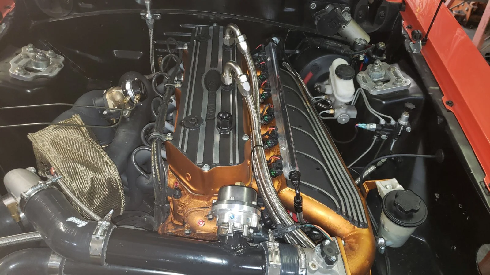

Ok,...Just got back after an auto tune,....and a full pull off of auto tune...
Ahem...
Without the freakin boost duty controller doing a damn thing..I now have exactly 10 p.s.i. of boost. Clearly the spring that is in this new waste gate is a 10 pounder.
This whole time that I've had this setup ( new Chinee turbo, new waste gate, ITB's) That ITB "hat" has been leaking boost like a bitch.
10 PSI before left the engine a freakin oily assed disaster but this time around,..courtesy of the new Puke Troll...
clean as a whistle.
So,...provided I haven't hurt anything ( which I haven't,...the pull was as clean as you could ask for) it's time to ramp up the EBC..IIRC, nothing happened with that thing till the controller was set to 50% .....page 297 tells that tale..
It's clean, It's waxed, nothin left to do but drive it. Think I'll take it to the Mccalla cruise in.

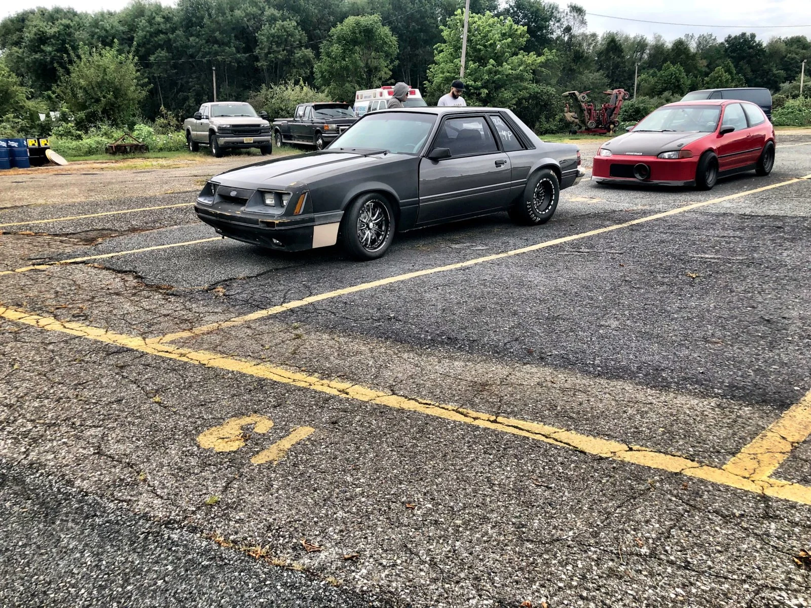

And we arrive w/o incident

I like the new wheels Mike. The Monster looks sweet.

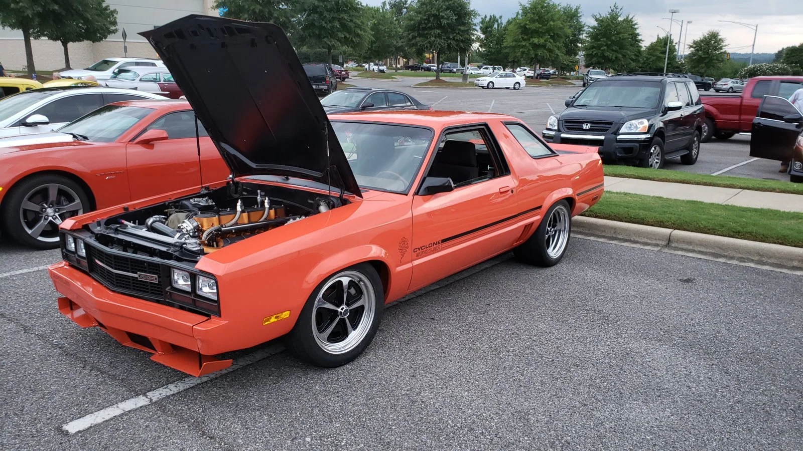

Two years ago, ( or page 297,of this thread, however you keep track of time) I had just moved into this house. Had the twin scroll BW turbo on the engine, and had finally figured out the electronic boost controller..Back then, I had two 7 pound Wastegate's on the engine. When I finally got to experience a full throttle pull at 11.9 psi in this car...I think I posted something more or less to the effect like "Oh My God!!"
No sooner had I said that, I was struck with an overwhelming case of Stupid, and I removed that turbo, claiming that the effect boost had on me was like a drug, and that I was on a path to blow up the engine if I kept the turbo on it. Because like Crack,......I had now experienced the green fairy,..and I'd want more and more boost until the engine came apart.
And this was after a slow roll in first gear.
We all know what happens afterwards...N/A, ITB's, forged rods, new sleeves, turbo comes back, blow by, glass top box, boost leakage, won't make over 5psi...Blah-blah-blahh.....That about brings us to this evening.
Different turbo, same engine. Same slow roll..
OH MY GOD!!!
I'm gonna blow up my engine.

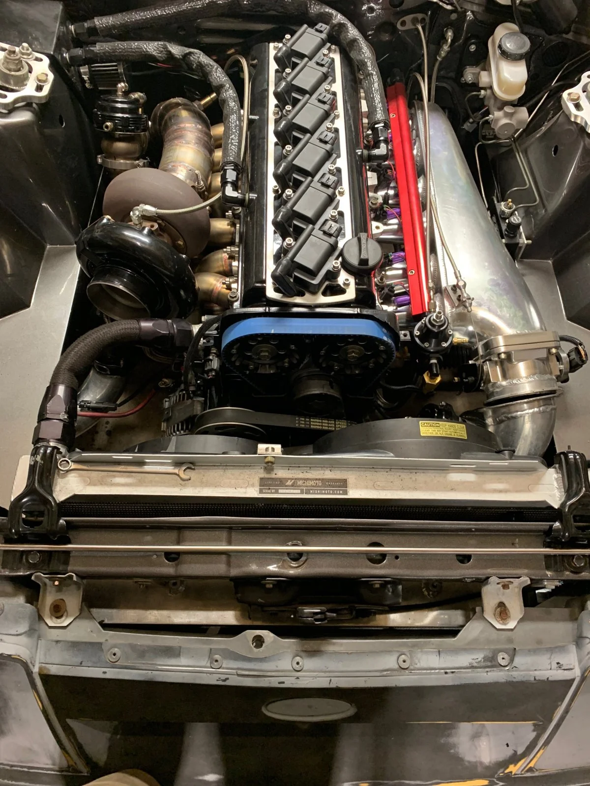

We did this over 2-3 years ago in my buddies 86 which just got re done with a 10:1 version . We have been doing that car prob over 5-6 years now I helped him prep to paint , mock engine up to make mounts etc .
Also another friend here has a reef notch with a 2j.
8 years ago someone on supra forums did a mint white coupe in Cali.
Body work will be finished this season . Reason he didn’t paint nose was because he didn’t want to keep making changes and risk the paint . Rest is mint . Gas door even shaved cuz it has a cell . We did this whole car including assy the first engine in his over size 1 car garage . Mini tub , all body work , 3/4 of the paint , cage , interior , haltech wiring you name it .

Don't apologize, aside from the coil packs on the valve cover, and the obvious dual cam gears, that engine looks a lot like mine.I'm gonna tap you as a source for info when I get closer to the end of the year. When you google 2jz engine for sale, there are several importers that pop up with pics of engines out of Japanese Lexus models that aren't sold here. If you can tell me what to look for as a starting point,..ill buy one of those engines.
Provided I can adapt that engine to an SBF trans bell.
