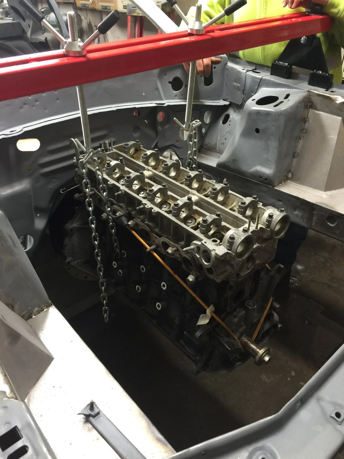

Engine - this long block was from a soarer originally which is a JDM counter part of a us Lexus sc300 . The JDM got the turbo engine which are originally twins . This year this car got the expensive single turbo manifold but before had the eBay variant like the intake manifold . Chinese and cheap but worked .
If it were me . Spend the extra on a non VVTI engine . Makes life simple they drive just as good . Those coils are IGN1a which is what all the high hp guys are going too . This had LS coils on it before. My buddy said night and day diff from startup to everything on down . Same with the cresssida I posted had stock Toyota coils and he went to these too to aleviate a high rpm breakup issue in 3rd . Now he’s running .028 gap vs the .017 he had to run before to not have blow out .

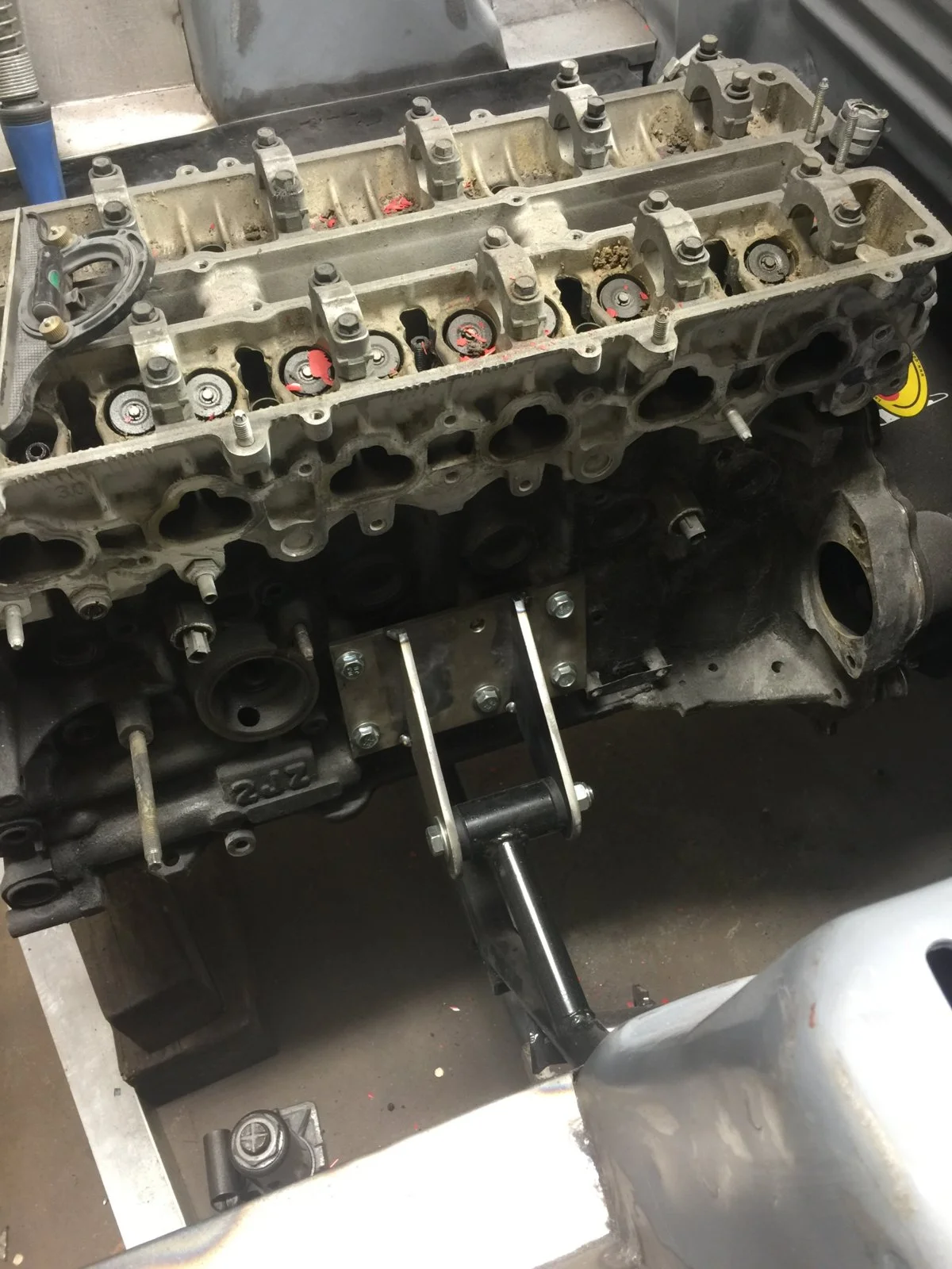

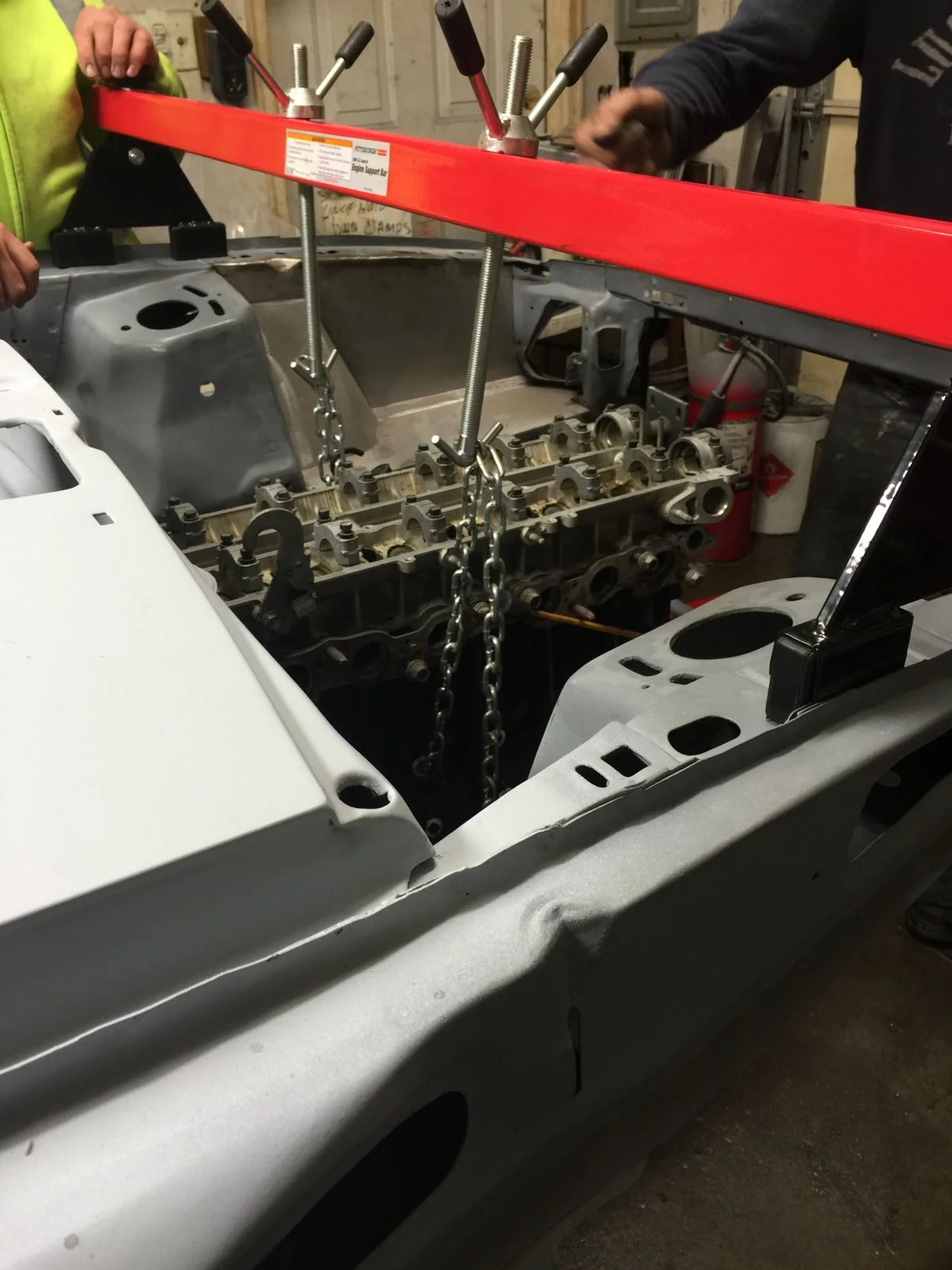

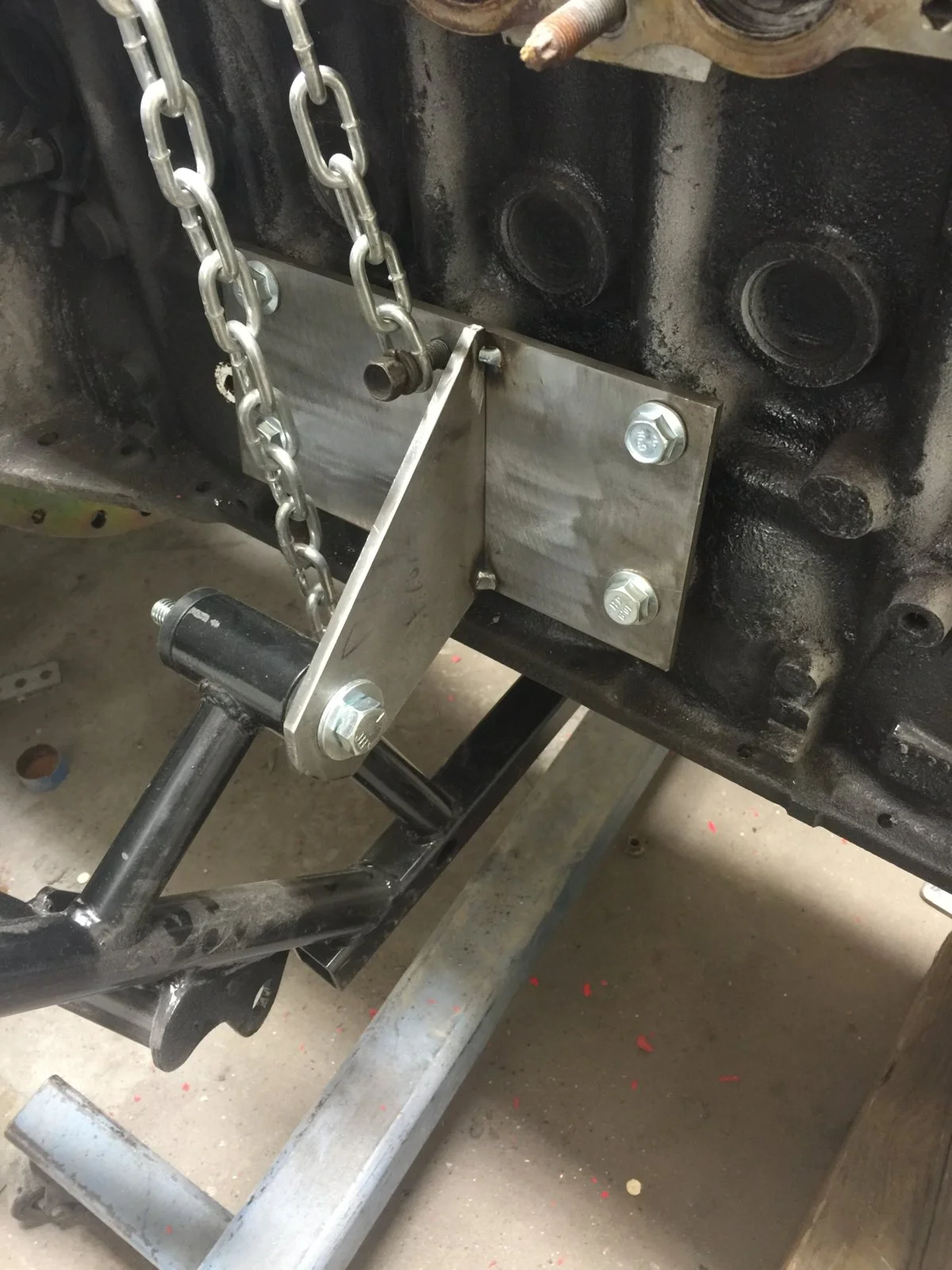

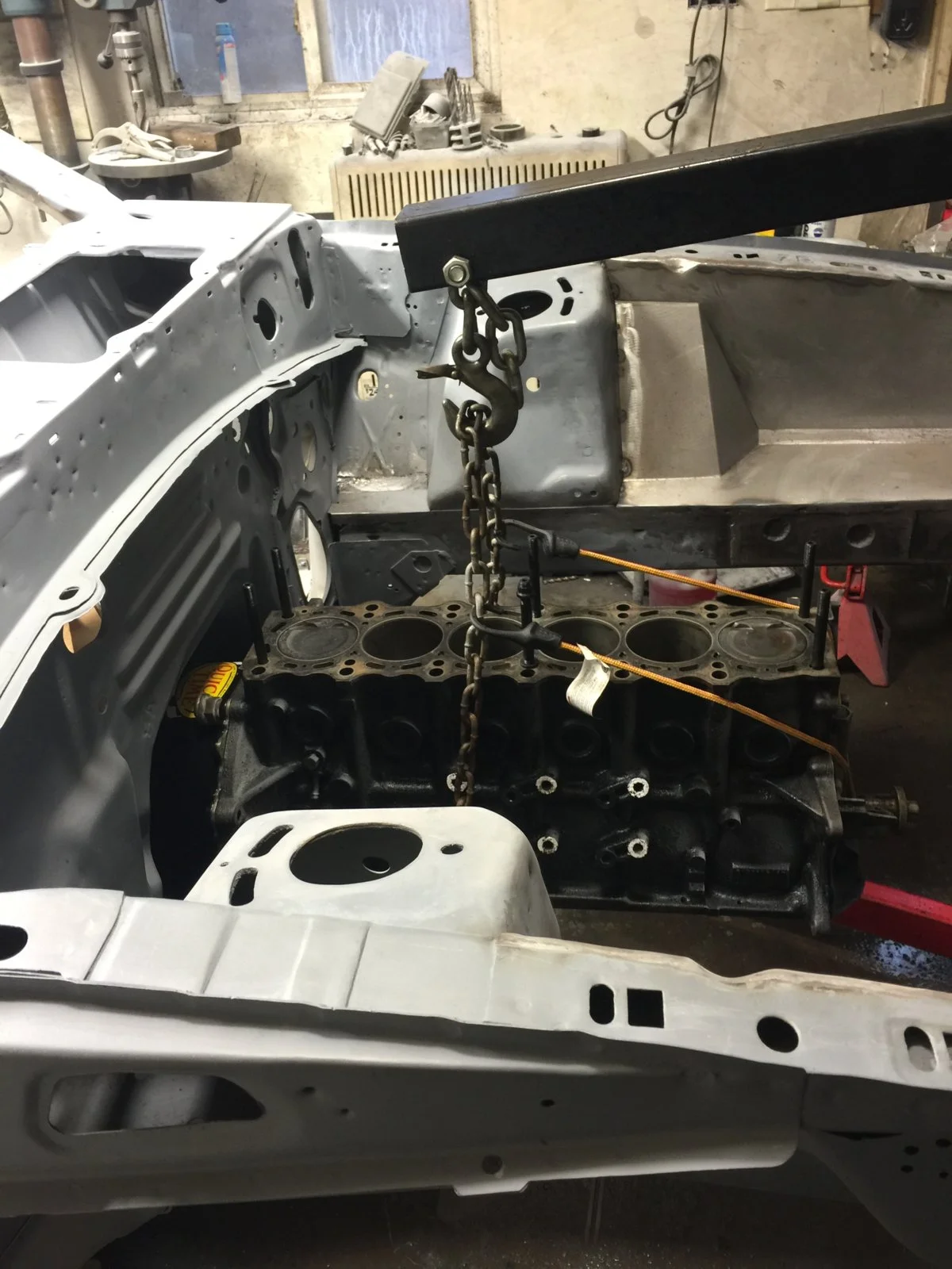

This was as we were making them. They got welded on each side of course and then re checked to make sure the engine was sitting straight . Dummy Trans was in x member as well and it’s place . You see why the aje makes this easy.
They are cheaper k members but I have used them for BBC , coyotes and This and no issues . My other buddy with the reef car got all his info from me and used the same k as well

Clearly, I'm not bothered by having to make it fit..are they all front sump? How does that work with the rack?
They have front and rear sump this was a mock up non turbo engine . I clearly remember us still having to slightly modify the pan to clear the rack and he did end up dropping the rack mount in the end of all of it . No issues with it that way. I don’t have the pics of that night when we did all that .

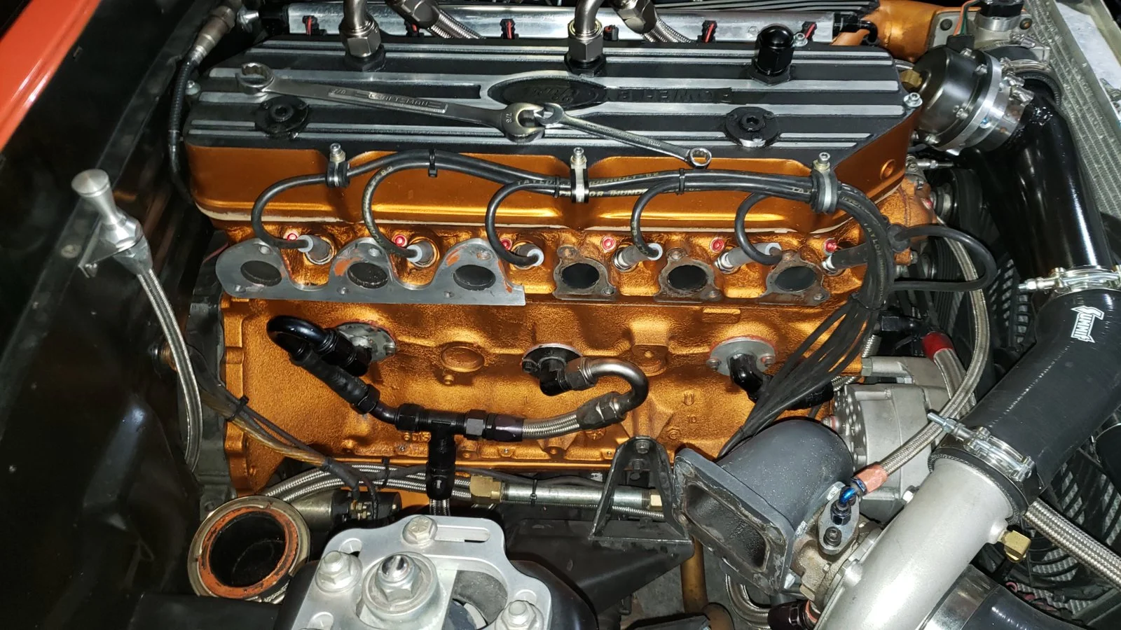

You gotta admit it Noobz,.....that engine looks eerily similar to mine.
( only I'll bet that shiny polished intake isn't hand made......at least not by the owner)
In a Chinese factory . The owner did cut the end off and turn the throttle body flange much straighter to what you see there and weld it back on because it was legit pointing at the frame rail being for a supra

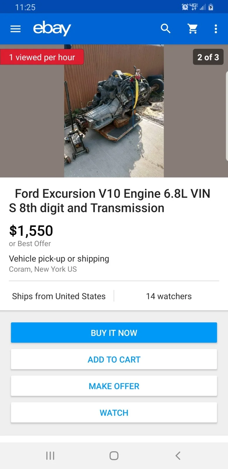

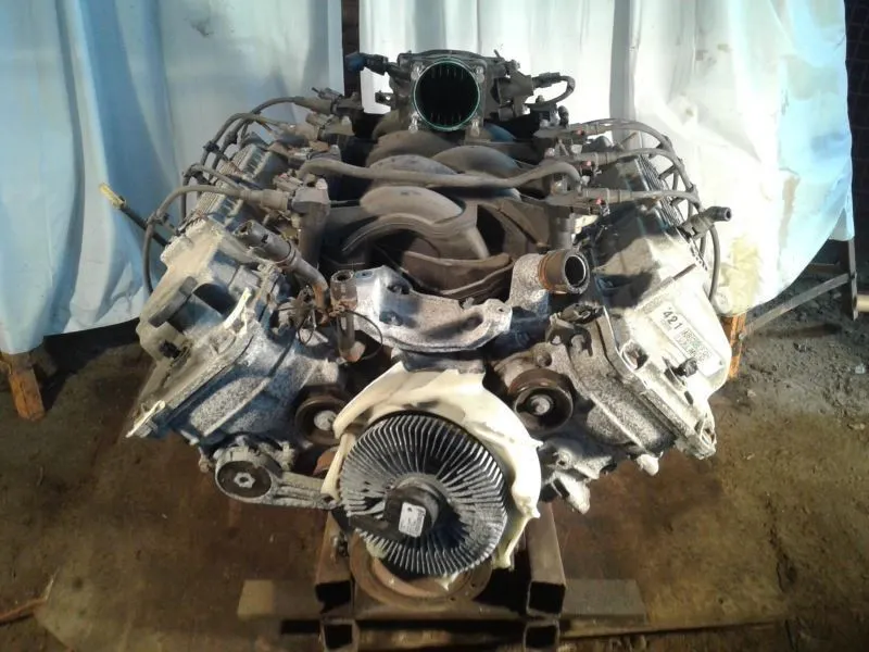

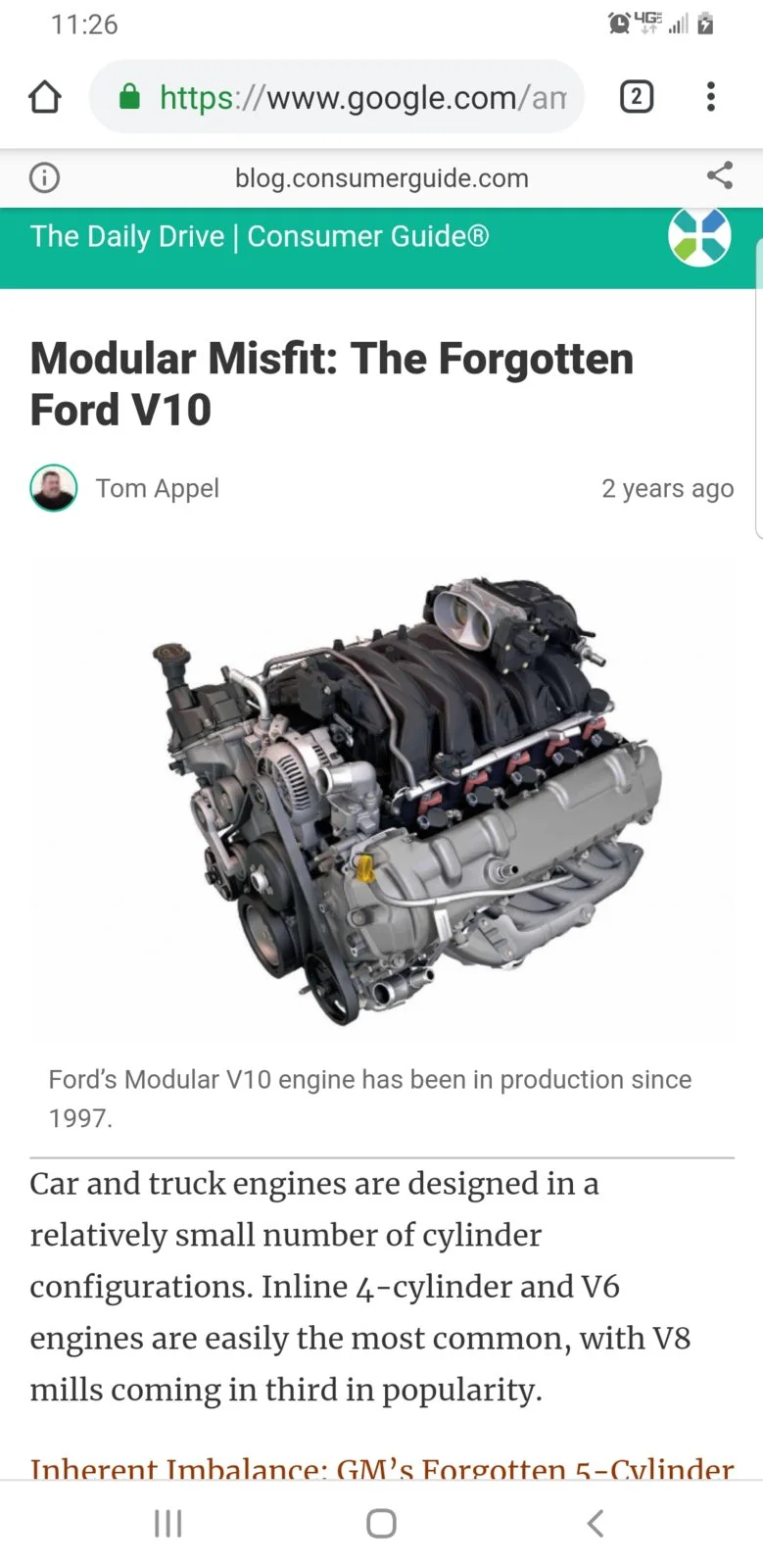

Hey Mike.... It looks like you made up your mind....but what about the ford v10. I havent seen that in anything. Same internals as a 5.4. Then again... I don't think megasquirt can run it. I think MS can only do the viper v10.
That would be cool though.
Could buy it and sell the transmission to recouped some money. I was going to swap one in my convertible but would have to move the radiator to the rear in the trunk. Couldn't find a controller for it. The factory ECU needs some info from the transmission to work properly. I do know ford put it in a new edge mustang test mule. Couldn't imagine how ridiculous it would be with a turbo.
The 2jz is cheap....easy....and common in just about anything. The v10 is at least worthy of you doing a little research.
