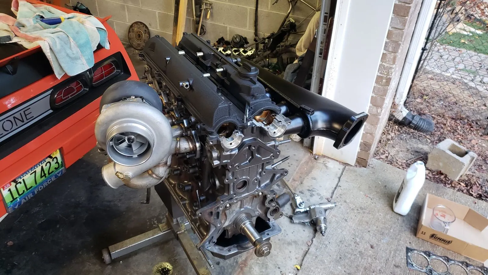

I think I'll work backwards tonight..cause this project is surely going that way.

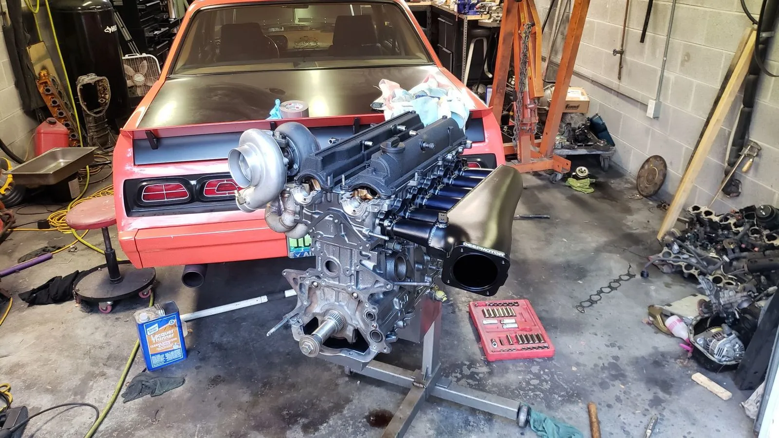

I started out this morning thinking that I would be able to get the engine cleaned and painted, and then work on getting the monster engine out.
I got the engine clean enough to paint. I wanted to paint it in a Titanium, but that color wasn't available as an engine paint. There aren't any choices at the local auto parts stores,...they all have removed most of their engine paint in favor of plast-dip junk.
I eventually chose a wheel paint. Its called graphite. It's heat tolerant, and chemical resistant. It'll be the new color.

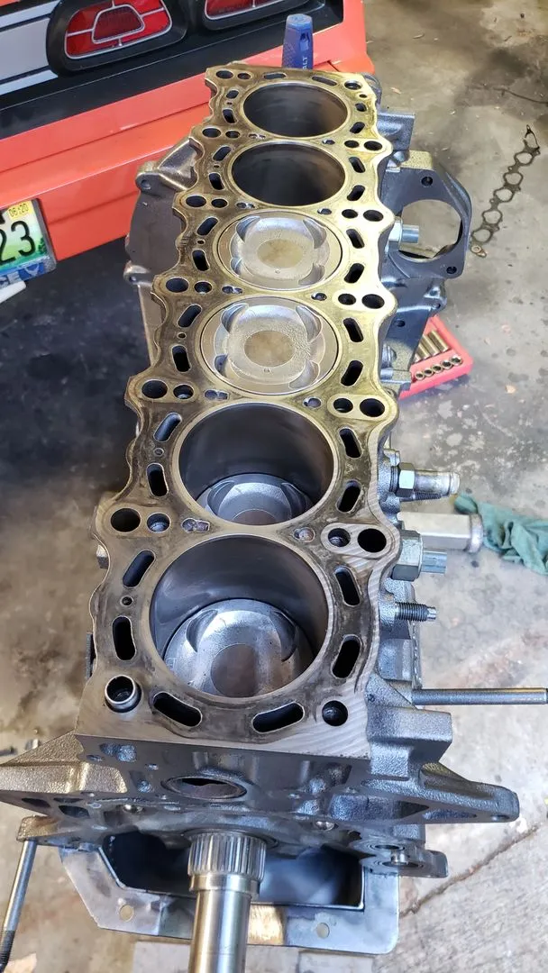

After that I decided to do a leak down test to determine the health of the engine, the spark plugs all looked bad. They were wet with oil. But I didn't know for sure that I didn't do that as a result of of all of the work trying to build the oil pan with the engine upside down, and all of the oil getting into places it's not supposed to.
So I got out my homemade leak down tester, rolled the engine around to TDC on #1, and filled that cylinder with 100 psi.
The leak down gauge read 88 psi. Potentially 12% leakage . But it was a cold engine, and if I can trust the gauge,..I'll take 12%cold.
I checked 6 since it was also up..
Un acceptable. Over 40% blowing by the valves
I removed the cams, thinking maybe since the engine was dry
The valves might be sticking...now all of the valves are closed...I give the springs a little bump with the butt of a hammer to make sure they're seated...still showing 40% leakage., so much air coming through both the exhaust and intake ports that it would eventually blow my hand off if I tried to seal it .
and it was at this point the sht hit the fan.
I removed the head...it doesn't matter anymore.. I got one cylinder that's leaking like a bitch, the plugs show me more are likely doing the same..
It's like a BMW....stem seals that have been heat fatigued, and aren't keeping oil out of the chamber anymore. I need to see the tops of those Pistons....if this is a 50-60k mi. engine, it should have dry carbon on top of the Pistons..
Nope...each chamber is wet...each piston top is wet. I take the wire brush on my drill to them as I rotate the engine...
Each cylinder shows the crosshatch from the hone from 20 years ago,....there is no ridge in the cylinder ...the engine is clean...
Is this just a cylinder head fix?

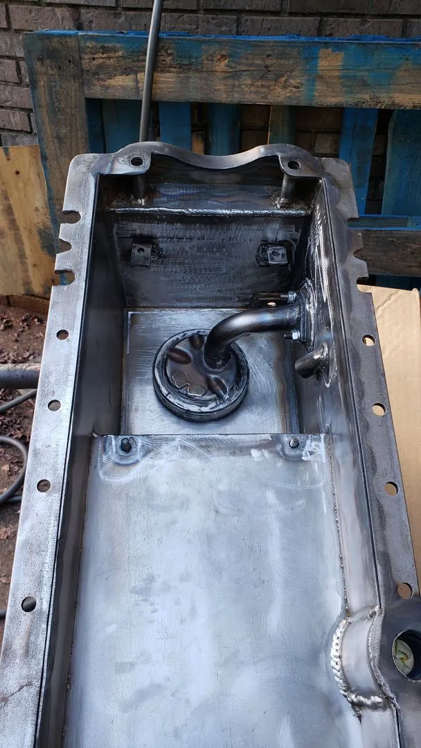

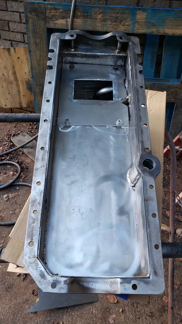

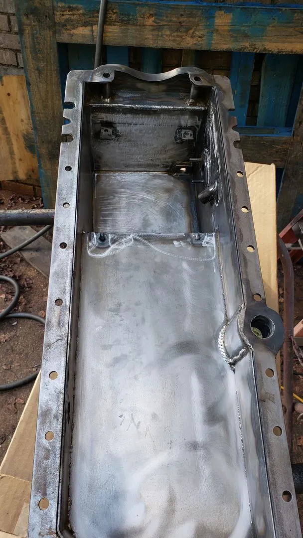

I resign myself to doing what I can do...despite the fact that I've said the the oil pan is 80% done, I decided to do the other 20% and bolt the damn thing on.
So,..this is what the pan looked like before I started...
( Only I've been working on it already...there's now a dipstick port, and bolt down points for a baffle.)
I made this ugly sonofabitch...I wanted to be able to clean it should I ever have to tear it down again considering that it's attached to the side of the pain, and it's another one of a kind.
Once you get that thing clearanced, and bolted to the side of the pan,..the next thing you gotta make is a baffle,.to keep 5 Qts of oil where it belongs..( in the rear sump of your DIY homemade swap pan)
Then that gets bolted on,..using lock washers, and blue lock tite.
Then....nothing left to do but bolt that bitch on.
And you go into your pile of 2jay sht,..and bolt this thing on, and that thing on...
See the head gasket on the ground? The head is only sitting on for the pics.
I was so prepared to buy an oil pump, timing belt, and water pump so i could put this thing back together,..but now, clearly I'm getting the head freshened...who knows how much money that's gonna be?

Mike how is it that you make the rest of us look like we get nothing done? Even with your bionic knees you run circles around most of us.

It costs 200.00 to re-do a 2jz head provided that it only needs the standard valve job. The guy at the shop stated that you could see the #6 chamber has issues just by looking at it.
So...200 more dollars (at least) to add to the swap total.
Given that I have to replace the timing belt..the water pump, and the oil pump (to be safe) that'll add any where between 325.00, and infinity,...
The oil pump is the killer,...I have to get a GTE pump, and not a GE pump. The thing looks the same, but the GTE pump moves more oil. and its a minimum of 175.00
Ive decided that I'm gonna ditch the Cobra Brake booster, and convert back to manual brakes. As much as I drive the thing, and provided that I can get the intersect point modified enough to increase my leverage,..even the boys at MM endorse changing to manual brakes when pedal feel, consistent performance, and getting the necessary clearance for a big assed engine (or in my case, that intake manifold) are objectives in designing a brake system.
As to my cylinder head dilemma,...I'm really curious to see if I can seal up the engine in some way so that I can pressurize each cylinder to determine actual cylinder leakage before I waste anymore money, and have to put the head on to do that, (like a new MLS head gasket) only to find out that I got something wrong elsewhere.
Maybe I go buy some 3/4 MDF and cut two or three layers together tonight. drill the necessary head bolt holes, and a hole in the middle so I can put some sort of fitting in.......I wonder if it would hold 100 psi?

The engine is only being held in by its own weight. Everything is unbolted . The radiator is drained and out, the engine is drained of its oil, the transmission is currently bleeding out as a result of several missing pan bolts that I removed to allow one side to drop. The exhaust is removed, as is the drive shaft.
I could pull the whole thing given another 30 minutes.
But I'm tired, and it's gonna have to wait till tomorrow.
Save for the bolted on accessories, I may as well put the engine on the curb. Factory Forged rods that would cost more to have them removed from the forged Pistons than what they're worth. Pistons that only fit one engine on the planet, that is now cracked between the cylinders, a crank that won't fit another stock 250 because the snout has been machined deeper to accomodate a harmonic balancer intended to fit a SBF. A timing chain set that used to fit a 5.0, but because the chain that it came with was discarded in favor of the shorter chain that's on it,...it also only fits one engine on the planet.
A roller cam that requires major engine modification to retro fit the thing into a US 250 with hardened 3/8" chromoly pushrods to match. Drilled to accept a timing gear that requires the crank be modified to make that work. Maybe if I were in Australia...
There are 12 roller lifters that fit a 460,.....but only 12. There are 12 1.75 ratio stainless steel roller rockers that'll fit a BBF, or a BBC ,....but again, only 12.
Ill pull the oil pump, the cam, lifters, harmonic balancer, head and rockers...( who knows what I'm sposed to do with that sht.) the rest of the rotating system will stay intact,....and go out as scrap.
A tragic end to a story about a mad scientist that combined a bunch of dead stuff from several other sources to build it into one monster, only to have to destroy it in the end because it wasn't meant to be.
