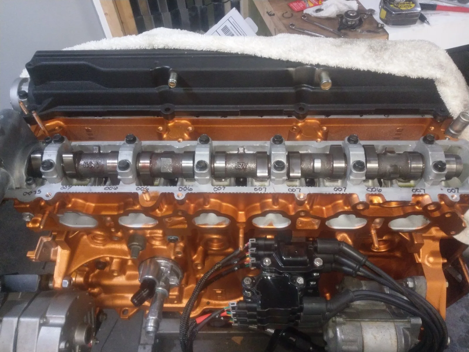

I’ve been dicking around with the intake cam for three days now. I put what shims I had in, torqued the cam down and measured the clearance. Removed the cam, removed the shims, measured the shims and subtracted or added to that to get the target clearance of .006”
Then I went and ordered the shims that should’ve been the answer to this math problem...they come in thicknesses that are approximately .002” larger or smaller depending on which way you need to go.
I did that last Wednesday. Thursday I order them, they’re in Friday.....I install the shims, bolt down the cam, measure the clearance......sht still ain’t right.
On Monday,...I order 4 more shims. They come in today. I go home for lunch, remove the cam, swap out the shims, bolt the cam back down, and measure the clearance....still.......sht ain’t right.
Now it’s down to one valve...it measures at .009 with the shim that measures .116” thick. Simple math should conclude that if I want .007 valve clearance, I need a shim that’s .118” thick...
So that’s what I ordered......... again. One shim that measures .300 millimeters.....or,....in America.... .118”
That thing will be here tomorrow, and I’ll go about the process again. If it brings the clearance into line like it should, every intake valve will be w/I .001” of each other.
Despite the fact that that piece of sht machinist ground the valves off by as far as .009-.010..
That woulda been one noisy, ticking sonofabitch.
