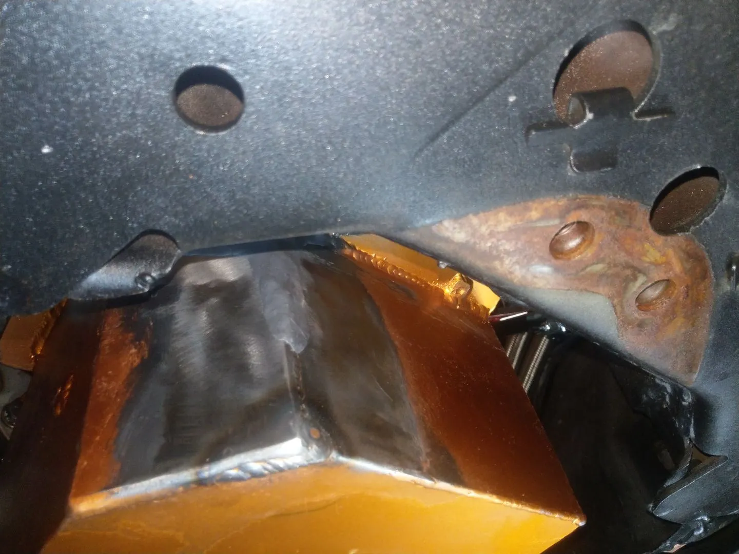

Well,...now that we’re past how each of us prefers our coffee...I attempted external pan fix v1 using a JB weld steel stick.
Cleaned the pan real well and kneaded the piss out of the epoxy ( kinda feel like a cat). Once properly mixed, I blobbed the phck out of the corner of the pan with that sht...
Then went drinking.....
After returning two hours later, I filled the pan with the same oil that’s been in that pan 3 times now......
And tomorrow, we’ll have a look.
As of tonight,....I’m dry as a .....( insert appropriate crude reference point here)
That corner on the bottom is where the hanging chad will appear if this stuff fails to stop the leak...for now,..I’m good.

Is that putty sandable when it’s cured, or is it just goin to be the IDGAF point to the custom pan?
Are you kidding? If I go down there and there is no dripping oil off the corner, that sht will stay exactly like it is. If you think that I care one sniglet of an ounce about what the back corner of an oil pan looks like at this juncture, you don’t know what it’s like to be on the 4th time doing something.
But to answer your question...Of course it’s sandable. If/when I ever have to remove the whole engine again, I’ll sand it.....Off.
Then weld the piss out of it, and leak check the whole freakin pan.

JB weld has kept my Canton oil pan sealed for the last couple years. They had a pinhole in the weld. I ain't messin' wit it.
And that was the case with me..missed a pinhole that was at the top of the sump. Now that I’ve blobbed that steel stick on there, it’s not leaking.
So,...I’m gonna say...FFN.
