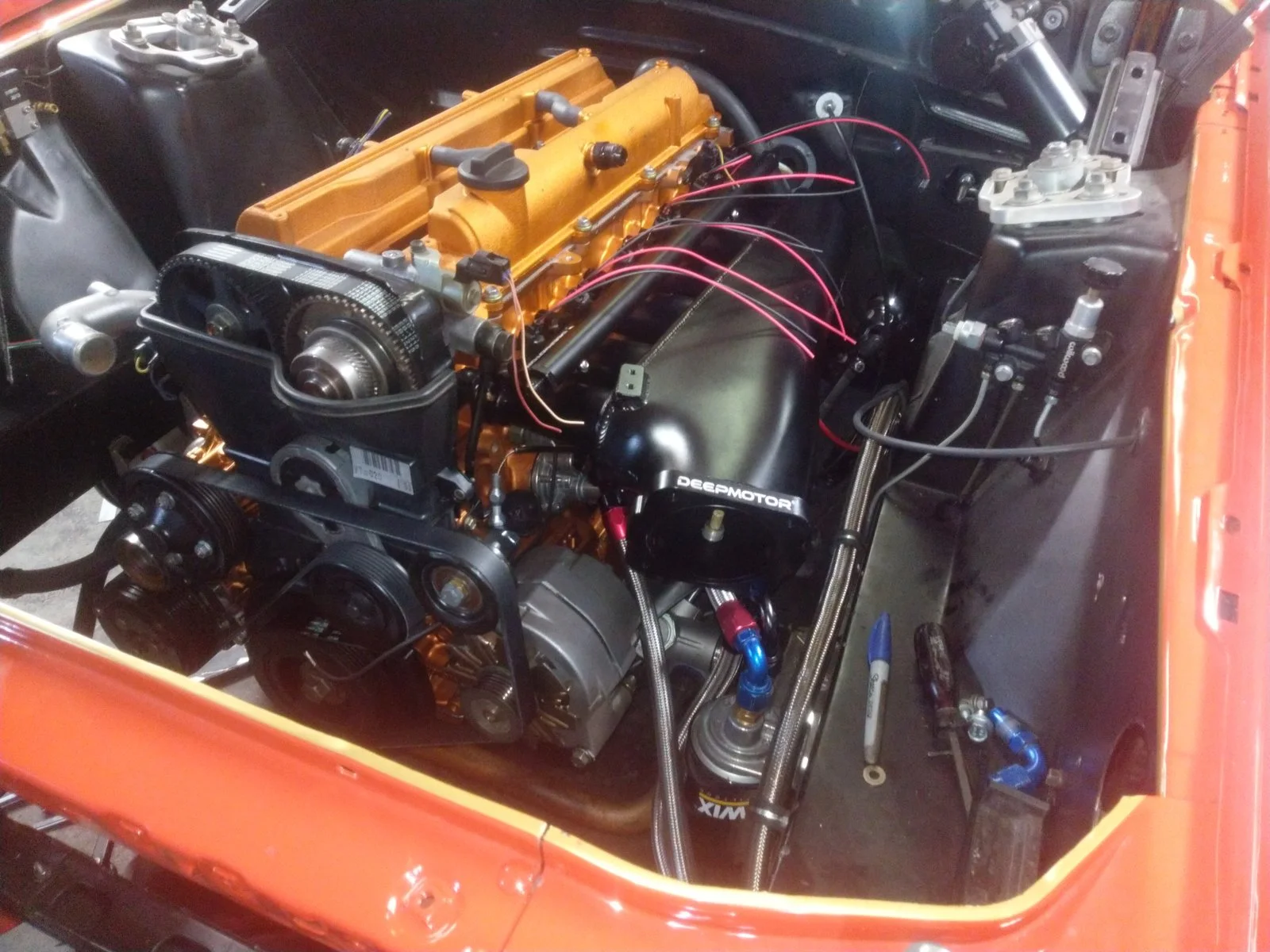

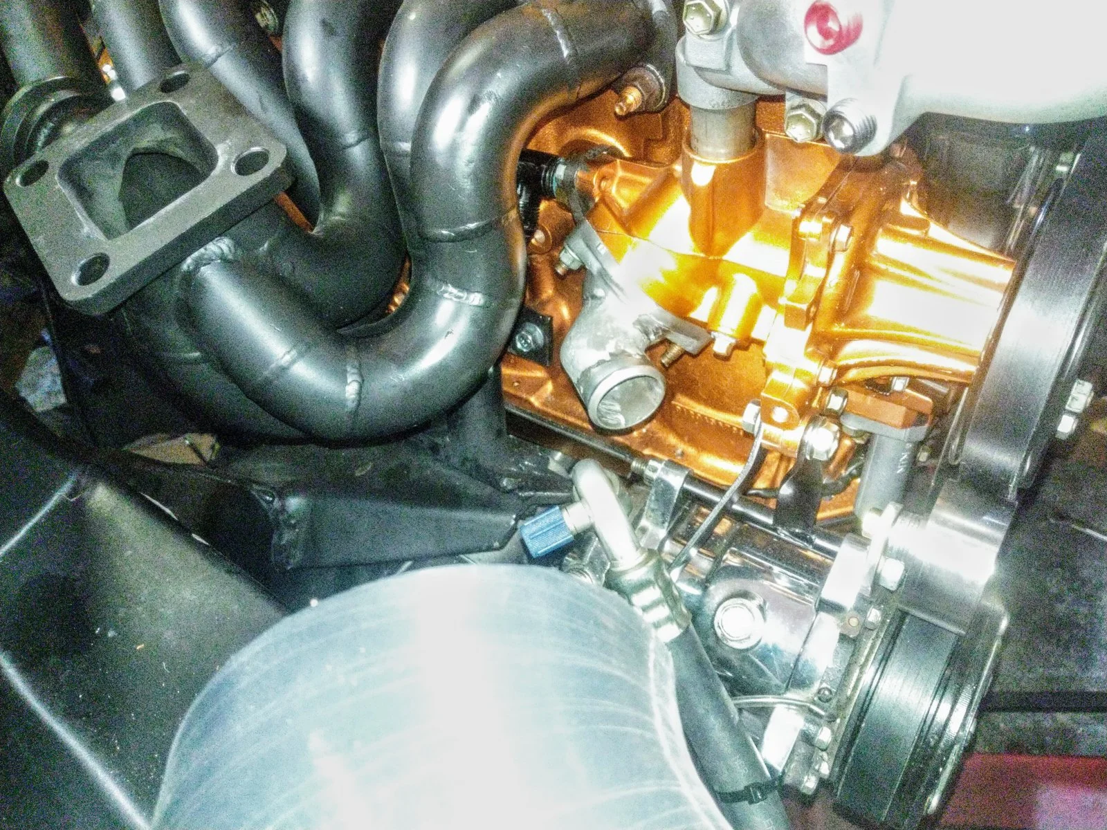

The water outlet crashed into the AC lines, forcing me to hack it up, and get out the spool gun ( I so hate that thing). It had to be radically cut and spliced back together. While welding it, it just seemed like the end result was gonna be fcked up as a rats ass, and be full of pinholes.
But,...after grinding it down, and sticking a flashlight in one end, and stepping into a totally dark room.....
No escaping light. ( At least it looked that way).
I cut up the old factory 2jz harness, and removed each of the pigtails that attached to each of the sensors. I have concerns about some of them. ( TPS sensor has 4 wires, knock sensors are shielded, yet only have one wire,......blah-blah-blah....)

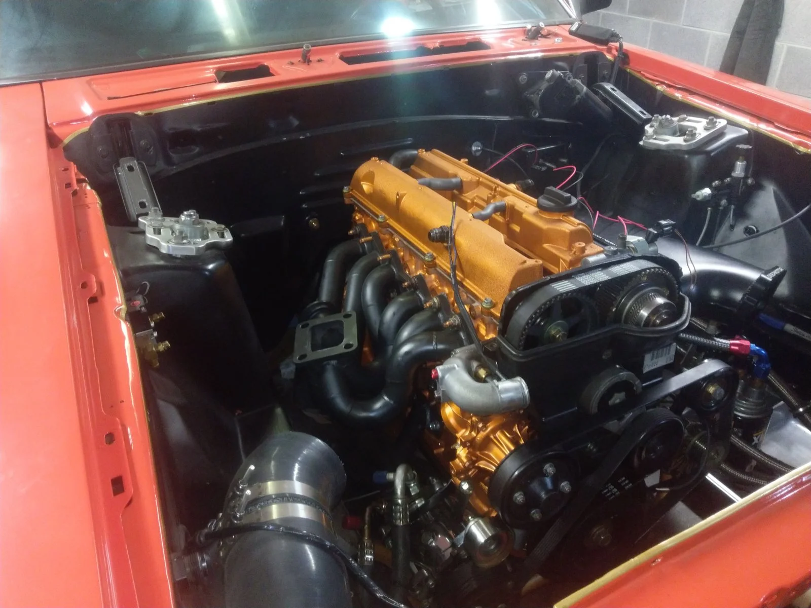

I put the exhaust manifold on, a real pain in my ass to tighten up. ( Note to self...if the engine is ever out again,..install the exhaust header before putting the engine in).

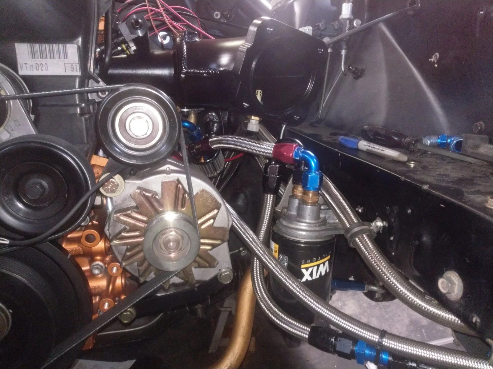

I plumbed the remote filter and oil cooler. ( Which required I install a new oil cooler, as the original one leaked) The problem with that is that the size of the thing has changed since I built the shroud back in 2016. The new 16 row coolers are not as tall...MOF, they're about 1/4" shorter. ( In the grand scheme, much better than them being 1/4" too tall).
The exhaust manifold is on there, I just need to buy some better nuts as opposed to the rusty ones in the pic.
The intake on the other hand is just mocked up. Only held on by two nuts at each end. The purpose was to determine how bad the thing was going to interfere with the water hose at the rear of the engine, and the hole through the firewall where the engine wires will pass through.
I'm gonna have to relocate that grommet. The water hose partially covers it, and that is reason enough to block off the existing pass through, and move it to a different position.
So.....I got that in front of me....before I can move forward.
The Ford IAC valve seems weird to me. Is open now...(You can blow through it...i.e. there is a big assed hole in the intake now).
Hopefully, when that valve sees 12v, it closes, and restricts air. I don't know for sure..ive never had one..besides,..How many of you have put your intake manifold up to your mouth and blew through the inlet of your IAC valve?.........
Well?
Like I thought...nobody.

Many years ago, I worked for a guy who ran cars on the Toyota Formula Atlantic circuit (Indy car type cars). He swore by WIX filters. Seeing that one on your car brought back some memories......... but wondering about your thoughts/ opinions on them.
There was a display of one that was cut apart in one of the AP stores I was in. After you see that, it doesn’t take a lot to choose it over the rest.
Reactions: Rdub6
NAPA filters are also made by WIX. There are many a you-tube video comparing oil filters, pretty much anything is better than Fram :ack:
