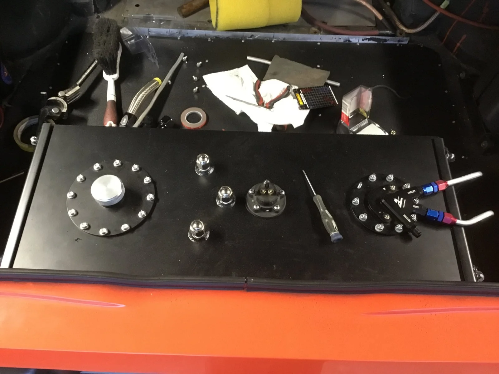

The cell is full of foam, and mounted. Stupid Amazon sent the two hard line fittings that go on the return port of the pump in two separate shipments.One each in a padded envelope. I have one, but the other fitting is in LaLa land.

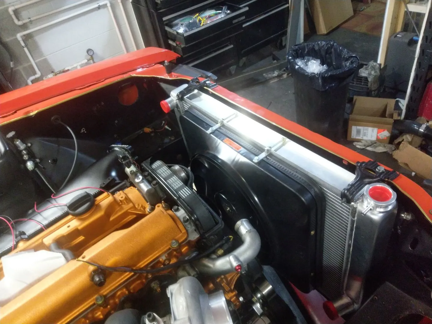

The Chevy radiator is mounted, as is the CATSUCKER 3 cooling fan.

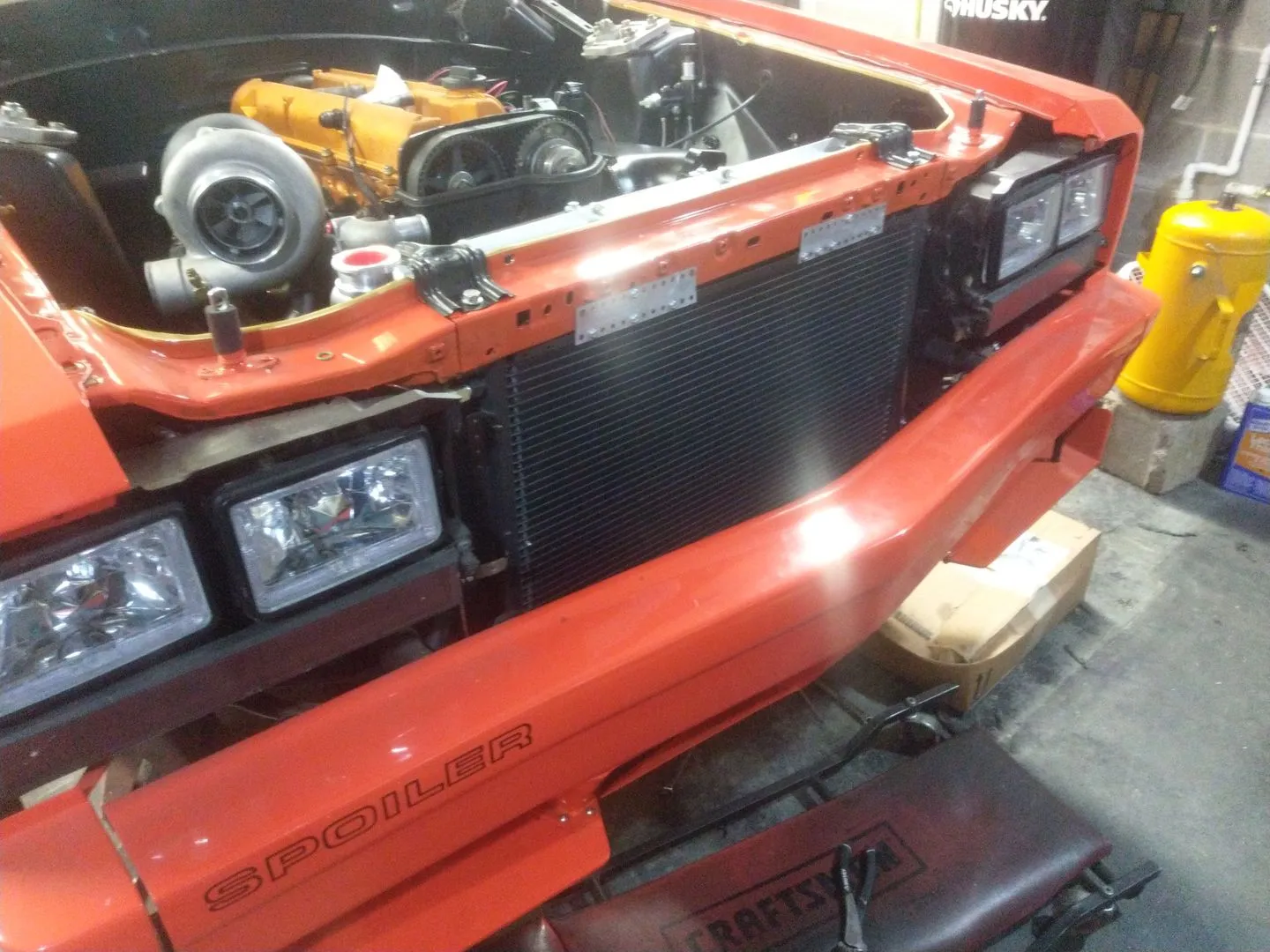

The “ much larger than before” AC condenser is mounted, and the lines are attached. That puts the AC system fully in the “Done” box.

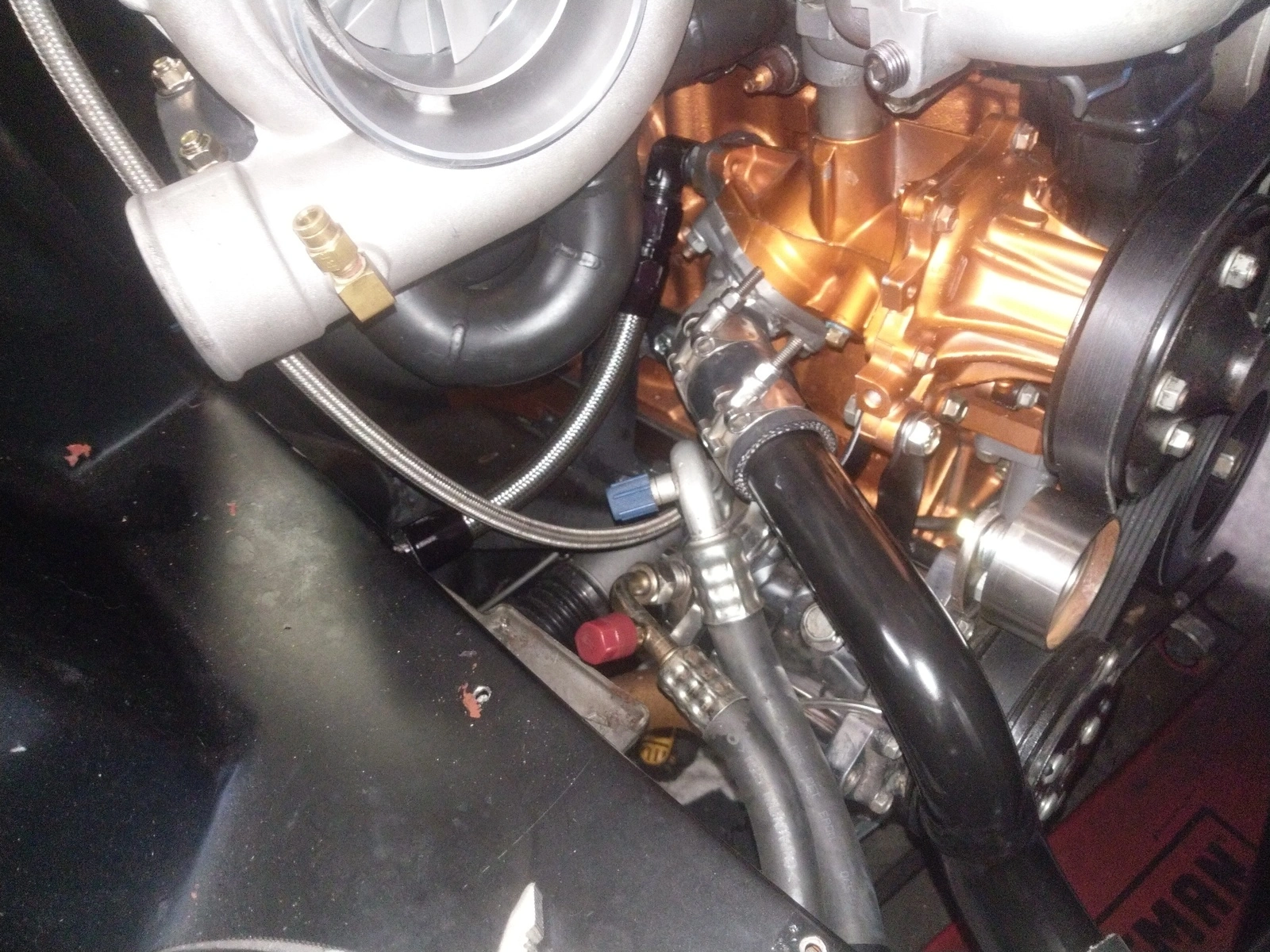

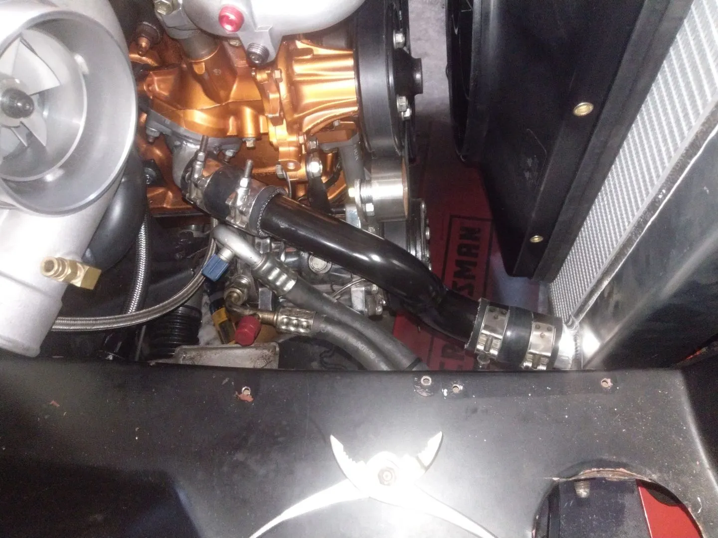

The upper and lower radiator hoses are made out of steel. They are done. Waiting on paint to dry. Each end of the steel “ hose” has a section of silicone hose clamped on it so it can be installed. All that is left after the paint dries is to get a new Tstat, and put them on.

Thermostat is installed, along with the lower lower radiator hose, the heater return hose, and the turbo oil supply.
The turbo drain line is gonna require a 35.00 fitting to get the drain hose away from the header. The cold side will have to be completely rebuilt. I was gonna use 3” stuff like I did last time, but there isn’t room for it with the larger Condenser. The turbo outlet is 2.5“, the A2W intercooler is 3”in/3” out, and the Throttle body is 4” I need the extra clearance keeping it 2.5” would give me, but that means I’ll need to buy some tubing, and at least a couple of 2.5” mandrel bends. If it isn’t detrimental to go 2.5“ for about 4.5 feet, then upsize to the 3in IC, then upsize again at the throttle body, then..that’s the way it’s gonna be.

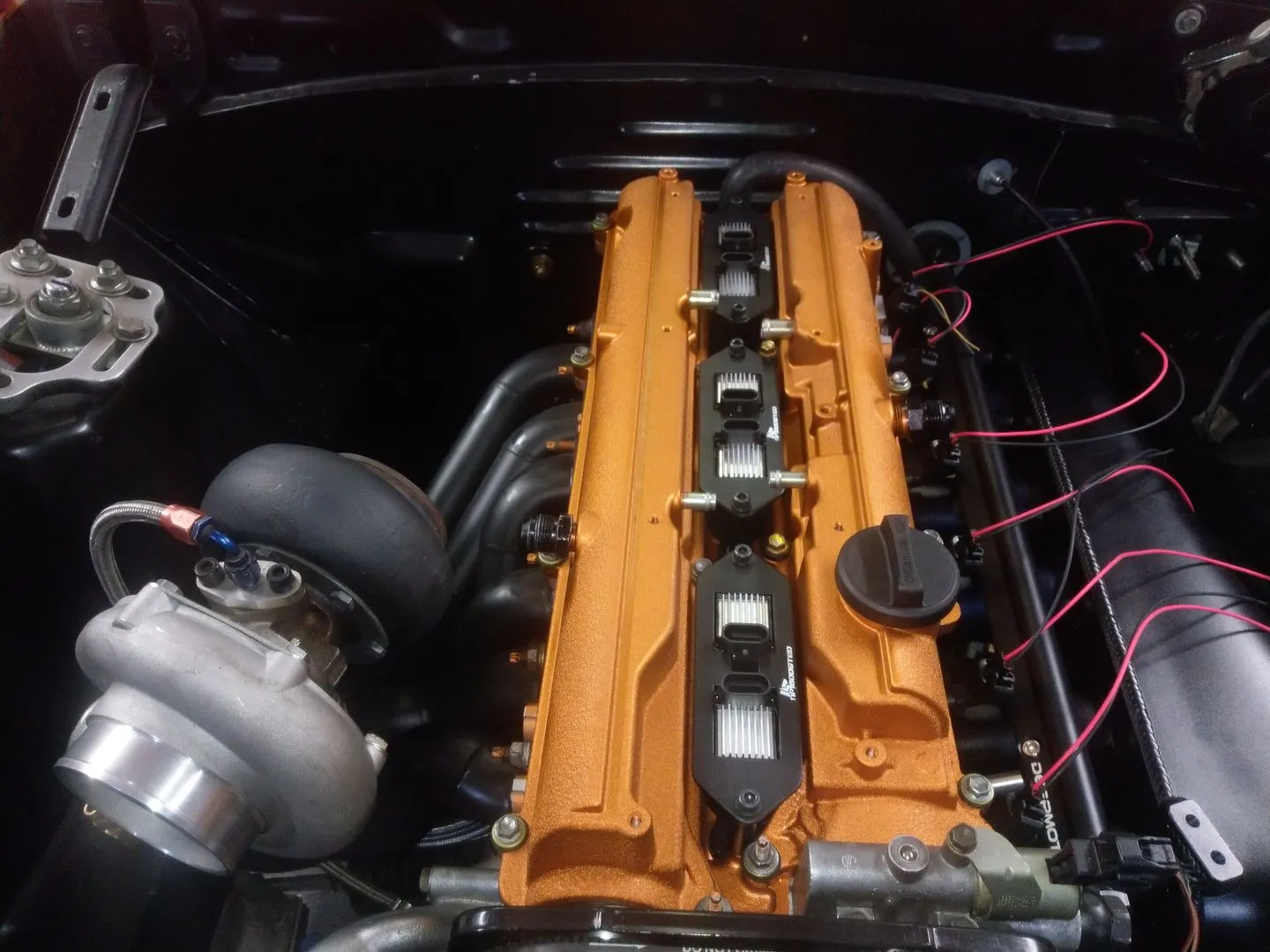

A chicken sht product if there ever was.. the D585 coils have to have the mount bracket removed, the Chinee plug boots have a spring that makes the connection between the coil and the plug inside it as a separate piece. You have to put the spring on the coil, slide the boot on, then push that concoction onto the plug. Then while trying to keep it from pushing itself back off ( because there’s a spring between the coil and spark plug tip) you have to try and screw the hold down plate on top. The really stupid part is that they supply you with a bolt and a spacer that wants to fall into the spark plug valley. If the kit had a stud, you could slide the spacers onto the stud, and put the hold down on top of that much easier.

There’s still a fair amount of work in front of me before I can even hope to be able to fire it up. I’m already second guessing the current coil install ( I think this will actually be 3rd guessing). The fact that the coils are teetering on a spring that is supposed to be the interconnect, and are insulated with a boot that appears to be made from the cheapest rubber that could be used, has me considering one of two different paths:
A. I go and get a piece of 1/8” thick aluminum that will bolt on top of the cam covers, and bolt the d585 coils to that. I have the good short LS plug wires to connect them. The only drawback is that the cam gears and timing belt are exposed. Now I know some guys like that, and it may grow on me, but at this minute...it looks like I’ve left something off. The good thing is that they should be quick and easy to disconnect for spark plug changes/inspection.
B. I make a mount bracket that will bolt on top of the intake to mount the coils to. The freakin throttle body hole is so large, I can get my whole hand inside the intake to put a wrench on a bolt from inside. So drilling a couple of holes and bolting that bracket on top of the intake shouldn’t be difficult. Plug wires could be routed through holes drilled into the existing cam valley cover, and I could use that thing to finish out the top of the engine like I want to. The plus side to this is purely cosmetic. Getting the cover on/off with 6 plug wires running through it will be a pain in the ass, and I’ll have to drill holes in both a 600.00 intake to mount the bracket to, and cut up a stupid expensive to replace 2jzgte cam valley cover. But, again, I have the plug wires to do it this way as well.
So I could go either way,...All I know for sure is that it isn’t staying the way it is.

The coil cover would be easy to modify back to stock if you only put holes big enough for the grommets for the wires. Wouldn't be all that much of a PITA to take off. ( cover would slide up the wires ) Putting holes in the intake could also be welded shut...or plugged. These are all small jobs for a guy like you. Those engines are so hot right now you'd still have no issue selling for decent money. The only way you'd sell is if you blow it up atleast 2 times. That ain't gonna happen...its a 2jz and you're not on a powah quest.
