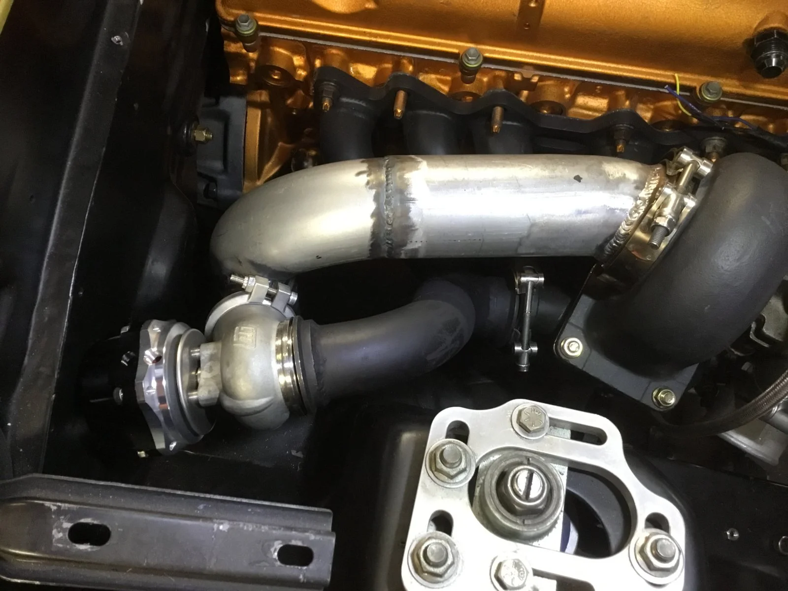

I planned to work exclusively on the turbo hotside. Had that been the case, the last thread title would’ve made sense. ( Especially considering that the exhaust is made up of a short spun catalytic converter, and two magnaflow stainless mufflers that are all “ straight through” design.
There are sooo many loose ends that I can tie up and call done. All I have to do is pick a path, pack a lunch, and by days end I should be sitting comfy on the deck, drinking a Jameson neat, pecking away at this iPad, talking about the battle that I just won.
Today is that day.
And while I’m not proud of this as I could be,...the hotside is kinda done.
Its always the sht that you can’t see that bugs me the most. That S shaped pipe that feeds the enormous waste gate is a freakin jug-phck. Welded, burned through, patched, cut apart and rewelded..to look inside that tube would scare the Chip Fooses of the world to death. It looks like steel ass.
But it fits,...and it’s purpose in life is pretty low on the totem pole from giv-a-phck town,...so,...I’m leaving it in the build.
I still have to mate it to the exhaust, and that will require some more welding. The part that concerns me is that there is barely any gas left. And I got a whole bunch of welding left to do.

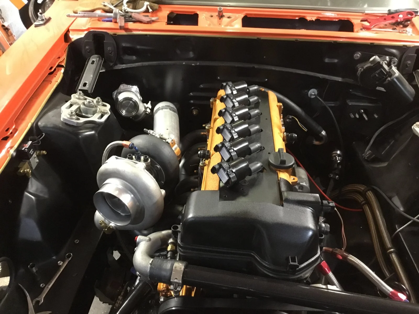

The part I’m most happy with is the decision on how to mount the coils.
I think this looks Killer. You can see what I did to keep the cam gears covered,..it involved cutting the OEM valley cover up.
Fortunately, if for whatever reason I decide to reverse it. I can kinda put the center section I cut off back in place. Obviously, there’ll be a cut line, but the engines in a freakin’ Fairmont. Who gives a rats red bunion hole if the cam valley cover is in two pieces?
Not me.
A close up look shows that I need to add a second set of mount studs to support the coils.. Home Depot only had two packs of the stand-off nuts. Tomorrow I’ll go to a different Home Depot or Lowe’s to find the rest. I also need to redo the plug wires ( I think) these are just a tad too short, and they’re kinda stretched to get them the way I want them.
But..I got those wires too, so at the end of the day It’s all good..I need a dancin taco.

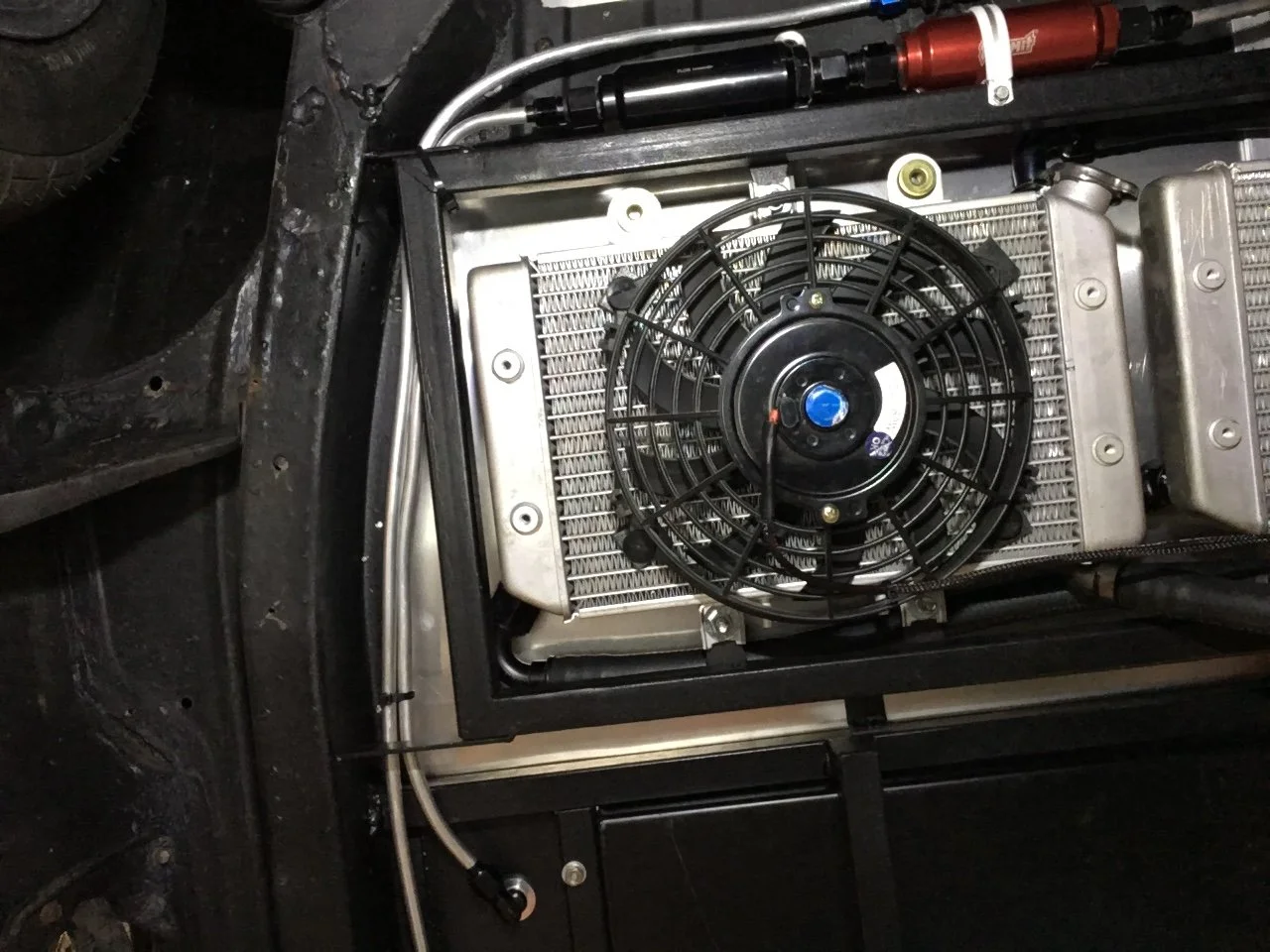

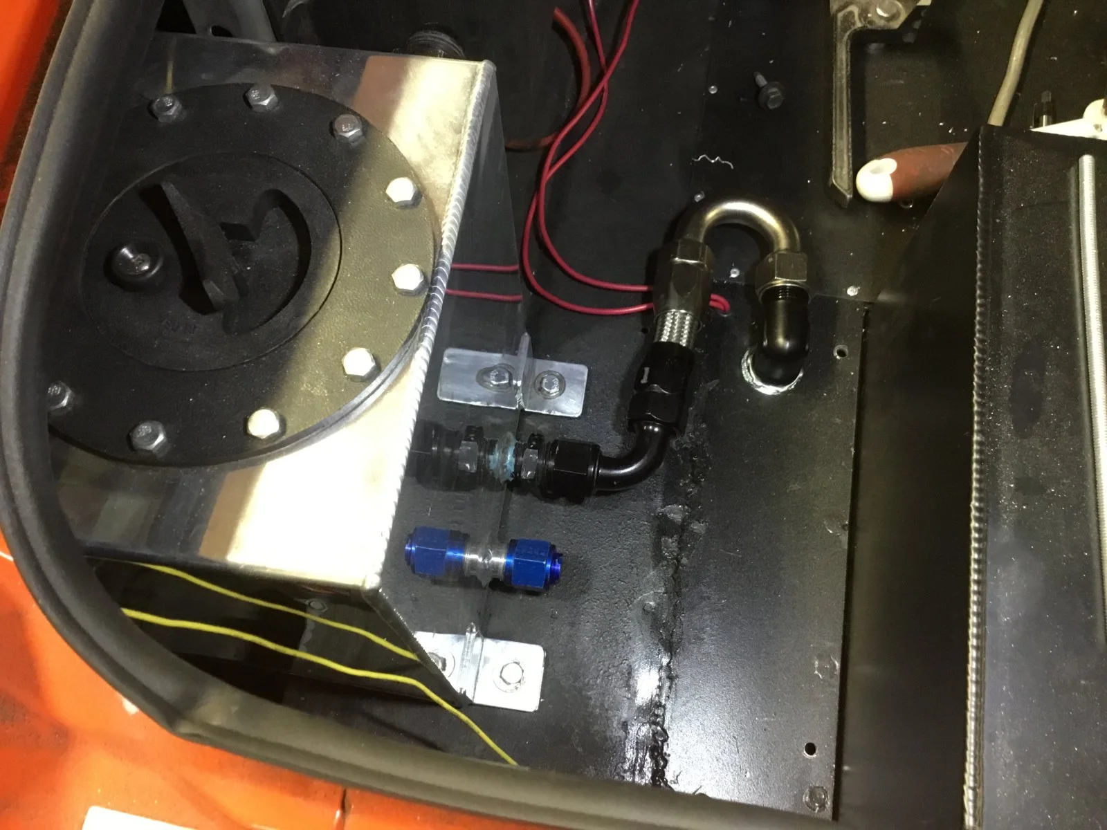

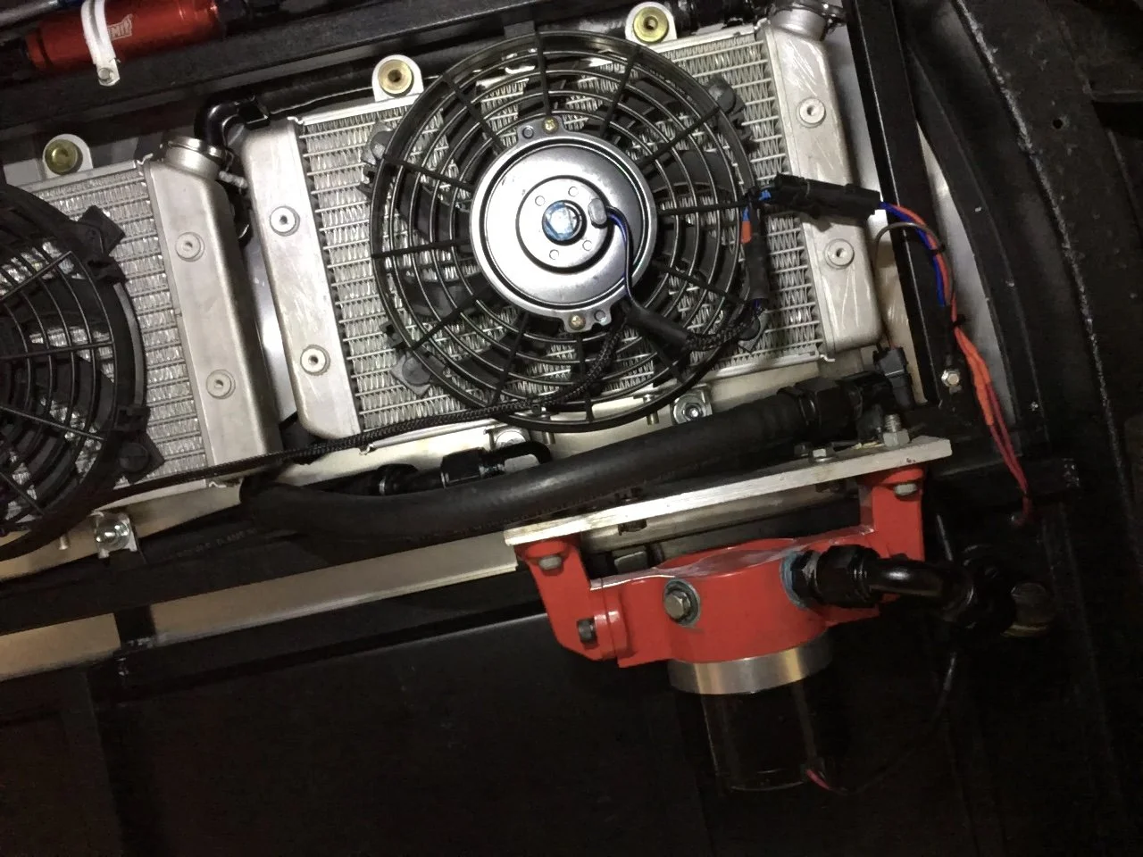

The fuel lines, and filters are mounted..
The pump, and fans are plumbed & wired.
The water reservoir is connected to the bulkhead fitting..
As goofy as this looks, there just wasn’t enough real estate between the cell outlet, and bulkhead fitting to just plumb them straight together. There wasn’t even enough room to turn it 90*. Fortunately for me I have a stupid amount of money in -12 fittings just laying in a big ole box.
This morning I estimated this to be about 2.5 hours worth of work. In reality, it took twice that. So that’s my curse now,...if I’m not doing sht over and over, I’m taking twice as long to do something the first time.
That I may have to do over.
Part of the problem is that I touch something, lay it down, and then spend 15-20 minutes looking for it when I need it next.
