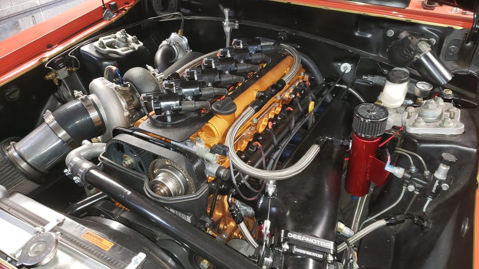

Here he is,...waiting on his tune..I built the hard lines from the EBC to the waste gate.
I just spent the better part of an hour trying to get oil pressure. I finally had to remove all 6 plugs to get the engine spinning fast enough to do that, but I prevailed.
And now I have a primed engine.

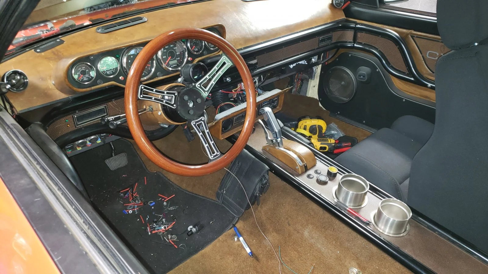

I aligned the front end using a string. It's close enough to drive.
The beginnings of my back to normal interior.
No drivers seat yet, but it's coming.

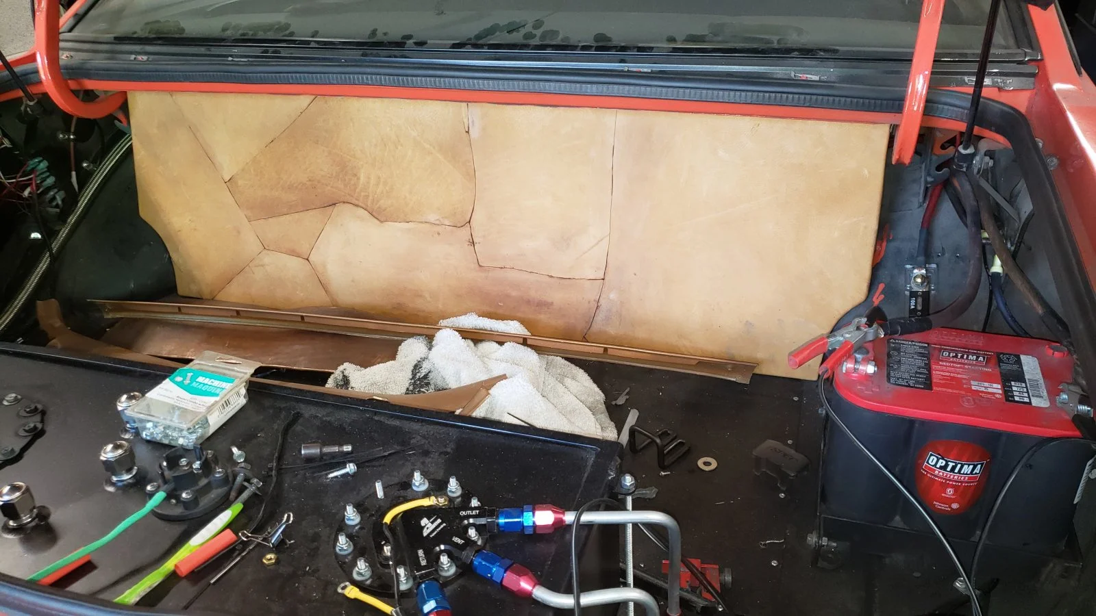

This was just a giant waste of time...(Like I have nothing better to do)
What looks like a map of the lower US is actually scrap pieces of left over leather that I've had for years now, cut and fit like a jigsaw puzzle. I figure some day I'll get around to finishing the monster theme in the trunk, so...you get the above.
It still needs the stain, and there is a whole bunch of additional work to finish the trunk, but that divider is done.
( I needed something ugly to hide the even uglier back of the seat delete).
