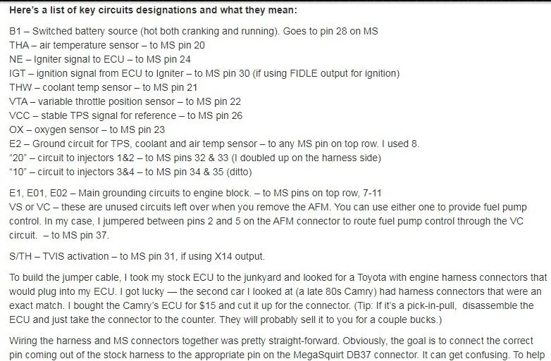

Hope you get it dialed boss.
Toyota uses Ohms resistance on everything.
It was a bit of a head bender working on turboing my wifes 3S-GE.
I've gotten good help from the NewZealand and US Toymotor crowd.

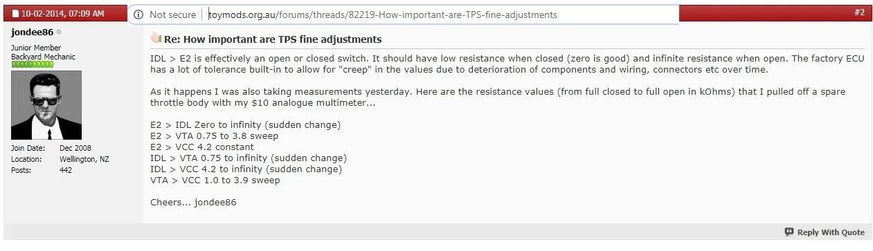

jondee86
E2 > IDL Zero to infinity (sudden change)
E2 > VTA 0.75 to 3.8 sweep
E2 > VCC 4.2 constant
IDL > VTA 0.75 to infinity (sudden change)
IDL > VCC 4.2 to infinity (sudden change)
VTA > VCC 1.0 to 3.9 sweep
Since you asked, the working range at WOT is 3.63-3.61v,
curb is 0.37v min.
The way Jamesls did his in 2004.
jdlaugh430 said:
Thanks. I saw your thread on the f150 project. In the small world category, my first Megasquirt/turbo project was on an '87 MR2. I ended up with a little over 200 hp out of the 1.6 L 4age engine. That was back in 04/05 and the car is still running great, according to the current owner. I was the first person to squirt n spark the 4age and a bunch of people in the MR2/ae86 world ended using the system I helped develop, including the guy who owns DIYAutotune. His site still hosts a copy of the article I wrote at the time. https://www.diyautotune.com/support/tech/jamesls-original-megasquirting-your-mr2-article/
The Econoline is plumbed, wired and just about ready to fire. There's only about 20 things that could go wrong, but I hope to get it running in the next few days.
Enjoy your engine.
