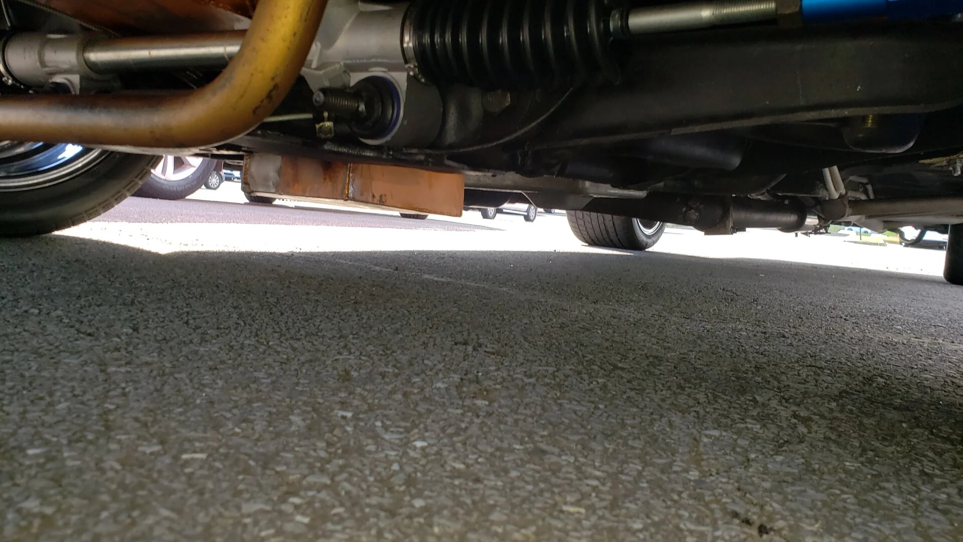

After the hour of run time, with several 5000 rpm " pulls" on the clock....I figured I'd look under the car and find a mini-envronmental disaster oozing out from everywhere...
And because I just love looking like a on again/off again bi-polar schizophrenic that thinks the the leaks come and go at will......
This time....all I have is a very tiny oil leak under the engine..evidently the little bit of oomph I was able to put on the fitting was enough to stop the water leak.
The oil leak will come back...MOF tomorrow, I expect it to be bigger.

And to quell the rolling eyes over my obsession to look under the car and either find a leak or not......The only thing I see is that freakin wet oil pan (minus all of its paint where I've been wiping lacquer thinner on it to try and seal the damn leaks)
