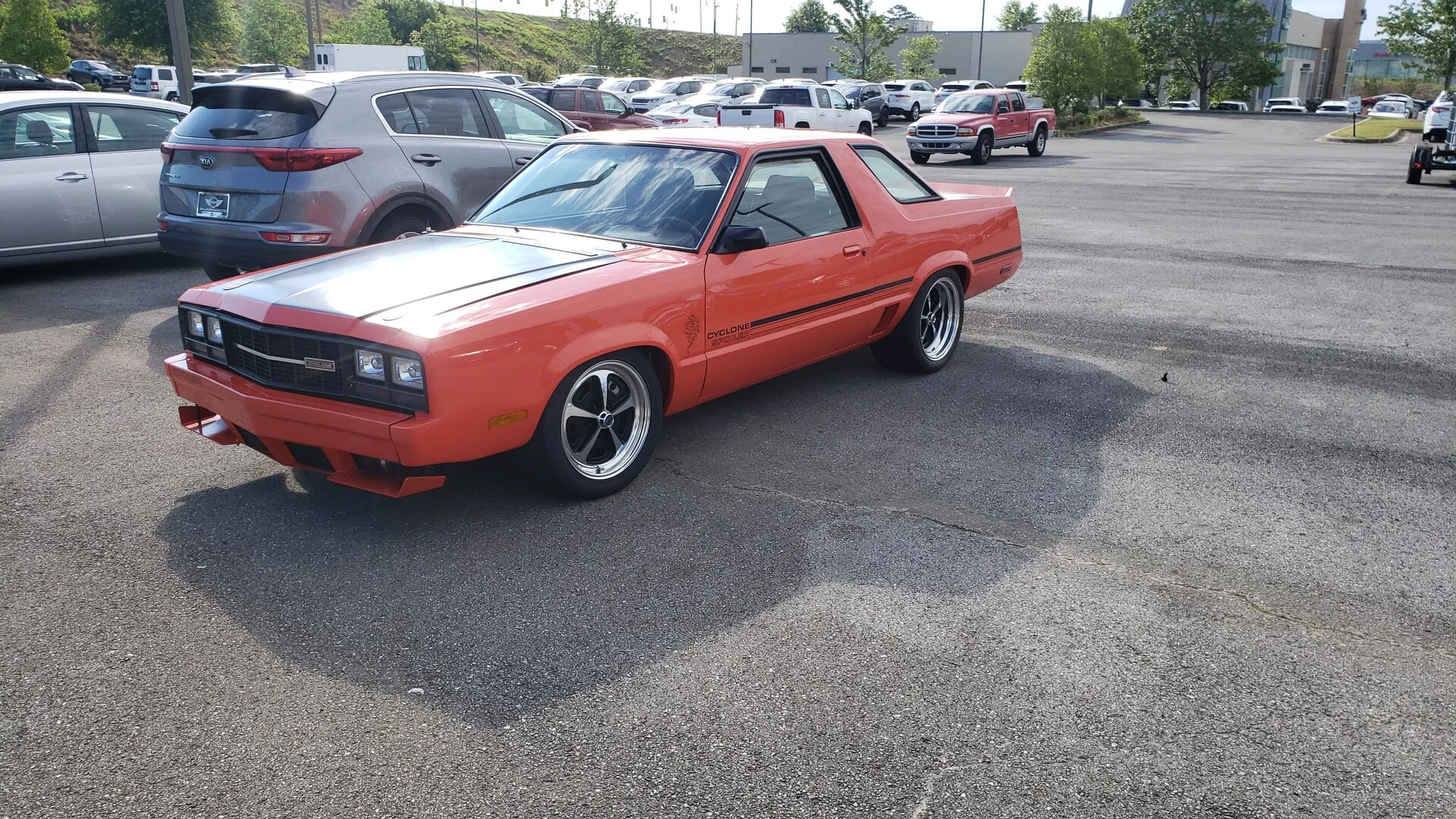

Well,......I made it.
That's why we keep reading.
There's a lot of pain and struggle behind that picture. Your knees haven't stopped you, and they won't in the future.
Looks sharp, I'd love to see more pictures.
