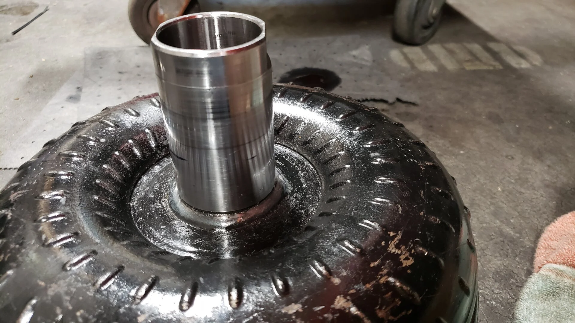

For whatever reason...There is wear evident where the converter engages the front pump. After only running for a grand total of 1 hour.
The 4r70w is a dead option. There is enough deflection in the driveline to cause significant damage to the converter after a minute of actual run time.
I’m sick...I really wanted it to work. I knew I was done for when after unbolting the converter from the flex plate, it wouldn’t push back. ( and I was concerned that the converter wasn’t fully engaging the front pump)

From what i’m seeing, the converter was seizing into the front pump...creating a significant drag on the engine...

There is one small chance that the converter isn’t worn from misalignment, but instead was being forced too deeply into the front pump.
There was front pump noise while it was running. When we first got it running, just putting it in gear would stall the engine, and if there was excessive drag, the engine would “ run like a pig”.
I couldn’t push the converter back any further when unbolting it from the flexplate. Now that the converter is out, trying to get it back on the pump is proving to be much more difficult than normal.
You can see the front pump bushing wear pattern in front of the reduced worn area where the pump lugs are...maybe I was jamming the thing into the transmission too hard and creating a bind :shrug: .

And the more I look, the more I'm thinking it wasnt the adapter that caused the failure...it was the converter specs.
Think about it..

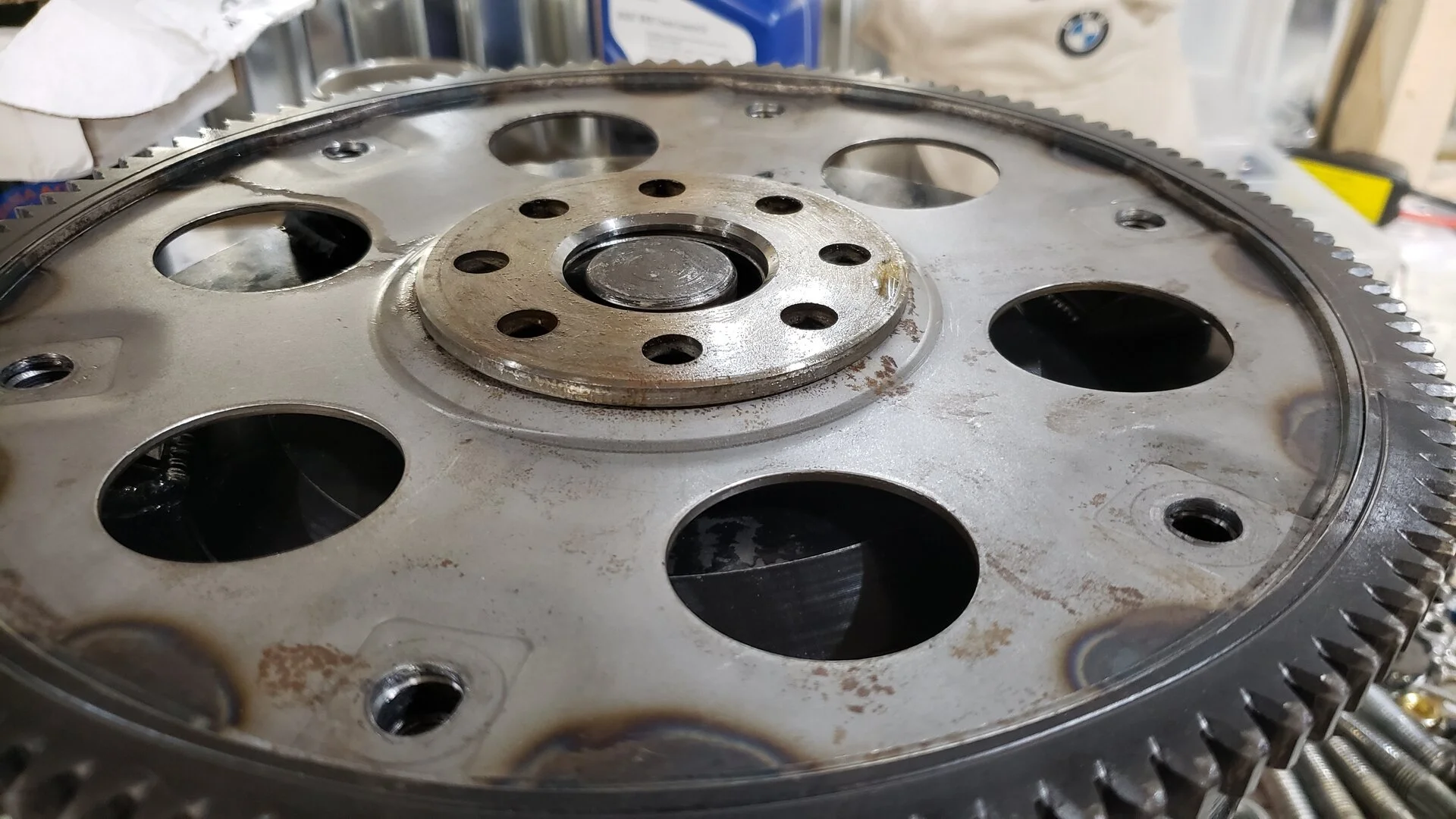

There was ZERO converter hub penetration into the crank. Nothing to support it at the front. It would've been free to wobble with the flexplate.
And wallow the front pump part of the converter sleeve just like it did.
Maybe a new front pump, and a new converter with a longer pilot, and .090.-.125" less pump depth?

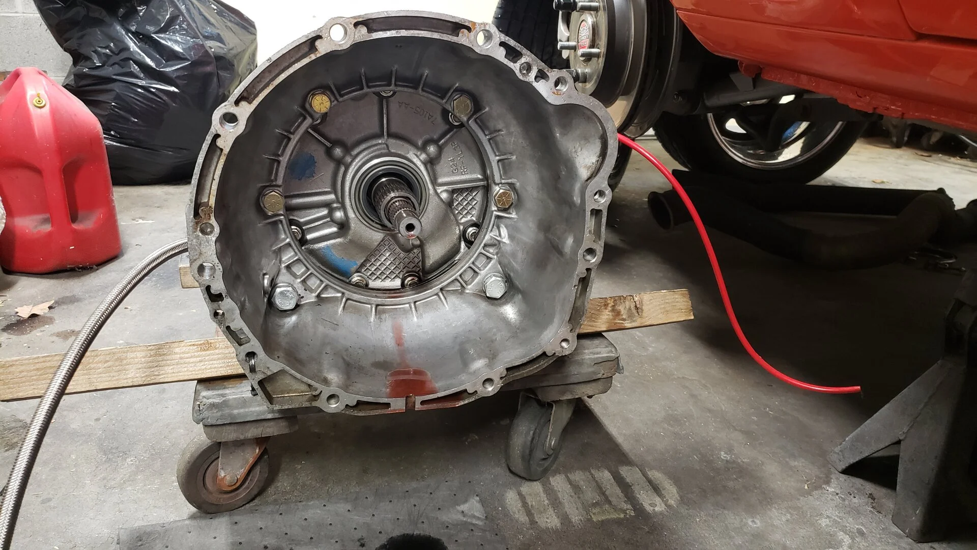

This is what I think happened:
I think when I mocked this thing up using the thinner spacer between the crank and the flex plate, I may have had enough converter/ pump clearance. But the starter hung because of it. Adding the thicker spacer pushed the converter further into the front pump, couple that to the interference that was going on from the converter potentially “wobbling” at high rpm, and you have a horsepower robbing sonofabitch that is rapidly wearing itself out.
Now, if I can get the front of the new converter supported like it’s supposed to be, and make sure that there is enough end play into the front pump, maybe I’ll not have to spend 3 grand to fix this after all. Right now I’m at 180.00 with a new pump and GTE flexplate on the way. I expect the converter to cost 500.00 to fix. At less than 700.00 I can justify putting cams in the thing at this time.
FULL STOP.
Soooo, you didn't have ANY engagement of the converter in the crank and wondered where the vibration was coming from for more than 1 glass of bourbon/whiskey-whatver your poison is.

Yeahhhh.....it took me a “ I wonder what’s up there “ minute to decide to check that.
The more I look at it, the more it only appears to be just that. The impeller side of the torque converter actually has that relieved area that slides into the front pump. In other words,....it’s not wear.
Its still very difficult to get the converter into the front pump though,...something still isn’t right there. But it’s not the converter....it’s something in the pump. That'll mean I shouldn’t have to have anything done there.
The converter will get the flexplate side completely revamped, though....including an extended pilot that will ride in the crank.

The only thing that is suspect would be that the snout of the converter wasn’t supported in the crank, and I had it almost too far into the front pump.....almost.
So that’s what I’m going with.
When the new flexplate gets here i’ll measure, and measure, to the point that i have checked the thing till i’m confident it’s right. then I’ll send the spacer, the flexplate, and the converter up to PTC for a redo. while that’s happening, i’ll attempt the pan fix.
