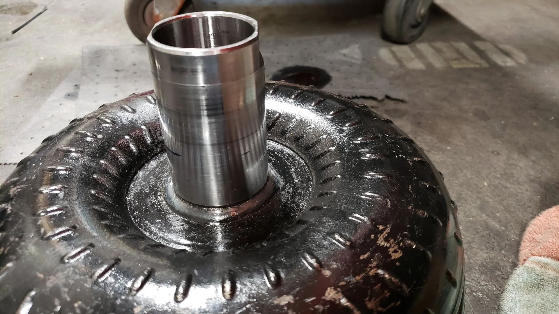

Wasn’t the snout on the convertor gnarled up?

Nope..
Blow the pic up as large as youd like...this is normal. I thought that the impeller hub had worn down because of the reduced area at the front pump. Turns out that is the way it was.
