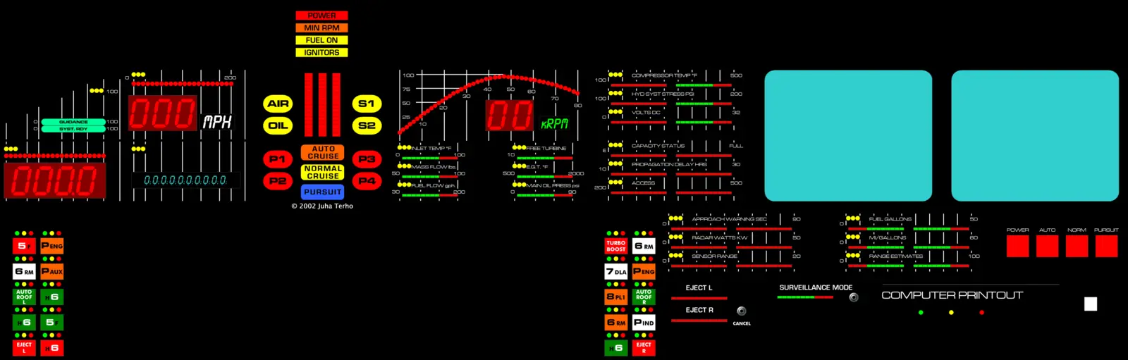

Uhh,....nooo,...not what I had in mind. But I appreciate your insight,..I'll save the pic for a reference in wrong.

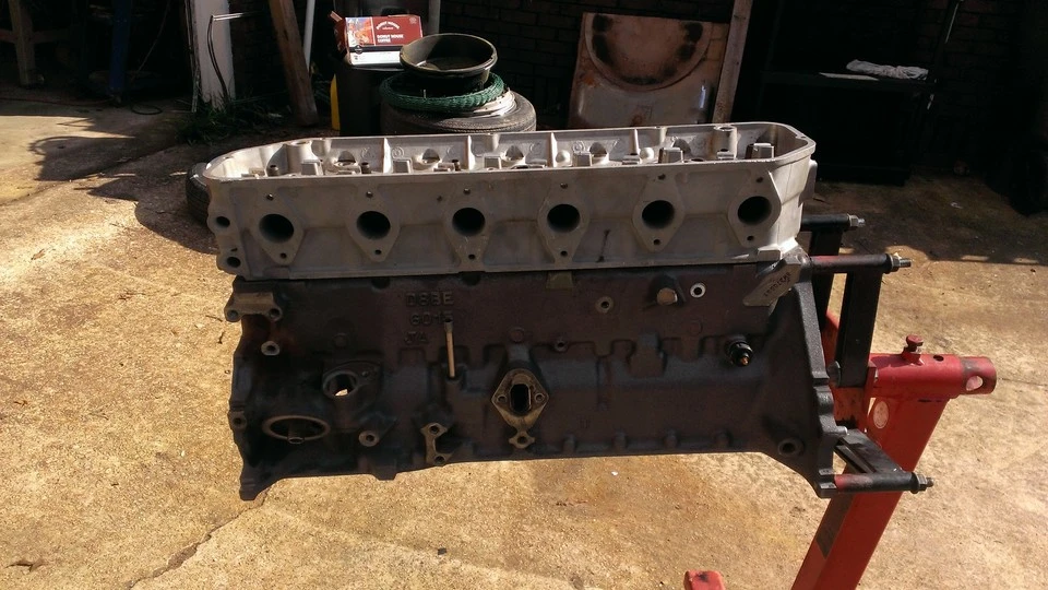

The key to my happiness with regard to choosing to build a turbo'd six banger was supposed to arrive Saturday. For whatever reason, it didn't. I had to go to the post office to pick it up, and after I got home, tore open the box to reveal my most recent aluminum prize.
Behold the Aussie Crossflow:

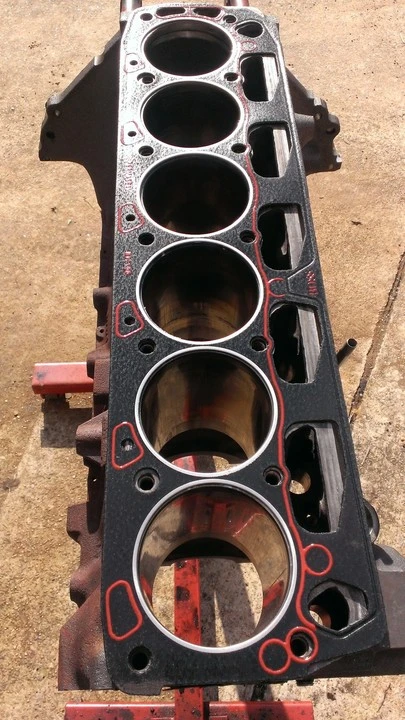

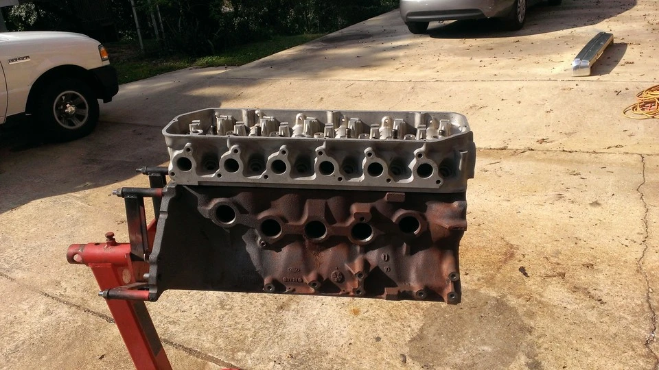

I picked up the just recently steam cleaned 250 block this morning, right after getting the head. Despite the fact that for the most part the head looks like it belongs there,....removing that head, and throwing a crossflow head gasket on the US block reveals something a little different:
On the left side of the pic,..the 5 holes have no provision in the block for the water to pass into. (You have to close those holes up in the head by milling and installing freeze plugs.) The Right side requires a 1.25" wide x 1/4 inch thick plate be bolted to the side, and the remaining gap filled w/ a really good epoxy. Once done, the cast iron has to be ground away to accommodate the push rods. This head uses a 351 Cleveland canted rocker setup,..and the intake pushrod evidently hangs way the hell out there, hence the need for the block mangulation.
For me it's no big deal,..I am not the least bit concerned about it. The area that needs all of the grinding only seals the oil splash that would be in that push rod tunnel,..so in the grand scheme of things,..it should be a piece of cake.
I am concerned about having to close off the water passages on the other side though,..that is the exhaust side and I'd just as soon have water moving through the head there too. I've already scoped that out too,..looks like I'll be able to tap into the head from outside in the 5 places,..and create a "water rail" w/ a bunch of AN tees so that the water can move through that side of the head as well.
