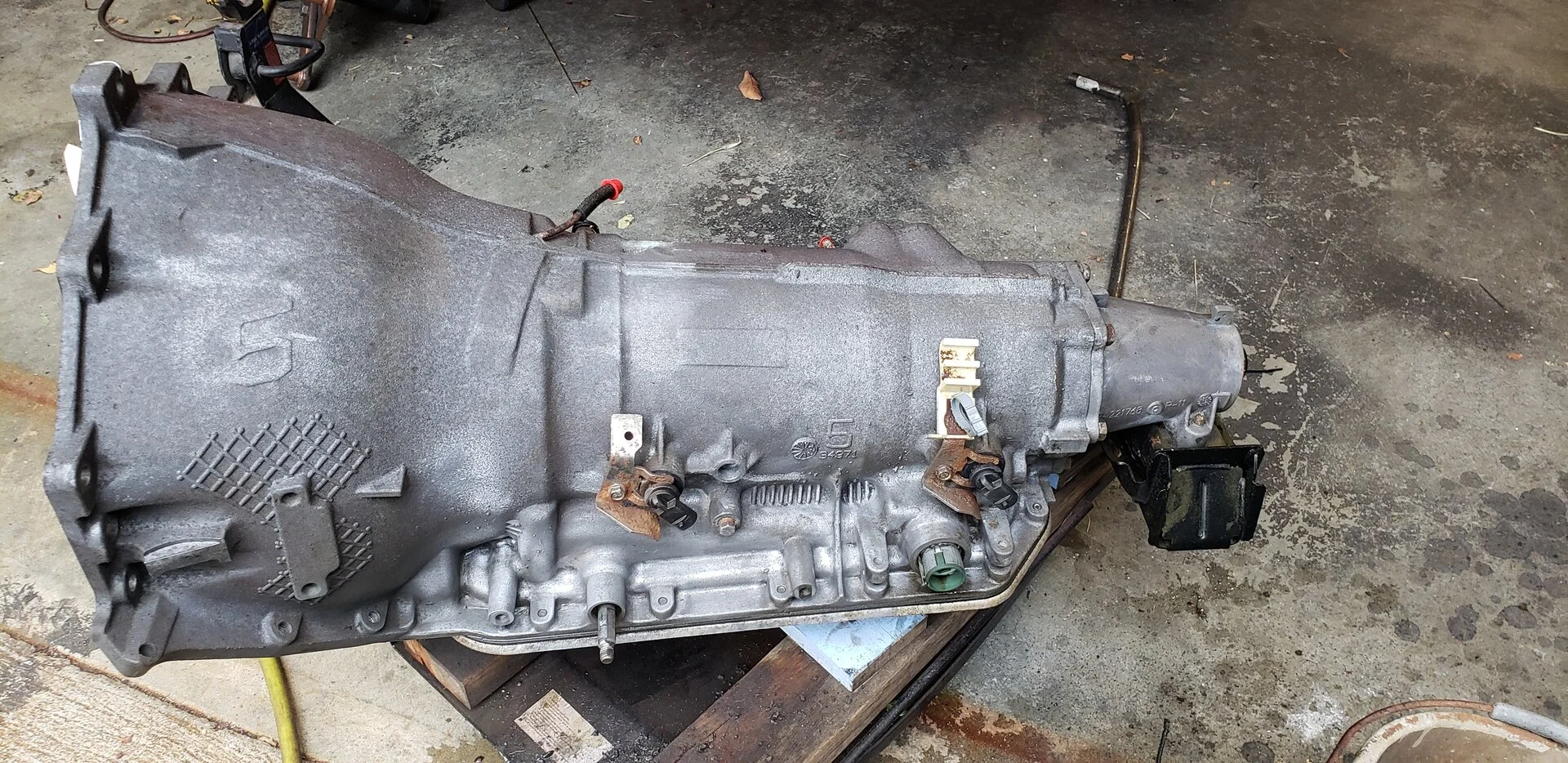

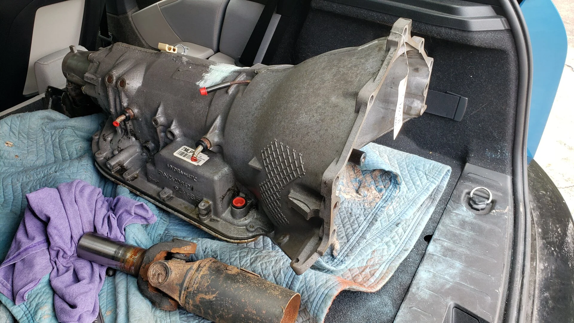

It's here..
That is one heavy sonofabitch. I'll bet its almost 200 pounds empty, w/o a converter
The input shaft is huge, the output shaft is huge...
But it don't look like a 45k mile trans..there is all kinds of evidence that this dude got a quick pressure wash, with the converter in place. Grease is hiding in all of the nookz/crannies, and when you pull the converter it looks like the front pump was leaking.
There is a Monster trans video out there where they disassemble the entire trans in about 5 minutes, leaving all of the subassemblies together. I wonder just for the sake of inspection, if I should do that. According to the video, there are tell tales that the trans has wear/neglect, or got hot
Just by looking at those parts.

It's here..
You can trust Monster transmission about as far as you can throw that 4L80.

It's here..
I remember what happened last time when you opened up Jayzee just to check some stuff....
Reactions: 2Blue2

It's here..
I don’t know why you wouldn’t. You’re surely capable, it’s out of the car, and if there are easy to see signs of trouble it’s obviously best to fix it now.
The trans has to come partially apart to modify the vb for the manual shift. As part of that process, I'm also supposed to remove the front pump, and modify a fluid passage, and upgrade springs in one of the sprags...I mean, the front of the thing will be open anyway.

This means you're going to rebuild the whole thing. You'll find a reason for sure. Any sign of any wear ( no matter how little ) will have you ordering more parts and digging in it. I can't blame you. If I had the time and moolah I'd do it too. Better to be safe than sorry.
I actually think about this with my engine every time I fire it up. This is the only engine I've ever had that I didn't put completely together my self. Seeing the poor workmanship with the intake gaskets it really makes me think. If I had the time and money I'd have a Dart block at my door.

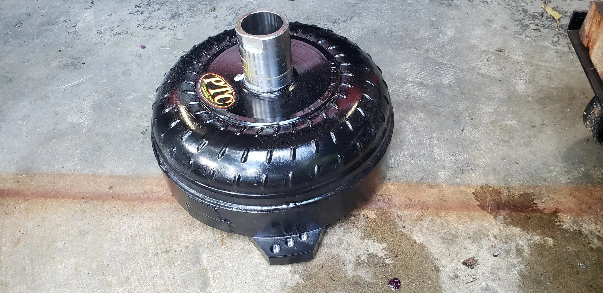

Piddlin...
I've kinda de-greased most of the chunkier grease spots..
Judging by the rust on the brackets, I'm saying this trans lived its life in the north.
By the time I got done with that, the converter arrived..Antiballoon plates front and back.
Rated to 3000+stall behind my engine..Time will soon tell.
But that time won't happen till next Thursday.
To me, its too much of a pain in the ass to do anything over because I didn't do it the first time.
NOT to be confused with having to do sht over because I "did" it the first time...wrong.

I was thinkin' you'd have the pan off by now. That's the easiest place to start figuring the true wear on that thing.
