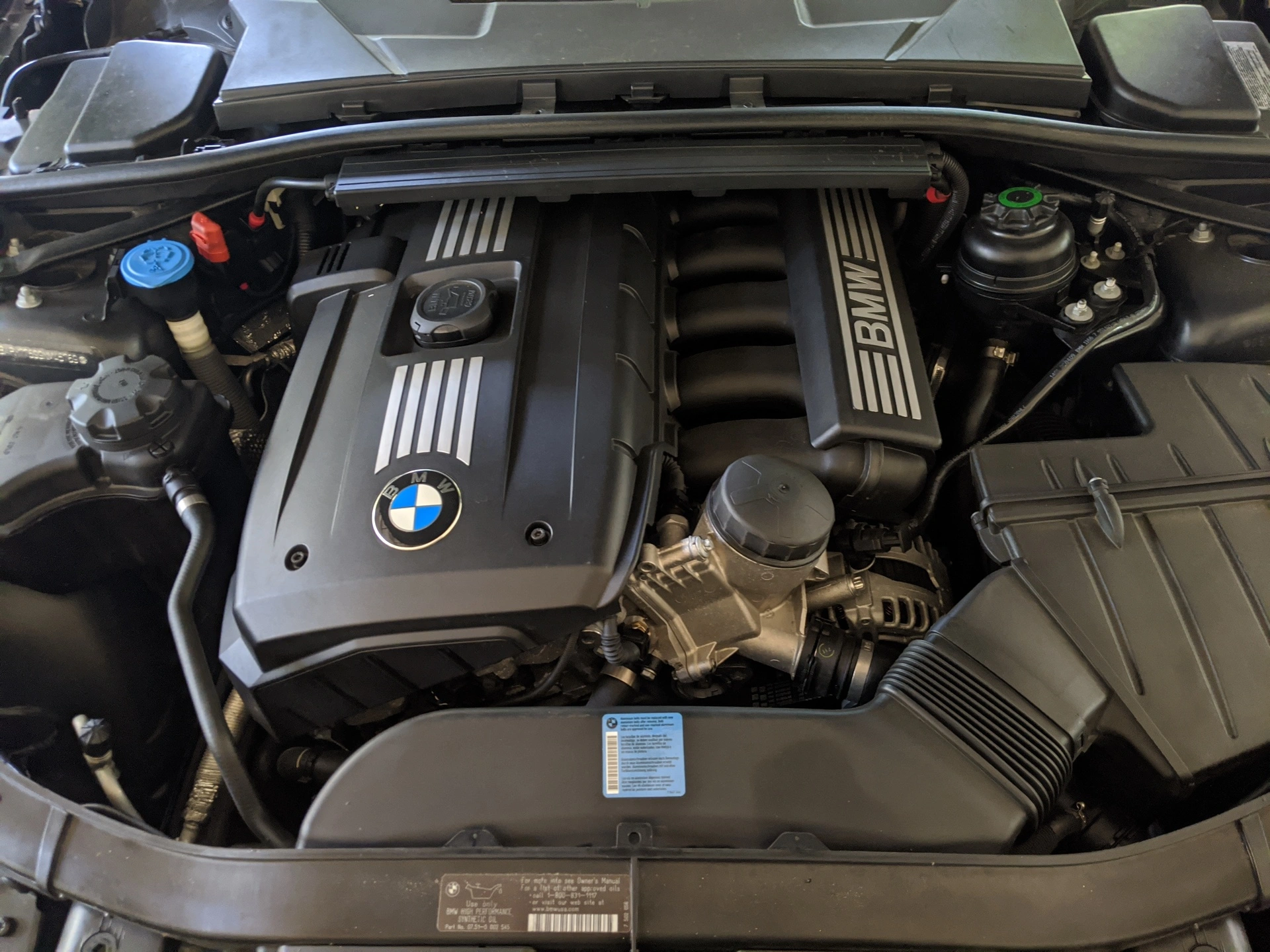

BMW N52: Because if you aren't leaking more oil than Deepwater Horizon, you're not :leghump:ing trying. Also known as the only engine I've ever heard of that will suck it's serpentine belt INTO the engine through the crank seal if you ignore the oil leaks long enough.
But damn is it ever smooth and powerful when it's running right.
