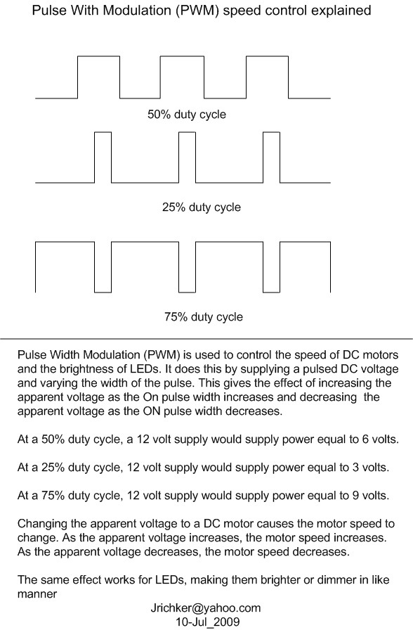

@CarMichael Angelo
@a91what
The main advantage of PWM is that with a simple variable resistor you can get a wide range of voltages.
Since you asked...
Pulse Width Modulation explanation
Buy PWM modules off the shelf"

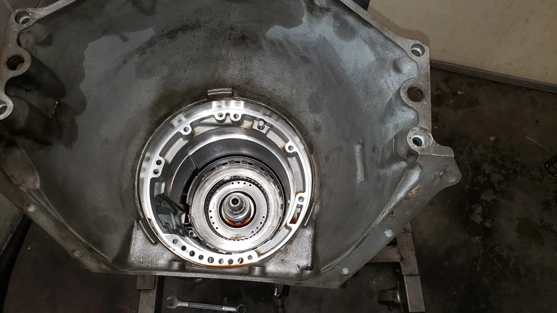

All day long I dicked with the trans mods, and excepting the time it took to bracket to allow me to flip the trans, got seemingly little done to show for it. And after spending all day bent over various trans parts, I can safely say that a 4l80e is a mutherfcker to work on.
Unlike a 4r70w, the case is way deeper and the clutches and drums are huge. Consequently, they are heavy as hell, especially when all you have for leverage to hold those parts are the tips of your fingers.
That have to be lowered into an 18” deep hole....carefully.

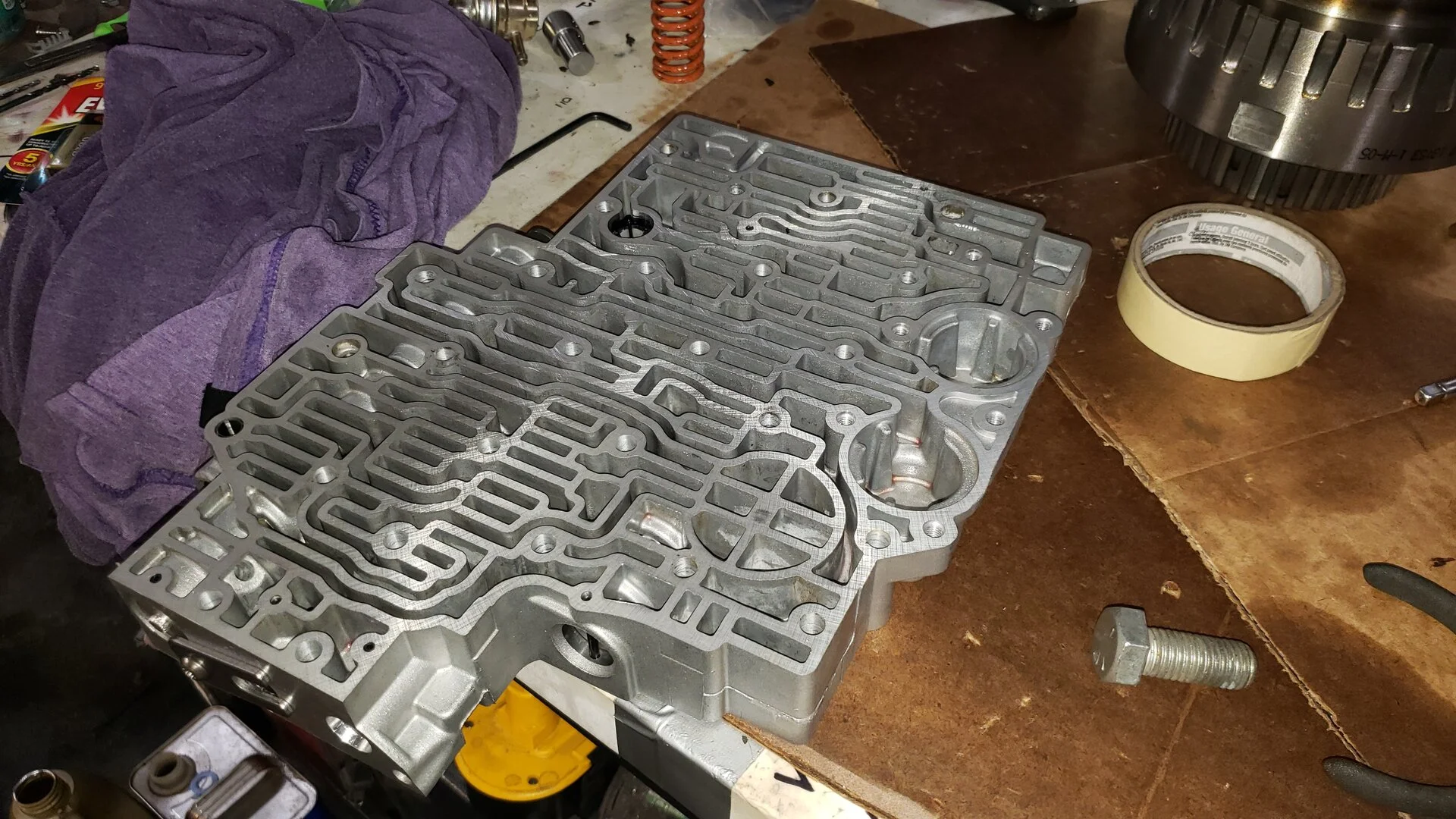

The valve body concerns me. A couple of the mods didn’t go together nicely. One of them is unserviceable should it need tweaking. ( A plug, stuffed into one of the passages that can’t be seen much less accessed)
It sits in the lower left corner of this pic...the thing fought me for an hour..Theres a cap with a pin, a screen with a spring in the middle...I can’t even imagine what it’s purpose is.

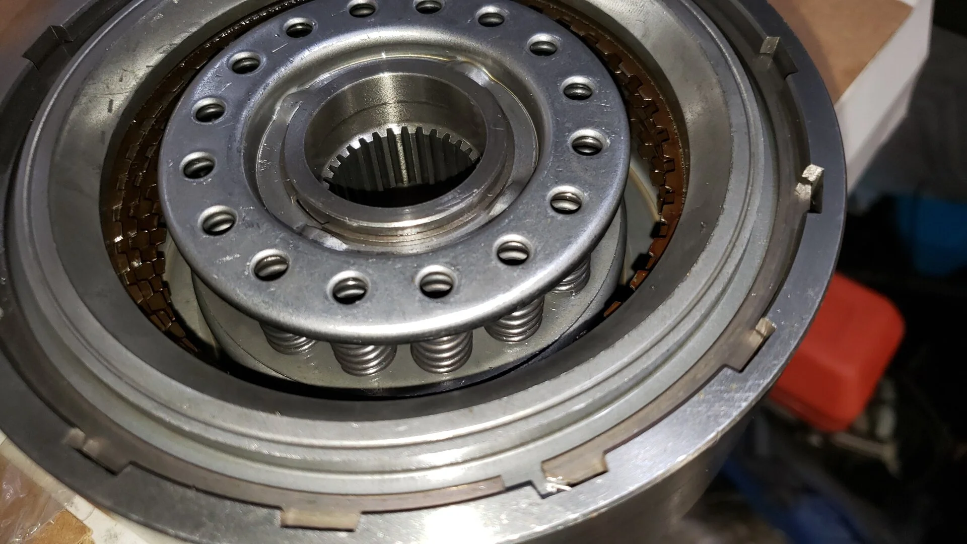

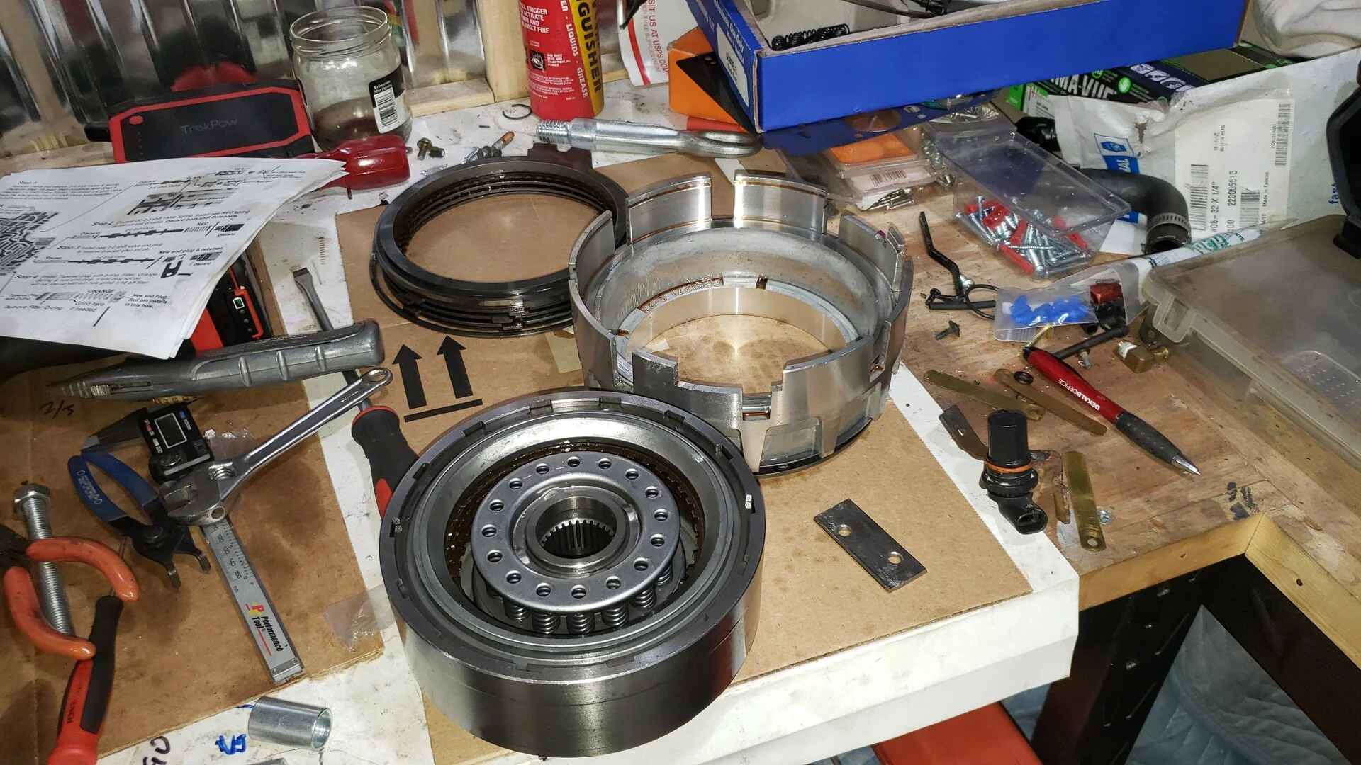

The trans had to come apart to a 75-80% level to get to that drum that needed the spring upgrade.
that center ring had to be compressed to allow access to the center snap ring that released that hub. Then, 16 springs had to be pried out of that thing, and then the new stronger ones put back in place. When I was done, the thing was so stiff, the process I used to get it apart wouldn't even come close to working. I had to make a spring compressor out of a piece of threaded rod. This is the “after“ pic.
The trans is mostly back together..The pump will need a new gasket, front and and lip seal,..none of which were provided in the kit. I‘ll see if I can find them locally tomorrow and have #1 son pick them up for me, elsewise I‘ll be stopped from doing anything on Sunday.

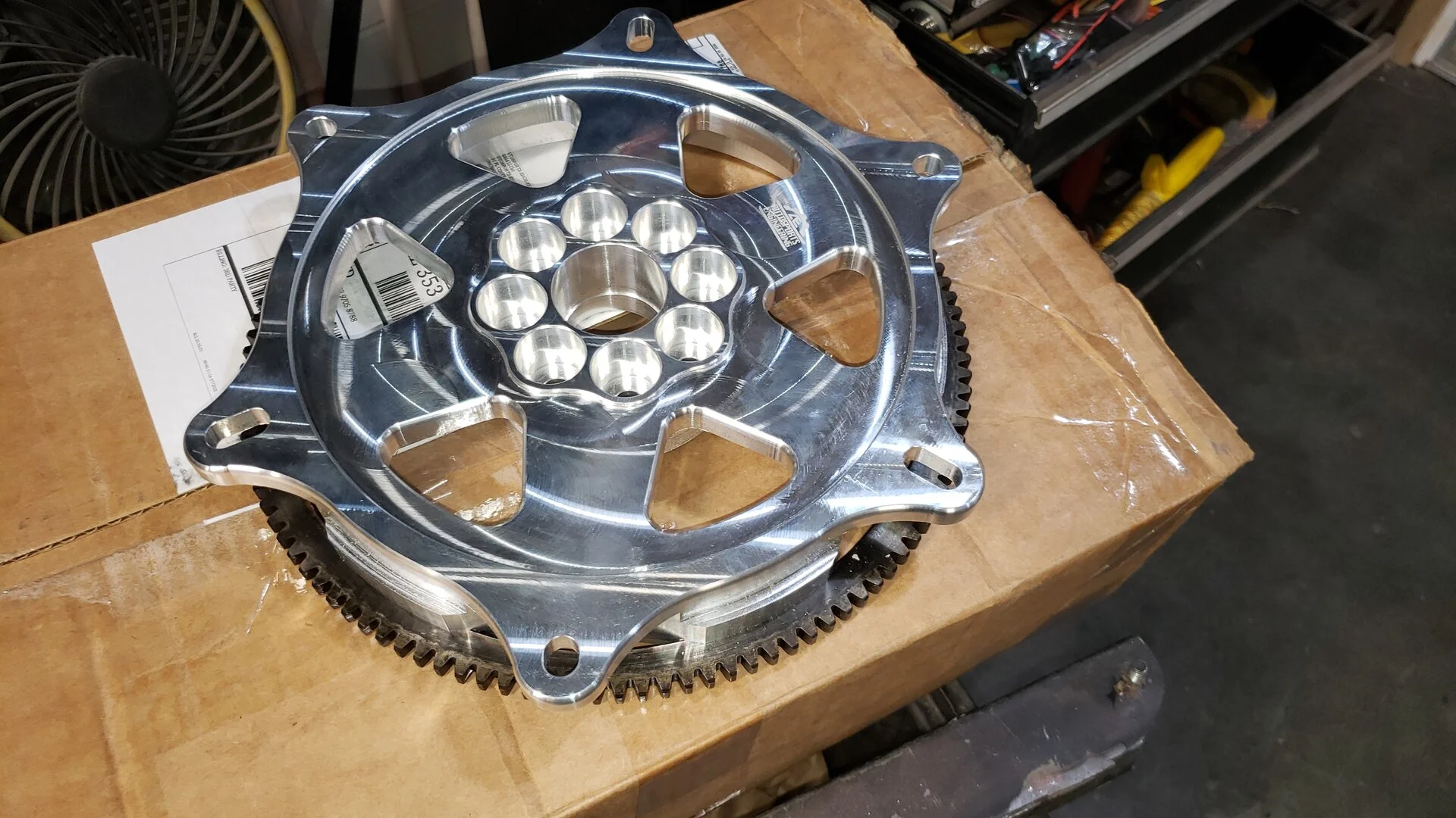

The adapter came in..It’s almost a shame. actually almost too pretty to have to hide out of sight. In addition to this flywheel, there is a 1/2” adapter plate that bolts to the tail of the 2jz.

I think i should just be like the rest of the new guys that pop up on here and pay some mechanic to work on this piece of sht.
Remember a couple of days ago when I was saying something about how I should re-evaluate my work plan, adopt a measure twice, cut once work ethic, and lower my expectations for what I could get done in a work day in order to come out of a days work with some sense of satisfaction?
That's bunk.
I slowed down...I re-read the instructions...And even after all of that...I omitted sht. I still made mistakes,...I still has to fix phck ups..
I left out filters in the valve body,....I had to take it apart. I forgot to add back a roll pin that held the 2/3 shift valve in a certain position,...I had to take it back apart. I omitted a spring,..(which I discovered while watching a Youtube video,) fortunately remedied while the pump was out. I drilled a “ too big“ hole in the front pump that had to have a restriction put back in the hole to bring it back down to the right size..
And this is just pertaining to the trans mod kit...
I think i’m better off scrapping this car, buying an S 550, and focusing only on the things that can be improved with a screwdriver, a lug wrench, and my wallet.
