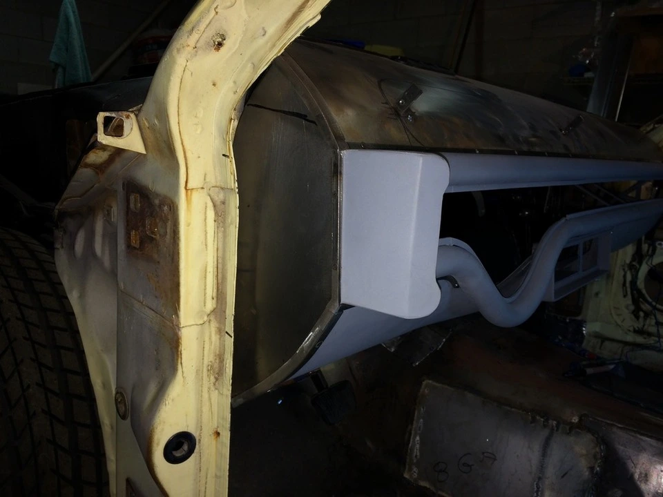

I intimated earlier that I had solved the dilemma of having to blend the turns that start at the end of the dash, and move onto the doors. I said the solution to the problem literally bitch-slapped me off my rolly-creepy thing.
That solution was in fact so clear to me, I set right out and welded the hell out of the dash, cutting the turn radius' of the door bar right in the middle, and welding that little stumpy-dude onto the dash. No easy task I tell ya, as those stupid little half bends want to get all kinds of wonky when you try to set them up prior to sticking them permanently.
As I always do in the end, I just take my best stab at it, and weld the piss out of it.
Fortunately this time, it worked out.
For the last several days, I've slaved away on multiple fronts. The welding, followed by a buttload of grinding. Modifying all of the insert mesh, and trim to match the new dash shape.
Finishing (or at least getting them close enough) the "three amigos" that are the cover panels that make up the bottom of the dash, and THAT is where all of the bodywork has come into play.
You can't necessarily see it in the pic, but the sheetmetal follows the drop for the column. Sanding a small, piece of rolled 20 ga. sheet metal that has compound curves that run in two different directions can only be described as hell on earth. Getting it close enough to put in a coat of epoxy primer took a bagillion minutes.
All of those pieces have to be removable, so they also had to have the requisite (say it,........you know you're thinkin' it.....SAY IT!)

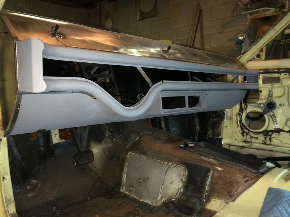

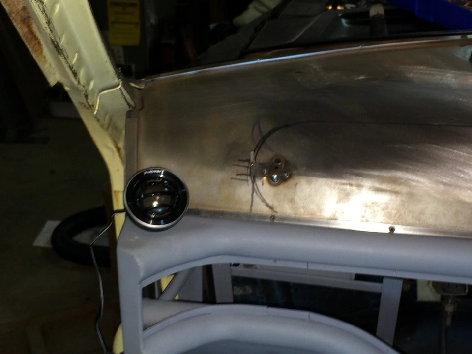

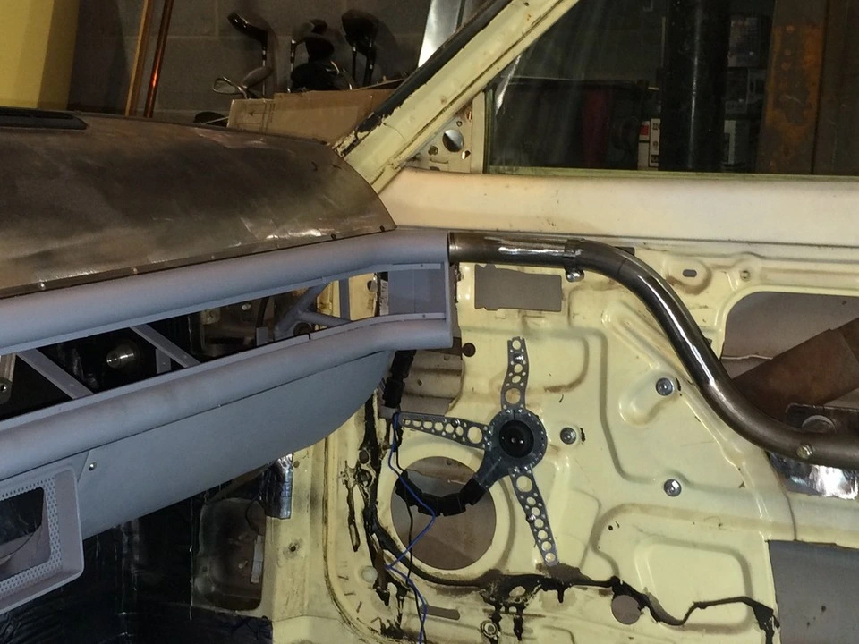

Now that I had the three pieces in place under the dash, It left me just enough time to work on the end caps. I got one done.
Now I know that this looks kinda goofy from this angle, but remember the door will hide this when it's open for the most part. They'll be black, so they should look less like a malocclusion after that.
As for the new flat spots that cap off the bend radius' I think I got a solution for that as well.
The tweeter portion of my component door speakers. It'll need a place to live, I guess this is just as good a place as any.

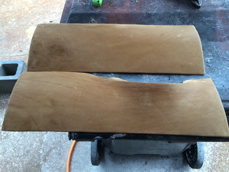

Remember when I posted the pic of the white leather and detailed my plan to use it as one of 5 colors that would be in my interior?
I decided against that.
Not that there is gonna be that many less colors in the interior, I just decided against white being one of them. So, I took the ex-cow back to Tandy Leather, and exchanged one bovine hide for another.
The new color, and the new look are more in tune w/ my overall plan for the interior.
I chose saddle tan, and the condition of the hide was listed as......."distressed".
Poor ole Elsie must have had a rough life. This particular hide is marred, and nicked where he/she met up with one barb wire fence too many. There are holes where ticks bit the hell outta the poor thing, and various wrinkles, texture changes, scuffs, and cuts.
Perfectly suited for an interior in a car named after a slow assed, low-riding, poisonous Arizona lizard.
Even exchange, I no sooner got home, and I got out the three amigos, and covered two of them.

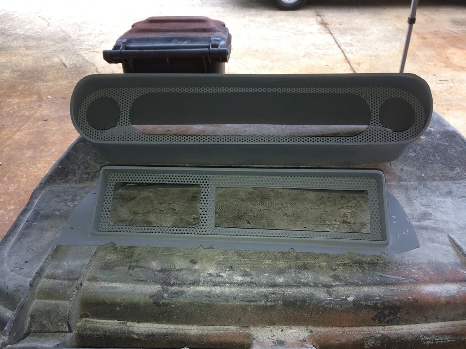

I finish sanded the gauge pod, and primed that dude w/ etching primer, and that brings me to the viewer participation portion of this update.
Here they are. Winkin,& Blinkin, Ying and Yang, Zig and Zag. One oval, the other obviously rectangular. Both are probably not gonna be able to be covered because of their weird shapes. I think I'll have to paint them instead.
The grill mesh will be gold, and the outer shell will be either be a color matched hue that'll match the new leather, or satin black to match the bars.
I'm thinkin' color match, but you guys are welcome to chime in and offer your suggestions. I do pay attention and appreciate the input.
The other option (and one I'll pursue on Monday) is to take them to an upholster, and ask if he can cover them for me. I kinda feel that I can cover the rectangular piece myself, but don't wanna chance ruining any of the leather on a folly, when the remaining stuff has to cover the top of the dash, and both doors.

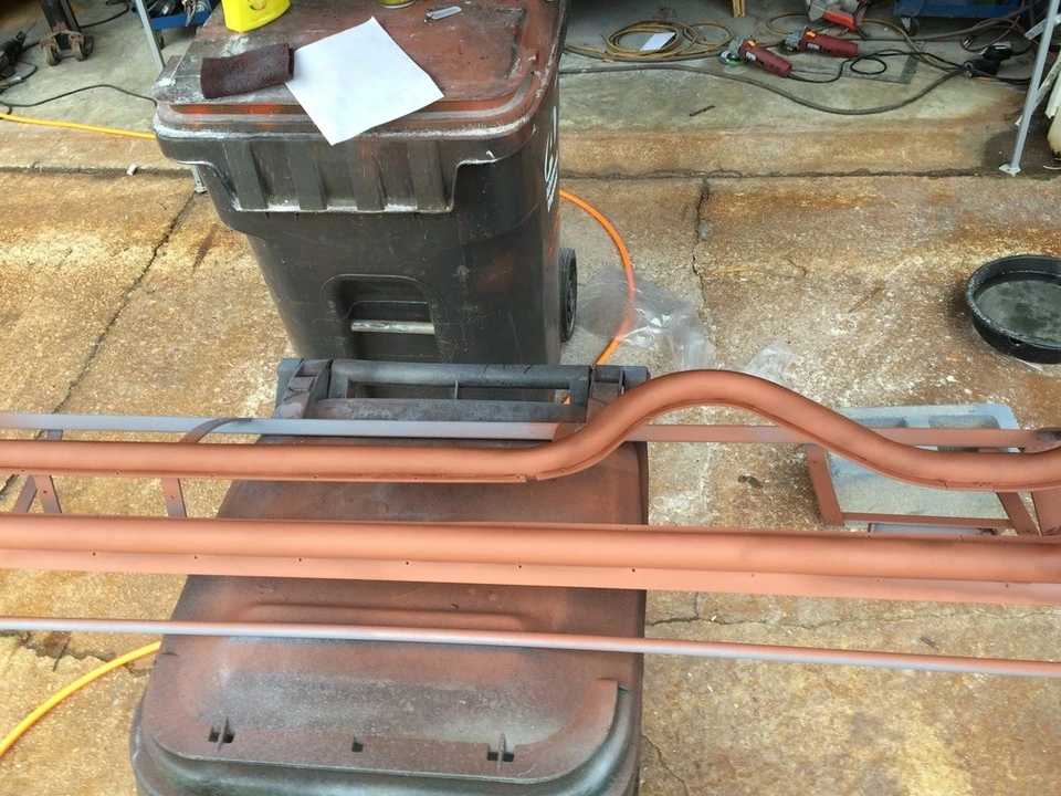

The dash bars are days away from being black. Once painted, the AC evap will go in permanently, and the wiring will begin. Two-three weeks of that, and I should be able to.........................start it.:
