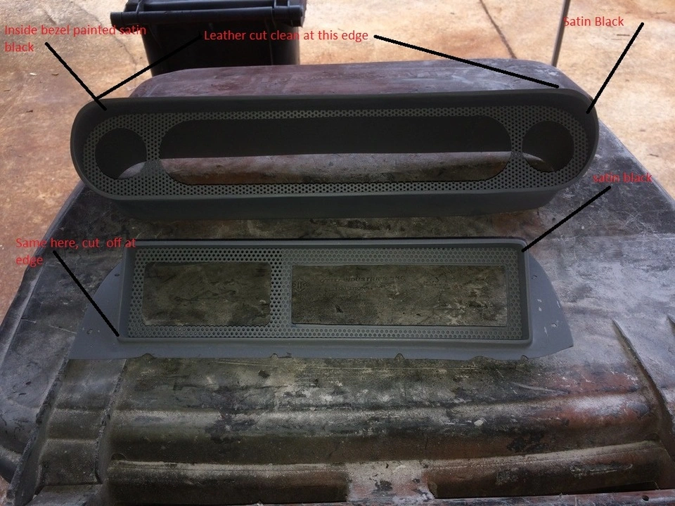

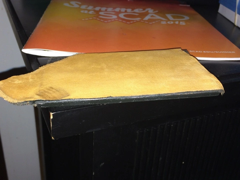

I trim the leather edge at the top of the bevel. Cut it clean, then do a thing called burnishing the leather edge (sanding) dyeing it black, then sealing it. The inside bezel would be black then, w/ the mesh gold.
By doing it this way, the very outside edge of the bezel will still maintain it's sharpness, and since I'm sanding the leather it will kinda round over to that edge by sealing it, then painting it, I think it'll blend the raw edge, but still leave two distinct edges exposed (the leather, and the metal)
I'm gonna go and do this w/ a piece of scrap 1/8" steel, and a little piece of leather as a test, and I'll see if i like it.
I don't know if I've seen that process done, but it sounds neat. I'd be interested in seeing it. If it doesn't yield the look you are after, maybe you can turn the edge under and stich a "hem" to finish the edge and glue it down, maybe? Isn't that how the Italians do it?
I'm concerned that I can't do what I need to do. Burnishing the edges seemed like a cheesy way to solve the problem.
This is the scrap piece that has the burnished edge. The actual metal edge isn't as smooth as the ones it would be up against should I decide to do it this way, but it could work.
The leather sucks up the black paint. There is still a visible divider between the leather and the metal, but again,....it could work.

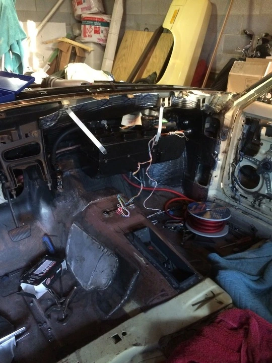

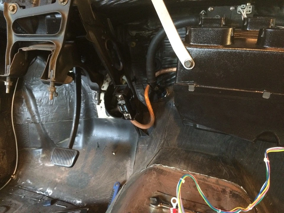

I go to my car audio guy, and buy the fuse holder for the 200A fuse that'll be my go between the alt, and my electronics. I mount that dude, and wire a big assed 0ga. cable from the bulk head fitting to that. Why I used such a big assed wire to essentially power the fuse block, C/A system and the ECU is beyond me, but it's done.
After that, I mounted the AC evap. This time permanently.
Still, so far so good.

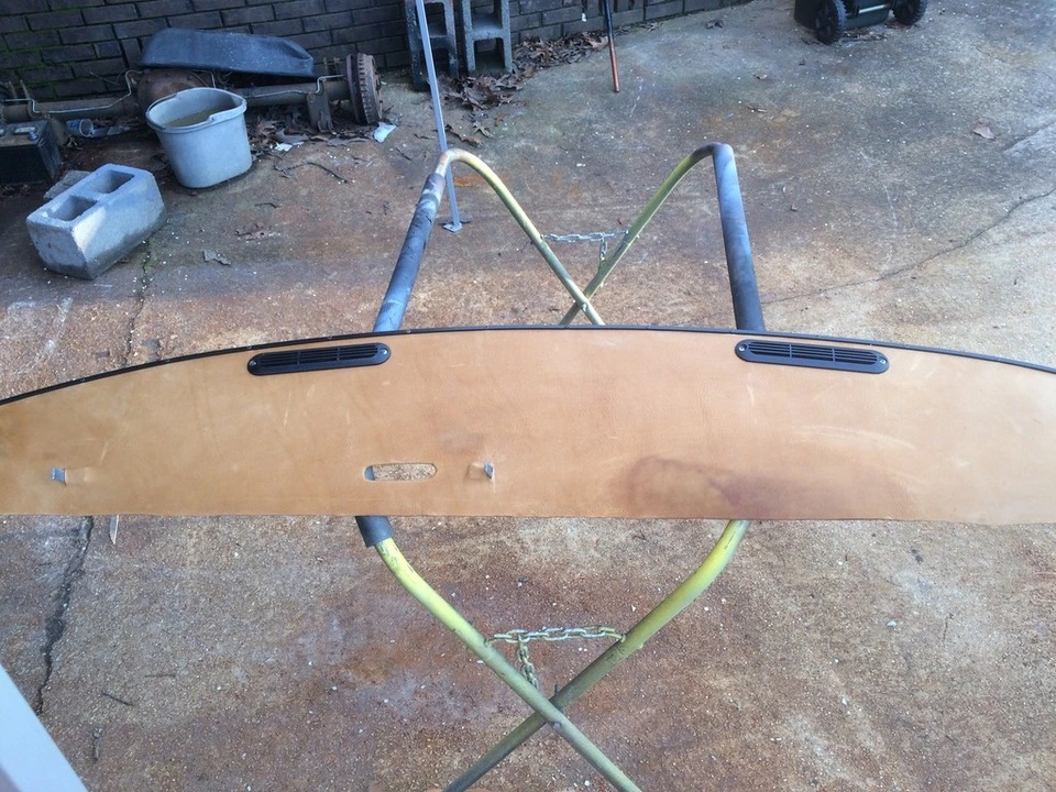

Next, I move on to upholstering the dash top. It goes along easily enough, until I manage to spray some glue onto the leather.
I don't stress over it. I still work at getting the thing covered.
It all goes to hell when I try to wash off the glue w/ some thinner.
I'm pretty sure It's phkd.
I just went down there, it's still just as stained as it is in this pic. The headliner material that was left over just got re assigned.

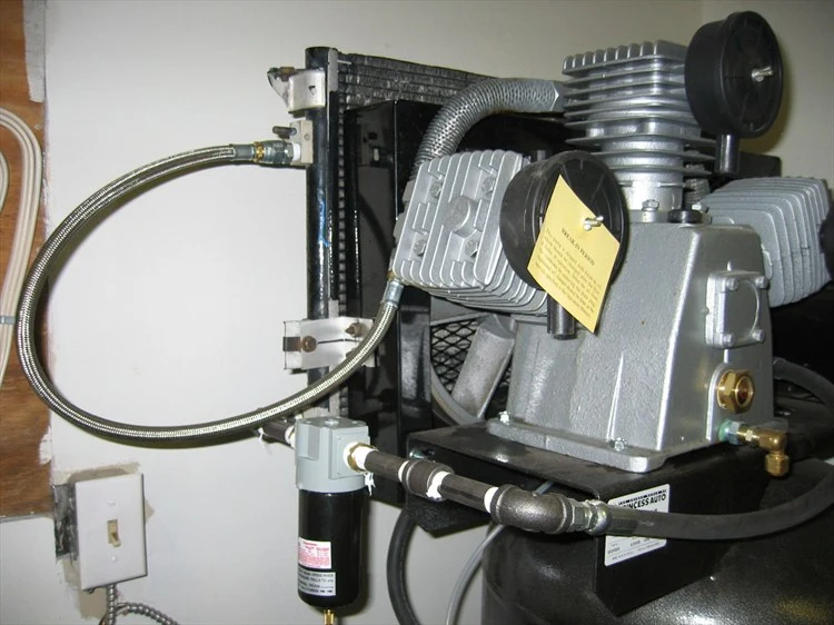

Intercooler between the compressor and tank - old auto A/C condenser. It cools the air and makes it easier for the water separator to spin the water out of the compressed air. The cooler air is, the less moisture it holds. Intercooler plumbing - connect one end to the compressor and the other end to a water separator with a drain valve in the bottom.
Remove the drain valve and connect tubing from it to a normally open solenoid valve. The valve closes when the motor is running. When the motor shuts off, the solenoid valve opens up and drains the water from the water separator. The air output of the water separator goes to the one way valve just before the 60 gallon tank that came with the air compressor. Does a great job of keeping water out of the tank and lines. It really does a good job. Don't skimp on the water separator - buy one intended for industrial use or a paint shop. The motor controller and solenoid require a little thought, but it isn't that complex.

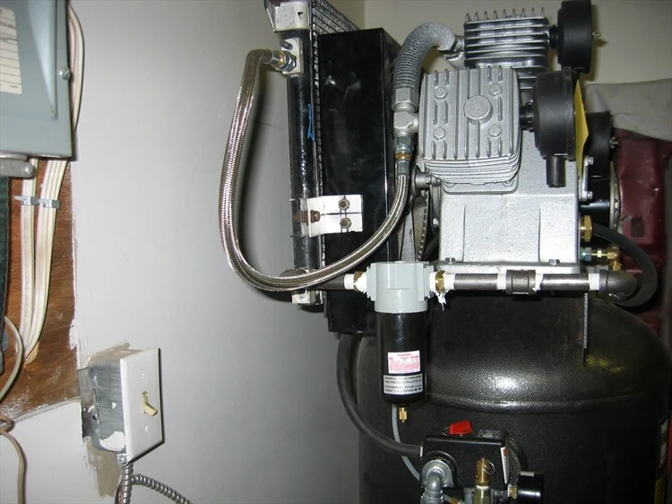

This setup below isn't mine but it is the almost the same as far as the design goes. The only thing missing is the solenoid operated drain for the moisture separator.
See DIY Compressor Intercooler for the great results this has.

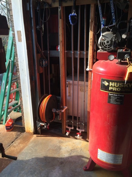

I was gonna repaint the dash today, but thought better of it. Although I had bought those little orange water filters that screw into the gun, I still wasn't seeing the forest for the trees. The real problem at hand was my weak-assed compressor line system. I had been trying to get by, but water would start spitting out of the exhaust of any air tool after 10 minutes of usage. So after a recommendation from a friend, decided that today was the day to fix it.
Off to Home Depot I go.
Returning w/ 61.00 worth of various pieces and parts to make a "manifold type" system where there are multiple risers w/ water taps at the bottom of those risers.
It looks like this when done:
It killed the day to the tune of about 5 hours, but I believe that it'll work (as long as the PVC lasts at least) There is a little over 50' of vertical rise in the system now, in the space of 32" w/ three drain spigots, and the regulator, w/ it's drain right before the hose reel. In testing the hot air manages to dissipate by the third rise (by touching the risers) so by the time it gets to the hose reel is has cooled to ambient. As the friend recommended, I intend to crack the ball valves just enough to hiss so that water will not be able to make it to the regulator, and any that does will hopefully pool in that reservoir.

I have been told not to use PVC pipe for air lines because if it gets hit hard, it tends to shatter like a grenade. I hope that I am wrong about that...
Edit: I found that PVC is definitely not recommended...
See Google for more information.
Uh oh. I need to re-plumb all of my air lines in the garage too.
Copper is expensive, Black iron is a pain, looks like nylon tubing is the way to go!
for however how long it lasts, and as long as you're not in the blast radius when one of the lines fractures and sends PVC shardlets spraying throughout the garage, The worked for me.
