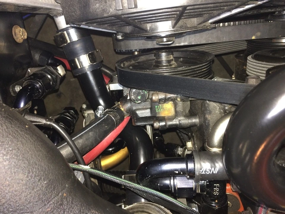

Ok, two things. First I'm looking for advice:
This is the start up video of the car when it was sucking water. I won't bore you by asking that you watch the whole 4 minutes, because the crux of my question centers at the start up of the engine at about 2:23 in on the vid. There is a squeak that you'll hear, particularly when it's first started. That squeak seems to be dependent on if the engine is accelerating (like when it first starts, and while the engine surges) I have the belt off thinking that I may have a bad idler pulley bearing, despite the fact that they were both new. Unloaded, they roll perfectly smooth, w/ no evidence of friction. I also ck'd for a possible interference issue where the pulleys may be rubbing on some metal part, and I couldn't see anything obvious there either. The belt itself was fairly tight so I don't think it's slipping. That brings me to consider whether or not there is enough belt wrap around the crank pulley.
When I built this belt system, I assumed that having the idler on the drive side of the pulley would be high enough to keep everything tight w/o any slippage, but now, I'm wondering. There is no real way to check this short of adding another smooth idler on the other side of the crank pulley, which would effectively wrap that crank pulley 180+ degrees.
But,...I don't want to have to do a bunch of extra work, just o end up finding that I had a bad idler bearing that only showed it's ass when it was loaded, so what do you guys think it might be?

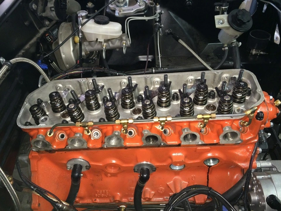

The HG came in.
After looking at it,...it is the lowest form of a stock HG money can buy. Paper fiber surrounding a metal shim, w/ a steel fire ring integrated into the gasket. I called Cometic to see if they wanted it to go on dry, or have me add some sort of sealant given this engines' fondness for puking it's fluids back out, and dude tells me that the gasket was intended to go on dry, but if I wanted extra insurance, I could shoot it w/a couple of coats of copper coat for an extra sealing margin.
What do you think I did?
You damn right I sprayed that pig w/ Copper coat.
I just hope that I can get a safe 10-12 lbs of boost out of it w/o pushing it's ability to adequately fasten the head. It is not my life's ambition to change out the HG every time I turn around, but at the same time, it'd be a damn shame to have an engine like this that I have to hobble because of it.
I gave the head a bath in soapy water, blew it off, set it on there, and torqued it in three steps to 75 ft lbs. Tomorrow, I'll give it a run through one more time, and I'm gonna put the rest of the engine back together.

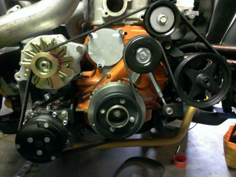

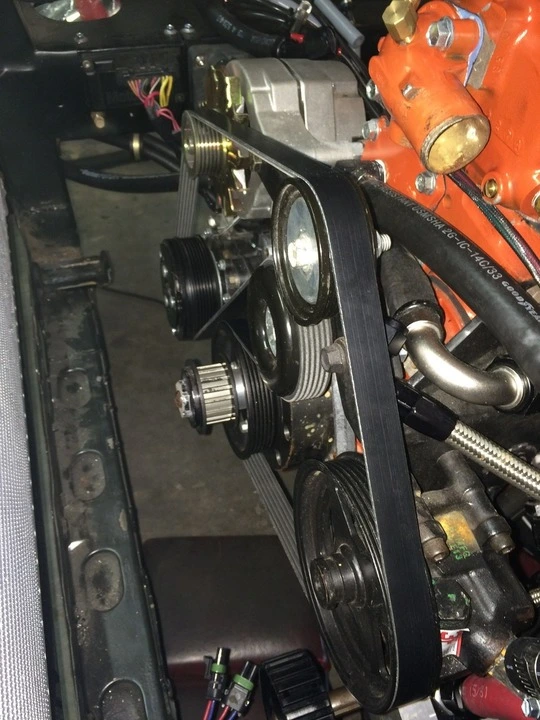

Whether or not the lack of belt contact was making that noise, I went ahead and changed the routing to allow more belt to contact the crank pulley.
It's good to be able to post a pic, and have others look at it, and potentially see things I do not. Thanks go yo a guy over at FEP for pointing out what was right in front of my face.
He did some drawing, and re routed the belt using the existing setup I currently have.
That drawing ended up looking something like this:
Unfortunately, there's a condenser in the way that won't allow me a straight on pic, but simply changing the path of the belt allowed me to get the crank pulley over 180 degrees wrapped.
It did hurt a little, as I had to cut the existing brand new belt, and an additional smaller one (that also was perfectly good) to use to determine the actual additional length that re-routing the thing took up. That new belt cost 40 bucks, and I'm sure that the one I cut up was similar in price.
That ended up being an additional 14" but now, I have effectively wrapped the crank pulley, and the AC compressor at the same time leaving only the alternator with only a small section of belt touching it. I can put in an additional idler if that becomes a problem, but for now, Im' in "wait and see" mode.
As far as using the old (new) belt as a guinea pig, I'm not too worried about that. It only fits the old pulley system. How many old serpentine belts that don't fit anything I currently own do I actually need anyway?

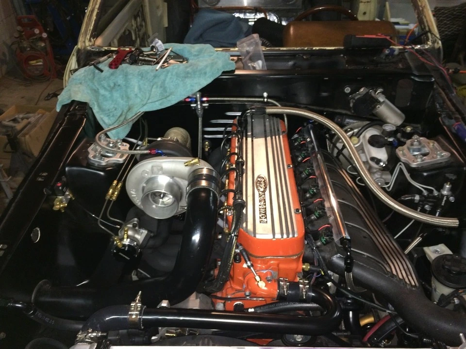

Well, another hour and I'll be back to where I was 4 weeks ago.
This time, I'm gonna go ahead, and fill the damn thing w/ anti-freeze.
We're just gonna assume that it'll stay inside the engine instead of pouring out everywhere else.

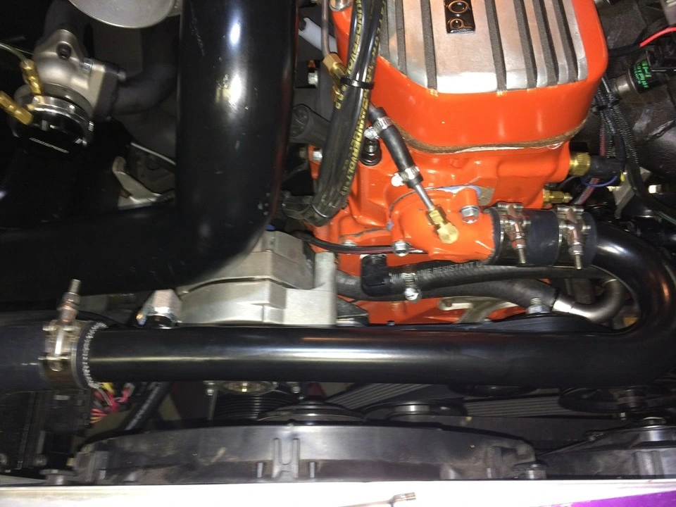

While it was down I took some parts over to the powder coater as they kept getting all banged up if I even looked at them sideways:
That stupid hard pipe lower rad hose has to be snaked in there, then twisted to get the "s" orientation correct. When it was just painted, it was trashed by the time all of that snaking, and twisting got done. This time however, not even as much as a mar.
The upper was the same way, but not as bad.
Additionally I took the hood latch, and some other non-installed as of yet stuff over there. All-in-all it cost 100.00. Tough money for me to spend when it all could've been painted w/ a 7.00 spray can. Obviously though, the durability is beyond compare.

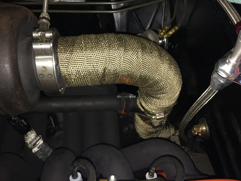

Since this guy was off completely, it got repainted in VHT 2000 baked in the wife's new oven, and wrapped from head to toe. Now I get to look forward to the heat fracturing that'll come as a result of wrapping thin gauge mild steel that sees extremely high exhaust temps.:tu:
I also had Medusa (exhaust manifold) sandblasted and I painted that thing in the same paint.
