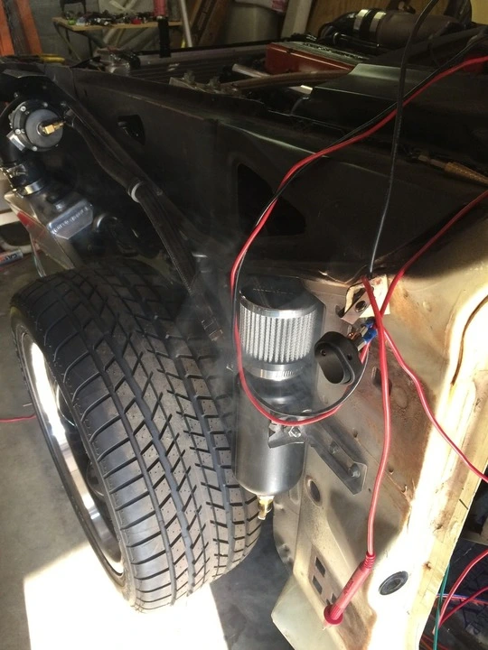

Lets turn the page of the "What the Hell is wrong now" saga that is the Gila Monster story.
Got the car back together today, and it started immediately. It still needs alot of tuning as it surges until it gets into closed loop but nonetheless it starts.
All of the leaks it had before are gone save one. No,....that's wrong. I should modify that comment to say that all of the leaks it had before that were outwardly visible are gone save one.
The one that is visible is an oil leak running down the side of the engine from the cover plate. That could be a simple fix, or a major pain in the ass, as only time will tell as I attempt to stop the damn leak w/ that cover plate in place.
The new "twist" in today's update is based on how to tell if there is water in the oil. The typical remove the valve cover, or pull the dipstick isn't saying that there is, but run the engine for 5 seconds after its hot, and this starts happening:
My best guess is that this is water vapor, as it dissipates almost immediately after floating out of the filter and it doesn't smell like oil smoke to me. Matter of fact, the only smell I can detect is a slight oily-gassy smell, like the vapor is being pushed out by crankcase pressure but so far it hasn't stopped. (At last for the whole 5 more minutes the engine ran today) Besides, even the pic shows the "smoke" to be transparent as you'd expect to see from your tailpipe on a winter morning. This isn't "new" water becasue the new water is antifreeze. This has to be residual from before.
So, lets say that there is a little water in the oil, and it's getting cooked off and is making its way through the crankcase as vapor, and out the vent tube. It seems to me that it didn't do it before w/ the copper HG, but that's not to say that water didn't get in there the last day(s) before I committed to pulling the head when I was doing a leak down test, and water vapor was puffing out the exhaust ports. How long is this gonna last?
One way to know for sure is to drain the 8 qts out and replace it. One time I'll look at the oil on the dipstick, It looks perfect on the stick (as you would expect from oil w/ 15 minutes of run time on it) the next time I look at the oil, it seems cloudy.
I know that it's not coming out the tail pipe this time as the exhaust smells like gas, there's no visible vapor, and now that there is antifreeze in there, there would be a telltale scent of antifreeze if it was getting in there. The number 1 plug, which was the problem child the last time appears fine, but I havent pulled the other 5.
This just can not be another damn leaking HG issue or worse something wrong w/ the head/cylinder seal. I will have a freakin stroke if I have to pull the head, or worse the entire engine out of the car.
If this is standard blowby, then the engine has an issue. That completely baffles me because the compression test, and subsequent leak down test did not indicate that there was poor ring seal. I guess if I start the engine cold, water vapor in the form of condensation shouldn't show up until the engine gets to at least 180?.......ya think?
I gonna go buy a rope and through it over a branch in the back yard.

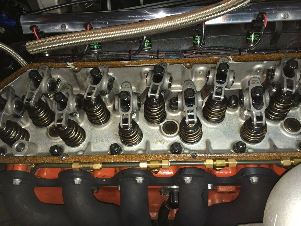

**Update to the update**
It's not water in the oil. Not when the top of the engine looks like this after running 5 minutes:
The plugs all looked ok save #2. It looked a little oily. I guess I'll redo the leak down test tomorrow and see what it says.
Catch 22.
Cometic wanted me to retorque the HG after the heat cycle despite the fact that it was a stocker. They said that as long as I had an aluminum head on a cast iron block, it was necessary to compensate for the different expansion rate of the two metals. I put the torque wrench on a couple of the outside studs, and was able to pull it before it clicked, so.......good advice.
The catch 22 part of that is that if #2 has something wrong, and it is the reason that I'm seeing what I think is water when it's really blowby because of a hurt ring, I'll be taking the whole thing apart anyway.
