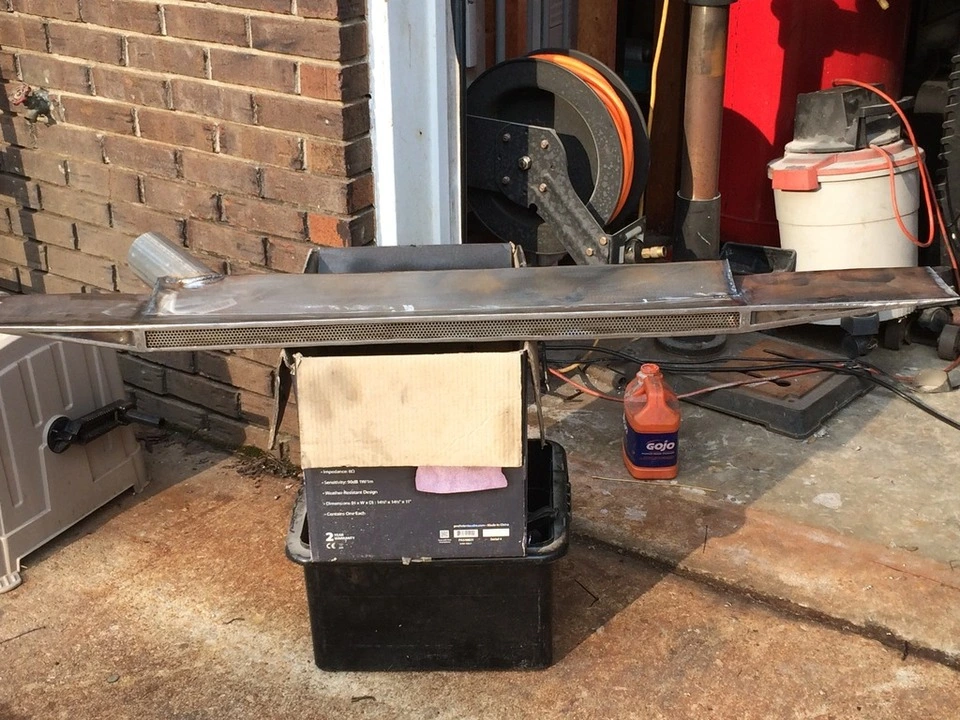

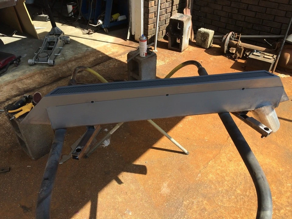

Again, as per my sketch, I wanted to do something different w/ the exhaust. The sketch details a center mounted exhaust hanging directly below the bumper.
Building the thing turned out to be way more involved than the plan. Nonetheless, I slogged through it. I just didn't feel a single fart pipe looking thing hanging under the bumper, although it would've been so easy to just chees out and go to AZ and buy one. It's just one more thing that took way too long and caused me a whole bunch of grief along the way.
I built this thing out of 16 ga. mild steel. To say that it is a little heavy is an understatement. Especially considering that a typical exhaust tip probably weighs a whole whopping pound or two, I now have the equivalent of about 10-15 of those dudes back there.
The problem that came with building this thing, and still remains even now, is the failure of the farthest outside edges to follow the curvature of the bumper.
The bumper crowns out and up. and despite the fact that I literally clamped the main center section to the bumper before welding the outside triangles in place, The damn thing just wont follow the curve. I have cut relief cuts in the outside traingles two additional times, clamped everything in place to avoid heat related warpage and welded the thing in spurts to be sure it all was welded before committing to the final welding.
It still comes out wonky.
I started on this thing Tuesday, and up until 6 PM today, have been dicking with it non-stop.
I think it looks good, and I'm curious to see how it will sound, but I'm sure that those hanging down outside corners are gonna cause me to cut it apart again. (and I know that it's gotta be getting thin in places from all the grinding)

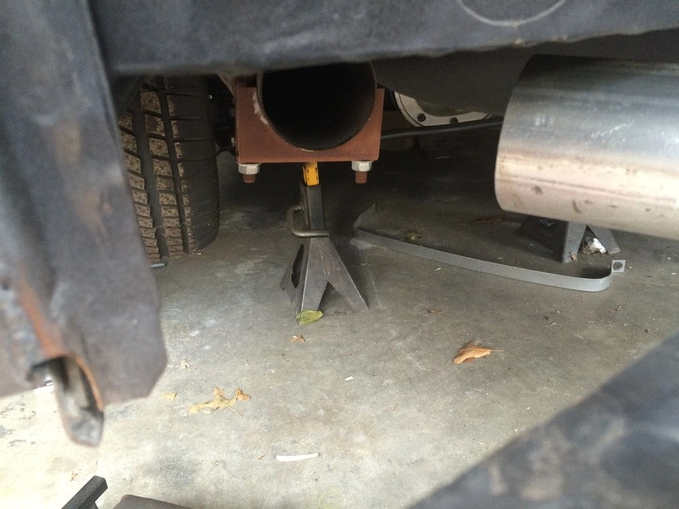

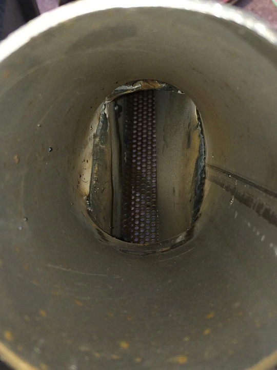

The 3" pipe that comes into the thing had to be "persuaded" down to the 2" height of the rear entry. I flared the transition into the box, and flattened the tube somewhat to mate the two surfaces up. Once the exhaust gets past that tiny choke point though, it flows into the big center chamber where it exits through the 1.5" x 36" slot in the center.
Right now the thing isn't tied into the exhaust, but it's only a matter of one 45 degree bend, and a couple of 3" V band weld rings to hook the thing up. As you can see in the pic, it is rigidly mounted. Well see how that goes after I get the thing back running again.

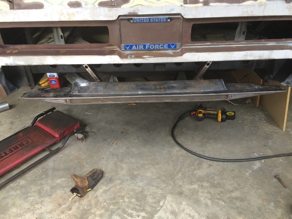

Take the exhaust tip as an example ( The Gila Hole).
I don't have to tell you that the original version was modified a total of three times trying to get it to fit. Unless you didn't read the commentary.
There were multiple problems w/ the design, and I'll get to all of them, but we'll go along and discover them in the order that I did.

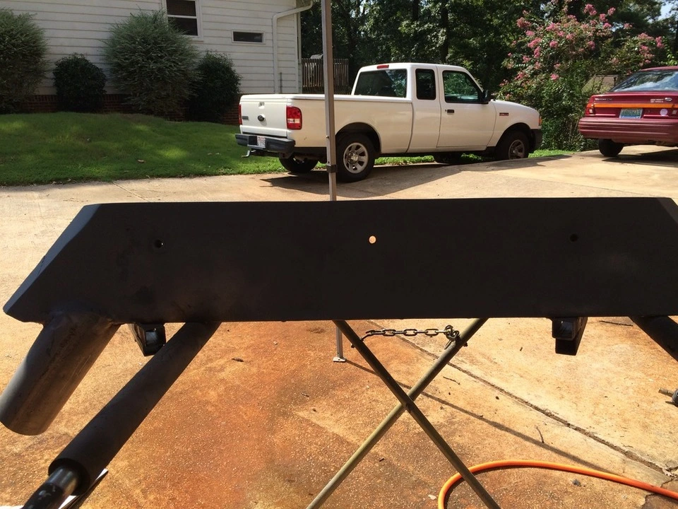

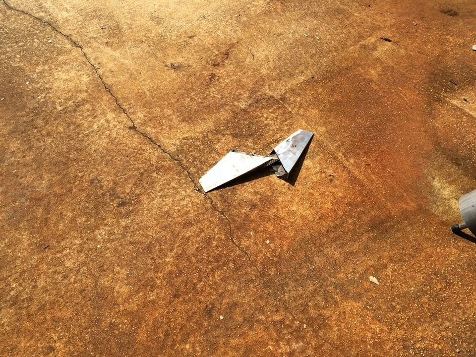

First the wings, outriggers, outside triangles, what ever you want to call them, were contacting the rear most part of the bottom of the bumper. It was suggested that I put a floor jack against them and hydraulically "tweak" them.
I didn't even try that.
The fact that they were triangles, backed by 16 ga. steel, w/ a 1/8" thick x 1/4" wide frame on front was one reason, the other was that they were already making contact w/ the rear bottom edge of the bumper would've made that pointless.
I cut them off.
I then modified the remaining center section by covering up the wounds, and finished it by running stiffening tubes through the main body to lessen the possibility of unwanted harmonics ( i.e. rattling) as a by product of the exhaust pulses.
I put the newly shortened main body in place, only to discover that it still was over a 1/4" away from the bumper at the outside edges. There simply wasn't anything else I could do to the thing to get it to fit better.

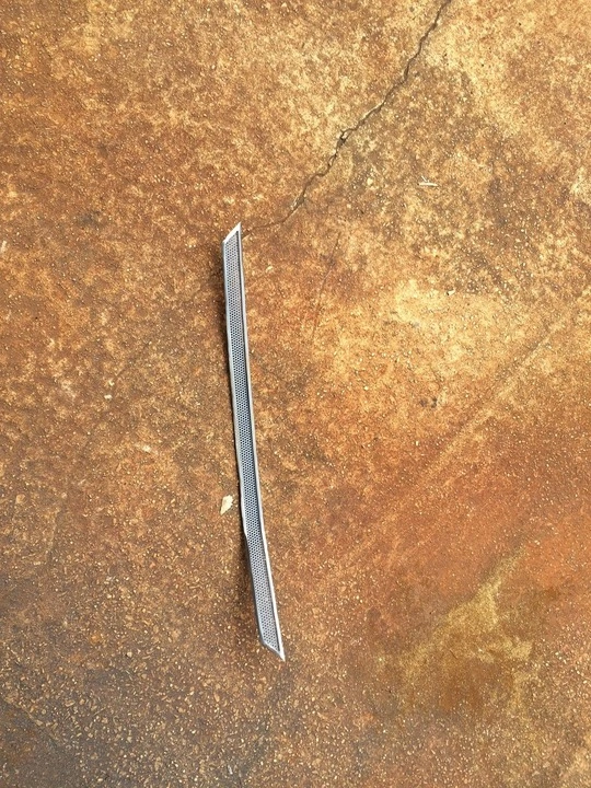

See the "do it twice Mike" part of me evidently put the mesh on upside down, and the curvature that I built into the framed front was frowning, instead of smiling. It was now obvious by looking at it. I had indeed rushed through putting the front on the thing, and even though the curvature isn't that evident when you look at it laying on a table, it's real obvious when it's installed the wrong way.
I had no choice but to cut the front grille off the thing, and start over.
In actuality, there was more wrong with the front piece than the fact that it was upside down, I got it too hot when welding it together, and it was all wavy and had buckled. It had to go.
I built a new front.
This time being ever so careful to make sure that the orientation of the grille was smiling before I welded it in place. And,...as opposed to last time, moved around alot more so as to keep from getting the thing too hot while I was welding it.
But I ran out of welding gas before I could completely finish the thing.

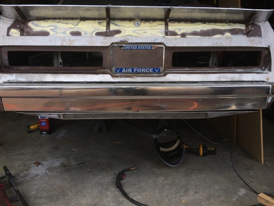

I ground those welds smooth, and bolted the thing into place.
Only to discover that I had the thing off center by almost an inch.
I took it back off and cut the mounts back off (that I thankfully only tacked on).

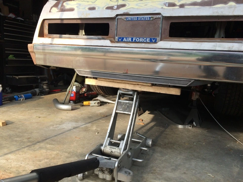

That left the only thing I could do to check the fit.
THAT is what I'm talking about!!!
Finally, after 7 days I almost have an exhaust tip that I can live with. I have one more day in re doing the mounts, prepping it, painting it (High heat black)and tying the thing into the exhaust. But this pig is done.
