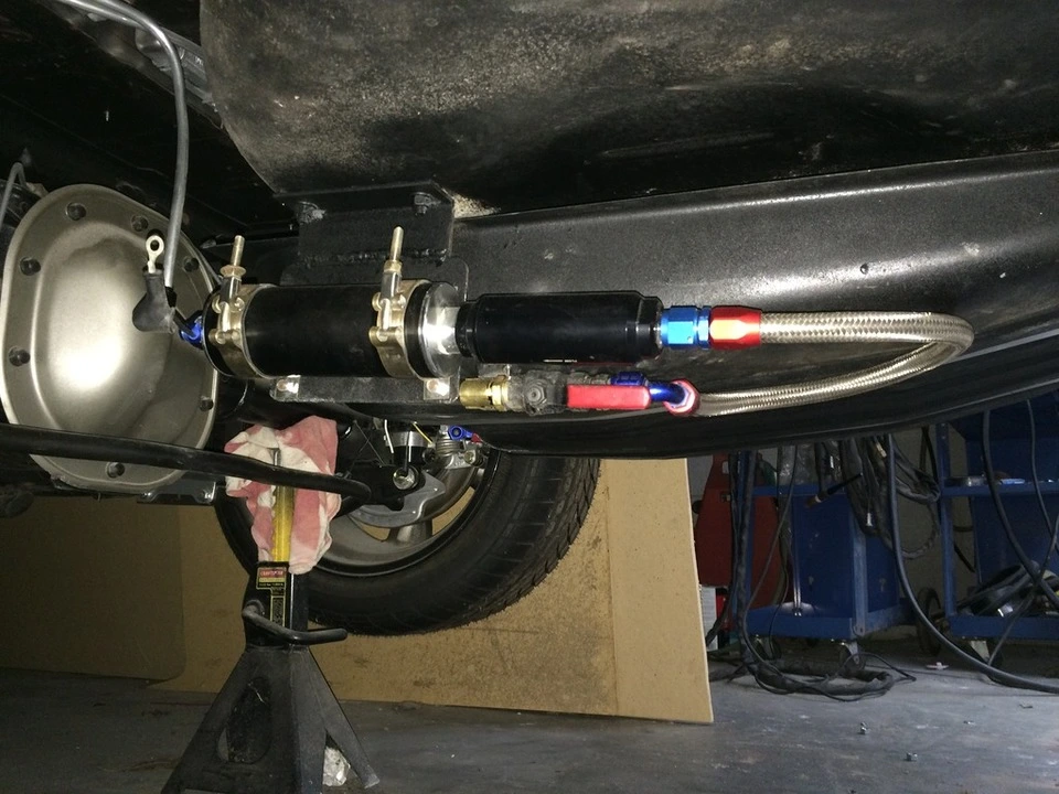

Maybe a month ago, I bought a new gas tank and set about modifying that thing as an alternative to the ground draggin', dropped sump piece that was currently in place. I decided to run a -8 out the side of the tank and have it exit behind the rear passenger tire. I installed a tube type fuel sender as opposed to the "not registering properly" conventional unit in the current tank. I relocated the pump assembly from the rear, to in front of the tank because I wanted to use that space for the Gila hole exhaust tip that I made.
I did all of that a few weeks ago. I haven't thought twice about it after that.

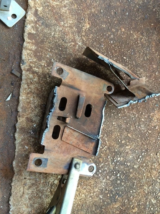

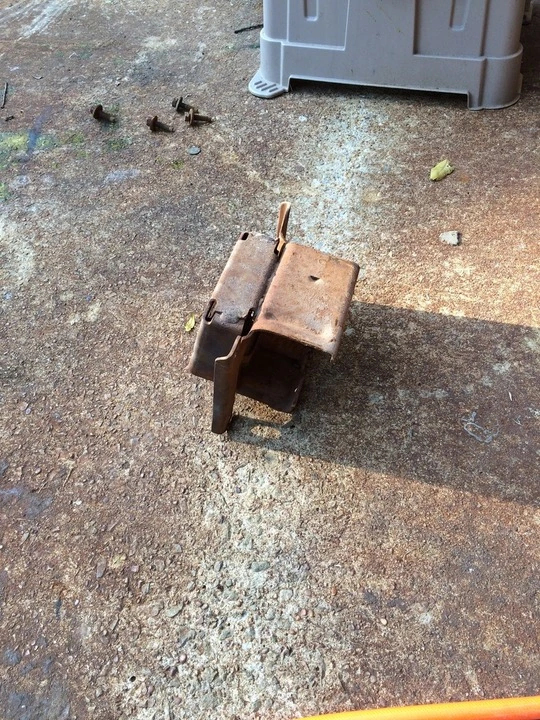

In between waiting on the primer to dry, I also spent way too much time cutting and grinding, then stripping and painting the invisible bumper brackets, and "welded closed" shock absorbers that the bumper mounts to.
This is what one of those ugly little suckers look like after hiding in the bumper for 35 years.
And after it had a session w/ Dr Plasma cutter.
The rest of the day Those parts, (brackets, shocks, bolts) took turns bathing in straight muriatic acid. By the end of the day, I had breathed so much of the fumes, I'm convinced that I now have some sort of brain damage. If I was younger, and was still in the child raising years, I'm sure that any future offspring I may have had would end up as little mutant C.H.U.D-lets as an additional side effect.

When all the parts were stripped, and were going through their own various stages of primer, and paint, I turned my attention to mounting the tank.
Didn't fit.
It hit the relocated pump bracket assy that was now firmly interfering w/ the tank, not allowing it to go far enough forward. It wasn't by much, but that didn't matter.......
It wouldn't fit.

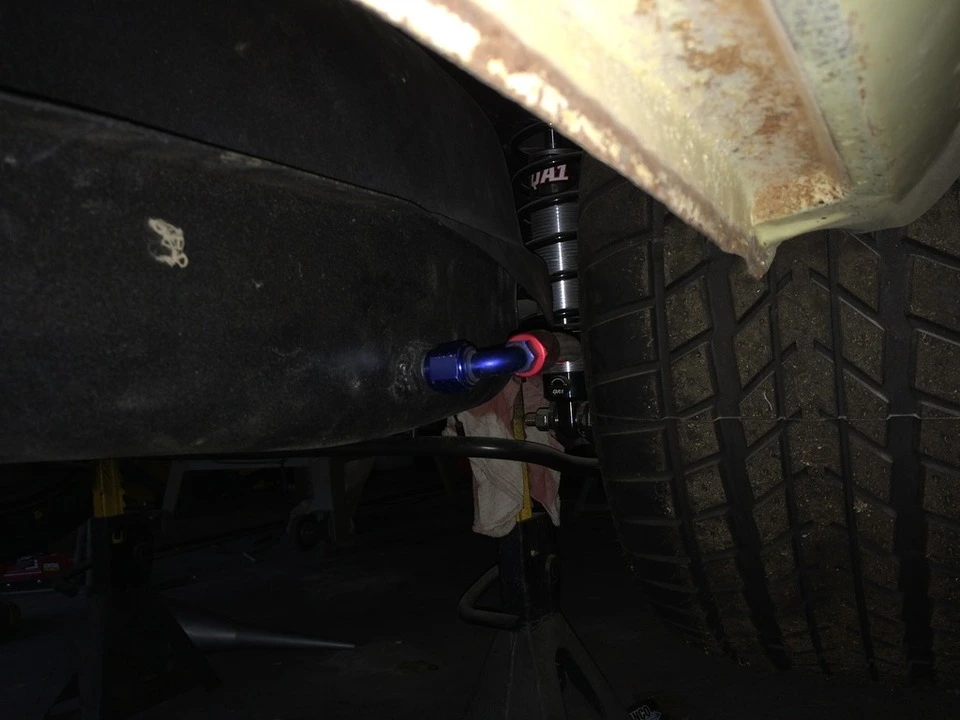

I removed the bracket, and finished installing the tank. While I was looking at possible alternative locations to mount the pump assy, I started to look at to the side mounted -8 fitting that was supposed to be the fuel supply orifice.
How much consideration did I give to the location of this fitting when having to also consider possible road hazards ripping the fitting/hose out of the side of the tank, and causing a massive fire?
** For those of you reading along at home, touch the tip of your first finger to the tip of your thumb to get the answer to the above question.
Maybe I should just do this instead?
So,.......The pump assy, and now the -8 fitting that supplies that pump was relocated to the side of the tank, in the middle of the car, as opposed to the areas that were most likely to cause me future grief. The -8 fitting behind the tire has been capped.
I made a mini sump and welded that onto the tank, the bracket assy that holds the pump is bolted to the trunk floor. The -8 hose had to have the loop put in it to avoid a "really too tight turn" to get the supply into the first filter.
It'll work.

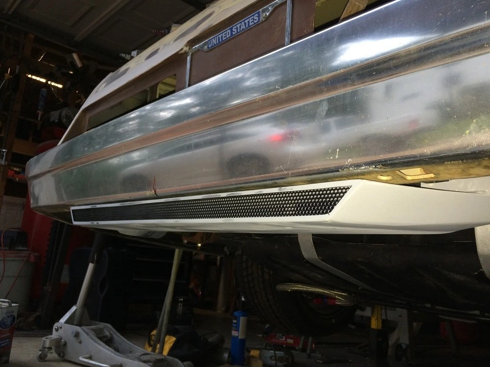

Now those modified bumper brackets, shocks, and bolts are all painted and reassembled. Did I think to take a "after" picture of that?.........Nope, and for the sake of any " what the hell is that"? I'll not show you the assembly inside the bumper, that is now bolted back in place,...but I will show you the G hole again ( I was laying on the creeper, at the end of the day, and I thought what the hell)
I painted the grille, but that is as far as I'll go w/ it until we get closer to painting. Although you can't see it in the pic, the bottom of that thing is as flat as Kansas.That piece will be painted separately along w/ the rest of the monster pieces when that day comes.

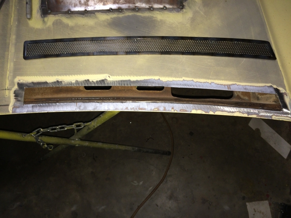

Today I killed two birds w/ one stone. (Well,....I only killed one bird, but the other one will be just as dead, as soon as I go and pick up the rock that killed the first one.)
At the back of my hood, right about pinch weld area, I have rust through on both sides. My options here are to cut out the offending area, and patch it with a solid piece, or create a vent(s) to allow hot engine compartment air to escape. Your hood is zackly like mine in regard to the frame structure, so you can appreciate my thinking here. The hollow frame that runs around the perimeter of the hood makes for a perfect run channel for the hot air to find a path to get out. So, it's only natural (at least in my mind) that if I'm cutting out a section of the hood directly above that frame, I'm certainly NOT gonna cover it back up.
How it rusted there w/ it being an Arizona car is beyond me. If the little old lady that owned it for most of it's life was still alive, I'd have half a mind to dog her lazy ass for never having the good sense to wash the damn thing...
" Hey,... Grandma! See that building w/ the robot that shoots water out of it at the cars that are inside? Do yourself a favor and drive it in there once in a while before you die, and I end up cussing you postmortem for making me have to fix the rust that you allowed to fester":grumble:
I guess I told her....
Where was I?.......
Oh yeah,.... killing birds with rocks.

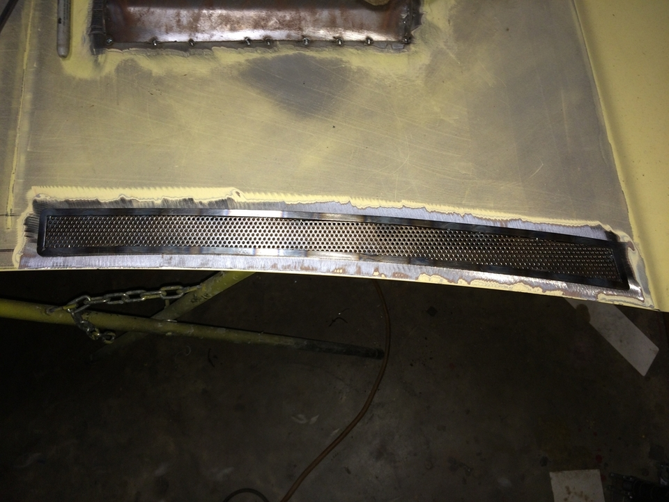

Today I set about cutting the area that was rusted. It really wasn't that big, and originally, I only intended to make a smallish cover for the actual area that was affected. But,....after thinking about it,....and looking....I decided to elongate the opening.
Of course in doing that, it required that I fabricate a longer cover,..but I seem to have a buttload of the mesh, and that expensive assed 1/8 x 1/4" hot rolled steel that I used in the dash, so what the hell.
G vent, Curious onlooker. Curious onlooker, G vent.
The cover is just sitting there for the sake of the photo. I still gotta neutralize the rust that started to form in the frame, and prime it w/ something that wont stand out like a beacon visible through the mesh.
The really hard part of this whole procedure is welding that thing onto the hood. It needs to be tigged, And when it comes to tig welding something in the corner like where the frame meets the sheet metal, I SUCK!. Miserably. I'll do more damage trying to weld it than what can be salvaged.
Using the Mig will force me to ruin the sharp edge of the frame grinding the welds out of the corners. On one hand, I'm tempted to rivet that sucker on,...but blind rivets look tacky. Or I could find some sort of taper head sheet metal screw, and perimeter screw that dude onto the hood. It'd be similar to the way I fixed the frame onto the dash structure where I had to drill and tap a bagillion 4-40 holes. This time they'd be sheet metal screws, as there is no substrate to actually drill and tap beneath.
Lastly,....................I could always Epoxy that pig on there.
