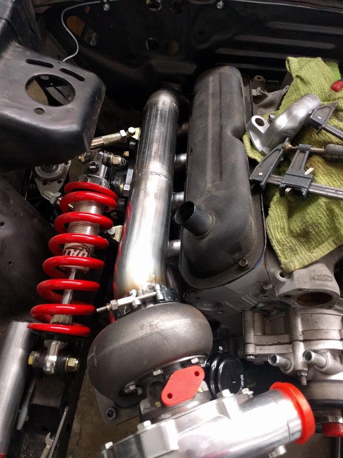

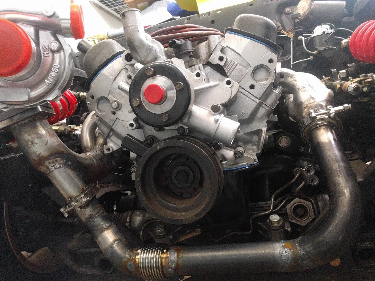

Since starting back on the car I've been focusing on the turbo hotside. I spent some time yesterday evening working on the crossover and adding the wastegate (which i conveniently forgot to snap a pic of).
I'm still getting the hang of tig welding. Welds aren't very pretty but they're stuck together for sure. The bellow flex joint is stainless and the rest is mild steel (used 309L filler for that transition). Not pictured is the wastegate added in on the inside of the Y.

I built the hot side in mild steel, I knew I could melt it all together with mig if I couldn't get the hand of TIG (also i don't have the setup to backpurge stainless and don't want to worry about the sugaring to kill my turbo). When it came time to order the pipe for the downpipe I ended up getting a generic 3" exhaust kit in 304 stainless. $240 for 8 feet of straight pipe, 2 90's, 2 45's, flex joint 02 sensor bungs and two sets of v-bands was better than I could do piecing it together.
Helped a friend move Saturday then got to work on the down pipe when we finished up. Opened my exhaust kit and found I was missing the vband parts, hopefully I can get them in soon seeing how I'm about to the mid pipe secion.

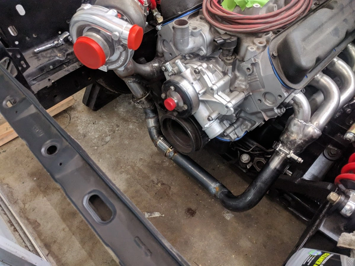

Here's a shot up top, about a 45 degree off the turbo and straight back to tuck between the header and the firewall. I had to cut some more out of the firewall, 3" is a pretty hefty size of exhaust!

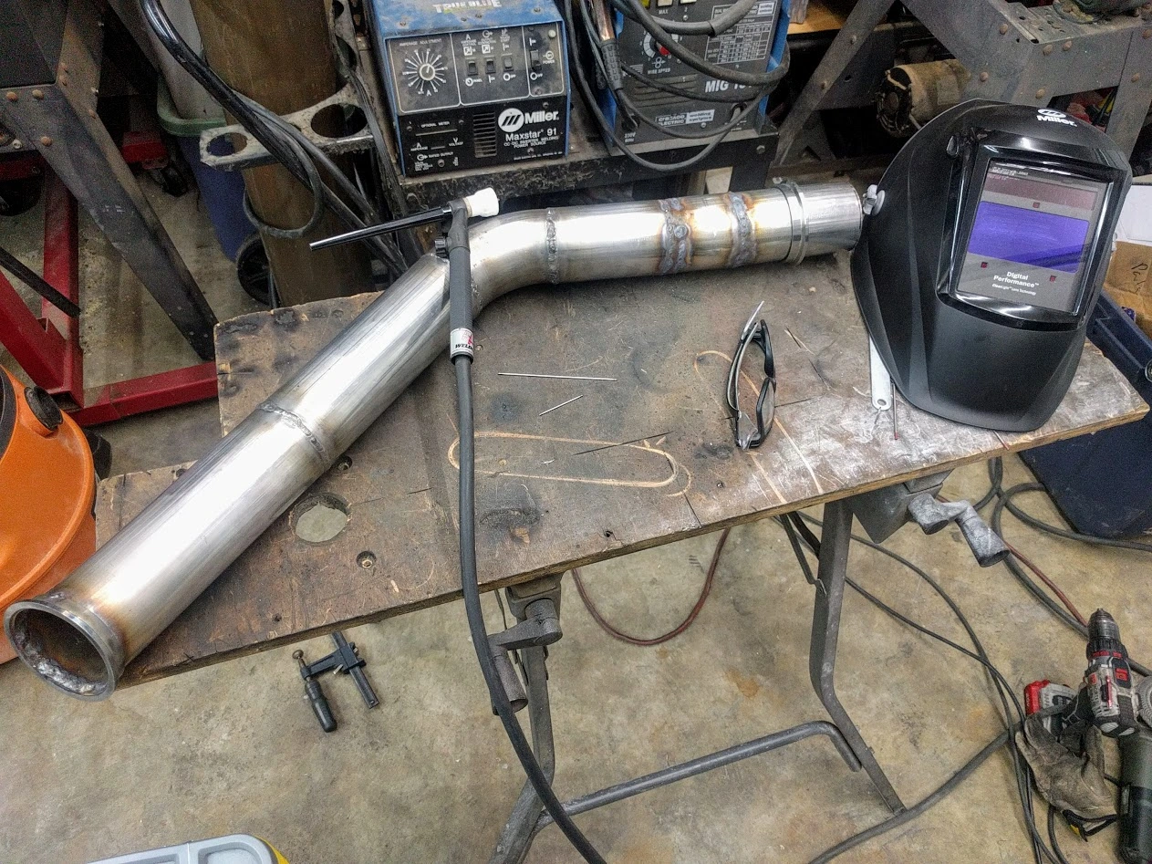

Here's a "glamour" shot for y'all. Ordered a #12 FUPA cup and picked up a new helmet when I was getting all my filler wire. My HF helmet kept switching on and off while I was TIG welding. I'd rather pay for a nice helmet than go blind lol.
Otherwise I've got this downpipe to snake down beside the transmission where I think I'll put the join in for the mid pipe. The pipe is going to be trimmed a bit on the right side, I put the vband on to make sure I could fit it past the headers.
